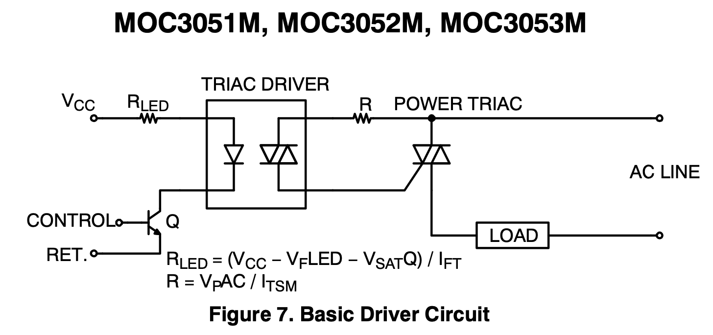

Maybe. Maybe not... I've attached the "typical application" schematic from ON Semiconductor's MOC3052 data sheet. Note the equation: R = VPAC/ITSM.
For 240 V ±10 % operation, you're looking at VPAC = 374 V worst case. ITSM = 1 A according to the MOC3052 data sheet. --> R ≥ 374 Ω. I'd use 390 Ω as that's a standard value.
Maybe I'm missing something. We all make mistakes at times. But I suggest measuring the voltage across that gate resistor to ensure that you don't overstress the TRIAC or the optocoupler.

Neat idea. One thing, though: It seems you're running a lot of gate current in your TRIAC. With a 22 Ω gate resistor, you get over 10 A of gate current. Isn't that a tad much? (Sorry if that's been addressed already).
In theory, for a 230V system it should be something like 330ohm (V^/Itsm or V^/Igm), but IIRC, early versions of the (then) Motorola applications of the MOC30xx often showed lower values (100ohm, or maybe 47ohm).
The reasoning is probably that in the darlington-like configuration, the main triac conducts quickly enough to remove the current from the opto and the gate.
330ohm is probably safer, but with low sensitivity triacs, it will require a relatively high A1-A2 voltage before the triac is able to conduct, meaning the soft-start won't be able to start from exactly zero; probably of no practical importance.
If you allow for ±10 % mains variation, you end up at 360 Ω for 230 V operation. Just saying... 🙂
It could be that 1 A is the max continuous current. It probably says in the data sheet, but I'm too lazy to go look right now. 🙂 With mains voltage, the optocoupler will see a sine shaped current. But still that only buys you ~30% margin.
It is the peak current rating, but the opto will never a sine current: just short pulses, the time for the main triac to enter full conduction.
Depending on the application (the load of the main triac for example), the opto might never see a high peak current, even with a low value limiting resistor, but that has to be ascertained in a robust way because getting it wrong would result in early failure (not immediate though)
