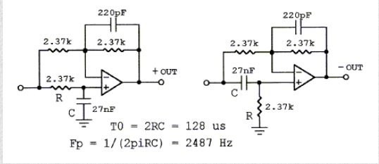

i have some questions regarding the 1st order allpass.
the attached shows the inclusion of 220pF caps.
i have assumed that this is for stability purposes, is that right? and how would you determine its value is sufficient?
if you simulate the two circuits, the 220pF causes a peaking in the HF response for the inverting circuit and rolloff for non-inverting circuit.

Yep, those are "angst" capacitors, intended to improve stability. They are IMHO way too large in those circuits, maybe a typo in those diagrams?
Their purpose is to compensate for the OpAmp's input capacitance and any stray capacitance from the (-)-input to GND and hence should be choosen to have about roughly the same capacitance in order to achieve a stable low "noise gain" of ~2 at RF (1MHz++) frequencies. 22pF...47pF are typical values and a reasonable educated guess.
These circuits are quite low impedance and thus are not very prone to such stability issues to begin with because the resistors dominate the feedback up to very high frequencies before the explicit and hidden capacitances take over.
