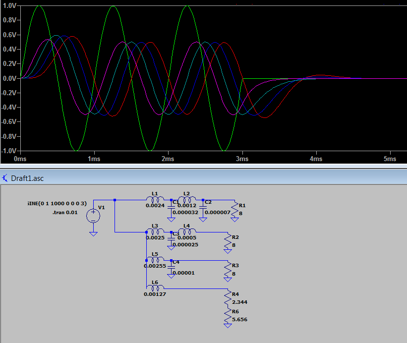

the distinction between time alignment and phase alignment
I don't know what you are trying to depict...? Plz explain...🙂
What I think I see is an electrical simulation. One where frequencies are properly in phase with each other.
What I don't think i see is any evidence of time alignment. Like any delays needed for physical offsets, for acoustic centers distances.
LC cells as allpass to 'compensate' ( induce delay) to the three drivers ( r1/2/3), so it take care of physical offset.
The physical offset could be estimated through the graph but resolution is a bit coarse though.
Thanks krivium, that is what I was trying to show.. The frequency is 1kHz and the low pass filters are -6dB at that frequency. Each order adds 45 degrees, so 0.5ms for the fourth order filter.

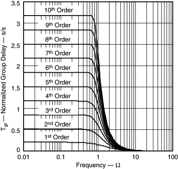

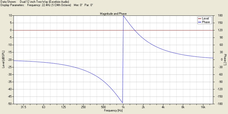

Yes they are (series of all pass in Allen's example and effecting phase rotation).
They are kind of constant delay below a (more or less) defined threshold which will depend mainly on order of the implemented allpass and it's associated group delay ( which will define the max delay availlable).
See first graph linked
In fact it'll depend of implementation and needs and the associated compromise you are willing to accept:
In the second graph you can expect a relatively constant behavior below ~200hz and above ~5khz. If you plan to use this filter in between those two value then yes, it's not very constant delay generator i agree ( it'll 'work' at a narrow range of frequency).
The main issue i see in a passive implementation are: the relatively low delay value availlable (if low order is implemented which is very likely the case) and the increase in cost ( depending on self and capacitors value - we could add another weak point about capacitors about the technology used for anything bigger than 100uf which could bother some).
