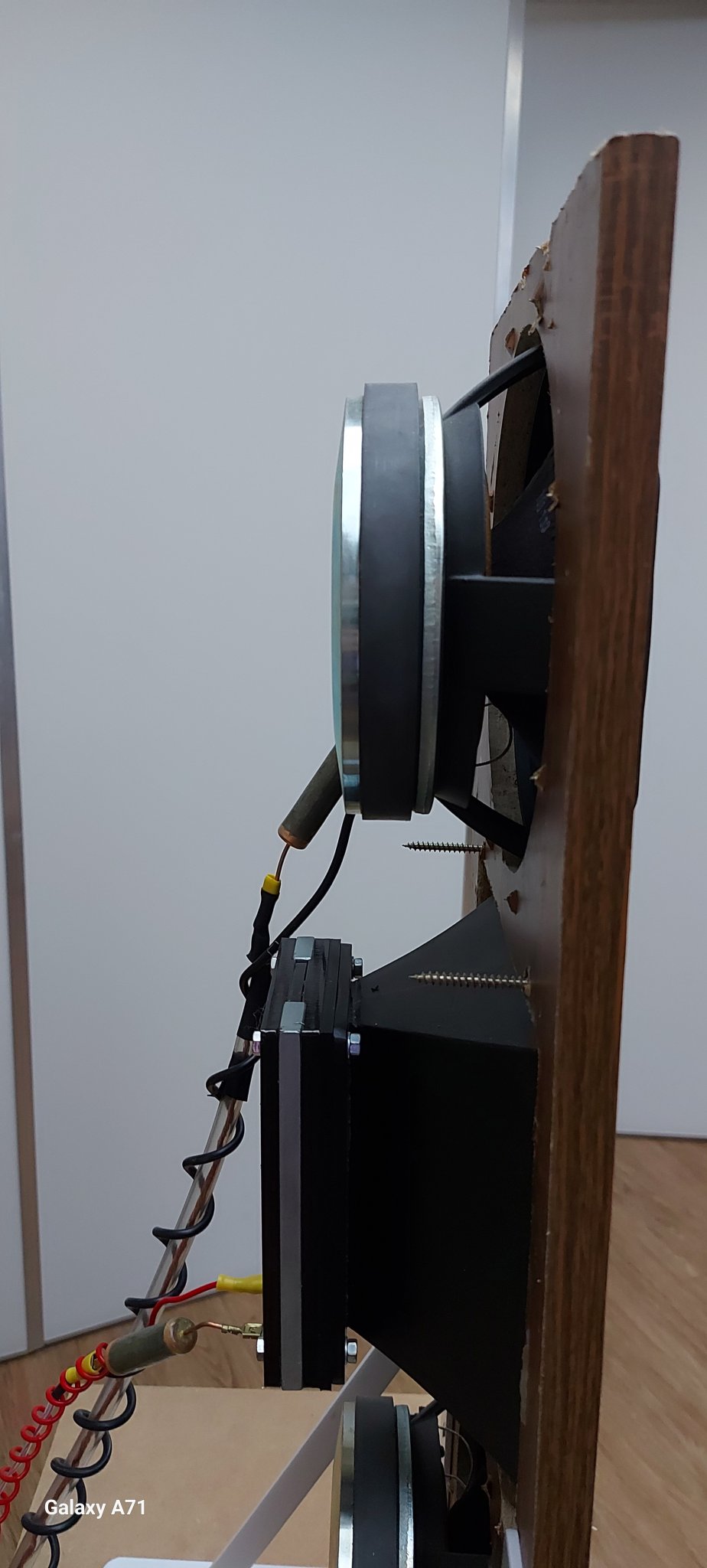

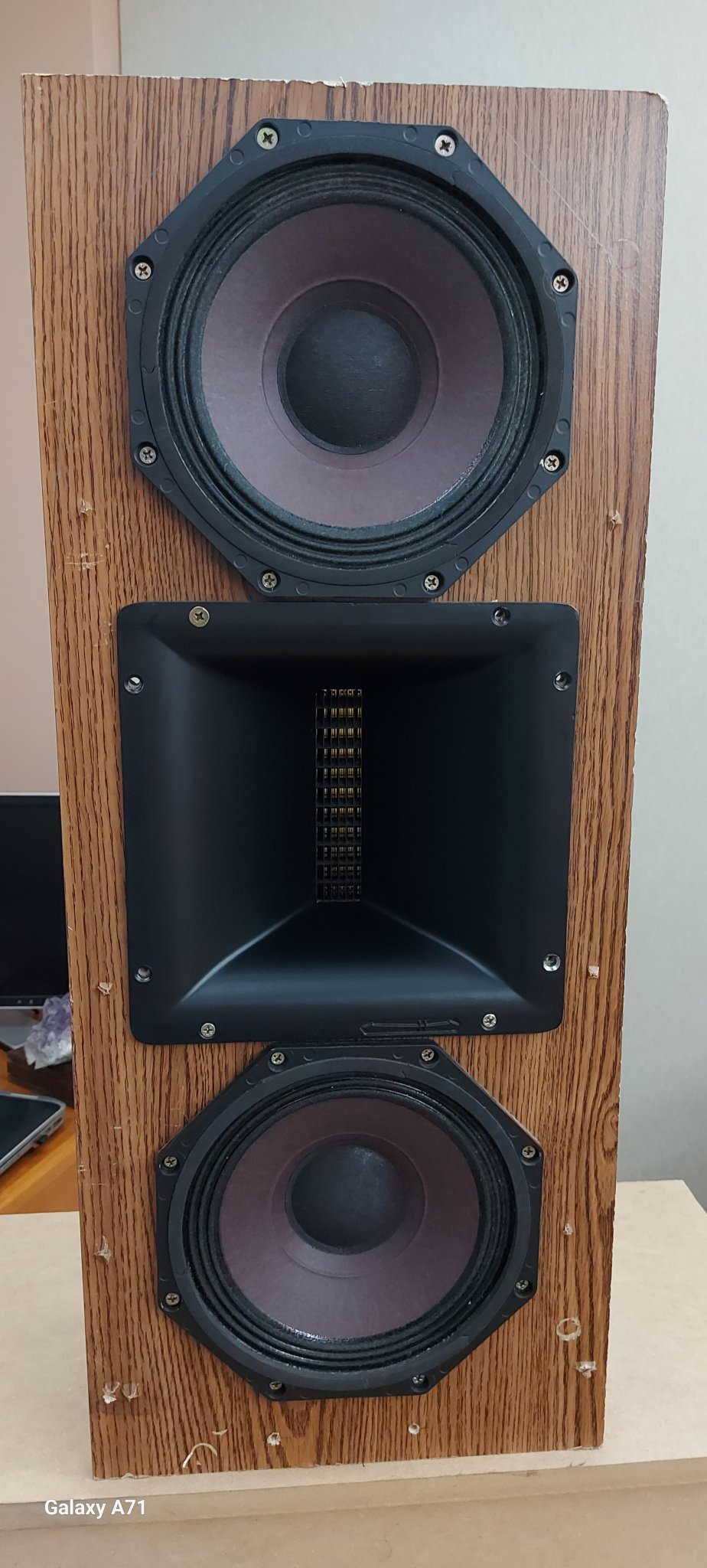

I have Beyma TPL-150H and a B&C 8PE21 mid, and want to mount the midrange from the back of the baffle and adjust the baffle thickness such that both drivers are time aligned.
This means aligning the woofer's voice coil with the AMT membrane:
But what exactly should I align?
The AMT membrane is in the middle of the light-grey part of the motor assembly.
Where is the woofer's voice coil? In the exact middle of the magnet? Looking at drawings online it seems in some the voice coil is positioned closer to front vs the middle of the magnet.

I would use whichever option gives the smoothest physical baffle transition as a higher priority than time alignment. Do you have a special reason that time alignment is necessary in this case?
I thought time-alignment was a good enough goal in itself. Have come across a number of knowledgeable folks referring to time alignment as an import goal. Maybe not?
What is the physical baffle transition you refer? Transition from what to what? Baffle step would be below the mid's range, currently at 300Hz.
Such as flush mounting (just for example). Some make stepped baffles while attempting to time align, but that is creating a new problem.What is the physical baffle transition you refer?
Ignoring it would not be good, because the relative phase needs to be taken into account. There are other ways to manage this, for example in many cases you can handle it electrically.I thought time-alignment was a good enough goal in itself.
Even if you were to attempt to find the acoustic depth you would do it by acoustic measurement. Phase changes are going to vary the effective delay which means the distance may change with frequency, and there would not be a single correct distance. Once you've measured you should see just how much electrical attention is needed.
The woofer itself will have a time delay depending on its high frequency rolloff characteristics, typically caused by Le forming a low pass filter with Re, and the mass of the woofer acting as another pole. Your driver has Le = 0.5 mH with Re = 5.6 ohms, so the first order filter from the electrical part has a -3dB point of about 1800 Hz. We know first order low pass filters have 45 degrees of phase lag at cutoff, so from there (with the speed of sound at 343 metres / second) we can deduce the woofer's delay will be the same as setting it back 2.4 cm. Add the mechanical rolloff and you may not need to align the woofer at all. Of course measurements will help immensely.
Also, consider flush mounting the drivers: your high frequency response will be smoother.

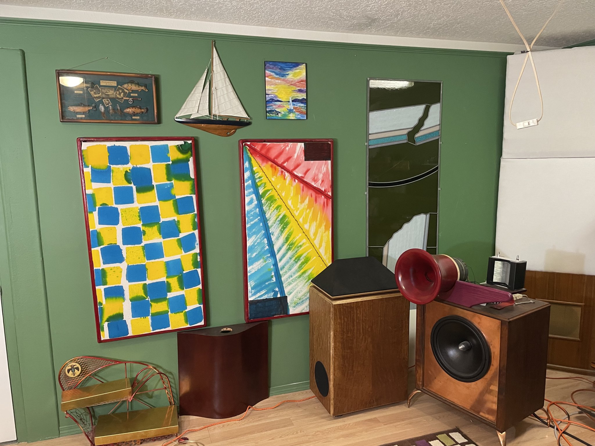

My woofers, midrange horns, and big *** Heil AMT tweeters are all time aligned. They sound very coherent.
How would you time align a compression driver on a midrange horn sitting on top of a FLH with the 15" woofer mounted pretty far to the rear in an enclosure?
Compression drivers are tricky to determine acoustic centers on. Just aligning VC planes isn't enough to go on. Problem is sound travels at different speeds through various materials, so your acoustic center will vary based just on this alone. You have to make impulse measurements to determine actual acoustic centers to physically time align your drivers. Anything else is just guesswork.
For Altec gear, but the instructions/guidelines apply to any speaker combo.But what exactly should I align?
The JBL 2441 compression drivers have a silver line on the housing that mark the alignment spot. The Lambda TD15 woofers have an alignment line as well. The center, front to back, of the Heils mark the centers. Will all those lined up, the speakers disappear.How would you time align a compression driver on a midrange horn sitting on top of a FLH with the 15" woofer mounted pretty far to the rear in an enclosure?
That's interesting ... I didn't know that any drivers actually 'marked' acoustic centers.
Even after 'acoustic center alignment', using passive XO's can enter all-sorts of phase shifts.
So, final speaker system phase responses can be all-over the place.
And, once again, the test equipment so many people don't have access to can be very limiting.

Good. So flush mounting is in. Danny Richie mounts the mids and woofers from the back of the (open) baffle and adjusts baffle thickness to time align and this seems a good idea.
My system uses digital xo/correction that enable digital time alignment. I thought physical time alignment would be a better solution, but seems not necessarily. Plus front flush mounting is easier, so seems like a no-brainer. I'll start with that, measure and will learn what's the misalignment I should correct for physically in the next iteration of my panels.
