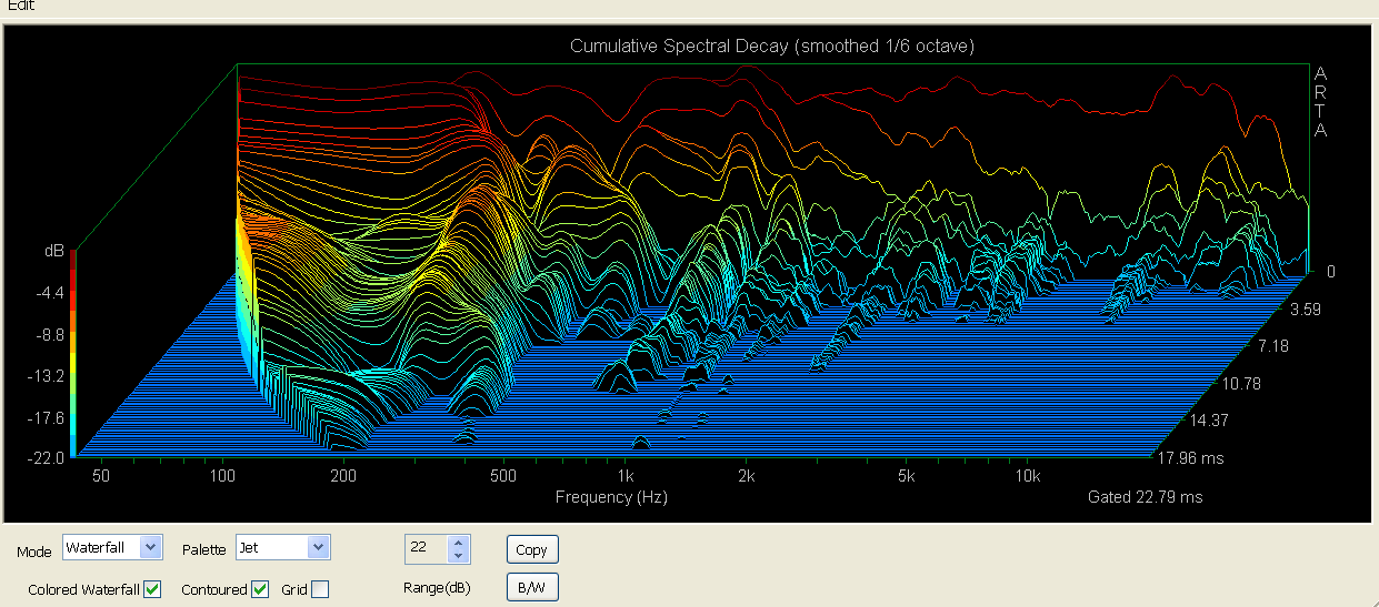

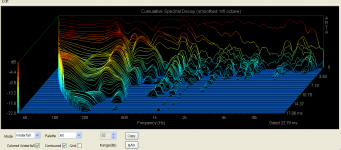

Reponse measured on their position in the livingroom.

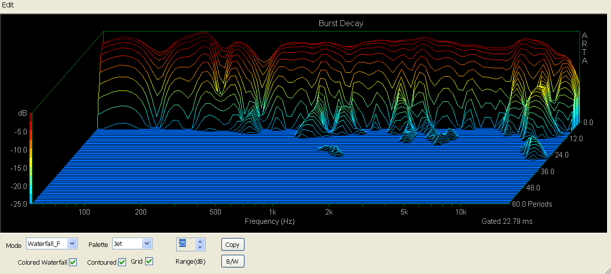

At the burts decay you can see it has only some resonances above 15kHz the response is very tight over the hole band, this passive OB. The sound is very good depth image of different recordings not only depth it even can come towards the listener, voice are very natural and strings of guitar just sparkles in the air and a fundament of subbas witch sounds more supportive without overruling the reproduction.
