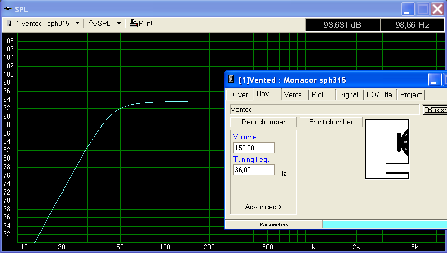

High efficient 12" BR monacor sph315. Grey line 94dB 1wmtr polypropylene cone. and inexpensive. Low groupdelay low thd. Small box.
-6dB 30Hz.

Thanks a lot for all your simulations. What simulation-program are you using?
The Monacor looks quite nice in your simulations, and at a very good price 🙂
Seems like the German measurements differs a bit from Monacors own data. Probably very helpful when designing a vented box. Is from a German magazine? If so, it must be quite dedicated to diy-hifi. The BR-peak at around 35Hz is probably deep enough for me. And probably a lot deeper than many of the typical two-way "stick"-speakers on the market.
It would be nice though to achieve a better efficiency. I could for instance use two of the Monacors. As the cabinet is so small I could easily double it. 85L gives for instance a cube with 3 x 0,44m sides.

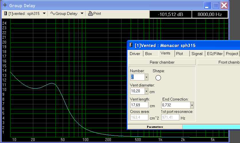

The benefit of the wented box, is that I can place it close to the front wall of my listening room. The OB-bass need space witch is a bit difficult for the moment.
I could imagine a box WxHxD @ 0,65m x 0,9m x 0,35. The depth may be increased. Anyway, if this was the internal volume, the volume would be around 200L.

monacor data is crappy as also for the lack of production quality, they have a big program and nice price woofers.The Monacor looks quite nice in your simulations, and at a very good price 🙂

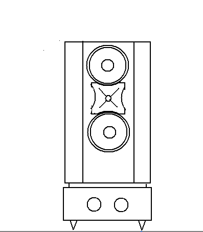

I think you do good thinking there. Placing the box on wall will make it radiating halfspace and there for become constant directivity. And 3dB gain.
Two woofers wil not gain because the impedance is become lower. You will gain better distortion behavior.
I already had these same Ideas that is why I am so fast, I did search all ways to gain efficiency and keep it small.

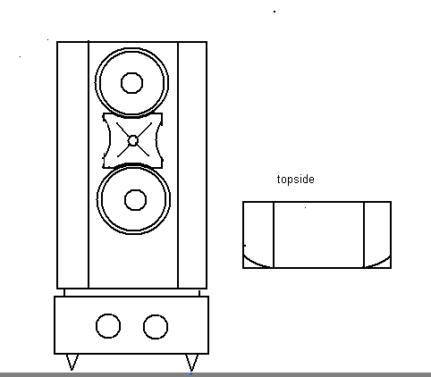

Here the on wall wide baffle d'appolito horn project with 2X SPH315. 150 liter = 130liter with damping .
Horn RCF-h66 this is a fine horn because it helps reducing CTC spacing. It is qaulity made of aluminium short for no colaration of sound.

Dammit Helmuth, that's a lot of different programs and alculators. Thank you very much.
MTM's aren't they beaming, meaning you are not "allowed" to sink down in the chair? I think I would stack the woofers below the horn.
I guess you have performed quite a lot of design-studies 🙂
I not trained to evaluate these dispersion graps.
Beaming or not to beaming thats the question.
My horn beams at higher frequencys. Is that a problem:No
Maybe it is even a advantage not to receive reflections of ceiling and walls.
With the BHB I want to create a point source.
Within the wave length of the XO frequency. The RCF horn HF66 has a dispersion of 60degrees X 60degrees.
This means on 3mtr distance you have 3,4mtr wide dipersion more then enough.

- photoshoot OB MK1, at least they sound good
