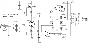

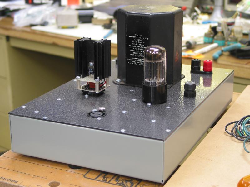

This is a SEPP amplifier I built to test the concept of a push-pull amplifier using a triode and a MOSFET, where the MOSFET is driven to produce the complementary signal current of the triode (all class A1 of course)
It produces a SE harmonic signature and uses a PP output transformer. Power output is the same as a standard 2 tube PP.
This amp uses a 6BX7, one system as driver and the other as the output triode. This is a good tube for this application because one anode can be run at much greater current than the other (like in the vertical deflection oscillator + amplifier circuits it was designed for), limited by the total tube dissipation.
This amp produces 4 watts from 2V RMS input signal using one tube, one MOSFET, an op amp, and a few passives. It uses no NFB.
The MOSFET and opamp are integrated into the octal base device with heasink on the left I call an OpFET. This allows the chassis to be wired all point to point like a regular tube amp. Since it has to dissipate as much as the tube anode it does put off some heat!
Michael J Koster

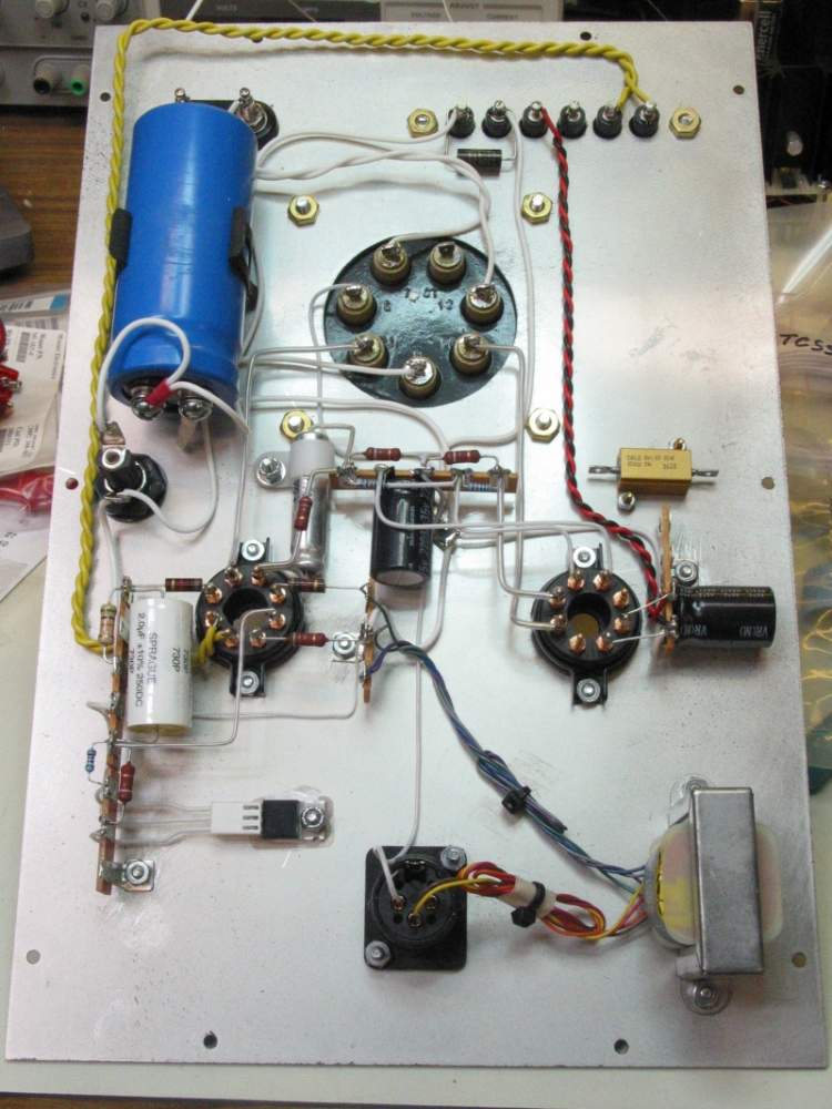

Hi Michael Koster !Michael Koster said:here's how it's wired
Im se one gold ( R ) do for what ?
So nice work sir !
What speaker setup with this amplifier ?
In the preliminary 'where does this go!!' stages...they'll be patched up to the chassis with twisted and braided wiring. Note the heater wiring is NOT on the PCB....!
