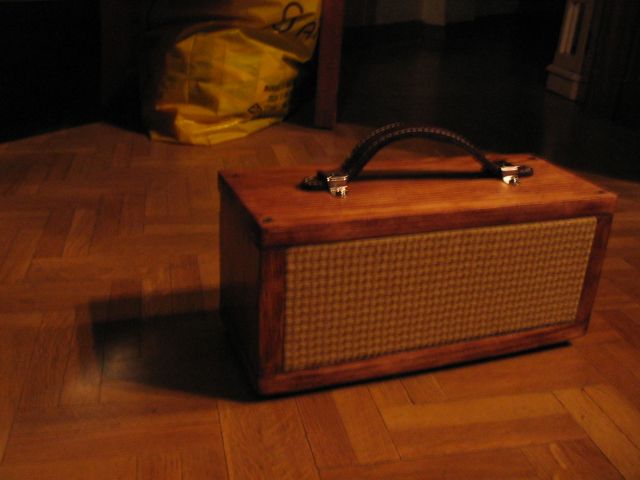

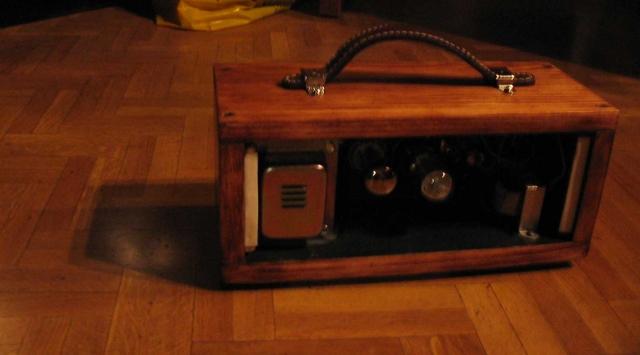

Hey... it's not a push pull, it is stereo - so one KT66 for each channel. The KT66s are triode strapped and simple cathode follower outputs. As for the need, most headphone amps either use parallel small triodes or an output tube of some sort. I figured whatever sound gain you would get from the small triodes is null once you have to parallel two or more sections to get the output drive. So, I just went for looks as well as sound quality. Plus, I already had the transformer and it was big enough to drive them. I also wanted to keep my circuit very simple, unlike most I've seen at headwize and other places.
Parts salvaged from the PC supply is wire, lots of free wire, a few PS electrolytics and yes I kept the case switch and AC receptacle. It also had a primitive noise filter on the AC line which I left in place. If I had it to do over, I'd use a larger chassis! I didn't realize at the time how large my output caps where going to be! I should have, I just didn't "turn on the brain" first.

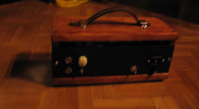

As for the back, it doesn't look nearly as nice as the front, there are all the holes for mounting the supply in the pc and the large fan hole. I simply cut a piece of thin aluminum and filled that in and placed the RCAs on it. Nothing fancy, not impressive, but then again, I don't plan on looking at the back!
Sound quality is amazing, very cool to unplug phones from my CD/iPod/computer and then add the headphone amp in between... same source, but so much better sound out of the headphones!

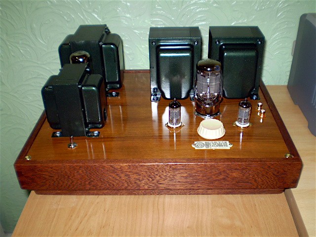

Here's a pic of my latest creation
It's a single-ended triode amplifier using a 6336A driven by two stages of 5687.
The surround is made from 2.5" x 0.5' mahogany baseboard box jointed and treated with four coats of Danish oil.
Top plate is the undamaged underside of a lid from my Mother-in-Law's old 1956 Ferguson console, that had been rotting in her garage for the last thirty-five years. Said top plate is made of 0.75" plywood faced with walnut veneer and french polished.
Knob and radio apparatus license plate are from the same console.
Transformer and choke set are Hammond, sprayed with dark metallic green auto paint.
It sounds rather nice too.

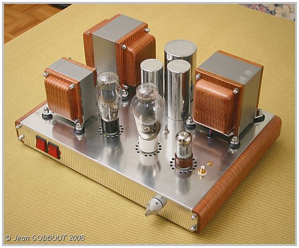

My new J.E. Labs 300B
This my first Hifi build, base on the J.E. Labs 300B discover on Derek Walton web site, great help from Derek for a newbie like me, thank Derek.
The power TX are Angela Universal and the OT are the Hammond 1627 SEA with the Hammond choke 193J. I spend about two weeks to build the transformers cover with MAKORE wood, very curly wood.
I'm very happy with the "magic" of the 300B tubes, very musical. I'm building a pair of Mileva speakers to match those low power mono block amps.

Very excellent metal work!
Please share the details how you made those tranny covers and the chassis.
Very, very nice work!
CNC mill if I had to guess... often thought of doing those covers.. now realy motivated to try...
