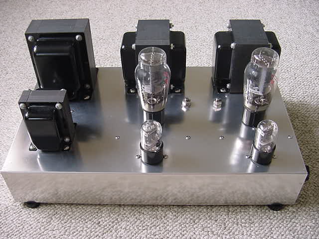

Here's my Fi Primer Loftin-White, which I built a year and a half or so ago. However, after much tweaking of circuit voltages & modding components (mostly different cathode bypasses) to get the sound just right, it's practically a different amp. Tried several 5AR4's, but fred diodes are better sounding IMO, in this circuit. All transformers are custom Electra-Print, all tubes are Sovtek. This amp now really kicks out a clean, tight uncolored sound that seemingly defies its 3W rating.

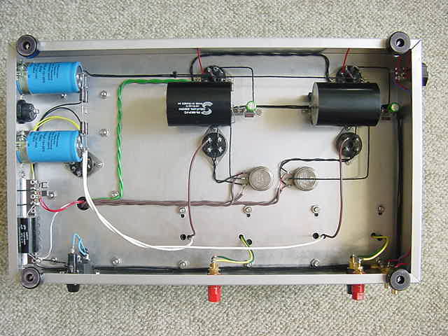

Quite a contrast in circuit topology, I'd say!
Most of the circuit is hidden by the big bypass caps, which is little more than a few resistors.

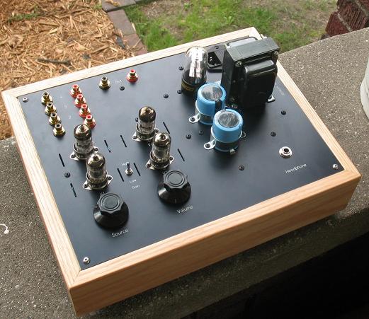

kstagger: it looks a lot like my Bottlehead pre-amp ... very nice.
Is it possible to see a parts list, schematic or similar? 😕

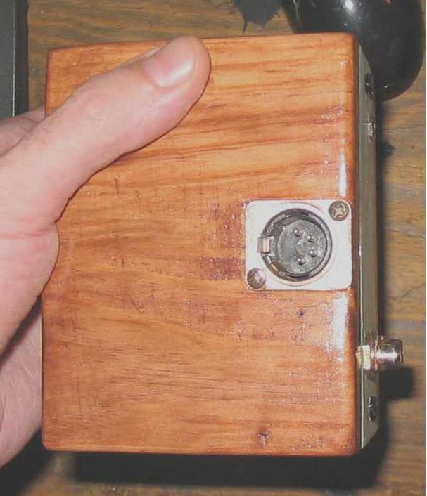

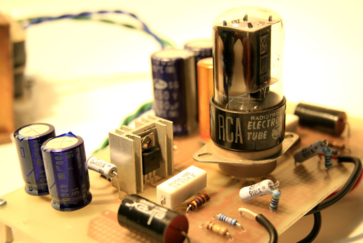

My headphone amp
Not fully tubes... the tubes serve as voltage gain only, the output buffer is MOSFETs based.

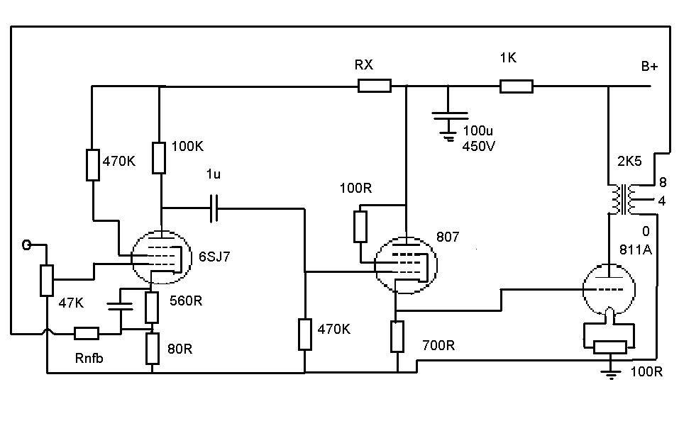

This amplifier is meant to run with KR-Audio's T100 tubes but due to delay in the production of these tubes I am for the moment using 842VHD. The input stage is 12B4 and a triode strapped EL84 is driving an interstage transformer. The IS transformers (bifilar) are from Sowter, output transformers from Hashimoto. The power supply is separate and together with the 842VHD I am using a 500V PS. (For T100 I will increase the B+ to ~750V)
I have tested the bandwidth and transient response: BW: 10-75kHz (-3dB) and a quite nice square wave at 20kHz:
Under the conditions I am running the amp now, max Po is 7W, Zo=1.5R and the distortion is 1.2% 2HD, 0.15% 3HD, at 0.6dB below max Po.
Schematic for the T100:

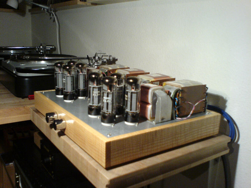

Here is a picture of my parallel single ended el34.
It is based on a design by Andrea Ciuffoli:
http://www.audiodesignguide.com/my/el34_pse/el34pse.html
Its got lots of power and sounds terrific. I worked a fair bit on the layout to eliminate any hum. It is dead silent when at max. volume. I also used larger value caps and hexfred rectification in the power supply...
It is grid biased and i am using cv4004 and cv4003 military triods, as well as two closely matched mullard XF-4 quads from 1977. Rectification is ss as I didn't have any more room in the chassis...

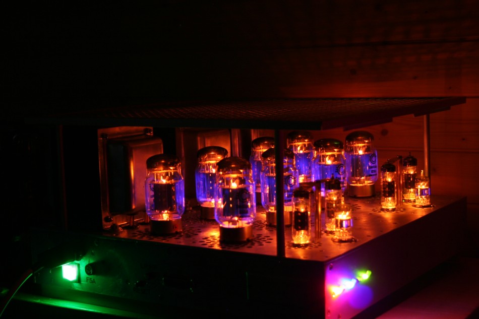

Soulmerchant,
Asking, not criticising. Do you have any heat problems with the EL34s that close together? I am using 6L6GCs that way and found the temperature between them on the chassis up to 70 degrees - heats up the chassis considerably. I had to drill holes in the form of a cross and mount a small computer-type fan underneath each foursome.
Please advise of your experiences.
Thanks.
Thanks.
