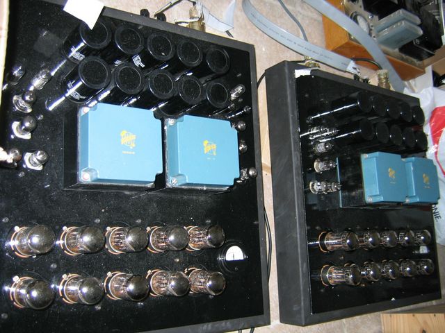

My GM70 SET project
This is the pthotos of my monoblock GM70 SET amp project. Named by NoyMark. Sound is fantastic.
http://img158.imageshack.us/my.php?image=dsc08345bz4.jpg
http://img158.imageshack.us/my.php?image=alooooe4.jpg
And it looks very cool too...as a majority of what i have seen here ...no matter wich country come for.
