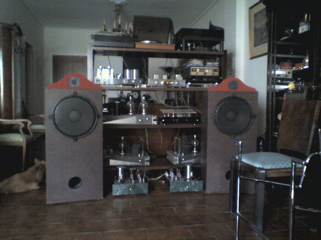

tube system

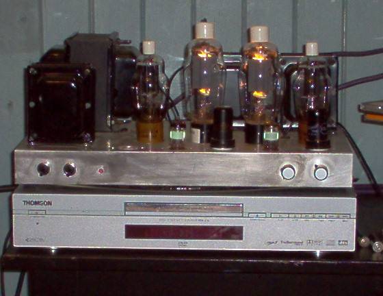

A strange system with vacuum tubes topologies . Preamplifier with 801 RCA tubes [15db gain], pnono stage MC [ECC83 and j fet], line preamplifier with 250TH tubes [15db gain], line preamplifier with 6J5 and 6SN7 tubes , Two power amplifiers with 250TH tubes SE A2 60 watts/ch , and two power amplifiers with 6DQ6 tubes in triode mode pp 30 Watts/ch . The loudspeakers are with Focal drivers 92db/W .

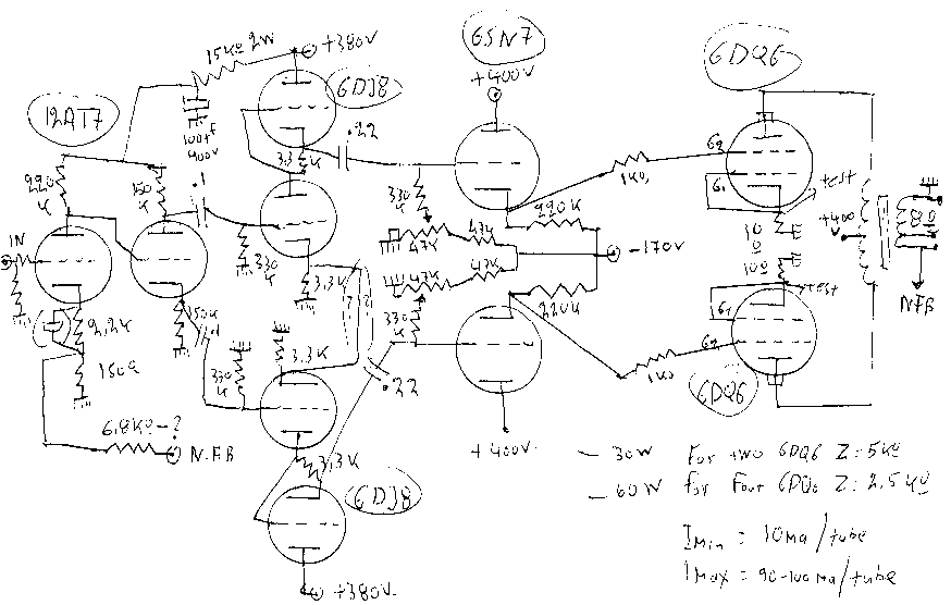

6DQ6
I`ll send a e-mail soon to you with the schematics . Gianis🙂 I have to found and scan this...
Re: tube system
The ports look on the small side for size of drivers. ?
richj
Originally posted by gianis The loudspeakers are with Focal drivers 92db/W . [/B]
