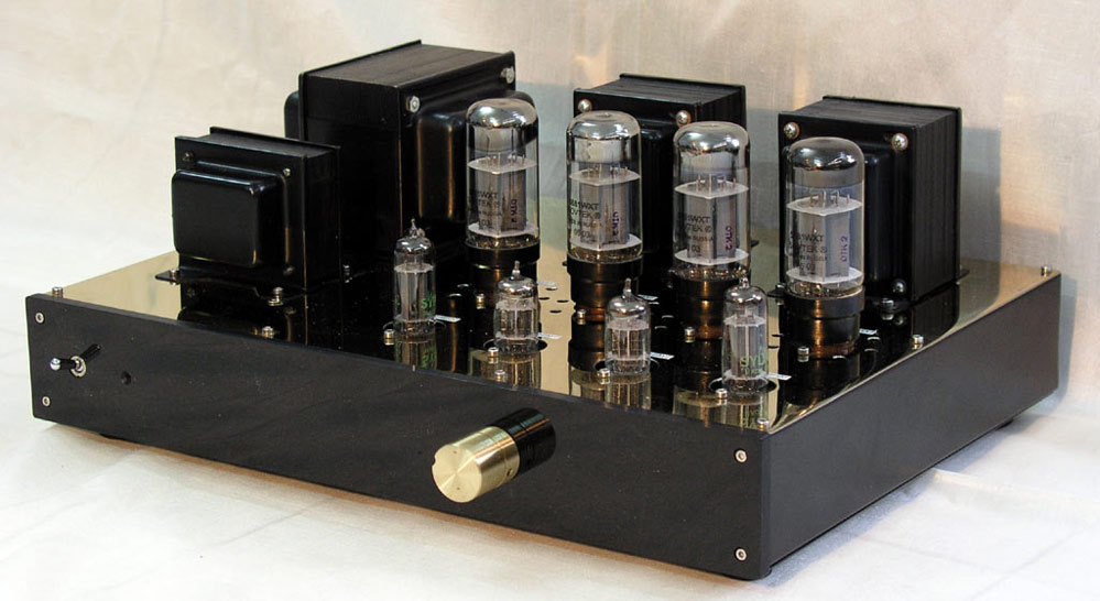

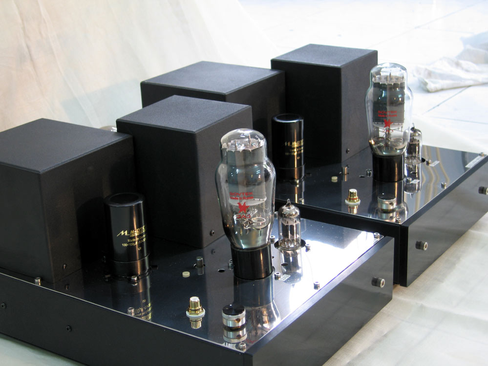

I especially like the looks of your 46SE ... Is that a kit or your own design??

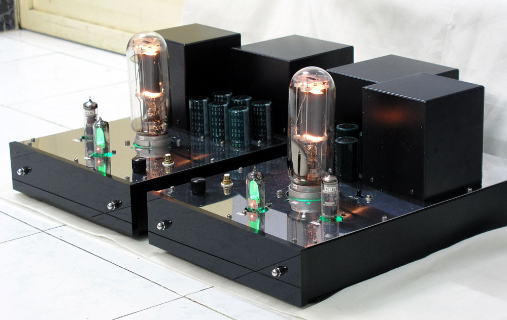

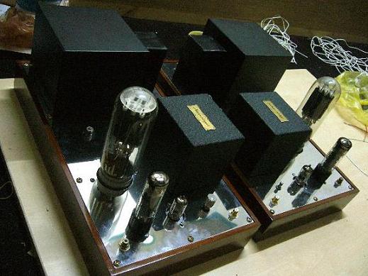

This is also quite a nice pair: 845 SE tube amp .
Which is your favorite? Which sounds the best?
I don't believe I have ever seen such a variety of interesting amp designs. Keep up the good work ...
This's not a kit .
tube 46 I bought from a friend , it cost usd40/pair
tube 12AY7 : usd 20/pair
SPU ang OPT : I wound them for a week.

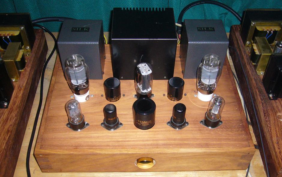

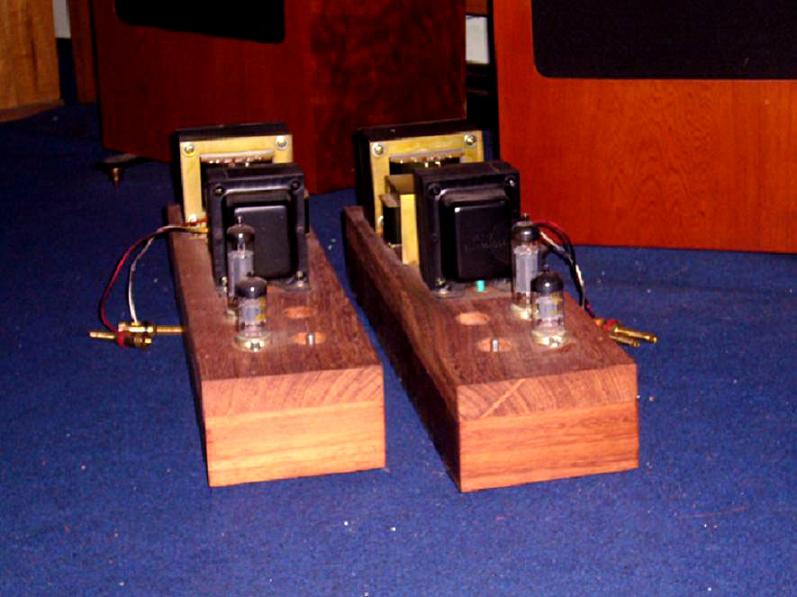

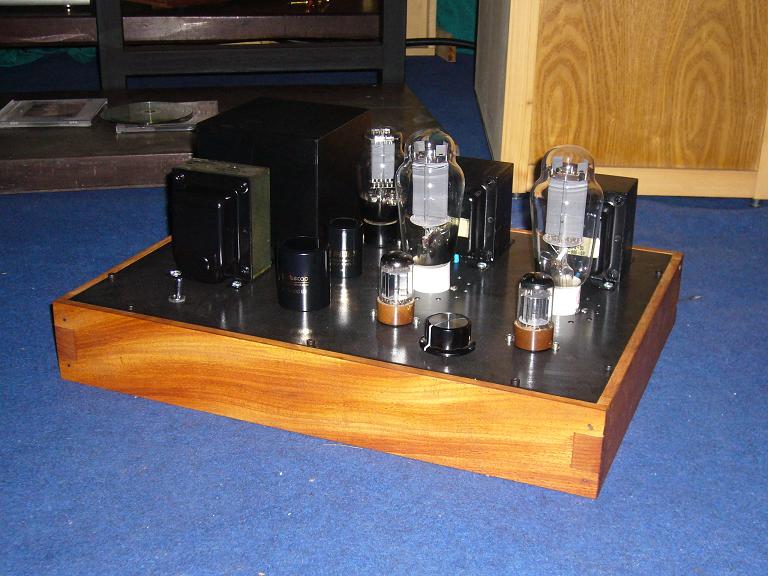

I use a BLH speakers with Fostex FE208EZ, so my choices are 46,45,2A3 .
The sound they come slowly, warm and good for relax at night .
Now, I use a pair of OPT made in China for 845 amp . I have a plan to change it with mine in near future .

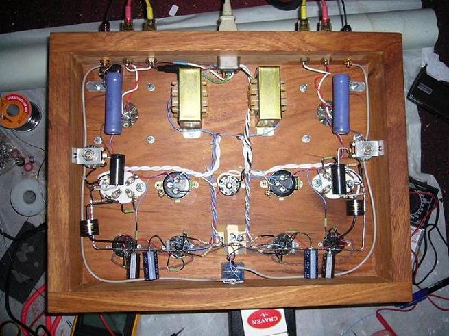

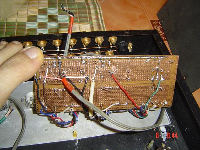

SY said:The power supply side looks like some tight work. You must have very small fingers!😉
Yes ! Iam have big glasses ! look like .... my eye !v-bro said:Whooooaaahhh hmmm!What kinda technology is behind all the loose wires and unconnected caps? Or do I need to buy glasses?!
You didn't even mind to bend the casing a bit for us?! 😱
I like the spirit! 😎
Iam do not connected capacitor because the main not ok , and find( B+) use and Iam looking whats kind number for( R)
Now its don with R = 68K>1K>22K , I don't understand befor with DC V= 370,pass R 68K and 22K its verynoise on speaker, when I put in 1K, not noise , maybe lower filter C>R>C not enough!

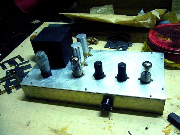

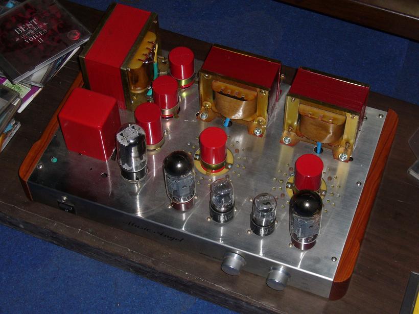

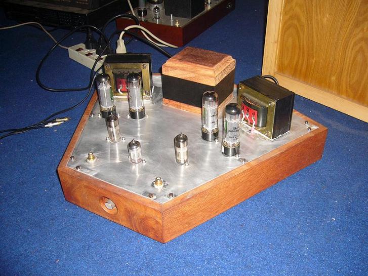

Last one is mono block EL84 - 12AT7 - EZ80 rectifier .
