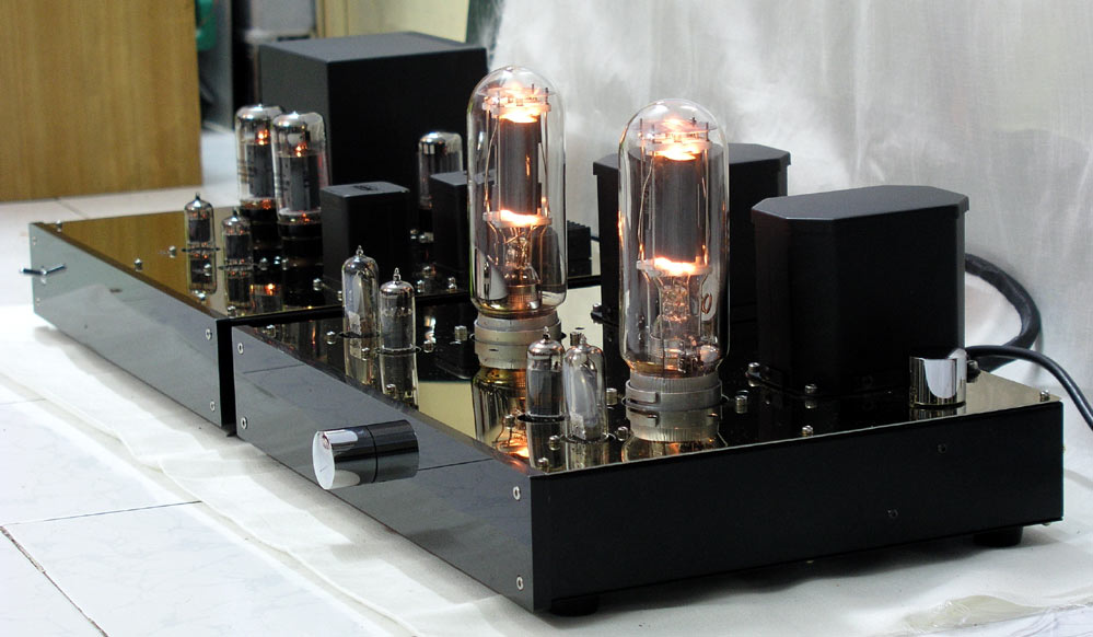

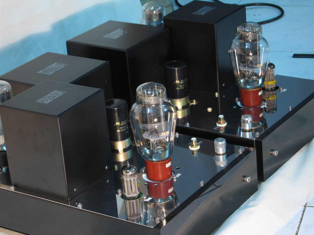

Hi FastEddy
1. That page mention MarkLevinson openning a ref in Vietnam ,not a review.
2. All project of Teablue are his designs, not kits .
teablue said:Tube Line Preamplifier with 845 , line output transformer (UTC) , 12BH7 Driver
PSU : All tube regulator

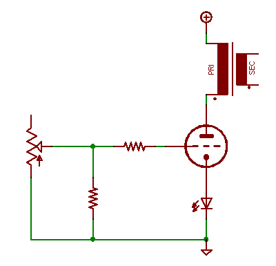

Single ended 5842 based headphone amp. All the iron is custom wound electra-print.
Hi dsavitsk,
Those are LARGE output transformers for a headphone amp...!
Would you mind sharing a schematic, or is it à la 5842 ultrapath?

The schematic is just a basic single ended amp. The only trick is that each tube is biased with a single red LED.
The whole thing is modular, so there are little circuit boards attached to the tube sockets that can be removed to use different tubes. I also have boards for the 6c45, a 5687 (both sides in parallel), 6n6p/6c30/6n1p/6dj8, and I am going to do one for the 6688 as well. So far the 5842 is my favorite by a pretty wide margin.
The boards are also made to be adaptable to an ultrapath topology, so I may try that at some point too. For now I am just enjoying it.
The transformers are spec'd at 35mA which is for the 6c45. The 5842 draws somewhat less current, but that is why they are so large. They are 5K:32R, so Grado phones only -- I have RS-1s that I love dearly.

" ... The only trick is that each tube is biased with a single red LED. ..."
!!??!! ... meaning that you have an LED in the tube signal circuit ?? ... or in the heater circuit ?? ... or somewhere else ??
Got a schemo / diagram / picture that would explain ?? (I can see how this might be a cool trick, but to what purpose other than as more blinky, blinky lights ?? 😕
Perhaps as a means to bias up a cathode with a simple, low impedance voltage source that has instantaneous recovery?

FE: Take a look at my old thread on testing 5692, "SY Gets Jiggy" or the Red Light District thread. Or better yet, go to the Ur-text and read about it in Morgan Jones's "Valve Amplifiers." It's a very slick trick.
FastEddy said:!!??!! ... meaning that you have an LED in the tube signal circuit ?? ... or in the heater circuit ?? ... or somewhere else ??
SY said:Perhaps as a means to bias up a cathode with a simple, low impedance voltage source that has instantaneous recovery?
Indeed. In fact, I learned this concept from SY. Schematic is attached.
The PS is a RCLCRCRC filter followed by a mosfet based regulator (I used one of Ron Welborne's designs as it fit in the chassis well) followed by a CRC filter for good measure.
