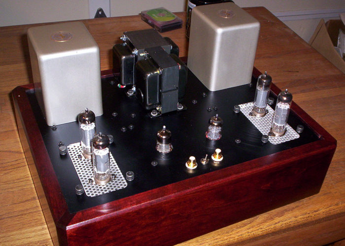

One of two monoblocks:
Transformer coupled push pull amplifier bases on KR-Audio’s 842VHD direct heated triodes and EL84 driver stage.
Schematic:
The amp gives 40W rms in class A, 60W in class AB1 and some more power when forced into class AB2.
Frequency response: <10Hz-50kHz (-3.5dB), 20Hz -20kHz (+/-0.2dB)
Distortion: at 40W: 0.12% 2HD, 0.12% 3HD, at 55W: 0.3% 2HD, 0.3% 3HD.
Output impedance: 0.9 ohm, DF: 9

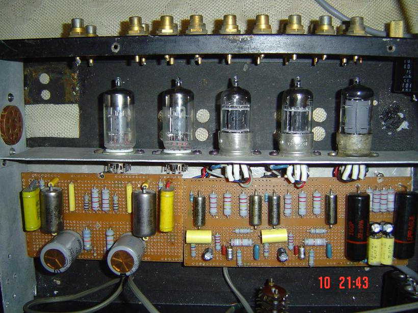

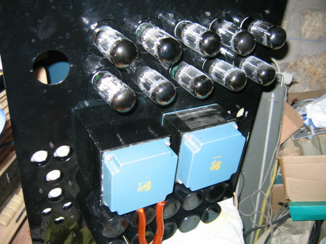

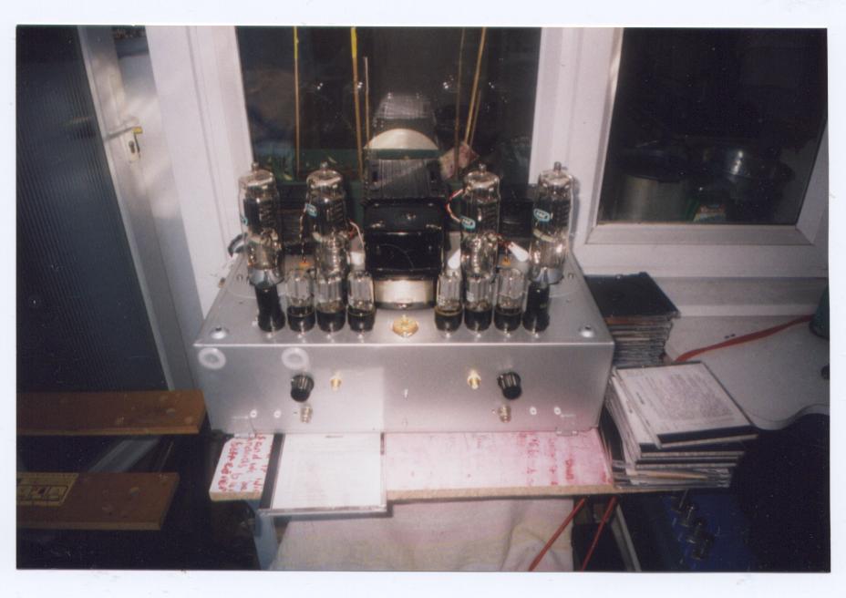

Nice looking amp Jan, looks a lot better than my amps, still I don't have to please a wife! Do you? I've never come across these output valves before! Is that a bias meter I see? What does it sound like and what speakers do you use with it? Can't get over how gorgeous it looks you must have spent a fortune on the transformers and chassis!!. I've put another one of my amps on. Using CV57's P/P about 500v. I couldn't afford intermediate transformers so I used 4 cheap output transformers instead, which I read about in the book :-Audio Frequency Amplifier Design by GEC.
Thank you JAMESBOS!
My speakers are Klipsch RF5 and WLM Diva and yes I’ve got a wife 🙂
There is a typo in the specifications, the output impedance is too good to be true, the real value should be 2 ohm.

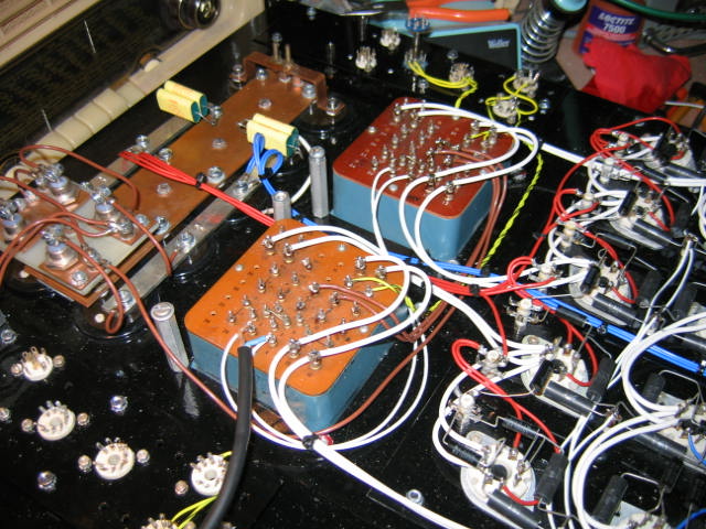

They look even better on the inside, how do you do it? Mine look like spaghetti after it been hit by a bomb or several!!! I can't afford speakers like that so had to make my own IB's, Underfloor Loaded, Transmission line and full range planar speakers, using ferrites and neo's. I also built several amps, some worked some didn't but the ones that did, Iam quite happy with and it keeps me out of trouble. Being retired (68), it keeps me busy and active. Henry.

Very nice Jan! What do you use as a control amp to drive it? How do you bias the output tubes? You did not show the PS schematic. Are you using four TV damper tubes as the PS bridge?

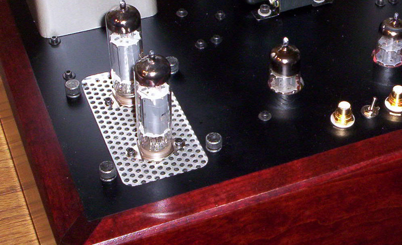

The output tube filaments look dark in your picture yet all other tubes are in glorious glow. Is this a standby mode or something?
Again very nice construction.
I'm using a preamp with a 6J5 common cathode gain stage with a 6R7 cathode follower. Since I've got ~20dB gain in the preamp I don't need high sensitivity power amps. 3V rms input for full tilt was the design target.
The output tubes are running at ~480V/80-90mA cathode bias each. You’ll find the complete schematic here: http://www.veiset.net/842/R070201.gif
The filaments in the 842s don't glow too much and most of the filament is hidden behind the plate.

That looks very nice. Where do you find the (looks like blank?) PC boards with connection posts along the edges, that you've mounted most of the components on?

>Where do you find the (looks like blank?) PC boards with connection..
You almost spelled it: Partsconnexion.com

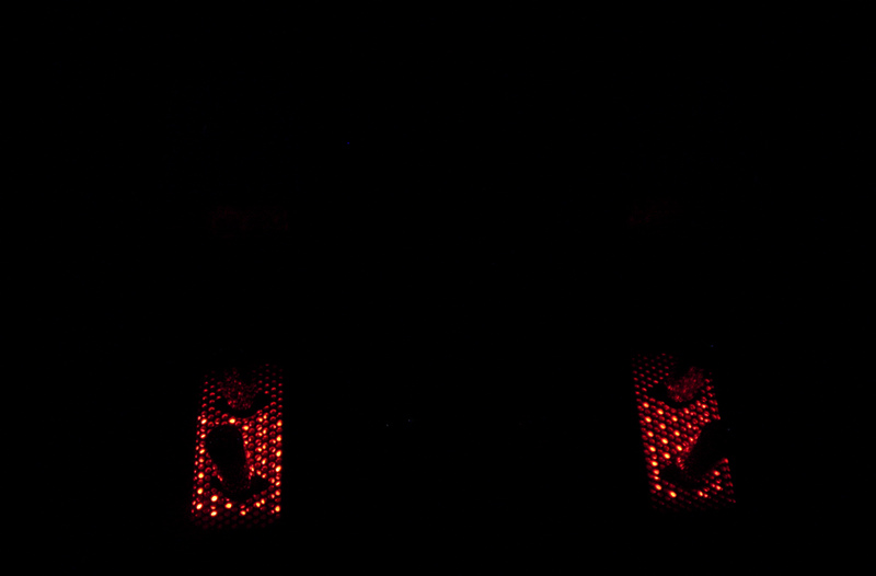

planet10 said:Now that you've posted the tease, let's see one of the whole amp...
dave
A little more. I'll try to get a shot with the lights off and no flash.
