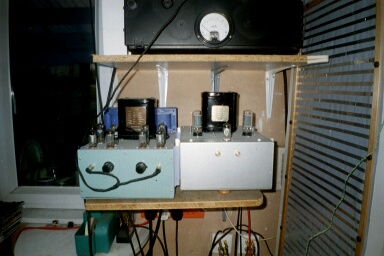

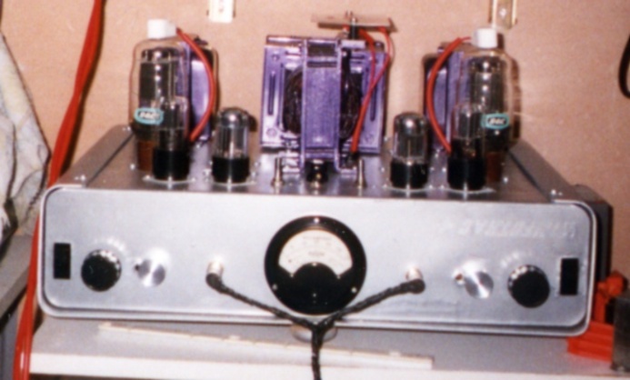

This is my da42 se amp with da42,6sl7gtand 6sn7gt. this should run at a 1000 volts at 40ma, but I only use 517 volts at 75ma, I had to use what I had. Iv'e got a dodgy bias pot so it flashes sometimes when the ma's climb. I will get round to using 1000volts at 40ma, someday!!

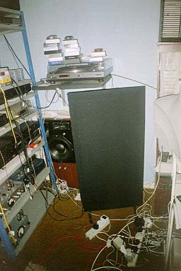

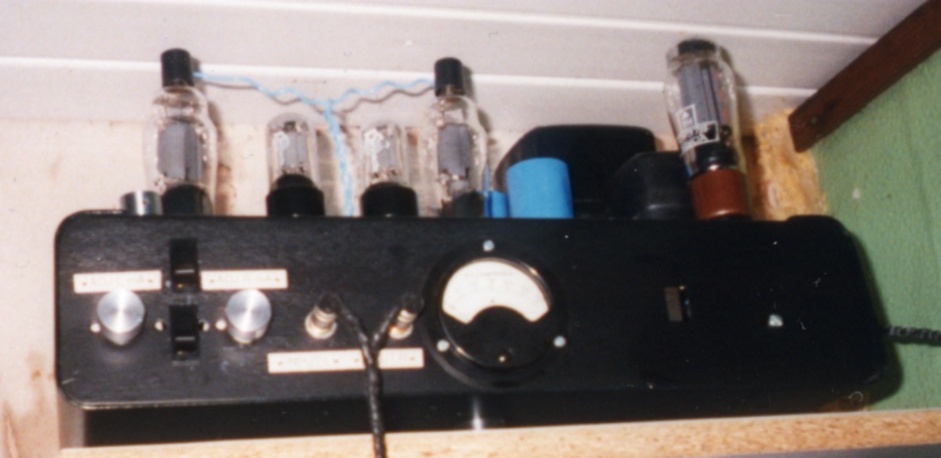

The one on the left is a p/p , using 6ch6, ef86, 5u4g and ecc82. it's in my living room now. Iam listening to it now, thro' my 2ft x 4ft planar full range speakers. Iam using a £19 dvd player, playing a mp3 on a dvd I burned myself. The Amp on the right is a se amp using only 4 valves :-2 x 6au5gt's, 1 x 5u4g and 1 x 6922. I use this with a Quad 33 pre-amp. About 5watts I think. Sounds very nice. The amp at the top is the 300a se amp.All these amps were in my conservatory, but they are all in different places now.

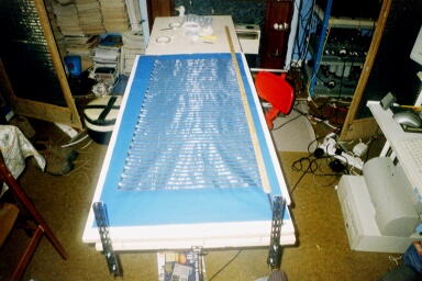

This is my medium full range planar speaker under construction in the living room! I had just finished sticking the aluminium foil on. This is the hardest part on your back, all that bending over. Rip the tape and you have to start again, very boring and time consuming. But well worth it when you switch on. Even worse with neos they are a lot smaller. I am going to build a neo speaker about the same size, about a thousand magnets for the pair, the aluminium foil will be a challenge, on my back and my patience. The old planar speakers in the background with no speaker cloth on were the first pair I ever built, after seeing an article in the Hi-Fi News about 20yrs ago.
JAMESBOS: " ... full range planar speaker under construction in the living room! ..."
Very interesting. This would make an interesting step by step DIY project we could all sink our teeth into. Got more pics?
Yes I have got some more photos just a matter of finding them, then getting them on site. Having never done this before, I'm learning as I go along. So please bear with me! This a photo of the finished speaker. Behind it to the left is my underfloor loaded speaker. Above it is a Aiwa AP2600 Direct Drive Transcription unit. On the rack is a small part of my equipment. I am not married and live on my own, so I can please myself, lucky me, nobody to nag me!!! Iam afraid you will have to rotate the picture. The photo company put on the disc that way round.
