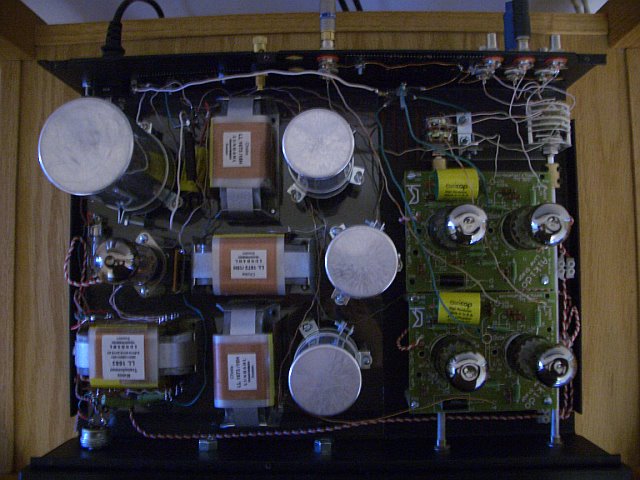

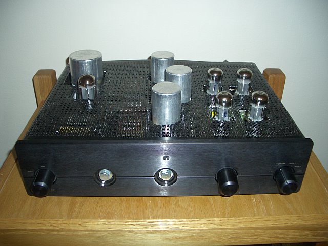

Aikido-based linestage
Here's my Aikdio-based linestage, using Bas's boards. All 6SN7s.
I mounted the boards, rectifier, and the big ASC caps on 2" ceramic standoffs, so they poke out the top. And the selector and volume pot are mounted at the back near the inputs.
I still need to make an adequate cover...right now I am just using a sheet of perforated aluminum from Home Depot. The chassis itself is cannabalized from an old Golden Tube Audio preamp...I have the original cover, but no way currently to cut the required holes in 12 gauge steel.
I'm also thinking about making a brand-new cover...and painting it dark red like the Cary Audio preamps...I love that look...

Bas Horneman said:Wow Jayme. Impressive build! How do you like the sound?
Thanks...this was my first DIY build.
The sound? Quite simply....amazing. The clarity is better than anything I've heard, and frankly I didn't know my speakers could reproduce bass that low. It's definately a reference piece in my system. The Aikido topology really does remove a lot of distortion and coloration from the linestage...
The bad thing is I now know just how poorly recorded most of my CDs are...time to finally get a turntable.
I've got AC on the heaters, with zero noise and hum.
I used teflon CAT-5 for all of the B+ and Signal wiring, other than the ground wires.

Very impressive "hardware hack" = sourcing "cannabalized" chassis and other parts. (You may eventually have some galvanic interaction between the steel chassis and your aluminum grid work ... maybe not.)

Got scimatics or wiring diagram ? Interested to see your approach to hum & noise removal.

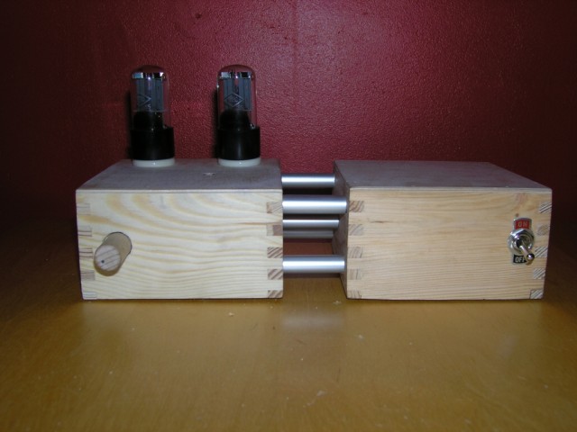

Interesting design idea. That toggle switch has to go!
How about a pair of 6ax4 octal damper tube diodes on the power supply to balance the esthetics, similar size to 6SN7.

Do you mean to get rid of the switch?
And yes, I was thinking about tube rectifiers. Actually, russian 5U4C (lat. 5c4s) are similar to 6H8C in size. I will re-think the idea. Thanks.

I think he means that it is not aesthetically pleasing.
