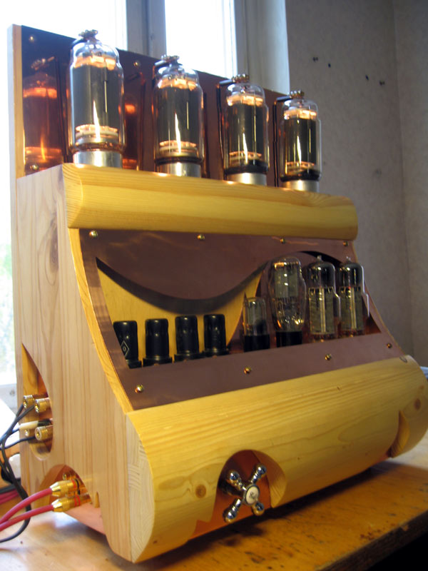

Iconostasis
Iconostasis IconMak 100W, PP, UL
Only tors, only tube rects,
russian tubes, class A,
FR 60W 5Hz-100kHz,
100W 25Hz-80kHz,
by level 0.9,
without FB, dist <1%
Other pics
http://public.fotki.com/igormak2/iconmak

I recognize GU13 and those big rectifiers..1700V/400mA.. I'm going to use both of those for one of my next projects..SE parafeed GU13...
PS..pretty unique looking amp! Congrats.

Hi, Bas.
Very close gess, that's her relative GK71, GU13 does'nt have anodes on the top, rects 5C8S. Anode V+ 1000V.

aaa yes..now I see... 🙂 but the GU13 has anode on top as well...but it is one of those big top caps.

As I remember... but could be. Anyway i heard both in SE and 71's sonic is more better. I'd recomend it to your attension.
Thanks for the tip...I'm going to check out the datasheet of the GK71.😀As I remember... but could be. Anyway i heard both in SE and 71's sonic is more better. I'd recomend it to your attension

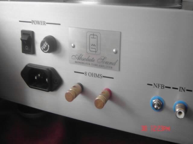

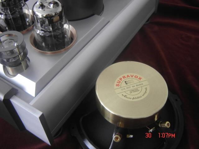

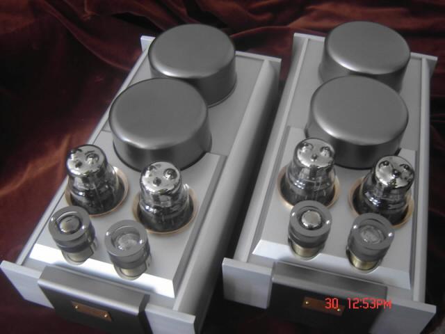

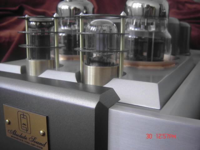

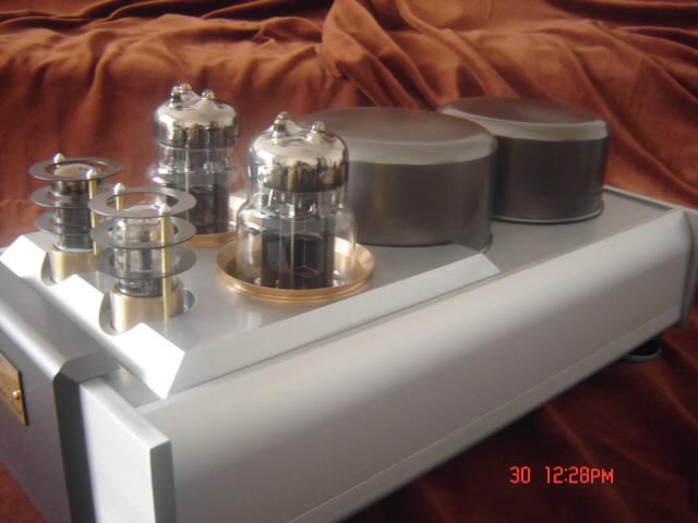

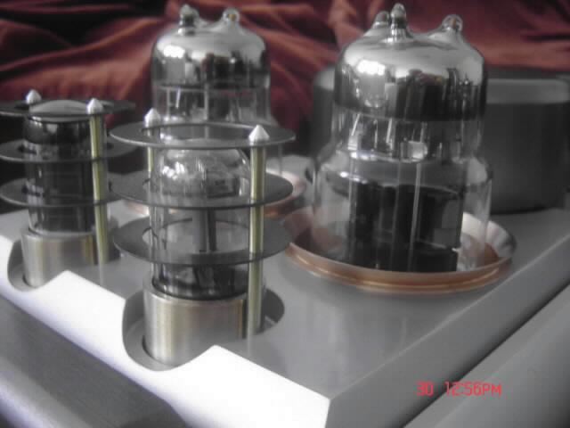

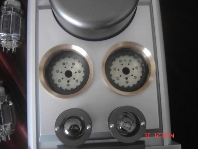

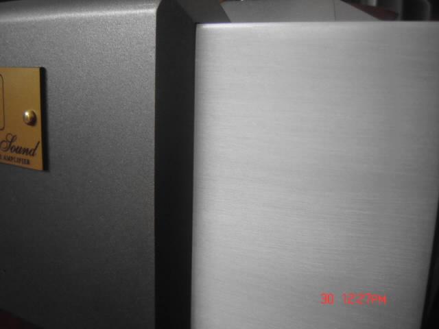

@ audiomanics
Yes .....I work a lot on these enclosures....and 90% is made by myself with my hands.
I have an 11hz-120khz responce on the output transformer on the 48W sinus(a perfect sinus...identical from the input)...also made by myself.
So ...on the 25-30W I have a very wide bandwith responce.........
All design was made to avoid seeing any screws.
The sound is different....something else.Very neutral sound....that was my target.
The tubes was 6c33c-nos-6bl7 black plate Sylvania-RCA, 6h9c-1965-nos.
