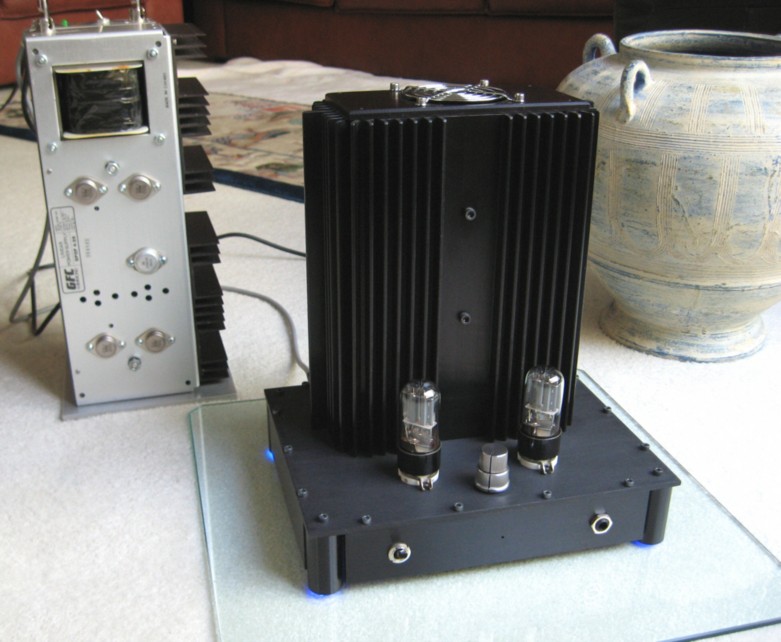

Clas A hybrid.

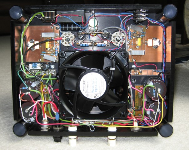

and here's the mess at the bottom. Tested a few fans DC and AC, this one is the least noise so far, a Pabst 120V running on 70V.
In the top corners are the Mos Fet source followers for the Mu stage, on a sort of surfacemount fashion. The components are siliconed to the top plate.

Aha....those blue lending legs are such cool dudes 😎miklos said:Here's my "Follower 99" type class A hybrid 6SN7 Mu stage/Hithachi Mos Fet amplifier, with a separate double 35V 6A regulated PS.
Miklos

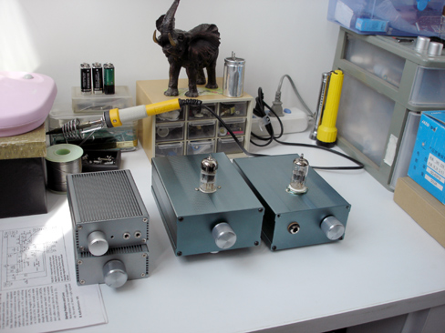

6C45 amp
This is my second 6C45 amp.
5Y3 rectifier, 6C45 single stage.
As you can see, there're PC boards😱
For convenient parts collection, it's based on a kit provided locally. I kept the boards & made some major changes on power supply & bias method & operation point. About 0.7~0.8w per channel, sounds very clean. It's serving 160Hz & up, I like it very much 😀
