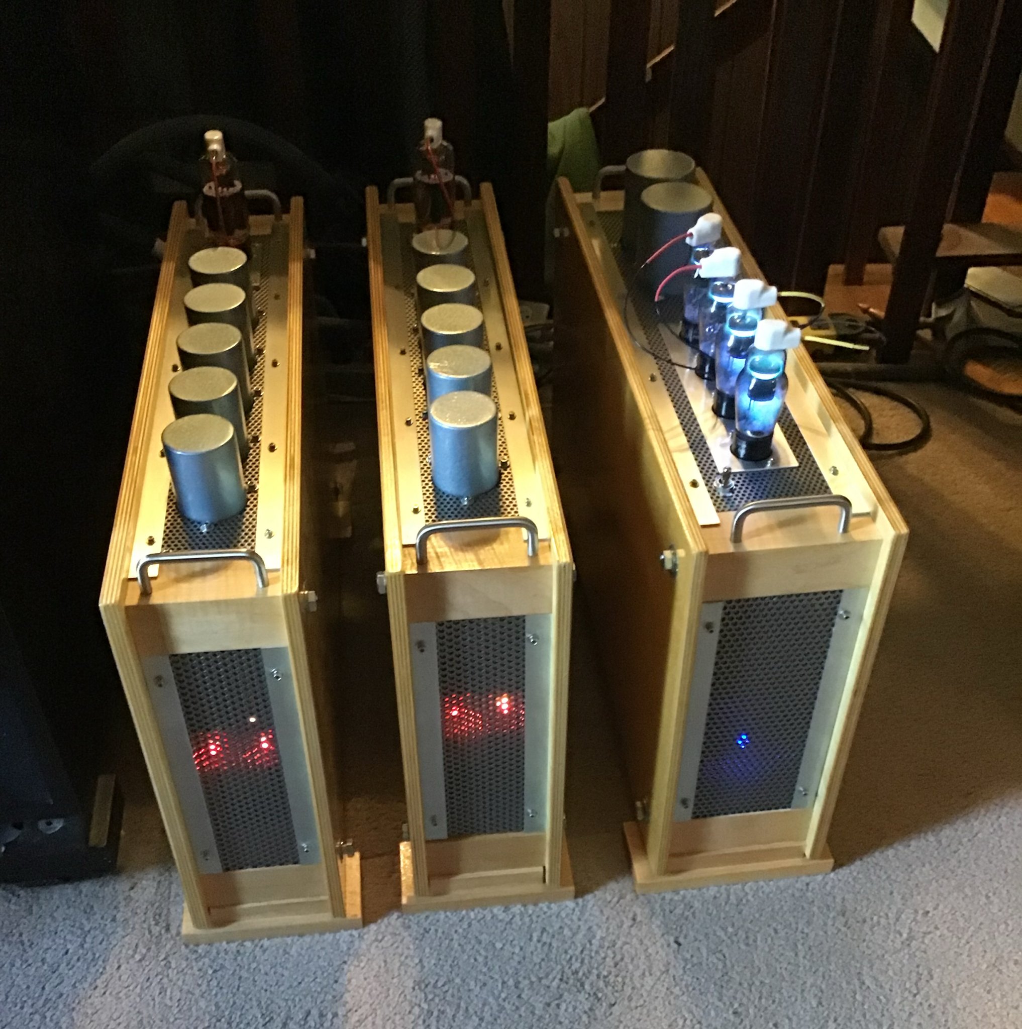

(😡 I had written a novel about the duckie, pilot light and the next project when the Silverfox collapsed, se here we go again.)
The Yellow Duck bought from an on-line toy shop for adults. It is a 😏 to enthusiasts spending more on "sound-enhancing" stuff than on amps, speakers and records. This yellow sound-enhancing is a Quackti, muffled and properly ball-gagged to keep unwanted noise out.
I love lights, so stuffing leds underneath a tube is always cool. A red or orange led enhance the lights emitted from the read-hot chili pepp ... heaters, I mean. A big and green pilot light isn't as bad as a BIG BLUE pilot light, which is what I woudl normally prefer - "blått är flott" (Swedish expression meaning "blue is fancy"). And that brings me to my next project ...
This one has been a shelf-warmer (also from a Swedish expression about stuff that stays (too) long time on the shelf, mostly referred to as stuff in shops), though safely stored under my bed. I is supposed to become a battery-operated 12B4A SE-amp. I found a HV DC/DC SMPS on eBay that will run un 12V and supply like 270V to the tubes (12B4A + 12AT7). The design is a mystery. Looking at the components I guess it may be based on a Darling and probably picked up on a Darling site showing how to double the OP power by replacing the 1626 with a 12B4A.
I have a 40Ah 12V lead battery to power this one.
The pilot light is a 10mm BLUE led.😎

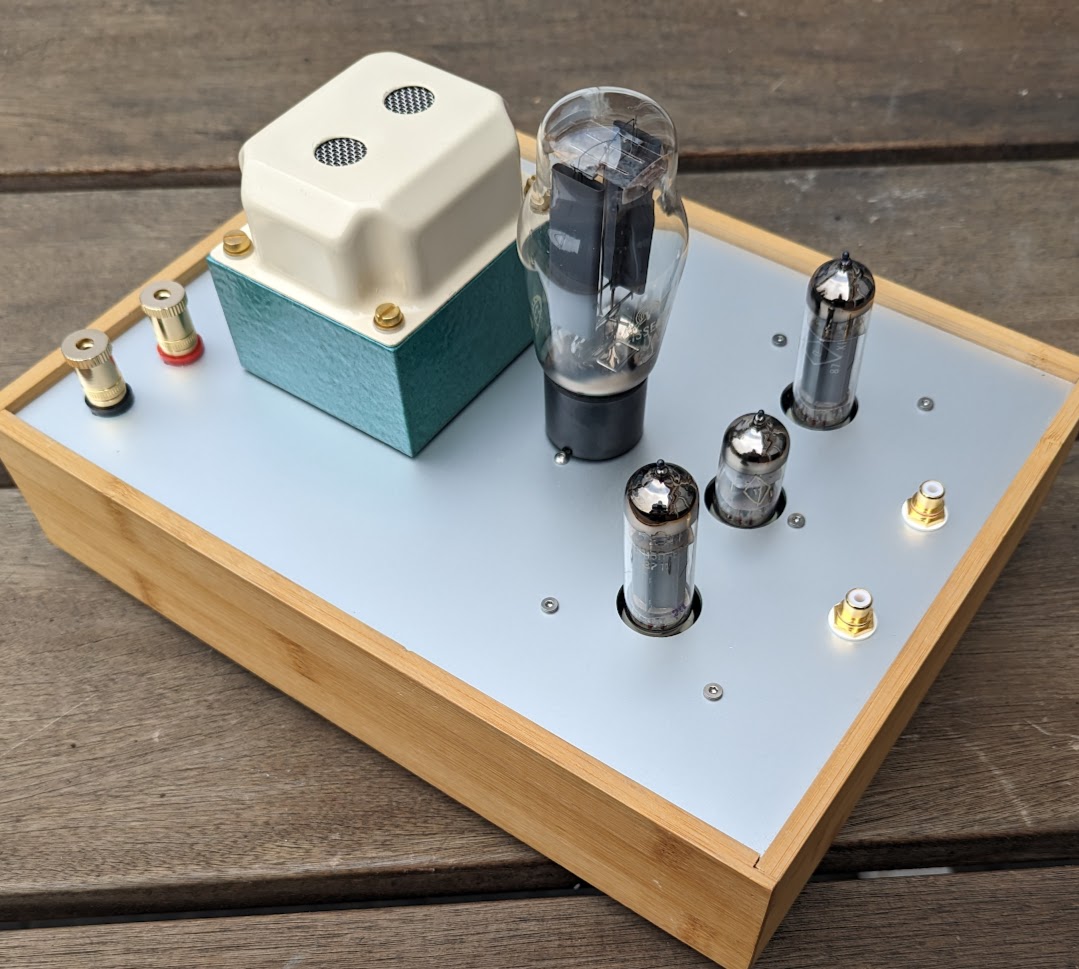

Have but one major opinion (apart from "looks good"). You have a toggle switch to switch between the two inputs on the LH amp - I'd deffunittly picked a rotary switch just because .... knobs for rotary switches ARE COOL!

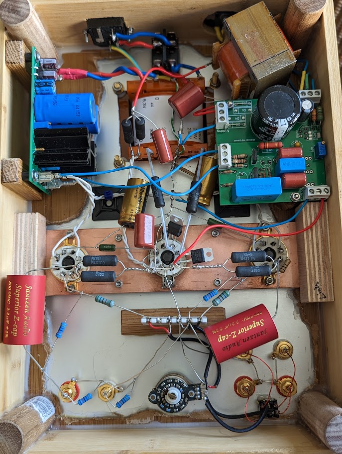

I just got a qustion from Martha Greenbrook in Little Vallyhill, Sweden: How are the tubes mounted? Du you have a PCB or a subchassi?

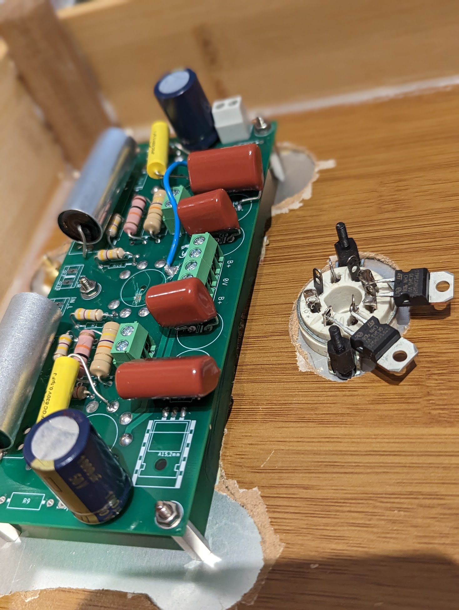

In the zen clone the tubes are mounted on a pcb. And on the Salas 6v6 on a subchassis.
