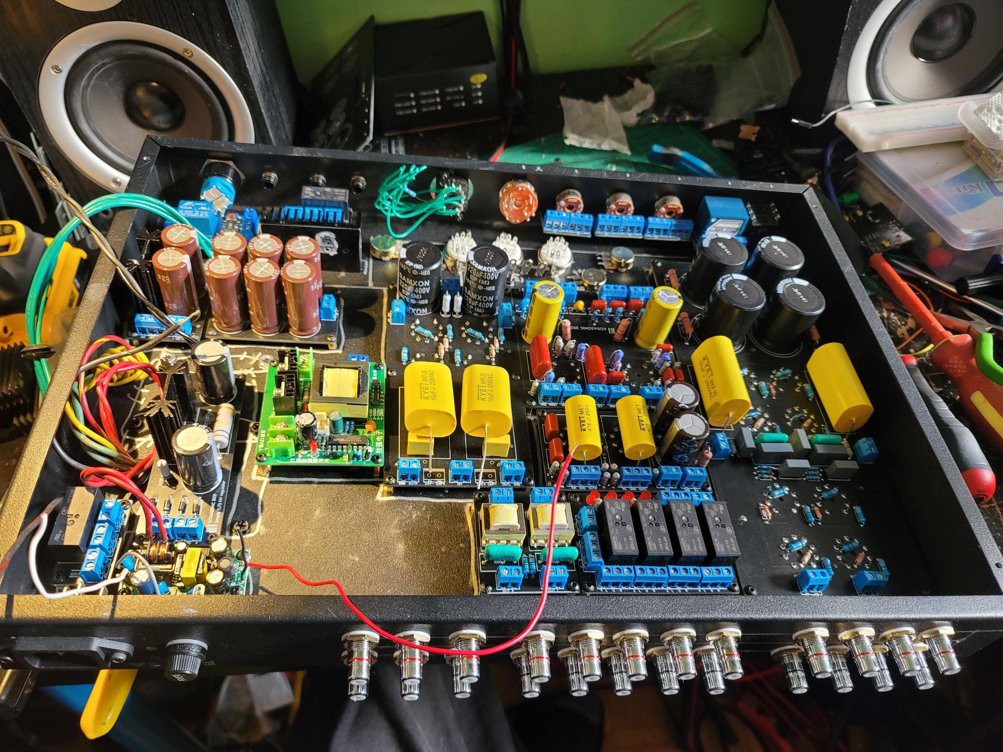

Looks very nice; I wonder about the dual transformer board close to the back panel. If these are audio input/output transformers, what is the manufacturer and part number? I also see a RC network on the transformer - any details about it?It's starting to look more like a preamp now... 😀
Now while I wait for the ADC to get here, I can start the wiring of the rest of the thing...
They are Triad TY-250P and I used them as isolation to break ground loops when running amplifiers on other branch circuits.
The RC network is a Zobel 1k5||1000pF - makes 10kHz square waves square and kills ringing.

Thanks a lot! It seems like these transformers are dirt cheap and I could use them in my projects, I hope that they don't get too much THD on lower frequencies.They are Triad TY-250P and I used them as isolation to break ground loops when running amplifiers on other branch circuits.
They are good.
I should say the Zobel is 1k5 in series with 1000pF, not parallel with it. The transformer is driven by a 6N14P cathode follower (Zout ~600R).
Nice. It's good to know since I'm partial to transformer-balanced connections and could surely use some inspiration to make it work good. At the moment I'm going with TeKaDe 114932 transformers, but they get some nasty distortion below 200Hz at line levels (looks like core saturation) and I'll want to replace them with something better.
