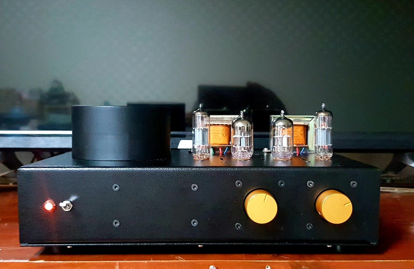

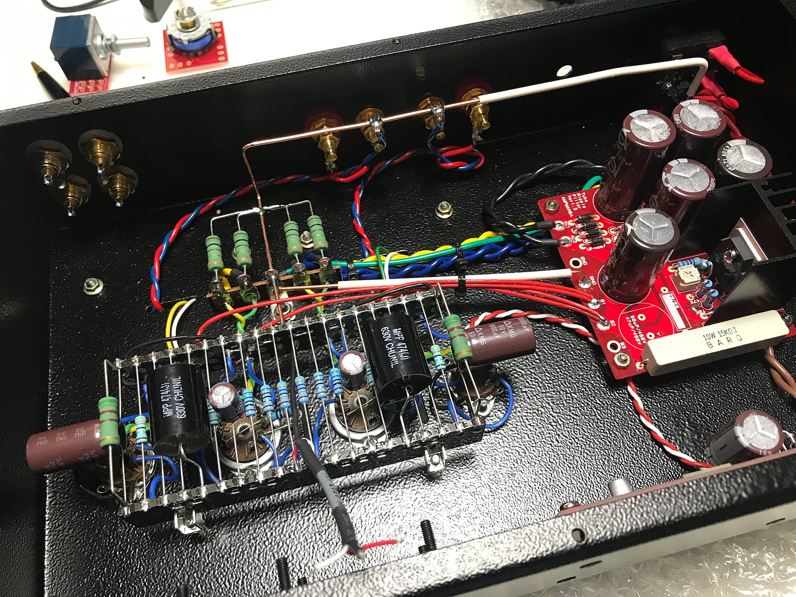

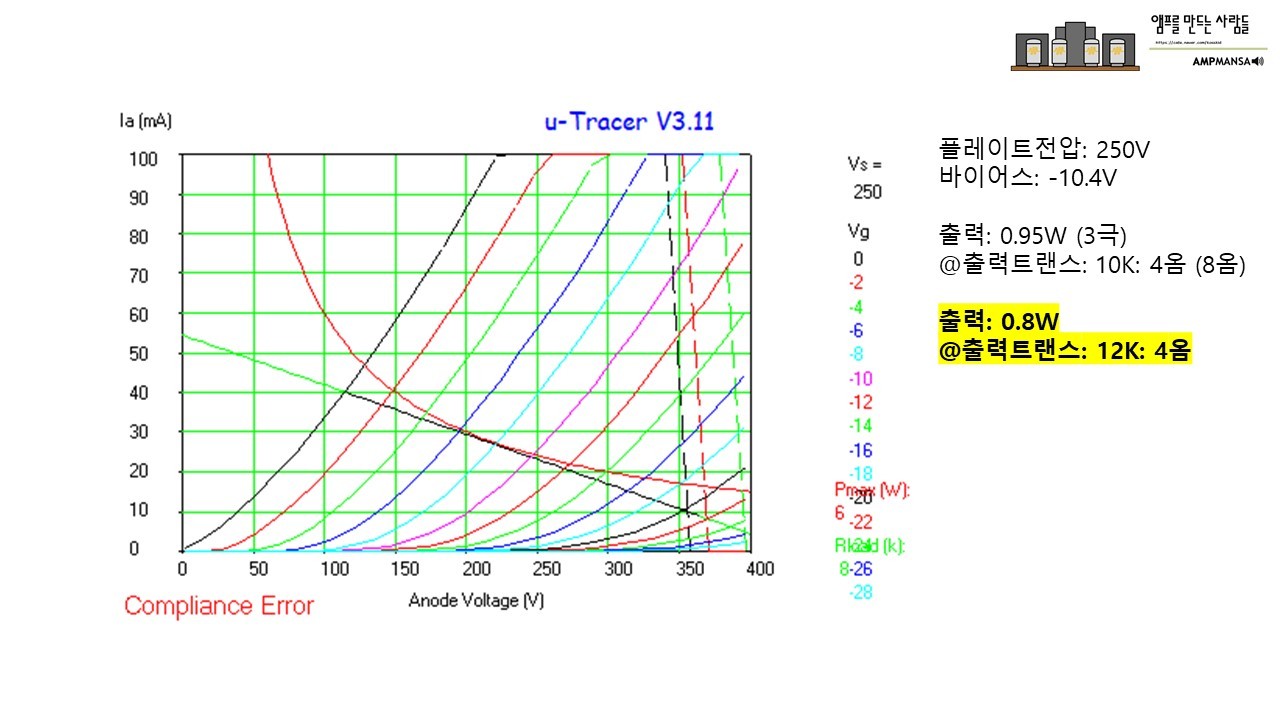

Compact Desktop Tube Amplifier: EL95SE

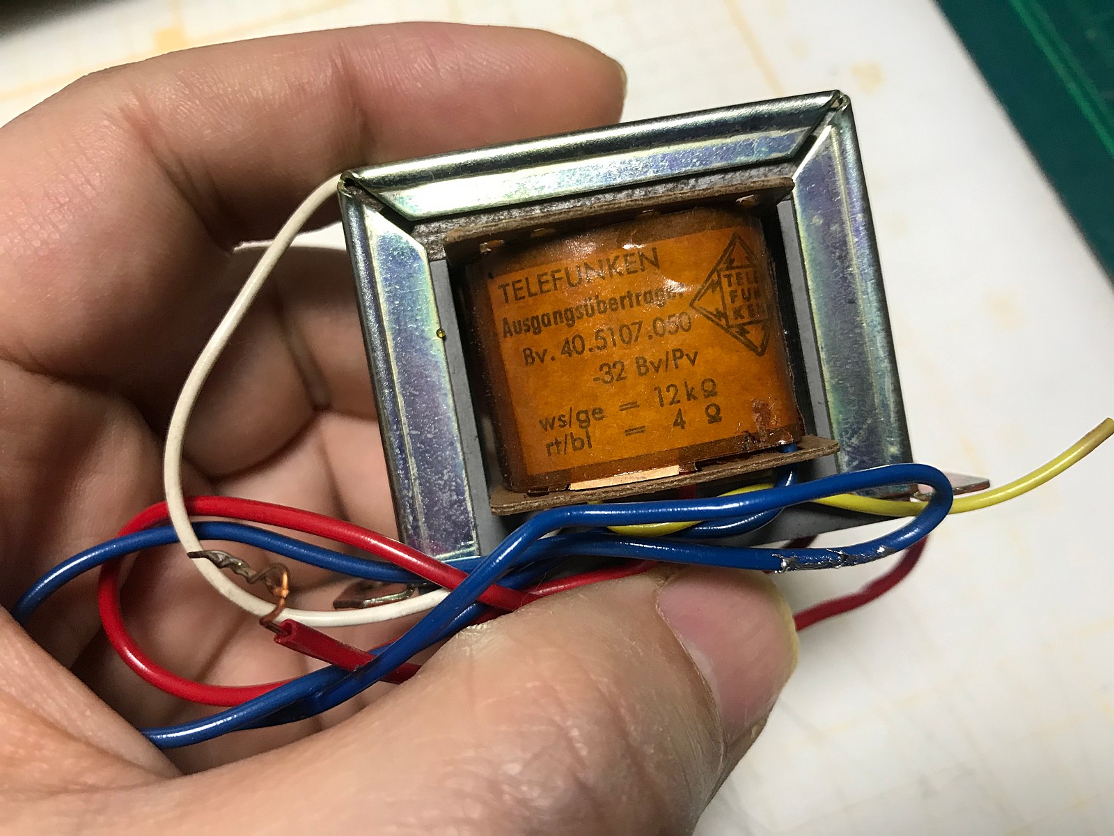

I've built a small output EL95SE amp that can be used on a desk. For the first stage, Russian 6n23p (SRPP) was used, the output tube was Philips EL95 (Triode Connection), and the output transformer used a Telefunken vintage product.
https://audio-diyer.github.io/assets/images/EL95SE_PRJ1_113.jpg

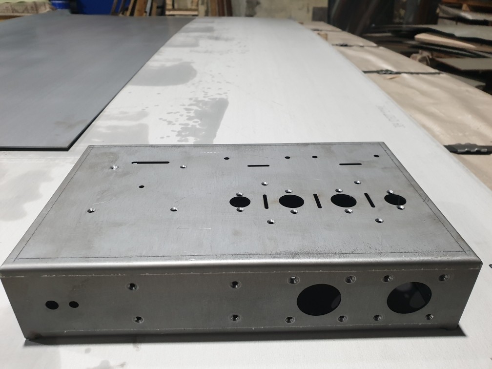

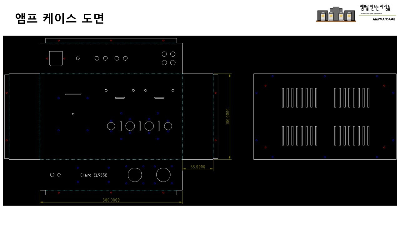

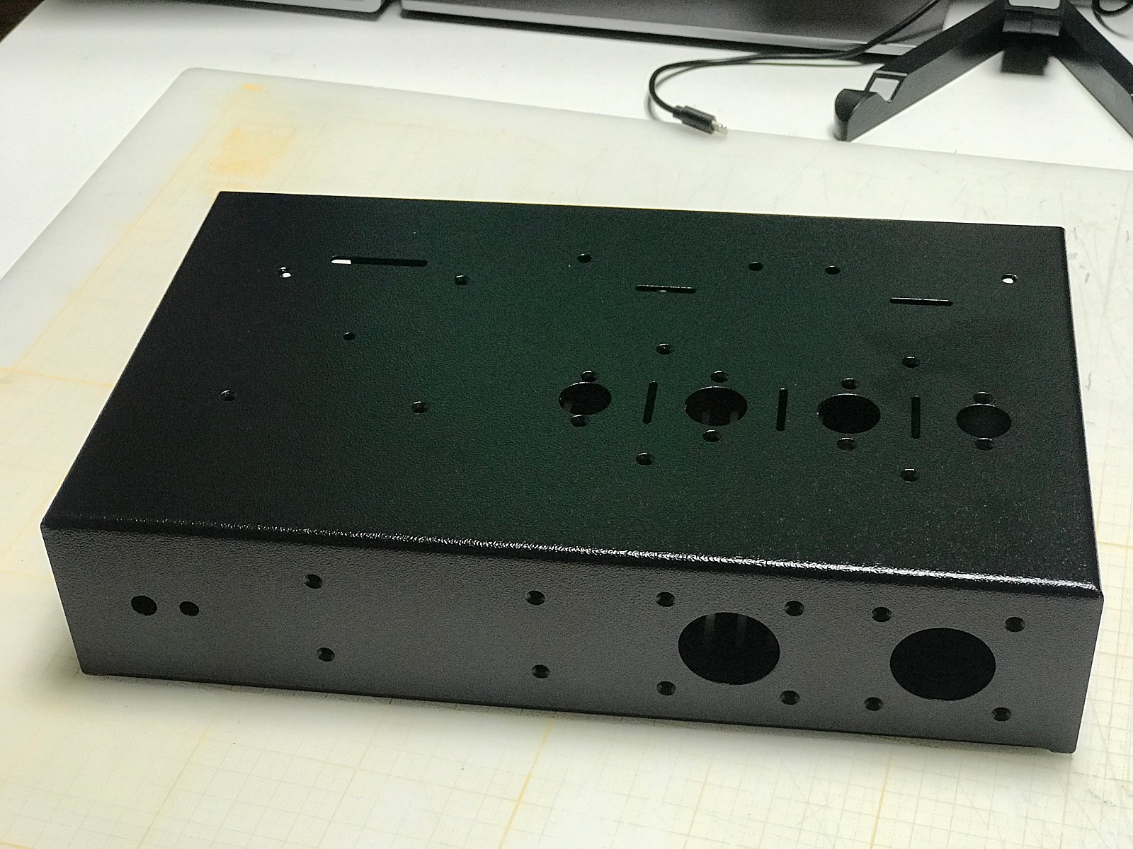

I designed using CAD SW and outsourced it. It's called powder coating, but I don't know if it's an accurate expression in English.

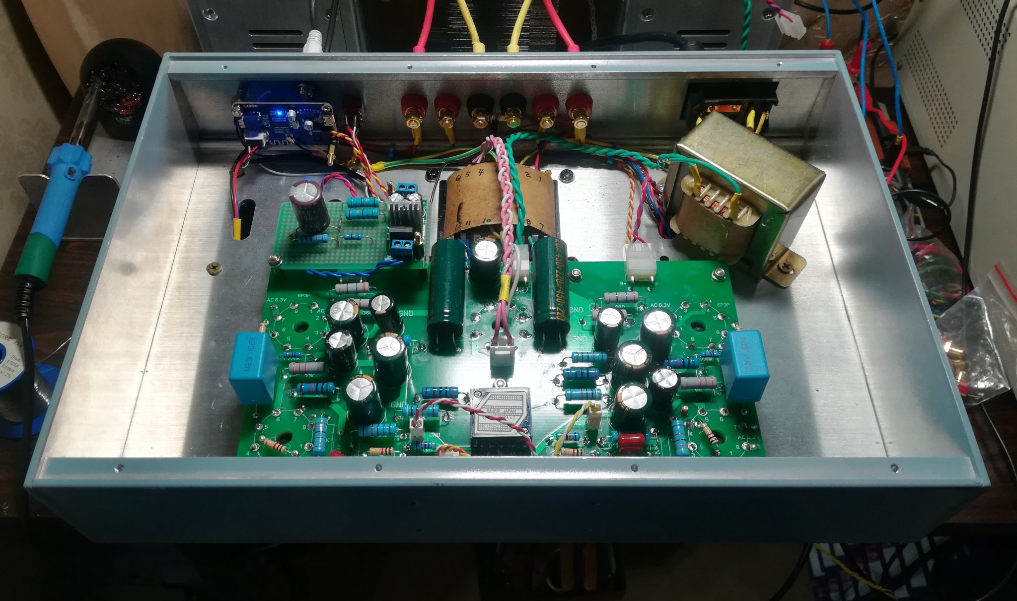

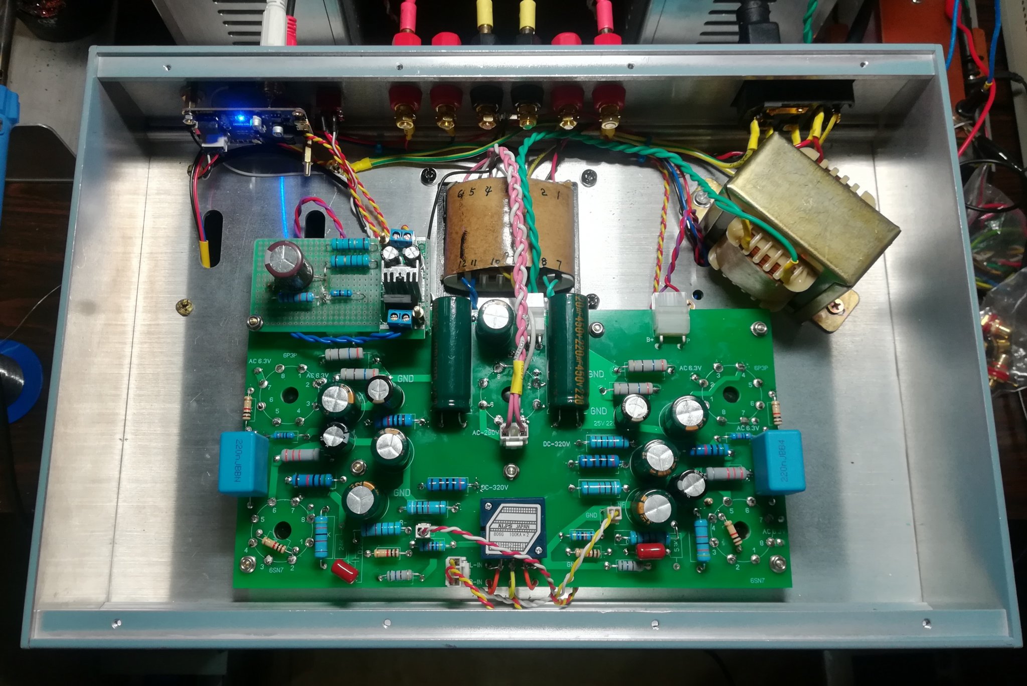

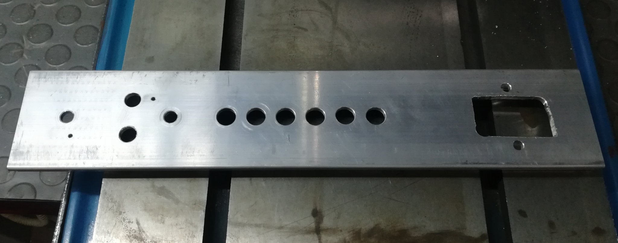

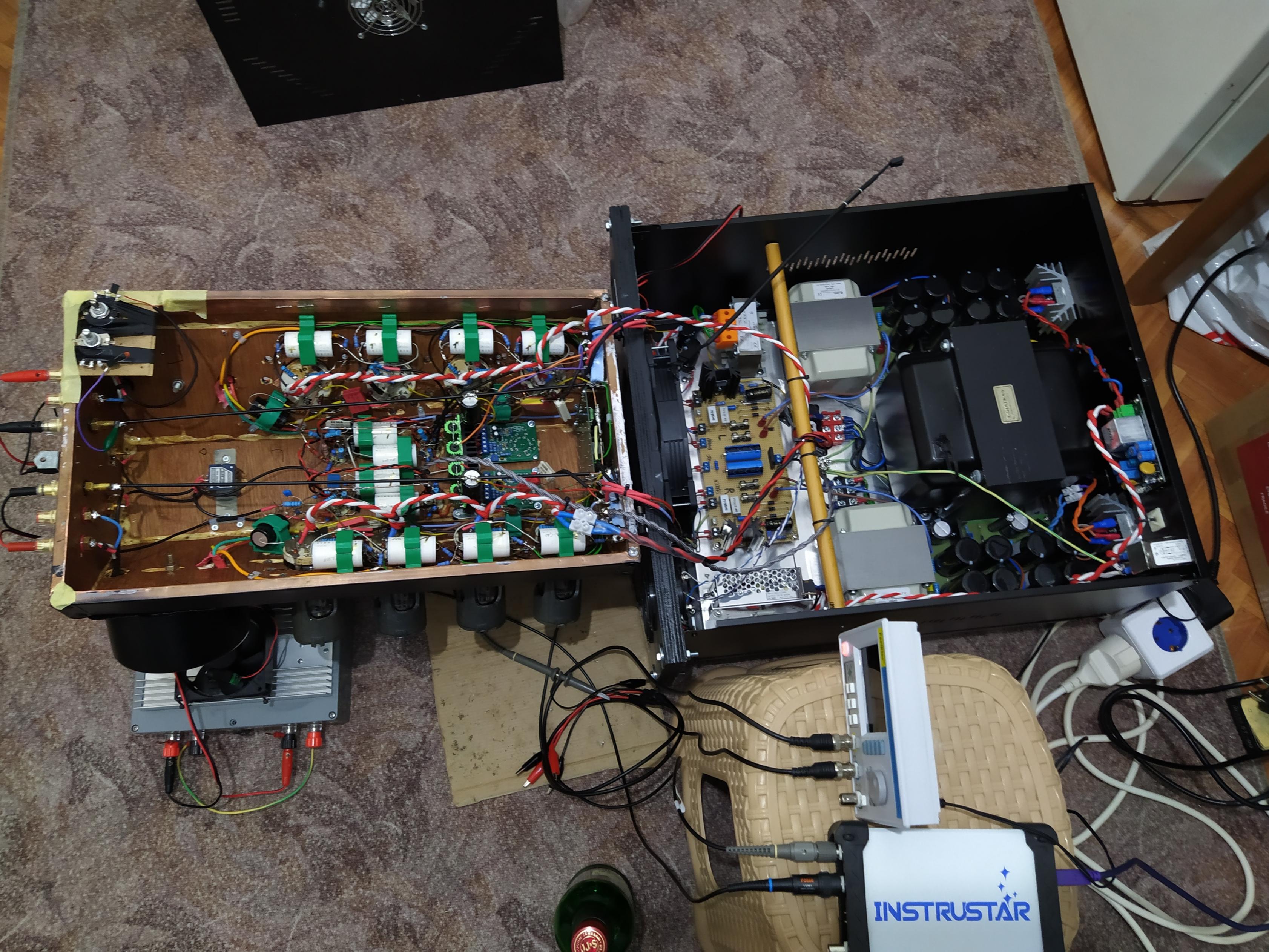

New boards for Priboj tube amplifier with OT GU50 PP , work in progress 😉
Regards, Alex mm
Very nice, I am interested for PCBs.
You have got it right - "powder coating" is the correct English term.
Nice work.

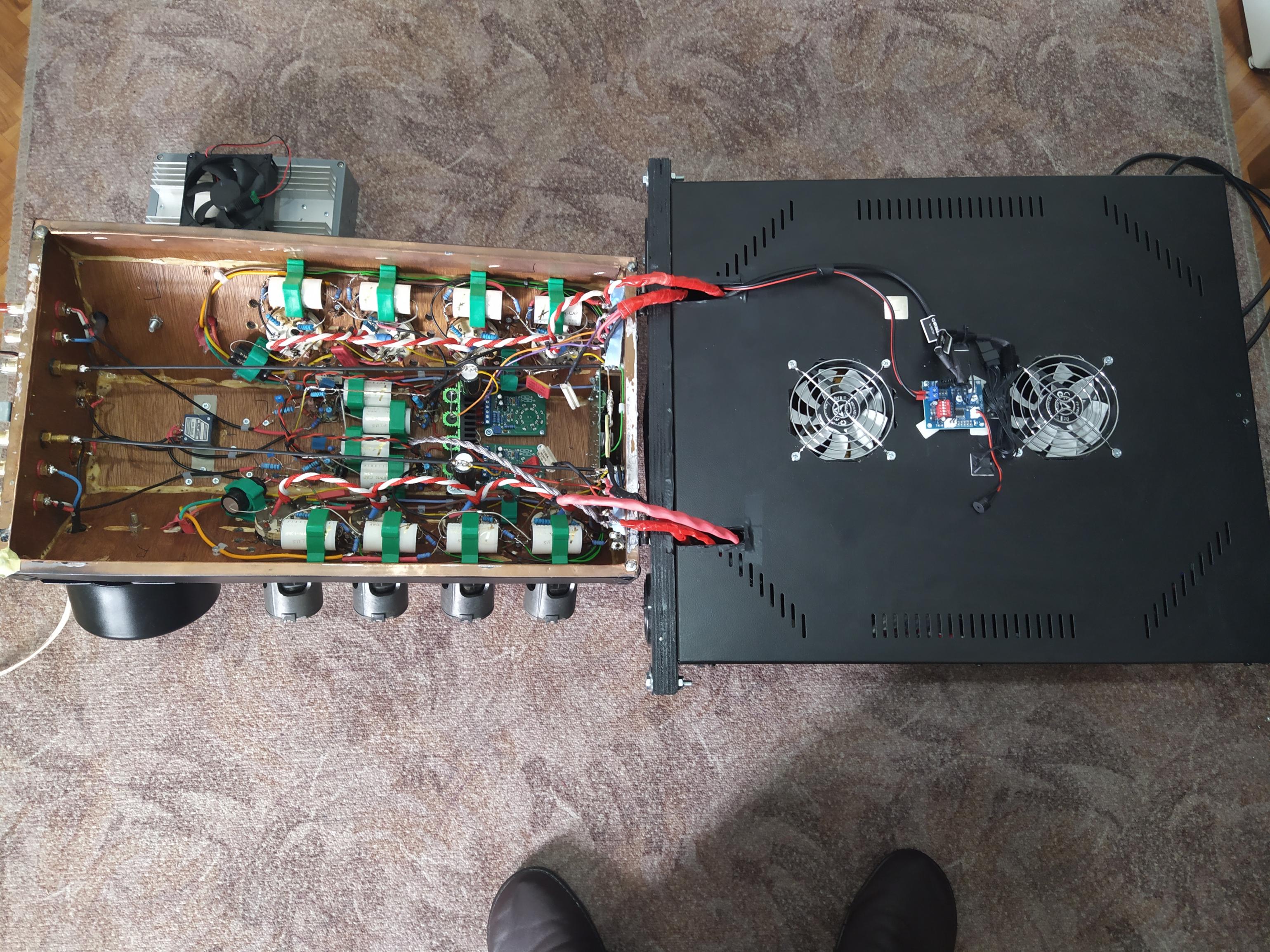

Nice shoes!
And a very nice Irish Whiskey to help the project along.

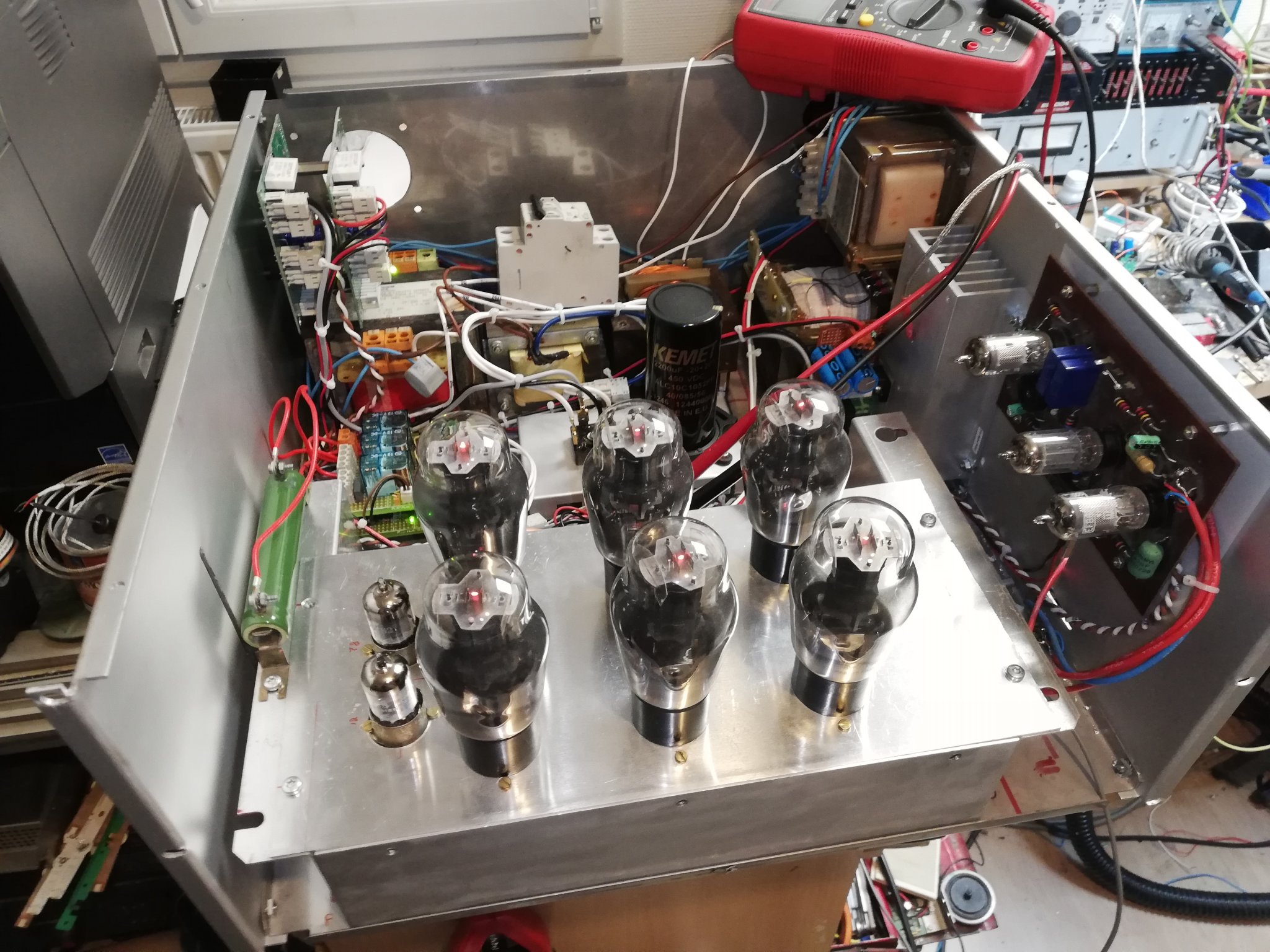

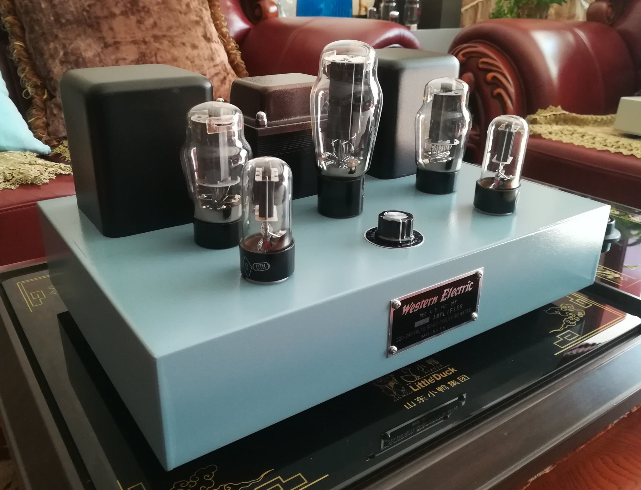

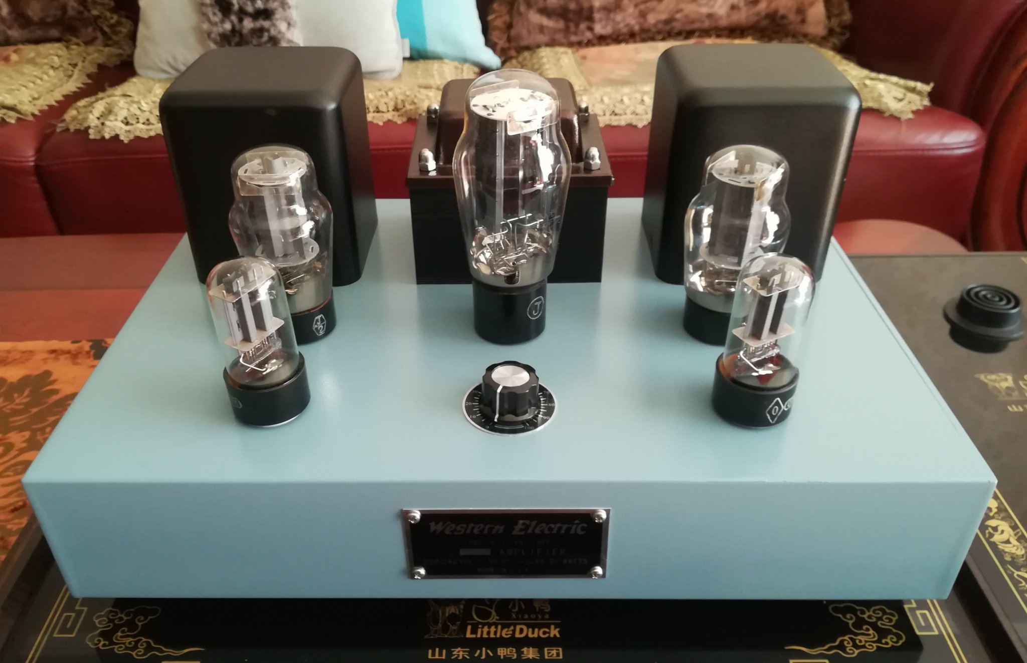

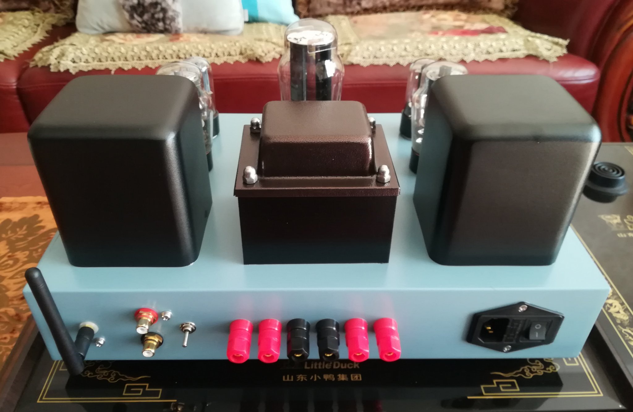

The 2A3 SE

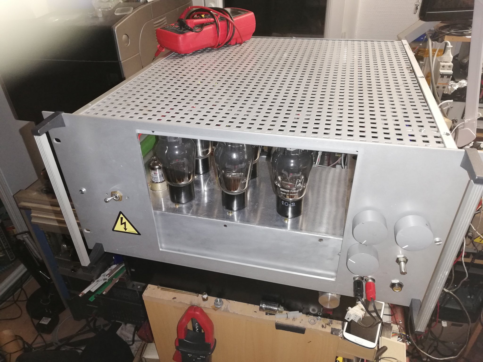

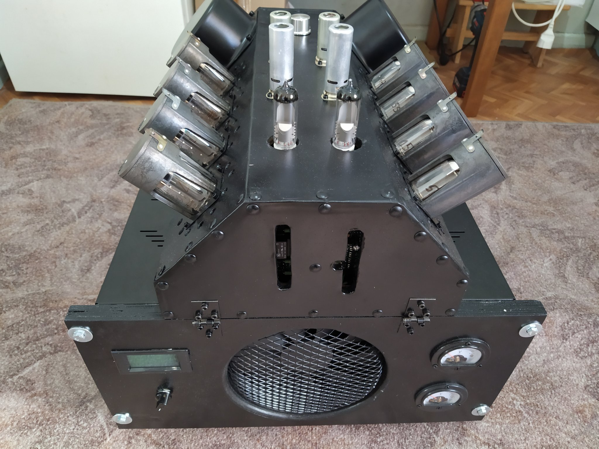

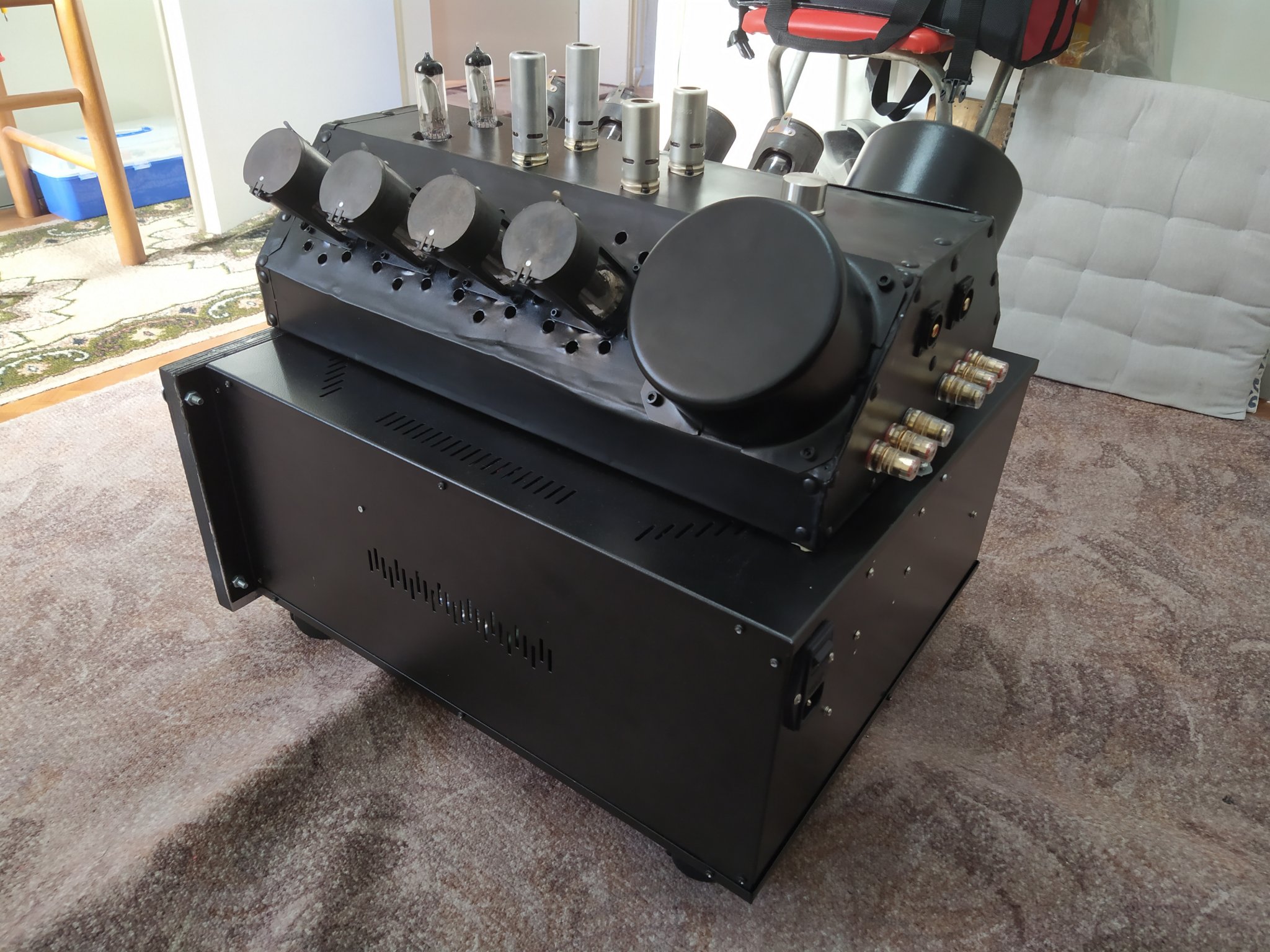

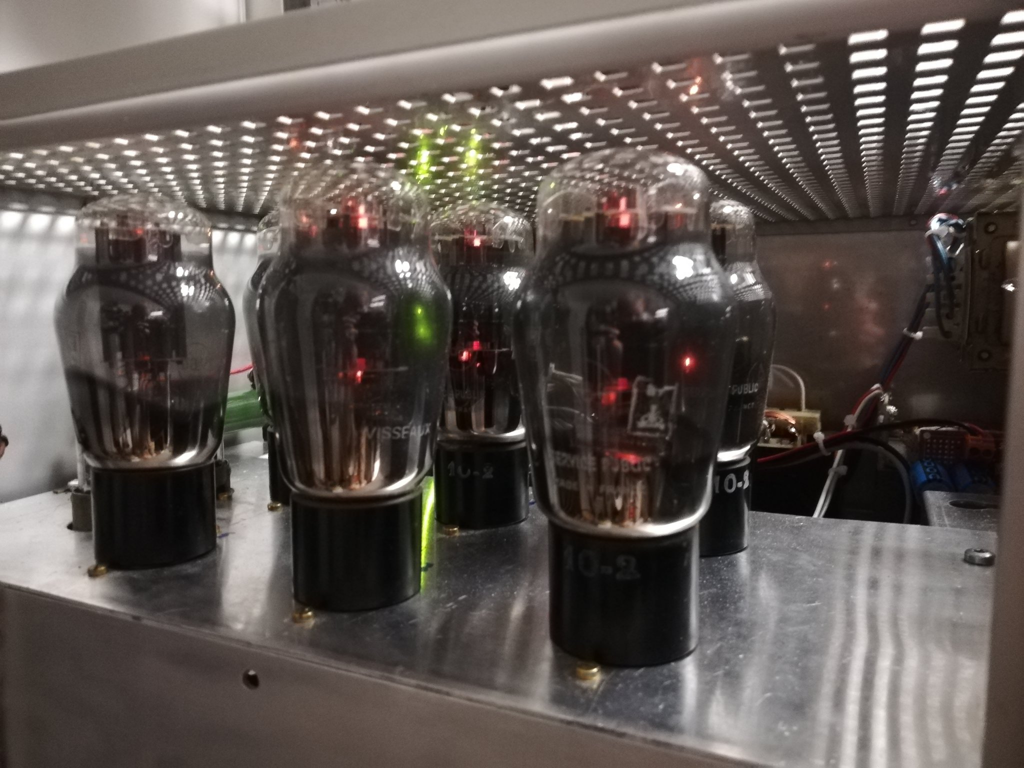

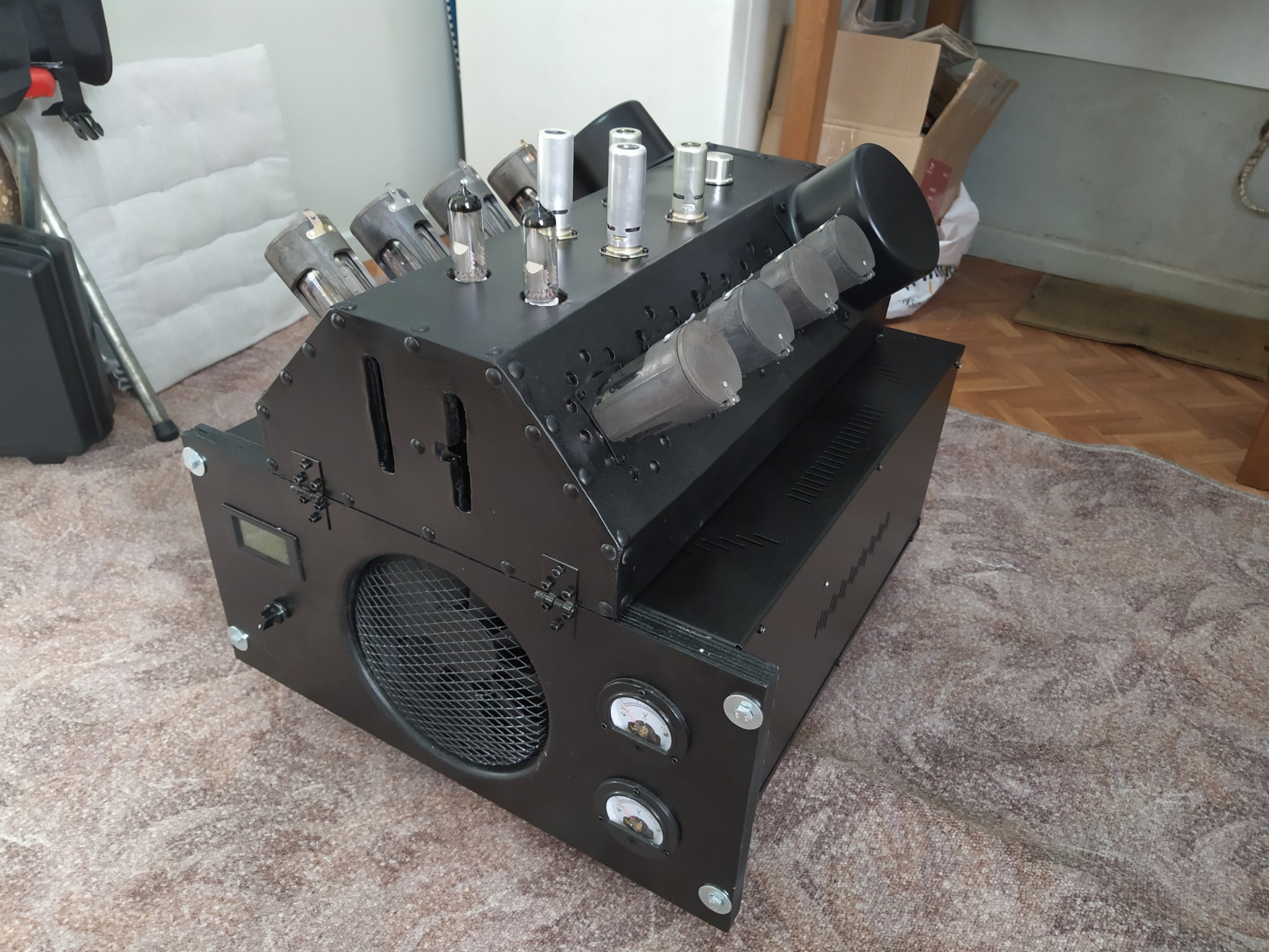

Finally my V8 GU50 PPP (aka the beast).
2x100W RMS@8OHM THD 0.2%.
Nice amp. The coolest I have seen this year. 🙂👍Finally my V8 GU50 PPP (aka the beast).
mean! 👍🙂
That is a powerful amplifier, 100 Watts x 2 = 200 Watts
Too loud for me.
At about 746 Watts per horsepower, that is about 0.268 Horsepower.
Too loud for me.
Makes me think about a "Quarterhorse" pulling a capstain that turns a siren that pumps out volume .... and how much volume comes out .....
