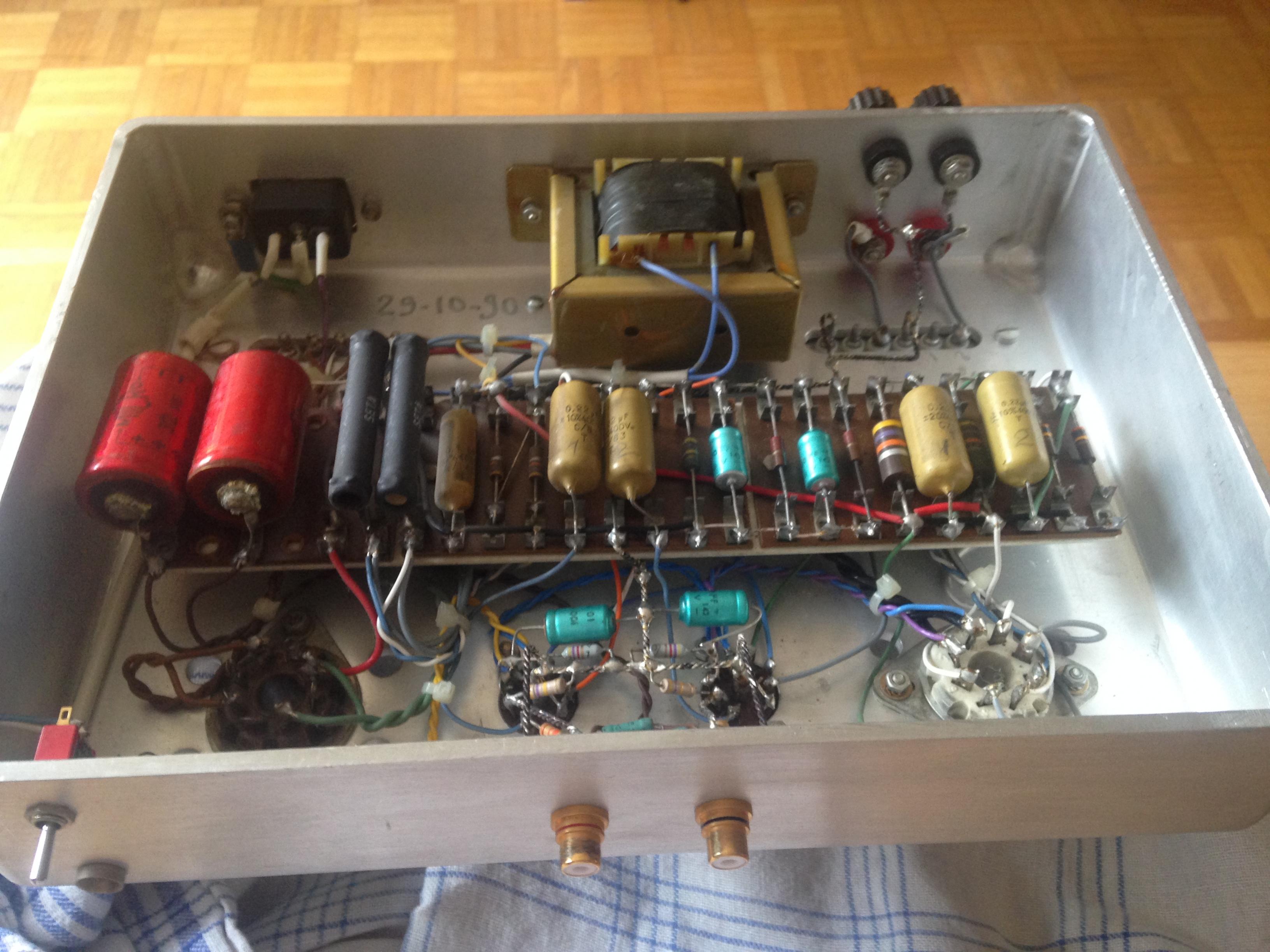

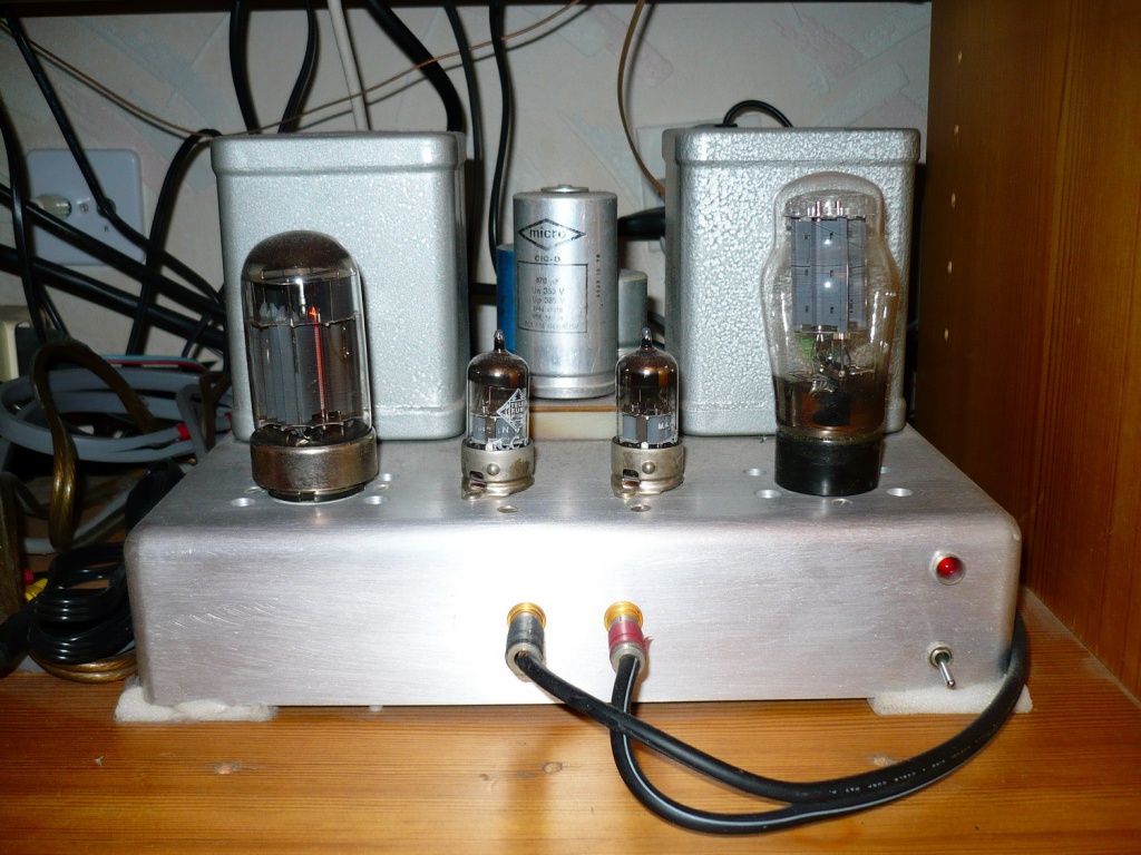

Monotriode 6080
Monotriode made in 1989 and overhauled in 2020
Vacuum 6080 , ecc83 and gz32

1989? Whoa, I was 3 back then, the Berlin wall was destroyed, and Poland had its first free elections ending the old communist misgovernment. That was a loooooong time ago :)
This is a clean and absolutely beautiful build, I have to say. Brings the tears of joy to my eyes. I wonder how it looked like when originally built. The power socket, components, transformers etc.

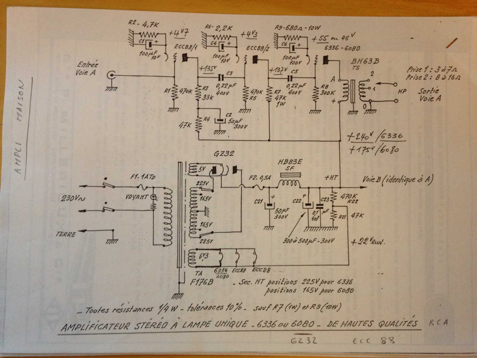

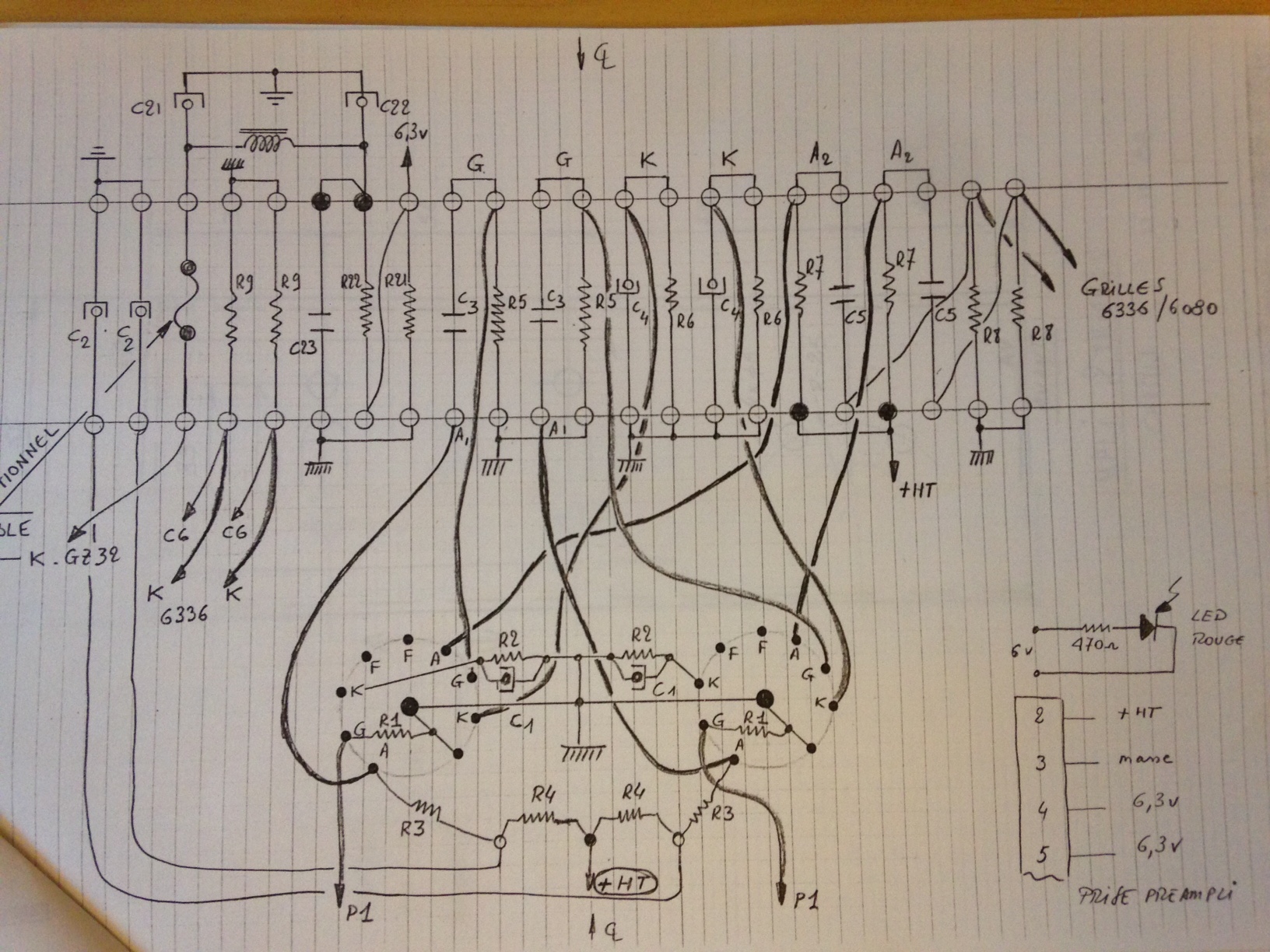

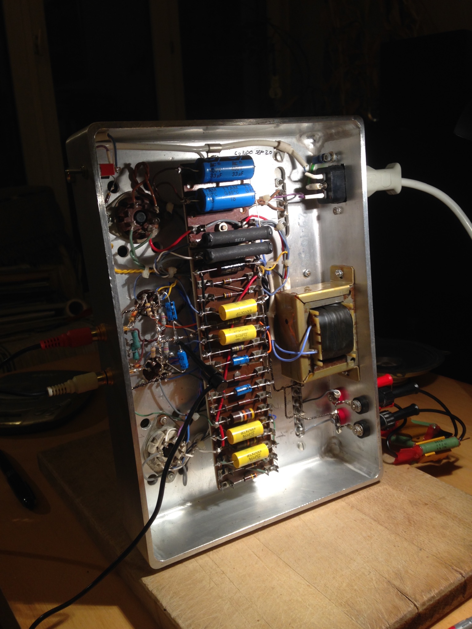

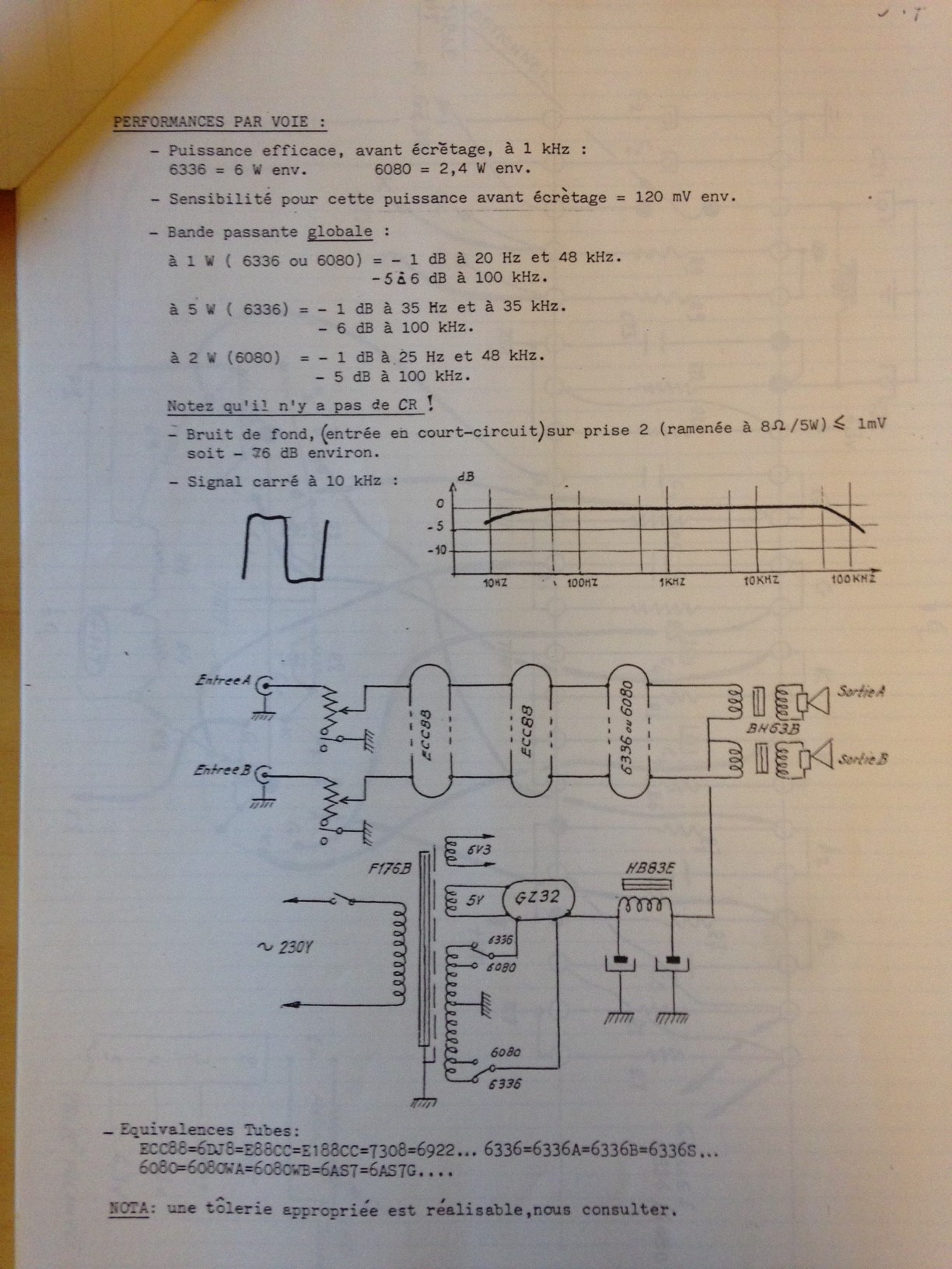

hello this is a DIY build, we made 2 amplifier with a friends, chassis is in aluminum
1 6080 for both channel monotriode, 1 ECC 83 per channel, 1 GZ32 as rectifier
transformer and self are from Millerioux France
total power is around 3watts per channel , the level is incredible .
You may see with new condensator , the original work well from 1989 to 2019 but become dry and outside of spec , tubes are from 89 except one ECC 83.
i have spare of tube
remaining resistor has been tested and good .
sound is excellent
That's cool :cool: - a three-tube amp, though with SS rectifier you could have made a 2-tube amp.
I went for somwthing similar using an ECC81 (I think) as driver but the 5998A dual triode, which has higher gain and is easier to drive. But I've tested my amp with 6AS7G and it works perfect too.:nod:
