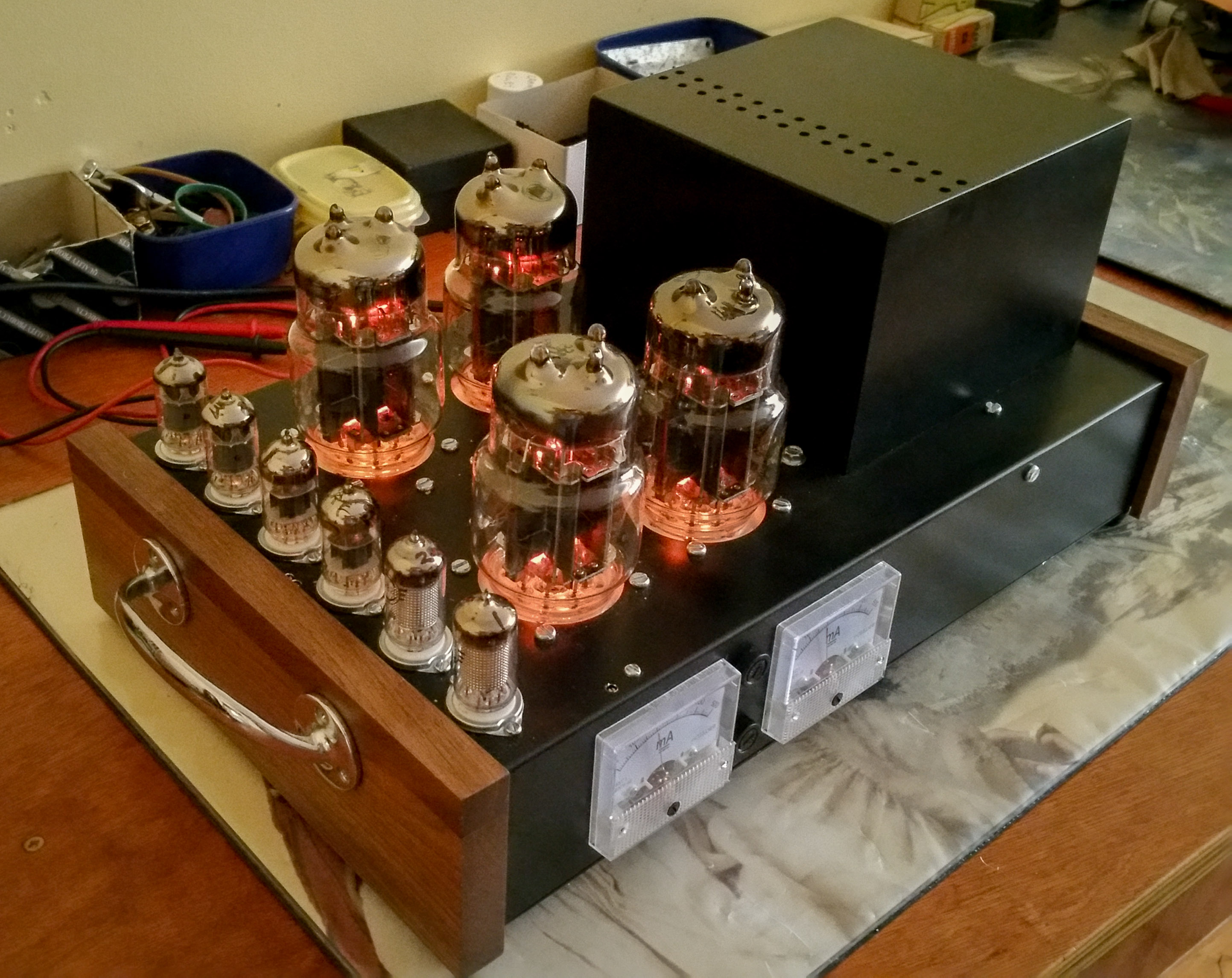

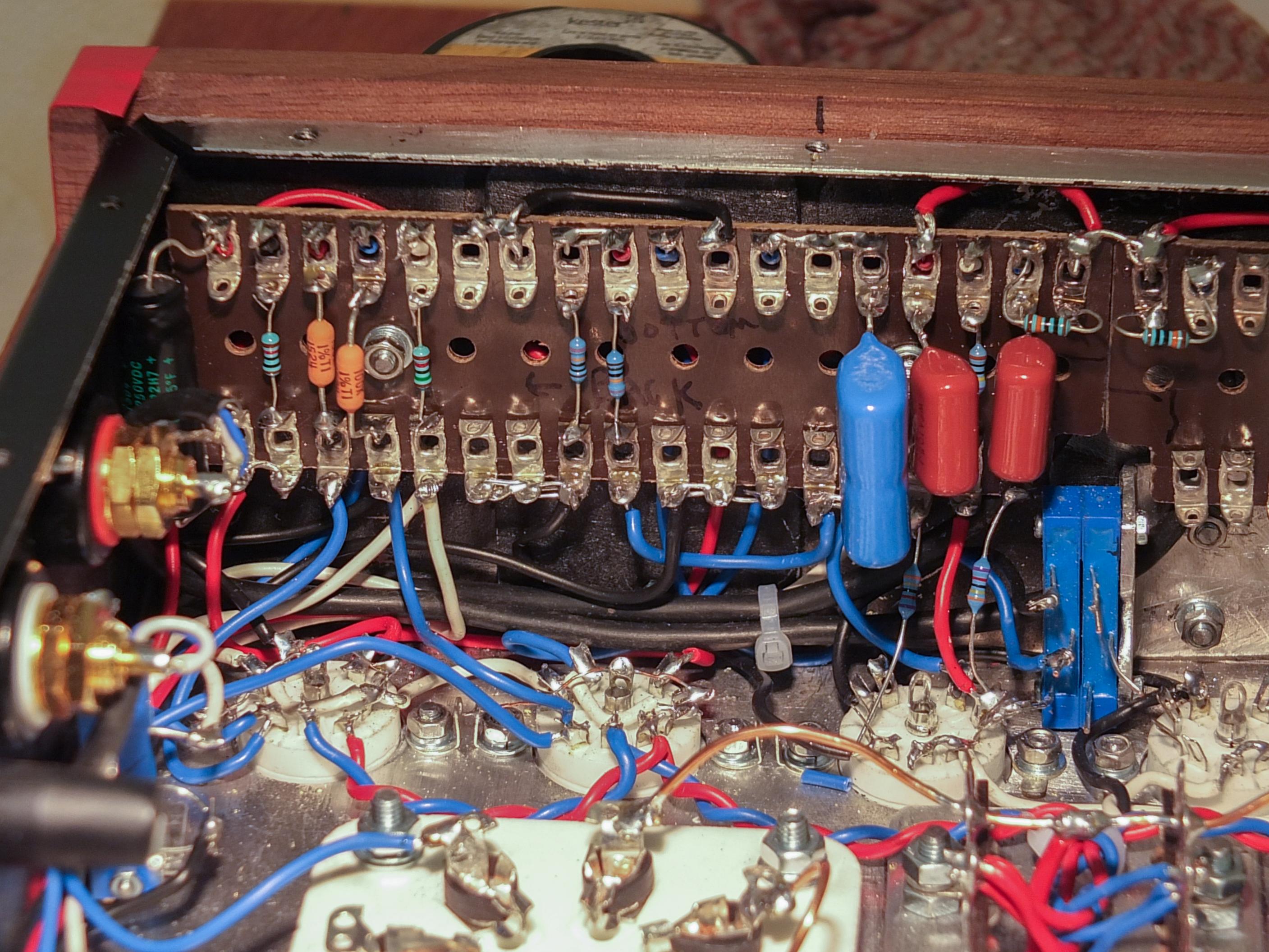

beautiful work!

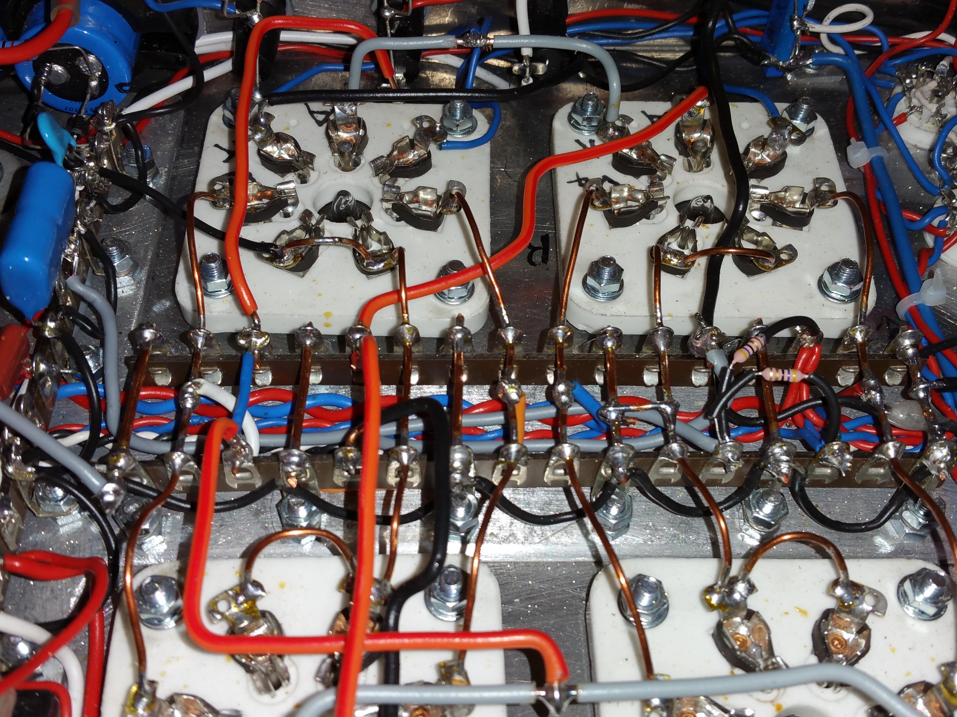

can we have a look at the drivers too? are they also p2p or a pcb is used?
A bit cramped, but does the job. All the driver tubes are NOS equivalents from Svetlana. I bought a job from Russia for $20, and matched them myself.
Hi goddlediddles! Are you satisfied with results? I mean sounding of the amp.
I have used mine for one year already and have to say - one of the best sounding amp ever!!!

Yes, very satisfied. I don't use it much due to the high electricity bill. From what I remember, it measures at over half a kilowatt draw from the mains.

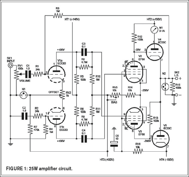

Good work. Good tube for a OTL.My iteration of the Tim Mellow OTL, using the Russian 6C33C.
...it measures at over half a kilowatt draw from the mains.
That´s true. But is useful during cold season like it returns at least 300W as pure heat 🙂

Hi Mhouston, very much enjoyed looking at your amps, which are practically works of art. Do you have the schematics to hand? Could not see anything on your blog.

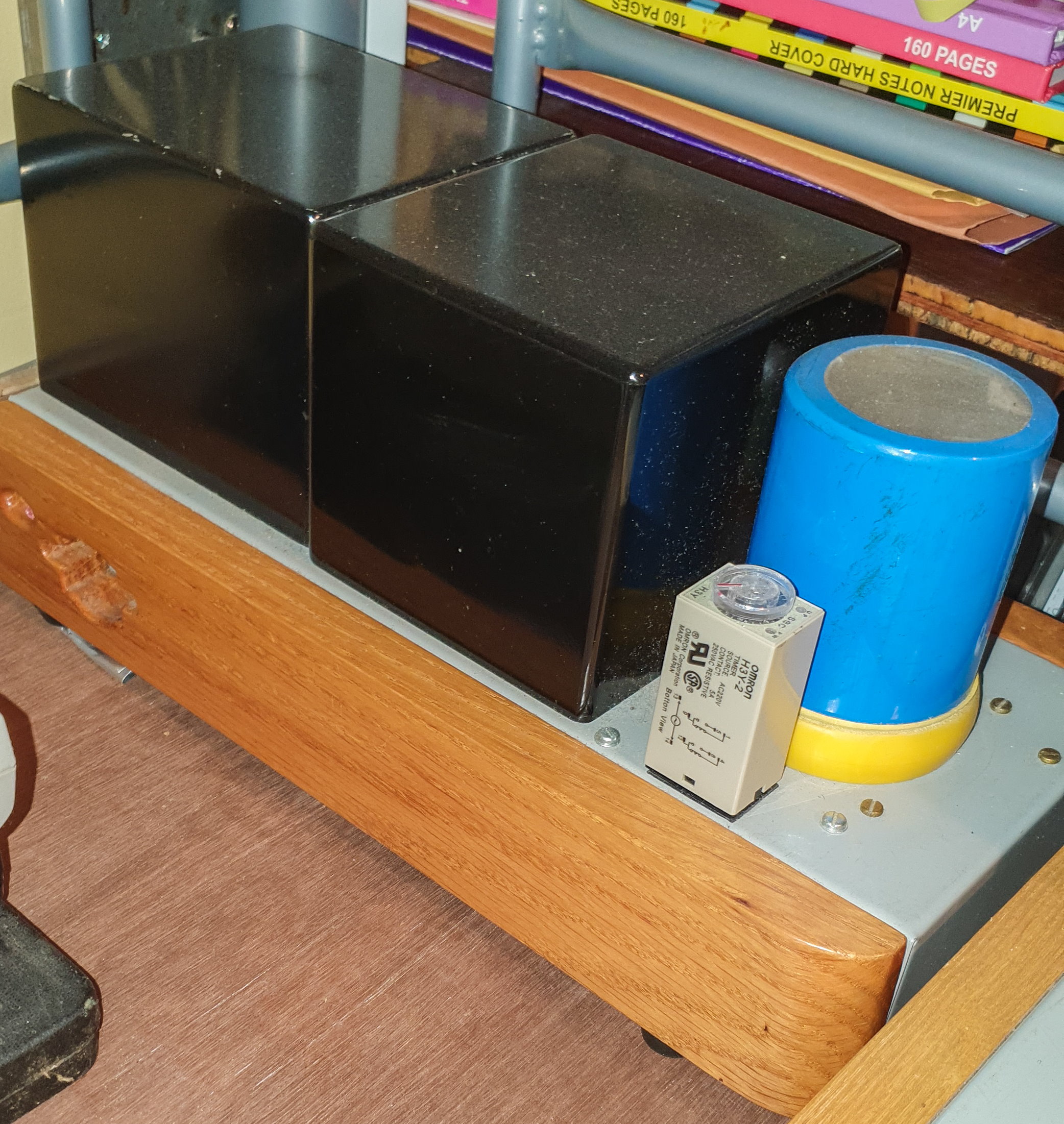

3 Watt SET.

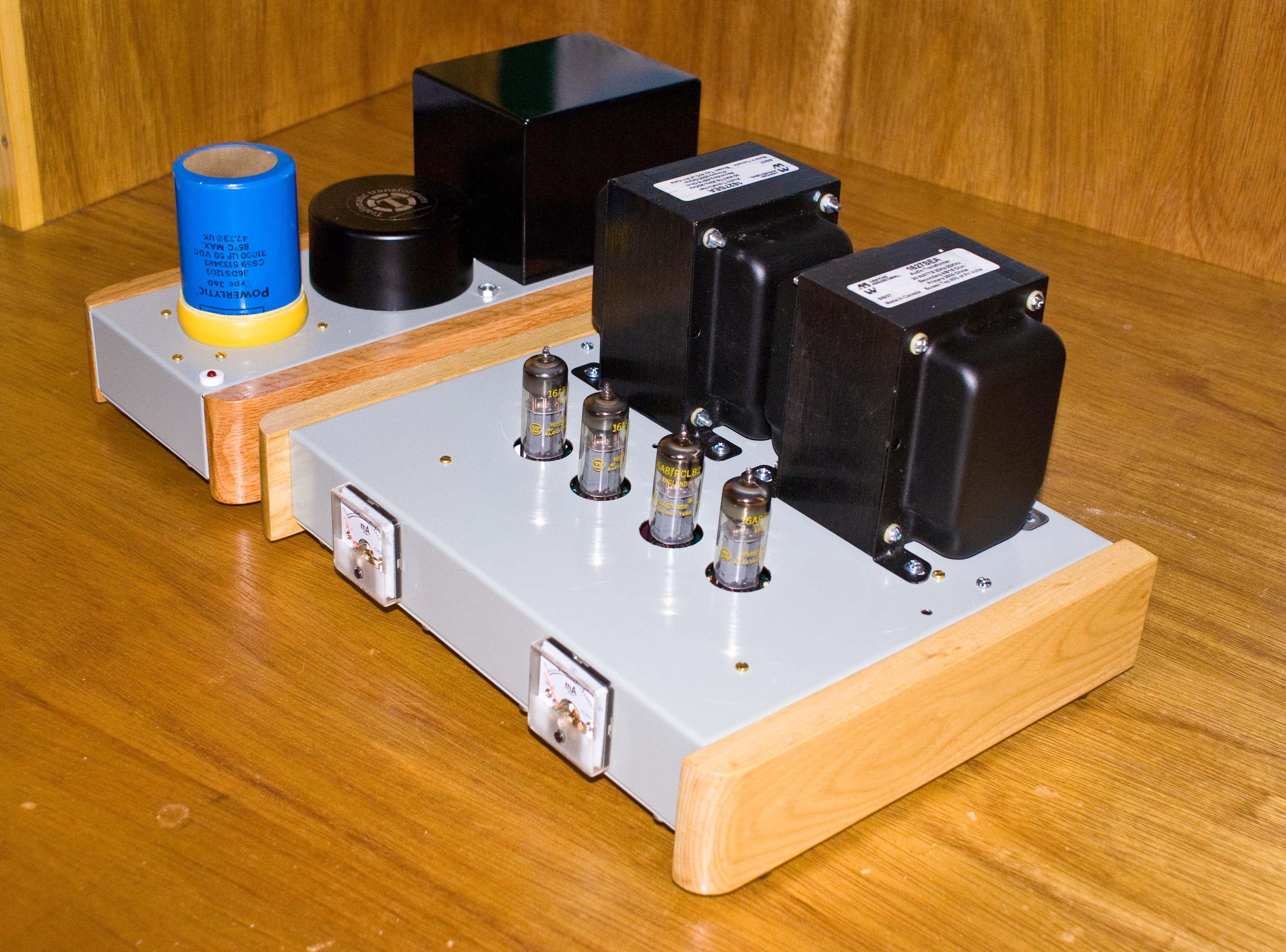

This is my 3 watt SET, using the television tube PCL82 Triode/Pentode (Pentode wired as Triode). Both sections of the tube are paralleled. It employs the over-large Hammond 1627SEA O/P transformer. The Filament supply is 12V DC, smoothed and regulated, which along with the Solid-State HT supply, are located in a separate matching unit. I made my own HT choke from an old microwave oven transformer, with a 10 thou' gap placed in the iron-works. The filament PSU uses the Omron HSY-2, to give a 10-second slow start.

Mate, looks good. Tear off those tranni stickers and put them on the bottom plate out of site. To me they detract from a very nice build. Not convinced about tube choice but haven’t heard them, so can say no bad.This is my 3 watt SET, using the television tube PCL82 Triode/Pentode (Pentode wired as Triode). Both sections of the tube are paralleled. It employs the over-large Hammond 1627SEA O/P transformer. The Filament supply is 12V DC, smoothed and regulated, which along with the Solid-State HT supply, are located in a separate matching unit. I made my own HT choke from an old microwave oven transformer, with a 10 thou' gap placed in the iron-works. The filament PSU uses the Omron HSY-2, to give a 10-second slow start.

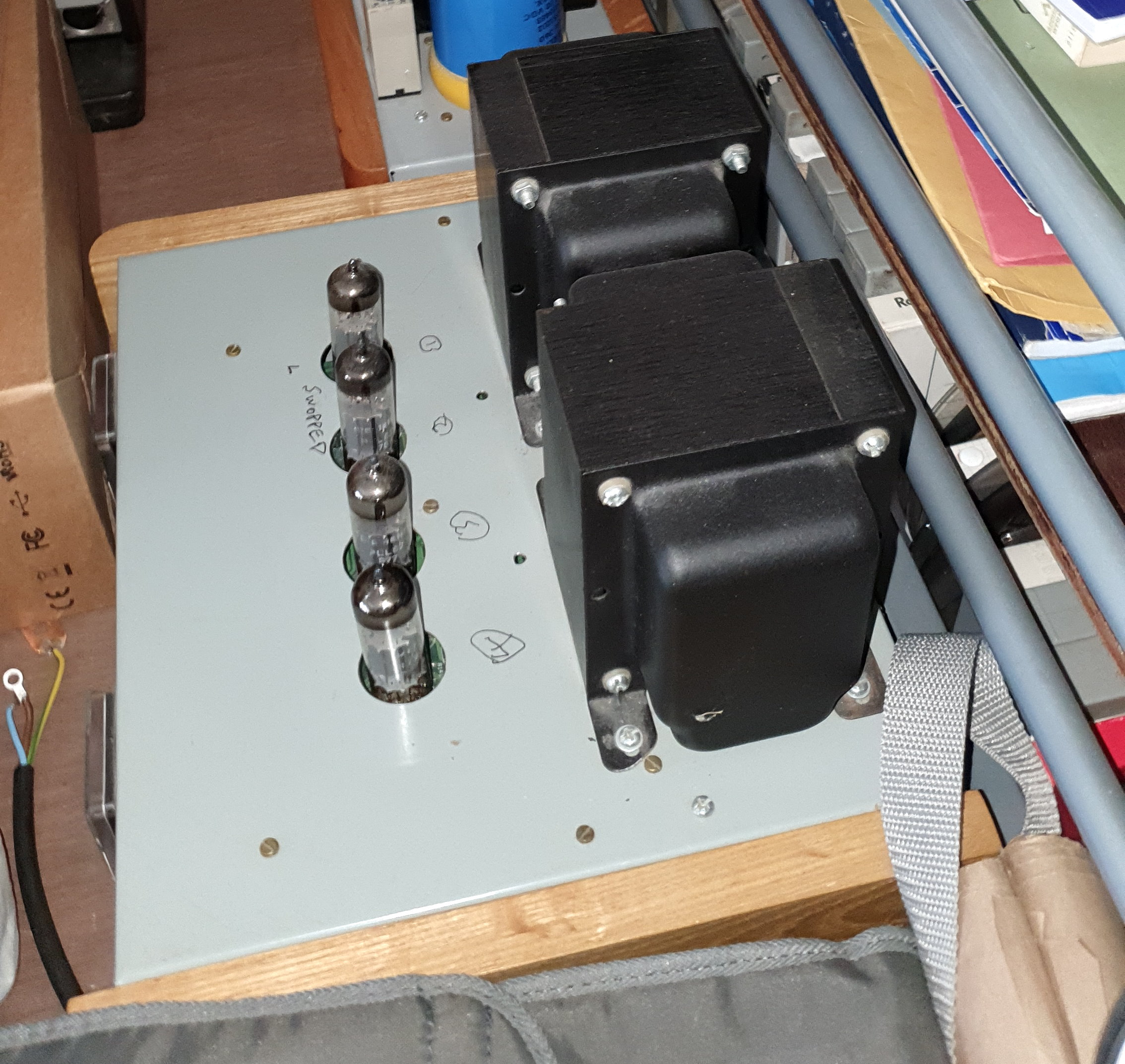

No Stickers.
Stickers off. Now I'll rub off the markings.

They are big OPTs. Im guessing the amp produces about 8W with a tail wind. The trannies look about 25W+. I’m all for it because it allows good bass extension.
Once again very nice, good clean build.
