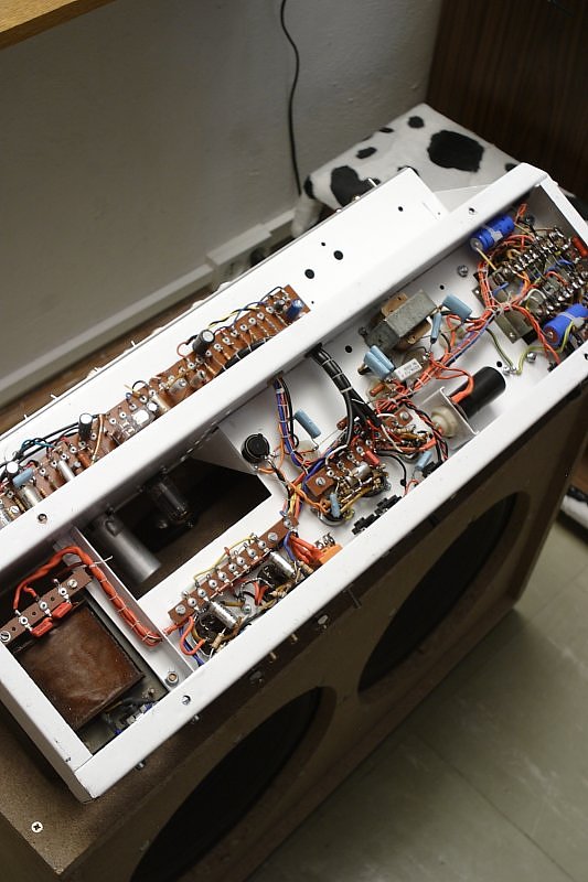

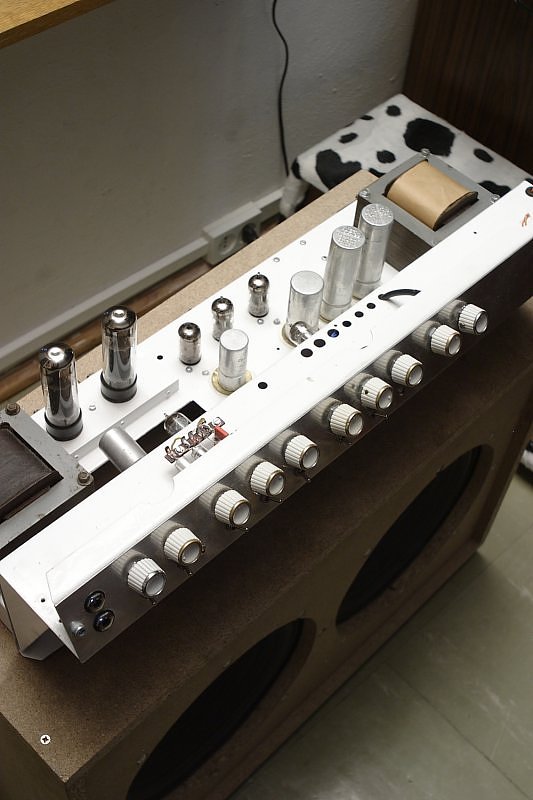

madBrahmin guitar amp
This is another project of mine, I built it around 2011/12 and it has two channels with various mods (bright, additional gain stages etc.), effects loop, master volume, presence and I don't remember what else, plus potentiometers and sockets for easy biasing of output tubes. Don't have the pics of the box though. It's coated with a fluffy fabric that resembles Polish black-and-white cows and the name is a pun: "ma-dB-rahmin" and "mad brahmin", inspired by the two-headed cows from Fallout series.
Is the 6CG3 damper diode there as a B+ soft start element? Looks really good too btw!
Yep, soft start. I got the filament current capacity and it also serves as a RC filter stage.

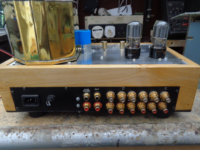

DIY preamp, CCDA 6H8C linestage preceded by SS tone control. Custom brass knobs made by Peterson Engineering in the UK. They did a really good job, contact Olly on sales@petersenengineering.co.uk if you want some knobs made. Video here - DIY Valve Preamp. - YouTube
Andy.
Andy.

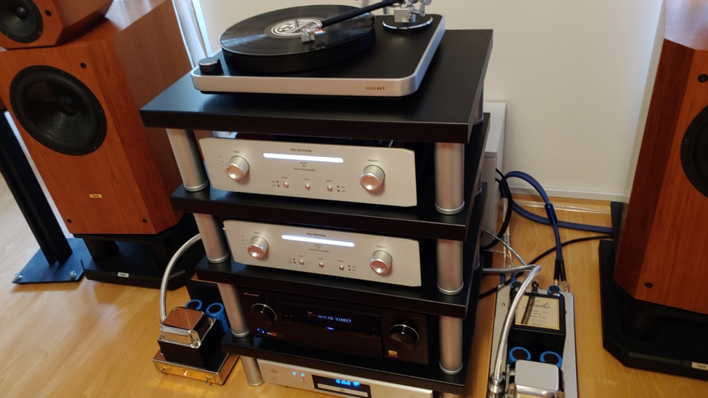

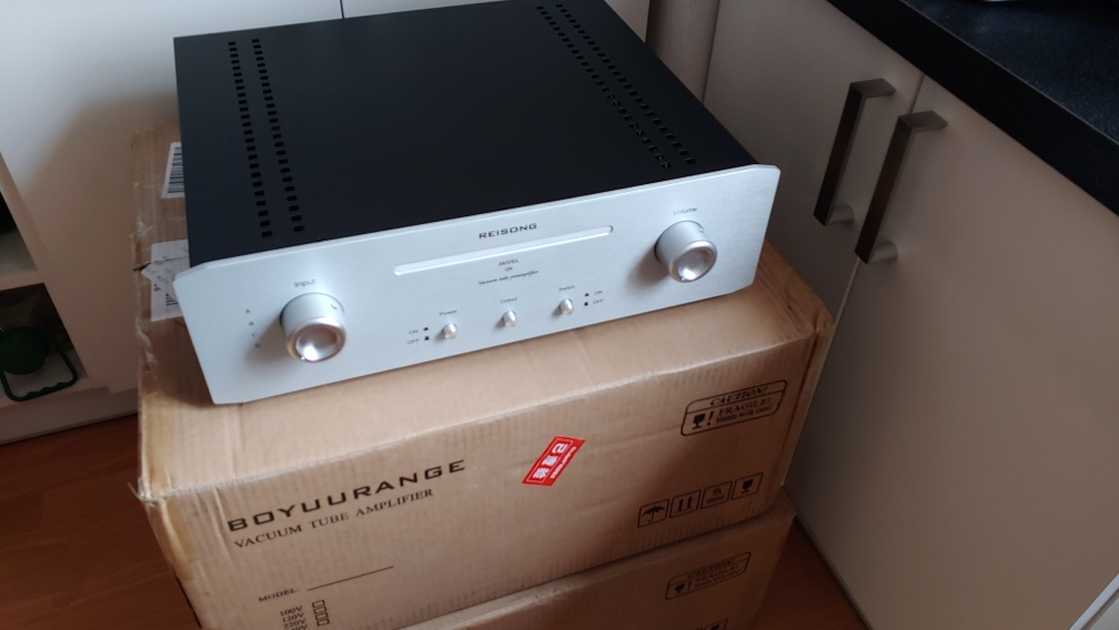

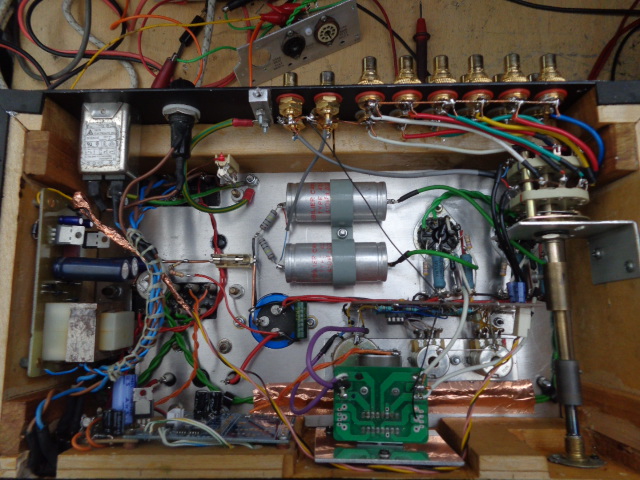

Preamp RTP3 built in AliExpress Reisong models
my fresh tube RTP3 line-preamp build, as posted at this tread:
https://www.diyaudio.com/forums/tubes-valves/151733-vacuum-rtp3c-79.html#post6769085
It has started at January 2021, I have bought 2 Reisong preamps, so I used its case for build phono-preamp and finally line-preamp.
The Reisong model use Marantz7 circuit, which works very well itself, going to 200-250kHz bandwith, nevertheess I tend to go to the edge - now is simply better.
Pics shows units before and after
Now I finally play vinyl - tube phono - tube line - tube amps 15W SE... nice!
