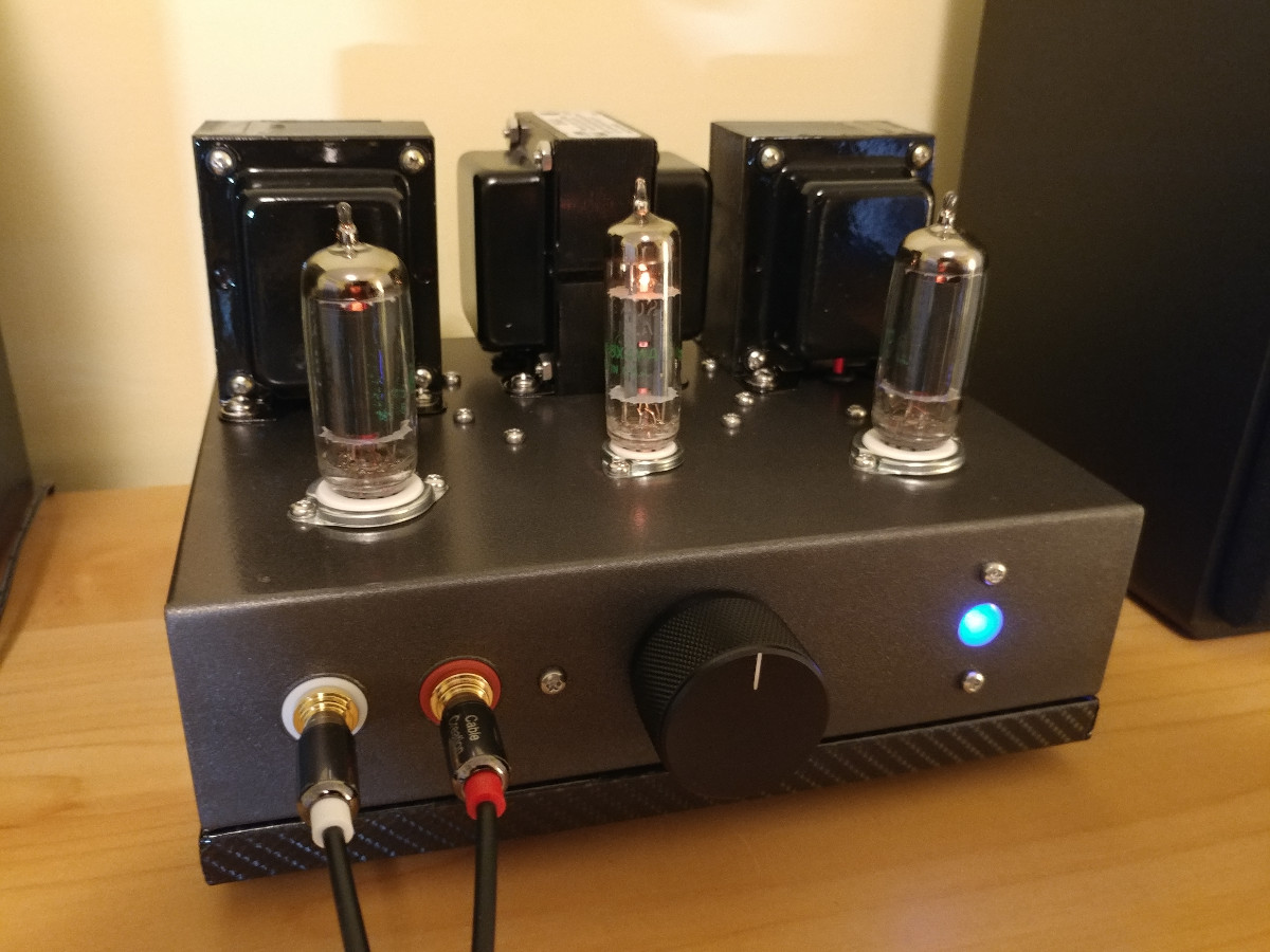

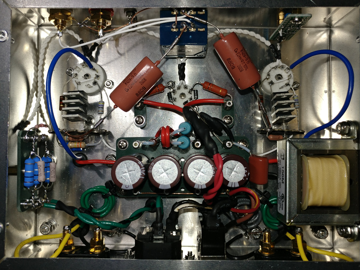

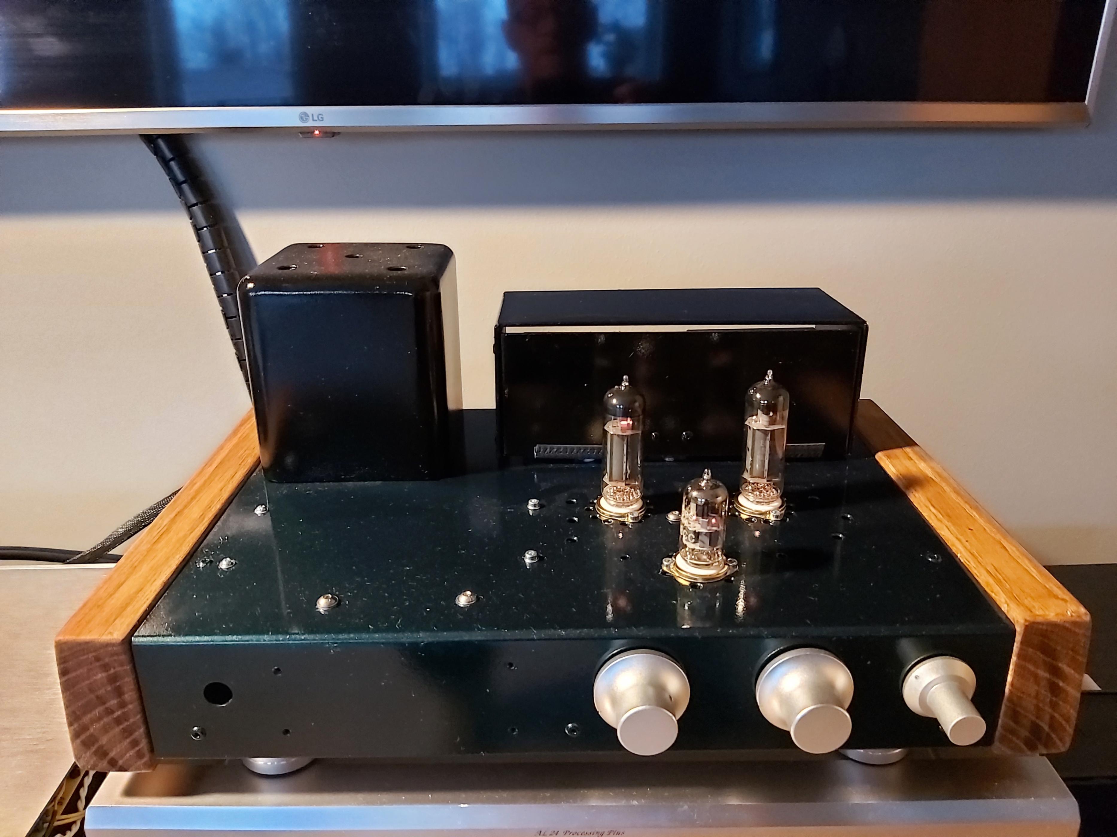

True spud amp with the 6CL6 tube. Chassis is 8" x 6".

Looks good drteming. So first, how is the 6CL6 a spud amp since it only has one section? I think of spud amps as using 2 section tubes like 6EM7. Are you relying on a pre-amp for voltage gain?
And second, how do you like it? I bought a few 6CL6 to play with many years ago but haven't gotten around to playing with them yet. They seemed to have promise, though I wasn't especially thinking about them as finals.
There are factions that believe a "true" spud amp has only one section. The 6CL6 is useful in this application because when you run the screen at 150V, you only need about 3-4V of bias, and the amp can be driven by a line source.
The little guy is fun to listen to. Surprising amount of bass, likely due to diode bias and relative overkill on the output irons. Only 2 W peak output, but plenty loud for my office.

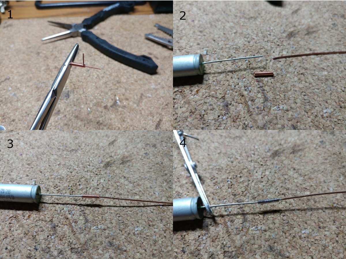

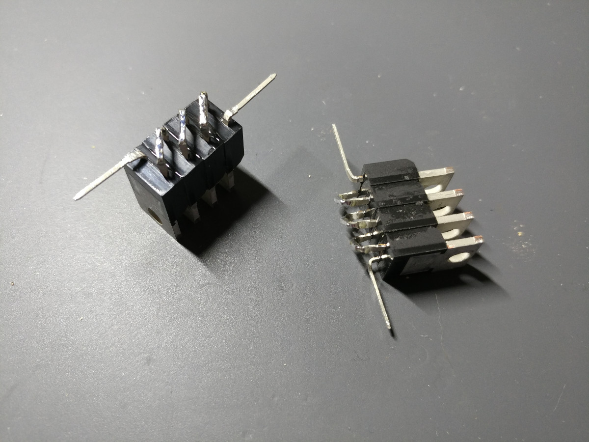

Interesting build drteming... how did tyou dothe wire wrapon those big brown caps, that's a clever way to extend the leads. Those TO220 packages, schotky diodes for DC heaters?
The wire couplers are 22 ga copper wire wrapped around an appropriately sized mandrel.
attachment.php
Those are stacks of Cree SiC Schottky diodes for bias. 4 of them provide a bias of 3.57V in this application.

Thx drteming. I guess I wasn't aware of that interpretation of a spud amp, but no matter. I was just curious. And you only need 3-4v of swing and you can get 2wpc out? I haven't done a lot with pentodes (or tetrodes) and have only tried designing with triodes.
Glad you posted this amp. I'm even more curious now!
Opinions are divided on these Cree Schottky diodes. Some love them, others like me can't live with them. I took all mine out - smoother with filament bias in my case, since I use DHTs. There was a certain sharpness I could never get rid of for all the clean sound.
There's already heaps of harmonic distortion due to the tubes running in pentode mode. A little extra clarity doesn't hurt.:D
