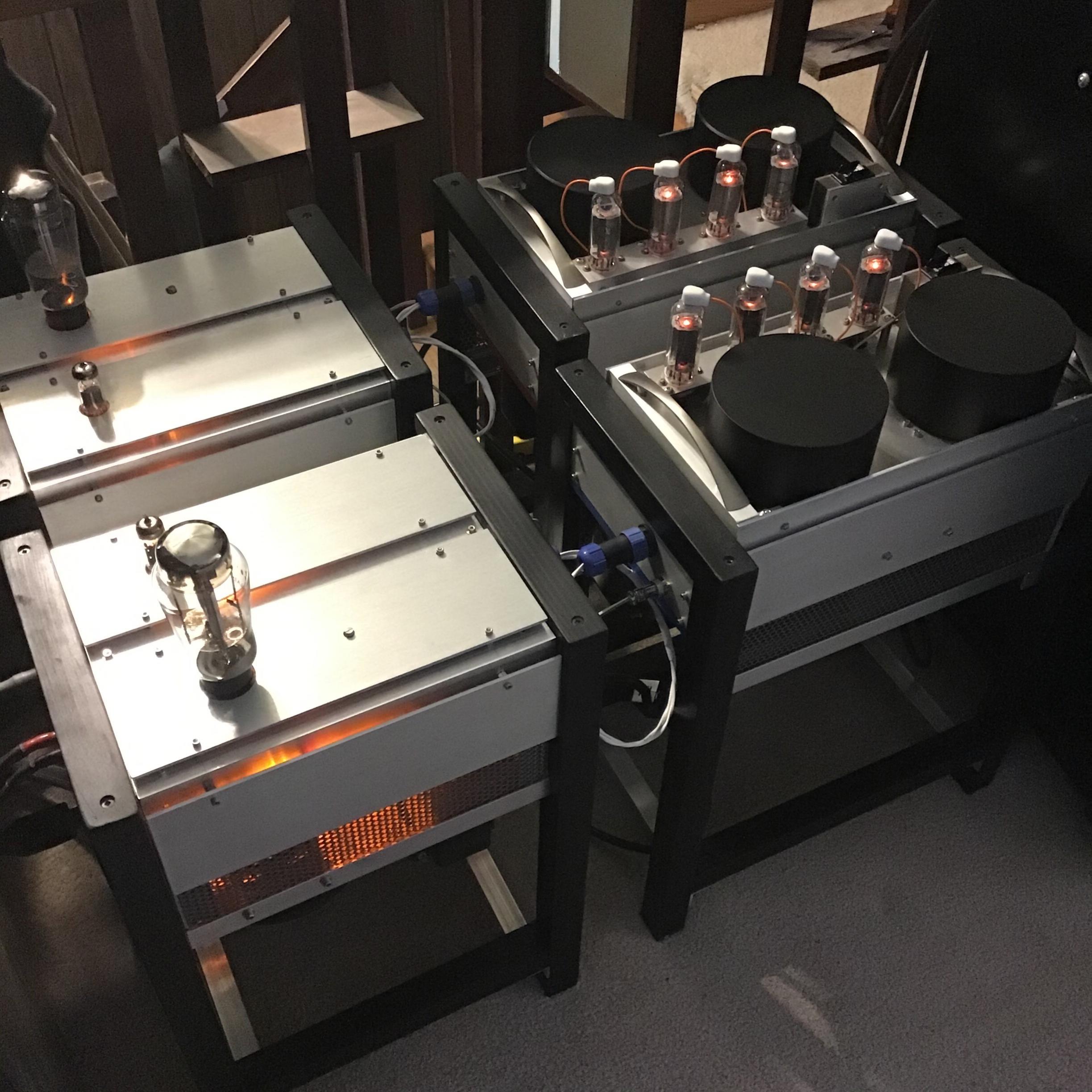

I love it, can you please explain how you used a couple of power transformer like the VPT12-2080 as OPT? ....all the best
Using a 50Hz mains toroid for an output transformer will never produce the results claimed.
Firstly the primary inductance will not be more than around 25H, because it doesn't need to be for a 50Hz mains trafo. Too large a primary inductance gives a high ampere-turns level which means the core needs to be bigger, this is simply not a design requirement for mains transformers, the manufacturer wouldn't be thinking "Lets use a huge oversize core and lots of primary inductance incase someone wants to use it as a audio transformer". So that never happens and the laws of physics means you won't be able to support the flux density needed to get low end power, additionally the modest primary inductance, whos impedance drops with frequency, will soak up any power at the lower frequencies as well.
Then we get to the issue of interleaving the windings for the best HF coupling, it simply isn't practically possible on a toroidal core to achieve the same level of careful interleaving on an EI core.
So this leads the simple fact: All the best output transformers are not cobbled together cross-wire mains transformers, and they are not toroidal.
So I am going to call you out on "better than any EI transformer", and I am going to cast shade on your performance claims.
Having been working in the audio industry for many decades in tube amp design, there is a reason why people like Brian Sowter and Majestic don't use toroids (two of the best, if not /the best/) transformer winders in the world (the former winding some of Audio Notes finest transformers).
If the those claims were actually substantiated no one would be using custom EI outputs, including me.
Stick it on an audio analyser in my lab, then we'll see, because what you think you have and what you actually have can be very sobering when then audio analyser tells you everything you thought you had never existed.
I'm not saying you can't get some sound out of a mains trafo wired in this way, lots of people have done it to save money and learn at the same time.
But when you claim its better than anything else, I will just tune out.
I'm agree. /One Polish guy produce tor. output transformers....?/

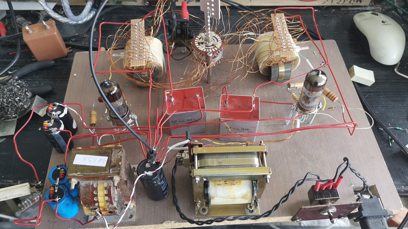

Nice orange glow from the interior ! Can you post any pics of the build? Also very interested in what you did with the power supply . Do you have a schematic you can post?

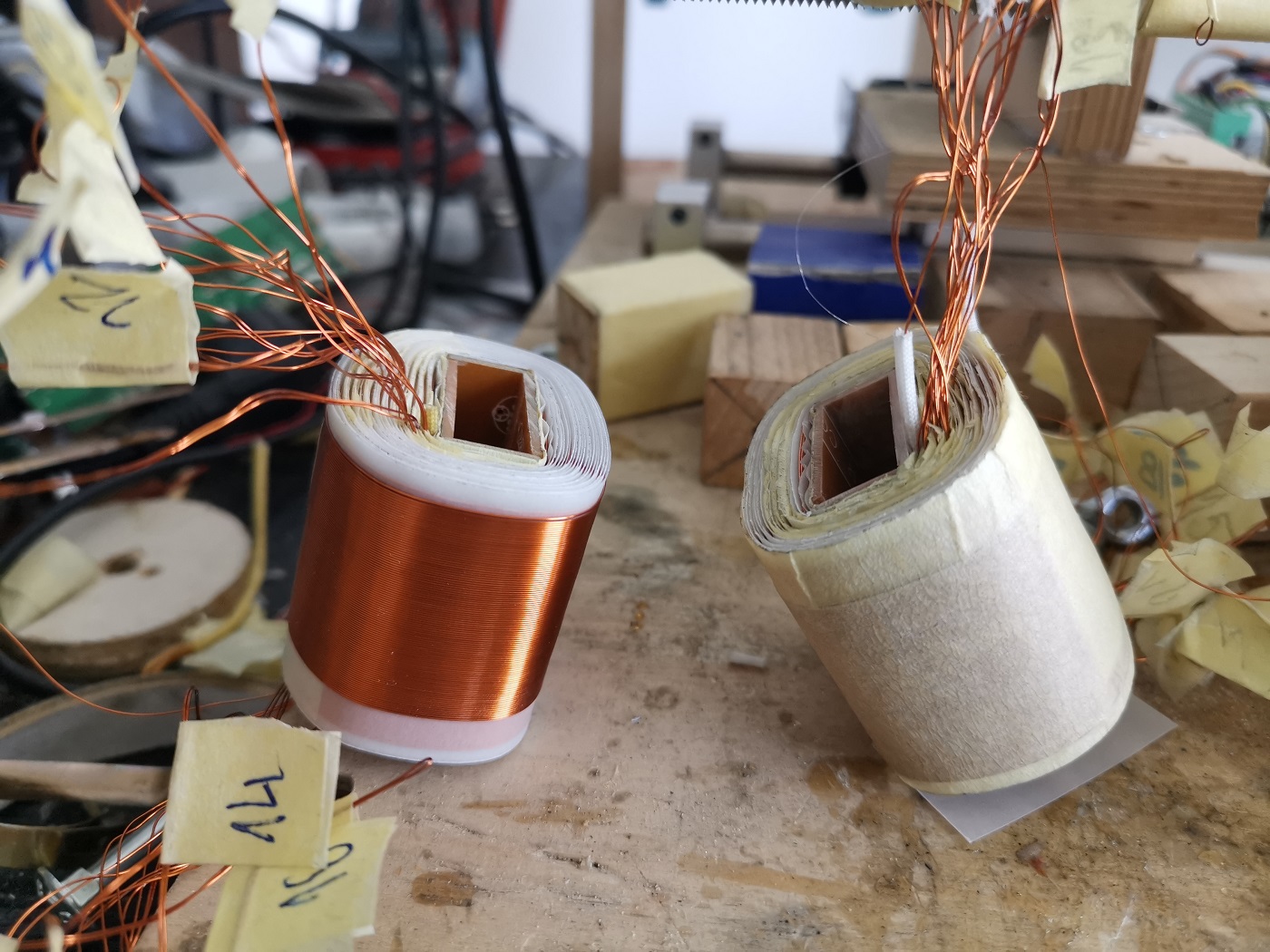

"In prototype phase. Autotransformer Volume Control" nice winding there but they look hideously complicated and a nightmare of stray inductances. They remind me of a fader I have in my bits stash that has a pot built on very similar lines, but no core and less IP/OP's.
A.
A.
I said it was better than any EI coils I have heard... Not you.
Secondly, it's two 50Hz transformers interleaved if you bothered to look and this makes a 460V@25Hz transformer, not a 230V/50Hz transformer (in that mode, the LF response hits core saturation around 15W@30Hz instead of the 112W@30Hz I measure with two interleaved coils...
Perhaps you should try it instead of trashing it without knowing ANYTHING about it's sound.
I suspect it simply doesn't cost enough to sound good in your opinion.
Oh and your estimate of inductance is off... From Triad:
"1. VPT230-110 = 213 to 439H @ 230V, 50Hz (primaries in series). 304H average from 15 samples.
2. VPT230-220 = 192 to 444H @ 230V, 50Hz (primaries in series). 283H average from 15 samples.
3. VPT230-430 = 93 to 214 @ 230V, 50Hz (primaries in series). 128H average from 15 samples."
This means in interleave the inductance is 4 times that.
I'd gladly "stick it on an audio analyzer in your lab" if you were in Toronto. I'd love to see the results and the possibility of you eating crow is satisfying.
And sorry if this reply is a little snarky, but you effectively told me my opinion is wrong. I don't like that kind of nonsense.
I don't claim that these sound better than Sowter or any other EI coils I HAVEN'T heard, but they do sound better than the Hammond coils I've tried in the same circuit (which make less power, too).
If you use low Rp triode connected tubes, and you keep the ratio low (my monoblocs end up being 1k:6R), you will get great results.
Also, I can't seem to find any EI audio transfomers that are 250W, 25Hz-50kHz, with a primary DCR of 12R that handles 1A peaks, and doesn't care if a faulty tube arcs. YMMV.
Toronto based Plitron builds toroidal audio output transformers. They are expensive and not widely used. The performance claims are pretty high.
Testimonials for PLITRON Toroidal Audio Transformers | Plitron Manufacturing
In the Netherlands we also have Menno van der Veen. And in Poland Toroidy. That build Toroidal audio output transformers.
