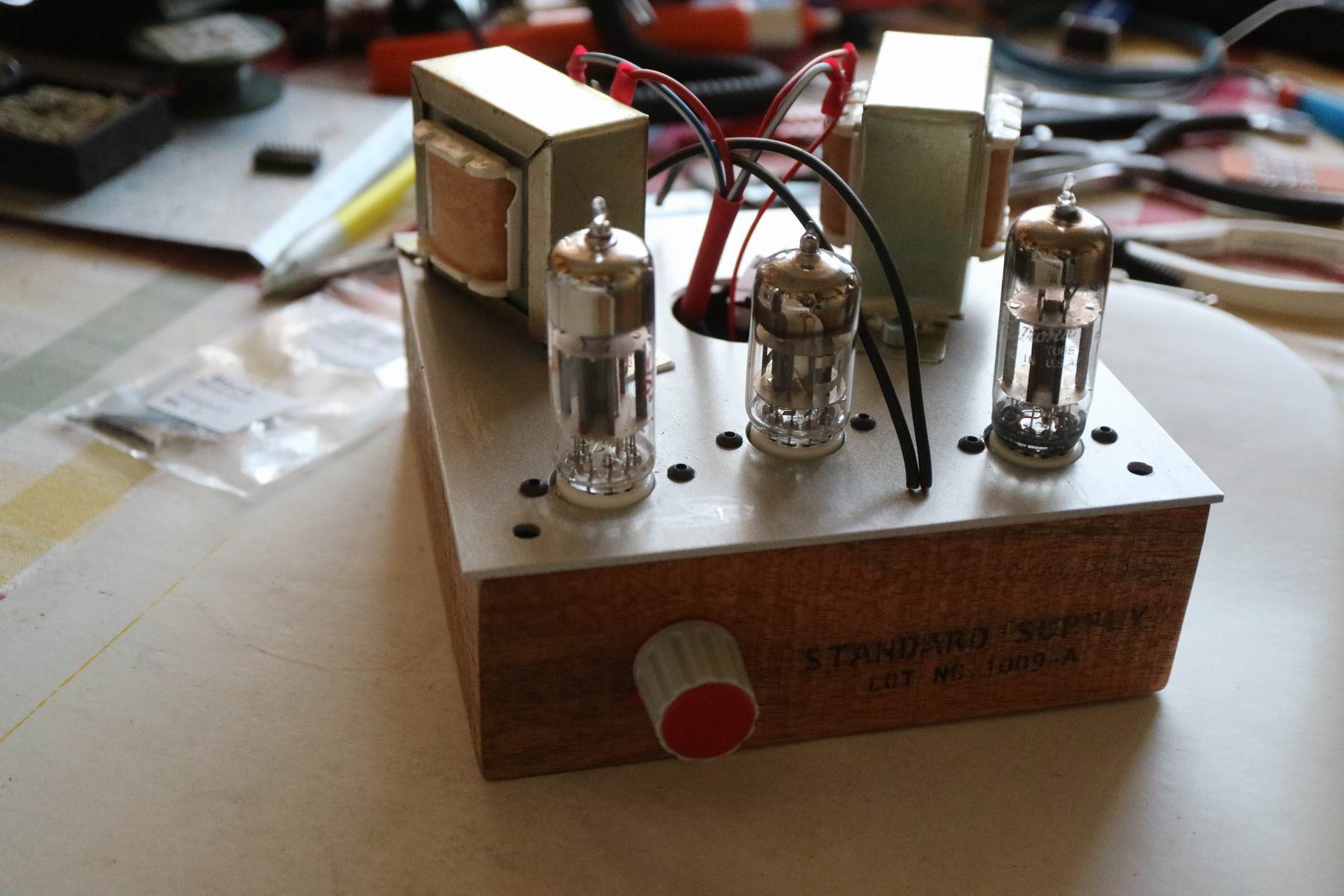

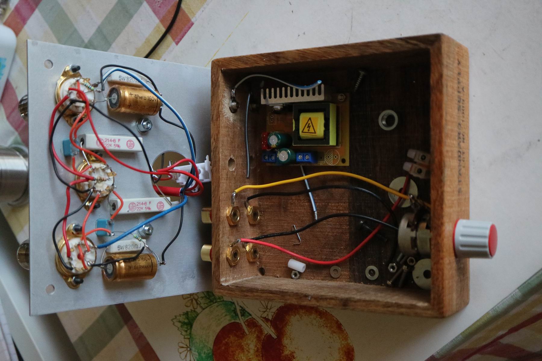

This one has been plauging me since Oct last year, but now I have finally started to get things together.
A small 12B4-SE with a HV DC/DC SMPS, intended to run on a 12V lead battery.
I have mislaid the phonosockets ... again!
Transformers are cheap Chinese and the box is some kind of "wooden box" from H&M HOME.

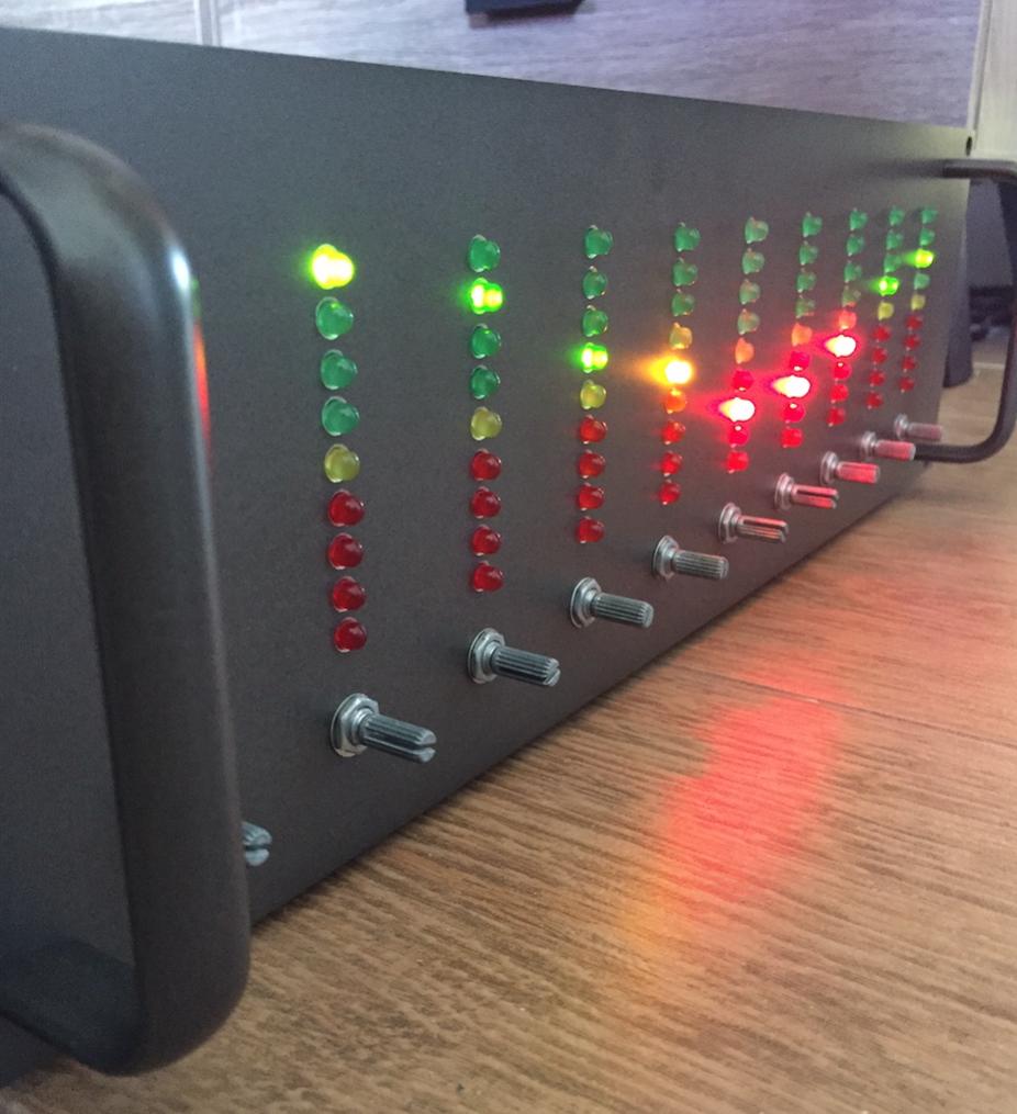

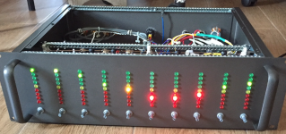

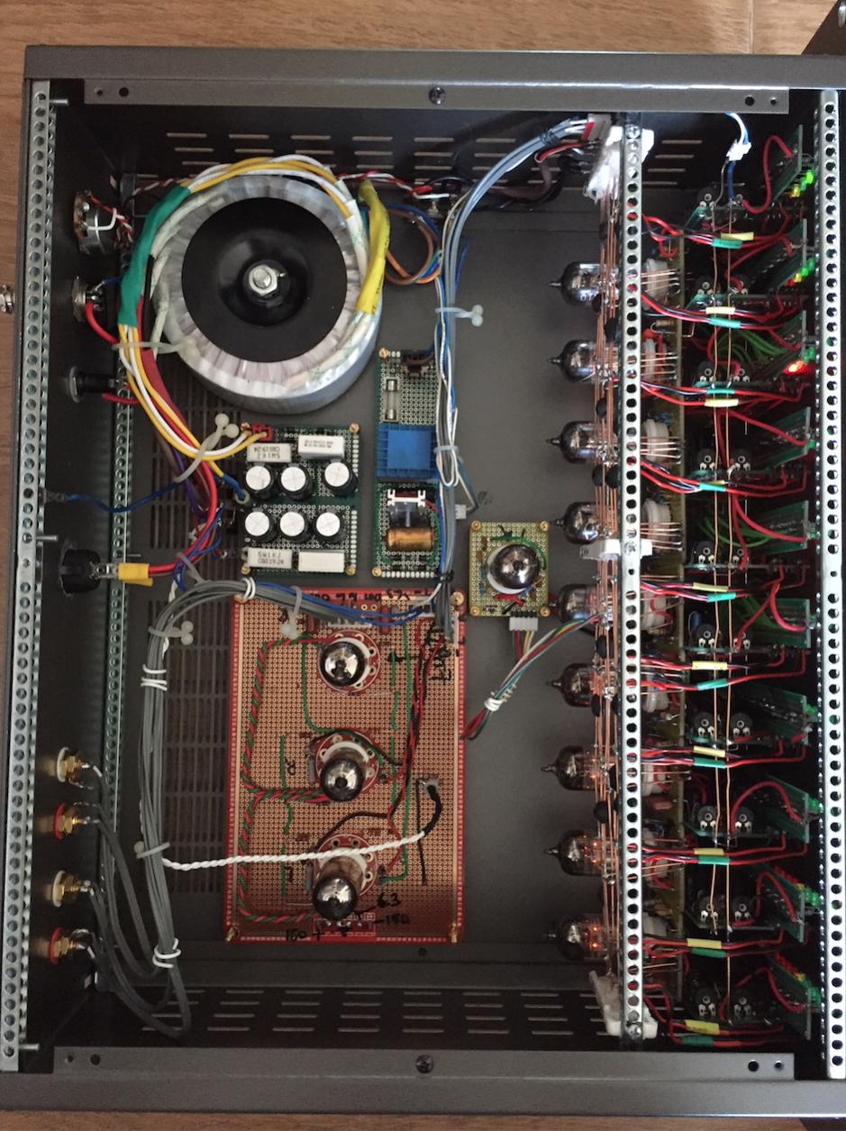

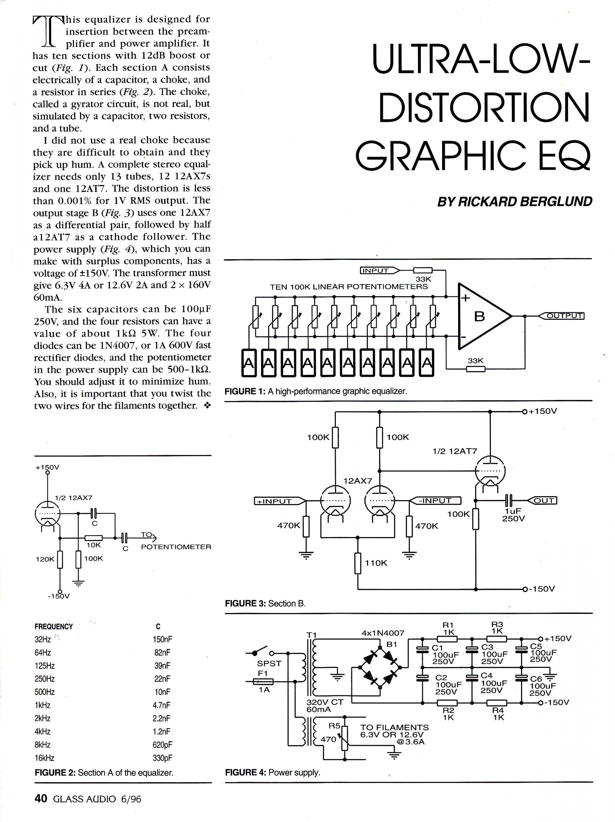

Unexpected arrival of shipping from US during lockdown of remaining parts necessary to finish this all tube graphics EQ by Rickard Berglund, then again extended quarantine until May 15 so perfect for give a finish to this project.
On page 930 #9296 of this thread the wooden board and other info, here the final build, big task has been find a way to avoid to much cable connections, so I made this kind of "guitar string" for connect the all 10 modules, this workout very well avoiding bundles of wires and unwanted oscillations.
I just tested musically and sound and work very very well, no oscillation whatsoever and even the little hum on the wooden board test is gone, max vol on amp and no noise at all.
I still need nice knobs and somehow some print for the front panel.
I will test now the EQ with generator, scope and Rew for see the real performance.....all the best

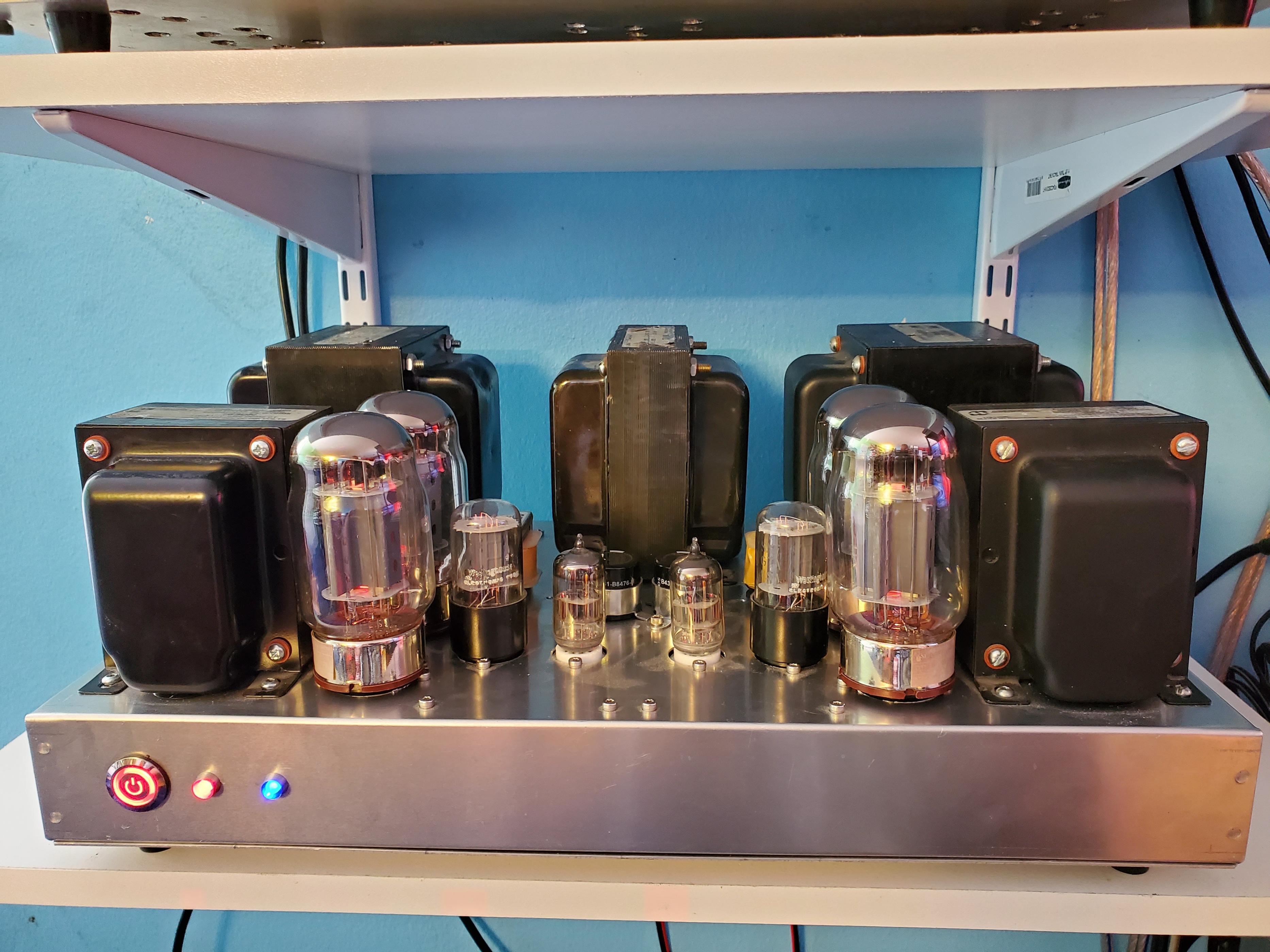

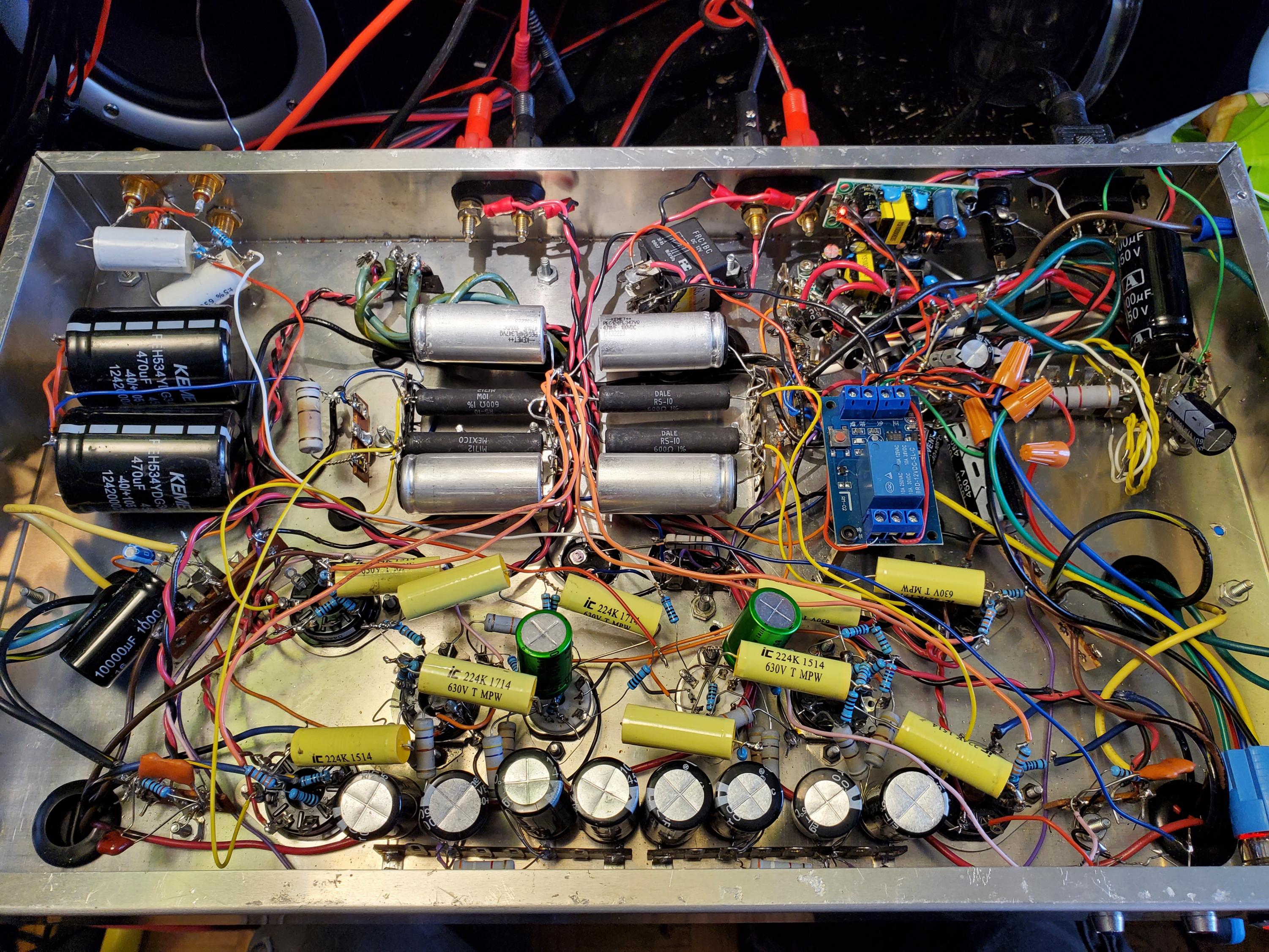

Finished converting the KT88 amp to cathode bias. Dale 600R and Kemet 22000 hour 105c caps. Should last a long time.
Now to sell it on to a good home.

That is really a neat build and a lot of work. Congrats.

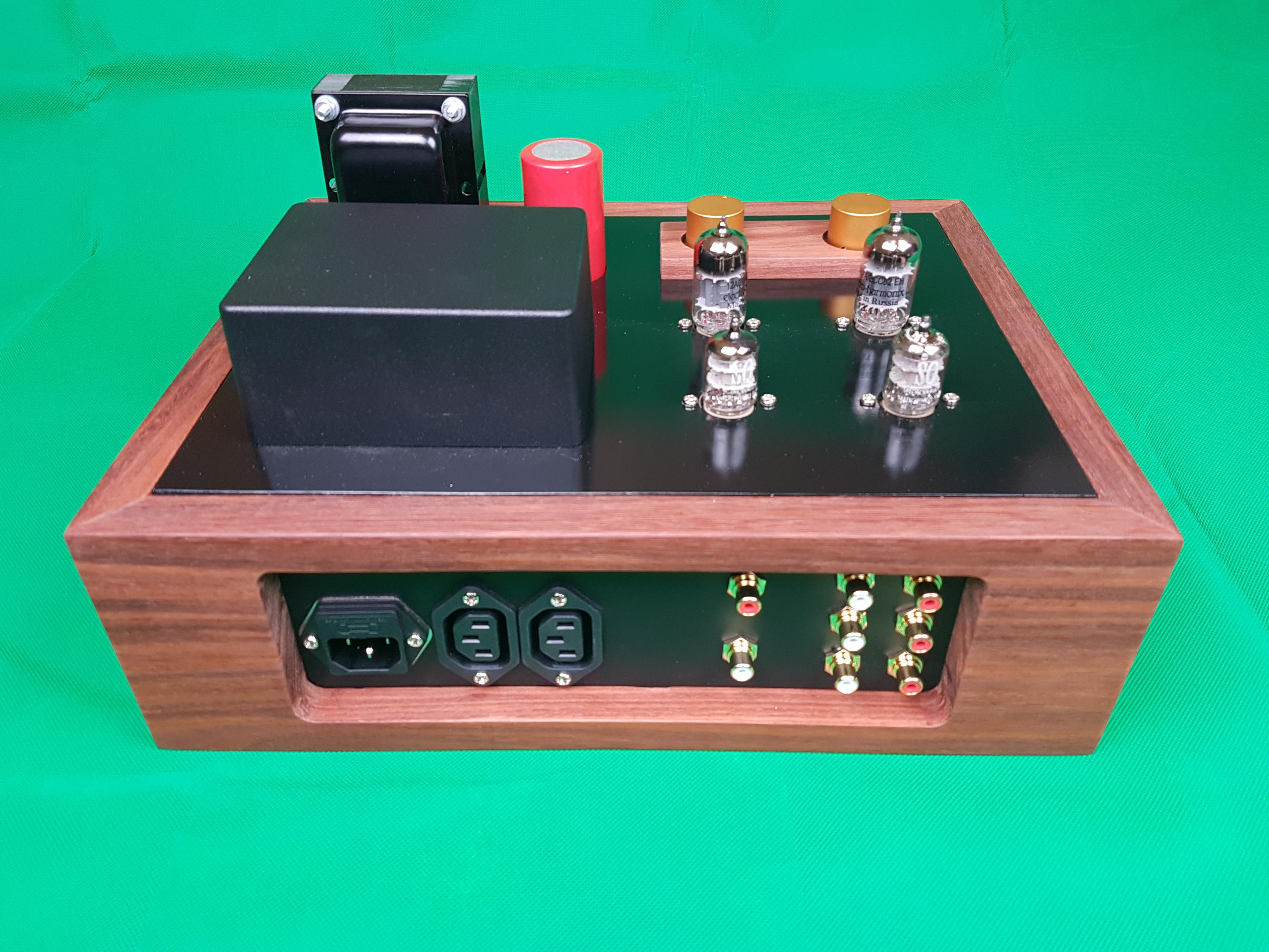

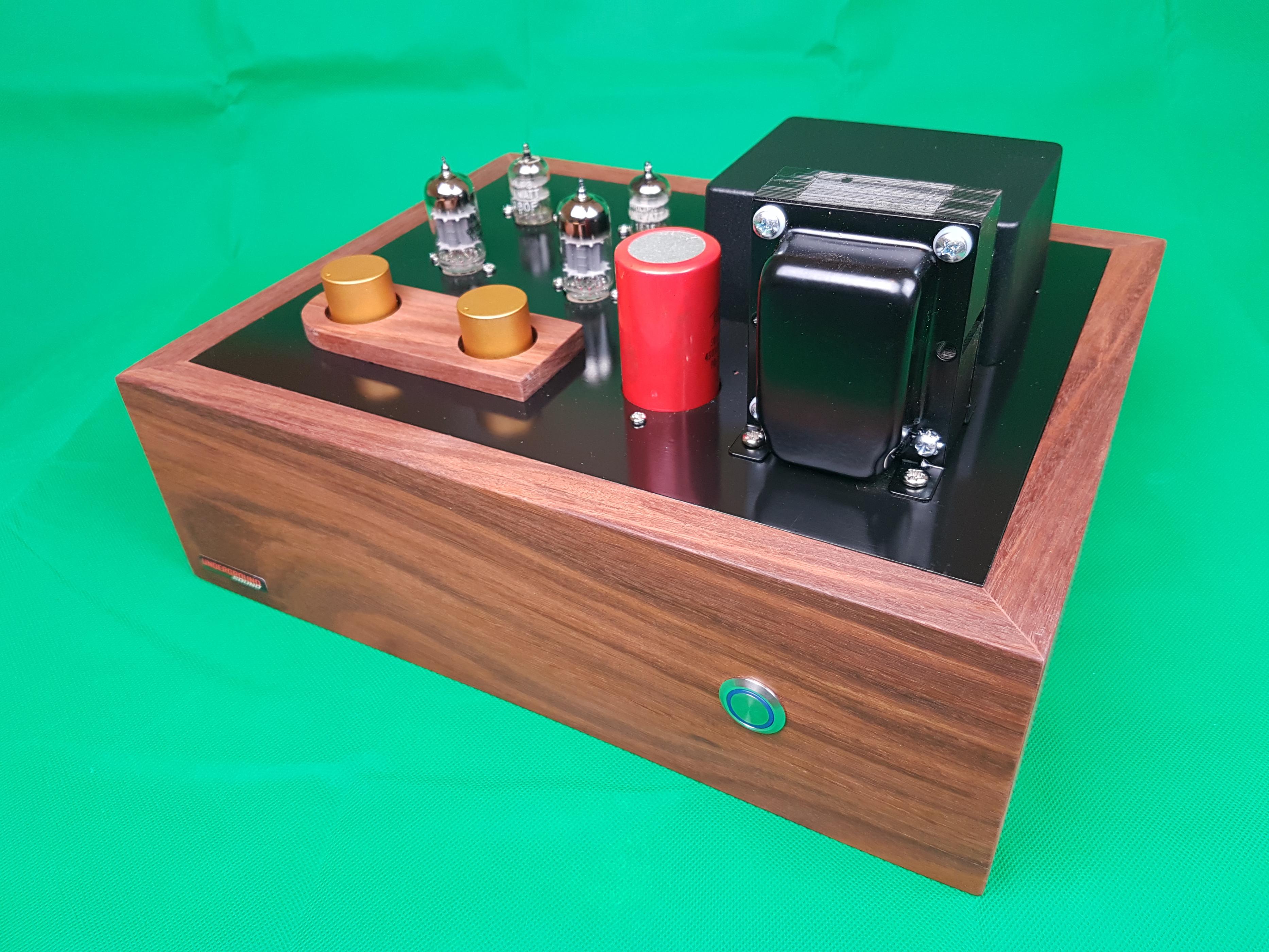

I am looking for that nice Mains On/Off switch with back light. Have browsed the internet but could not find that particular one. Where did you purchase it if I may ask?

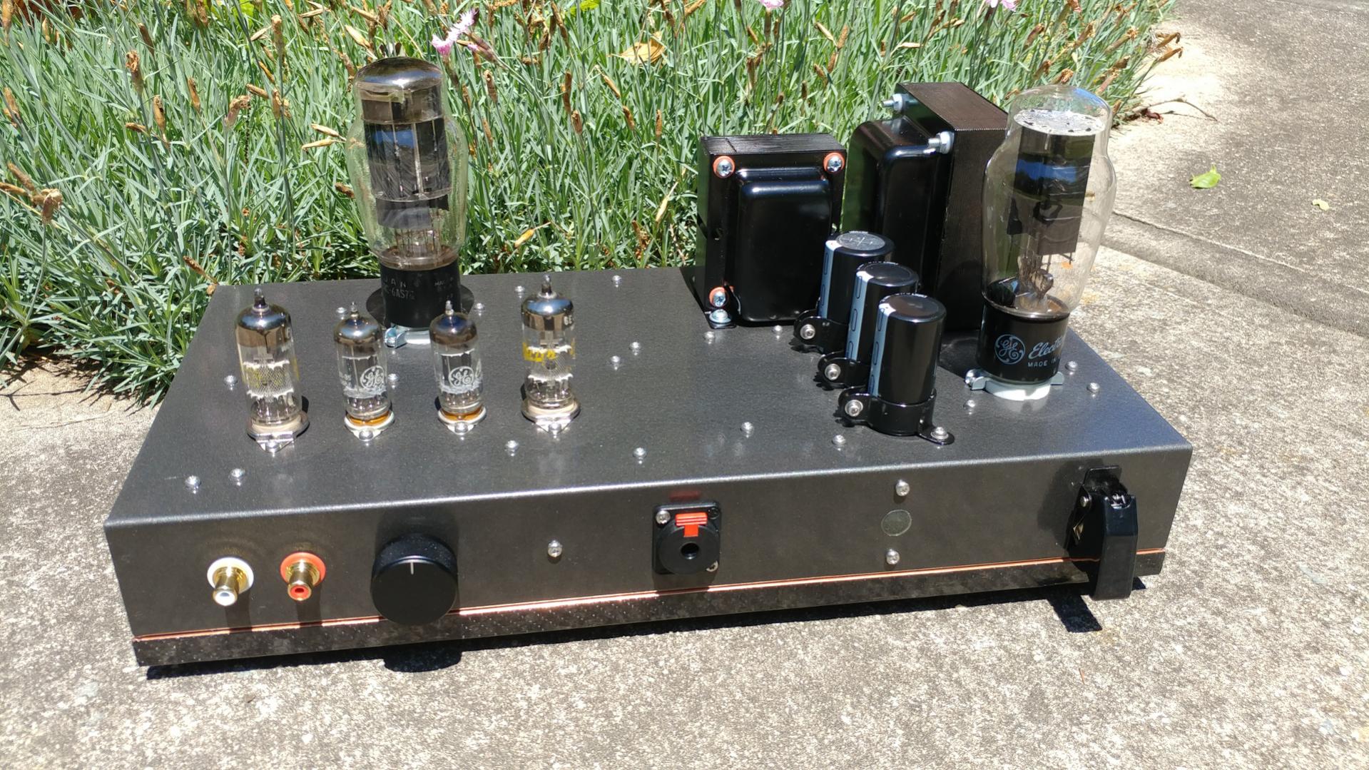

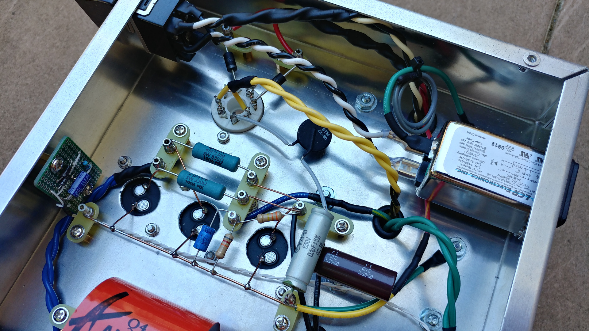

This is my first go at an OTL headphone amp. It's based on the ubiquitous 6AS7 cathode follower topology, and I must admit, I looked at Pete Millett's Wheatfield HA-2 schematic more than once.
I built the amp specifically for my Sennheiser HD6XX, and there's no detectable hum or hiss. The soundstage is spectacular.
The front end is a 6EJ7/EF184 triode strapped with an active load provided by a 6C4 in a mu-follower configuration. I set the negative feedback by ear, and it turned out to be around -10dB.
No problem 🙂
It's this one:
19mm Metal Waterproof 12V LED Power Symbol 5Pin ON-OFF Car Push Button Switch | eBay
Agreed... Of course this seller has stopped shipping to Canada, so I had to find another seller. With the crap exchange rate, 6 switches cost me almost 30$!
Yes you right lot of work but paid off, thanks for your comment...all the best

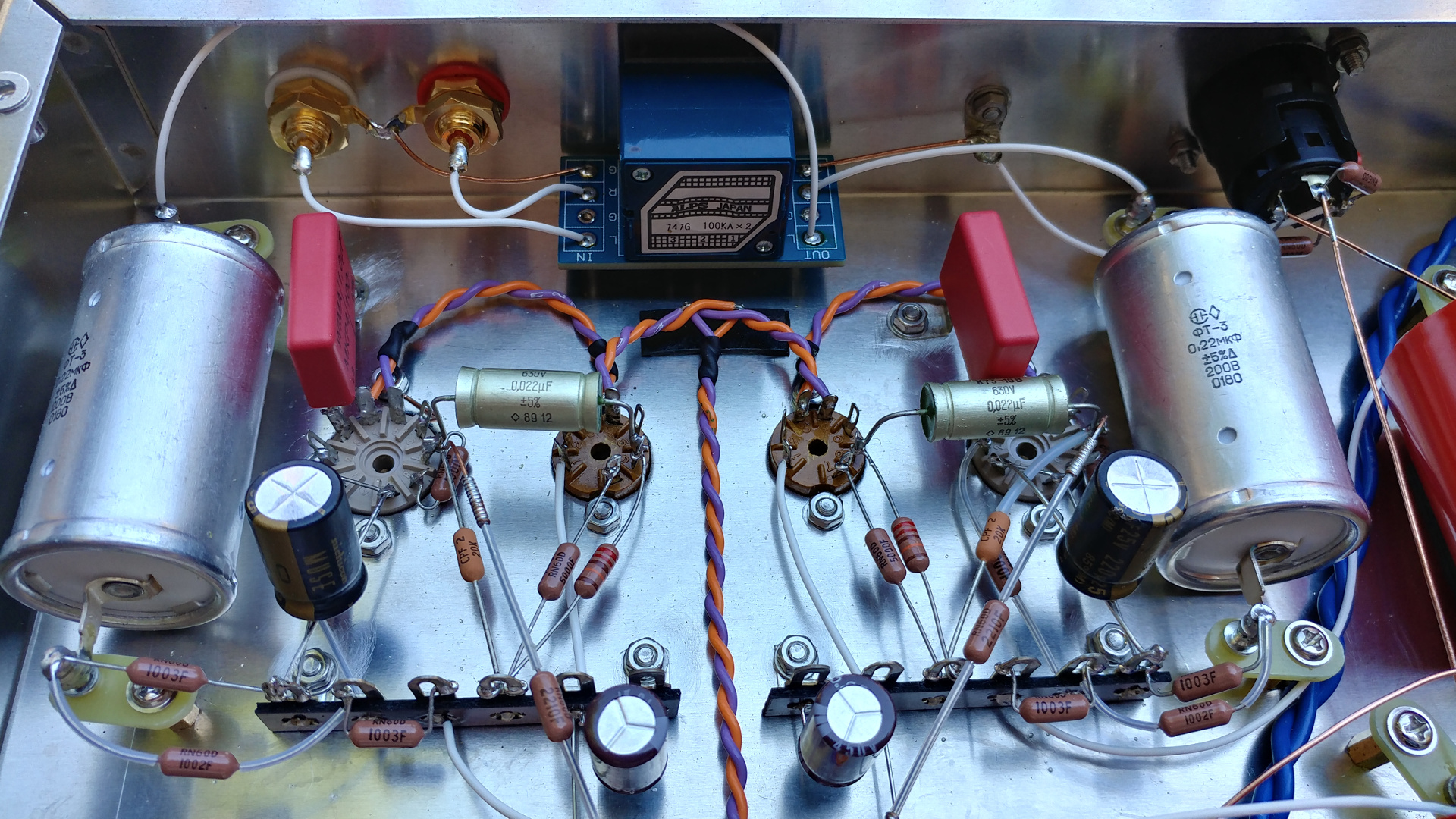

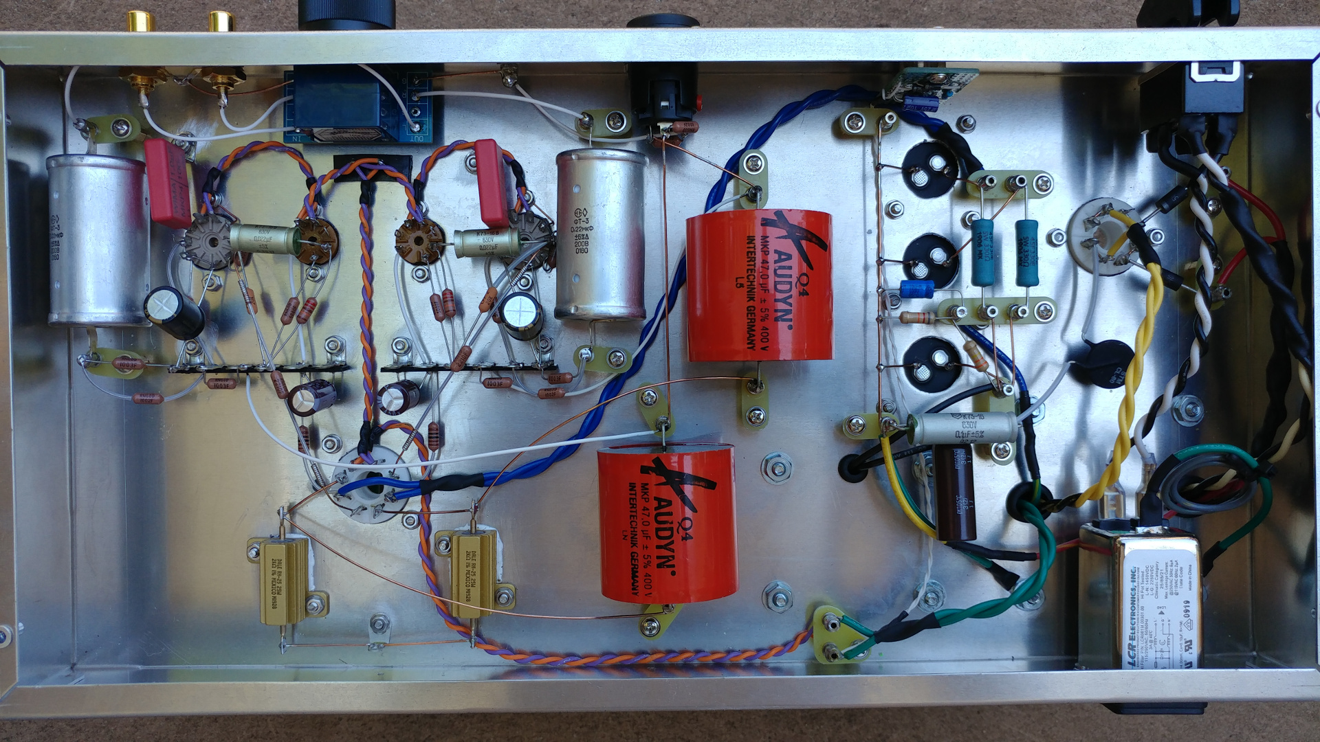

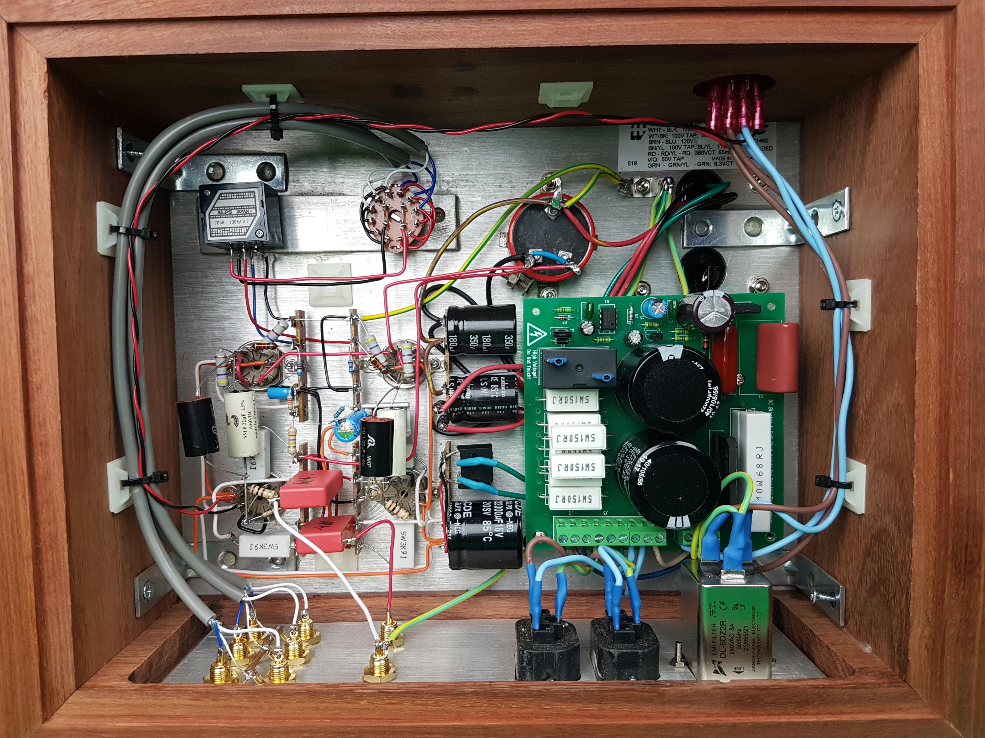

My new pre amplifier.
Active load on the gain stage and solid state current sink on the cathode follower.
Power to the supply and the two auxiliary outputs (one push button start for pre and two mono blocks) is via soft start and DC blocker.
