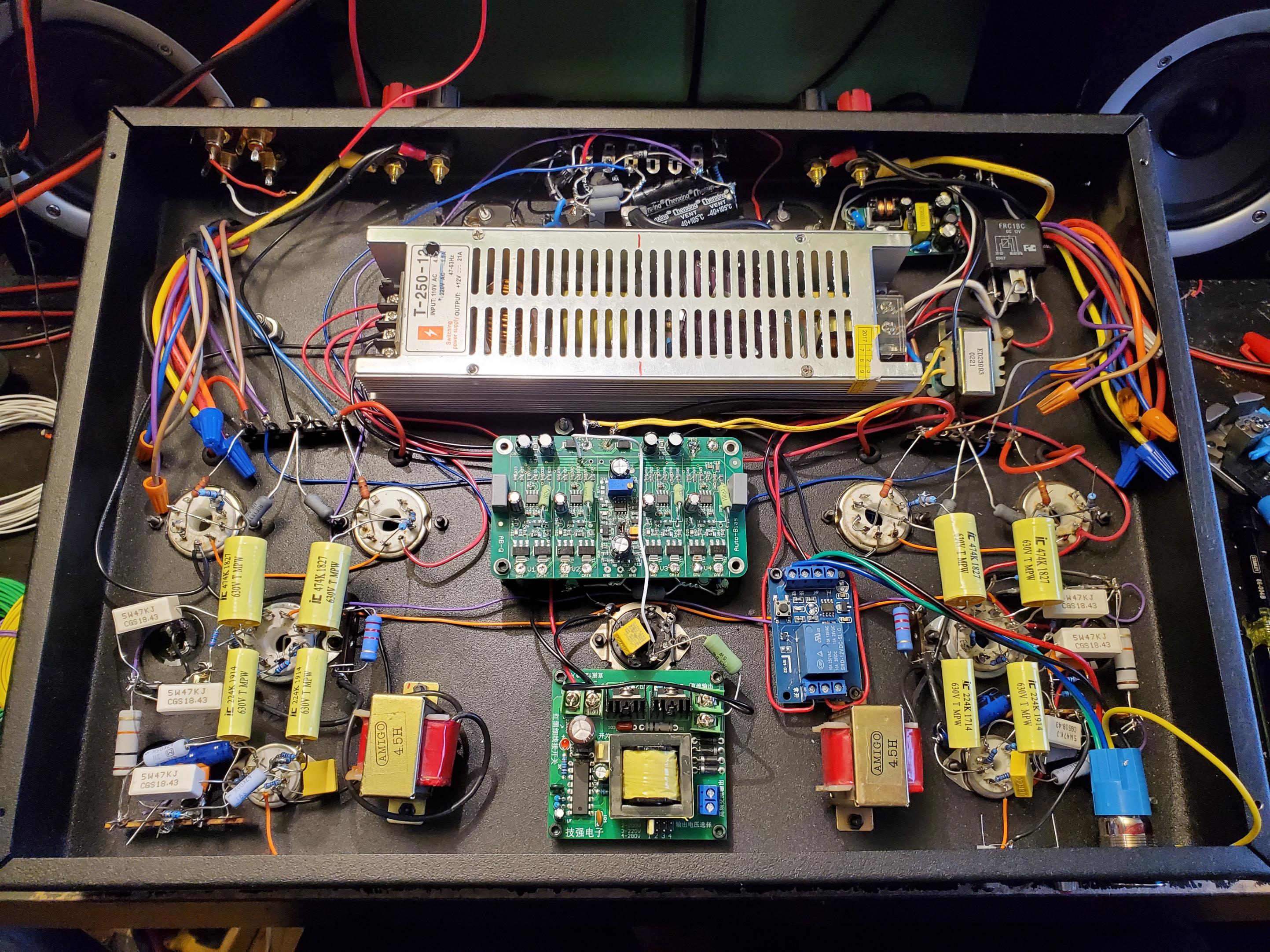

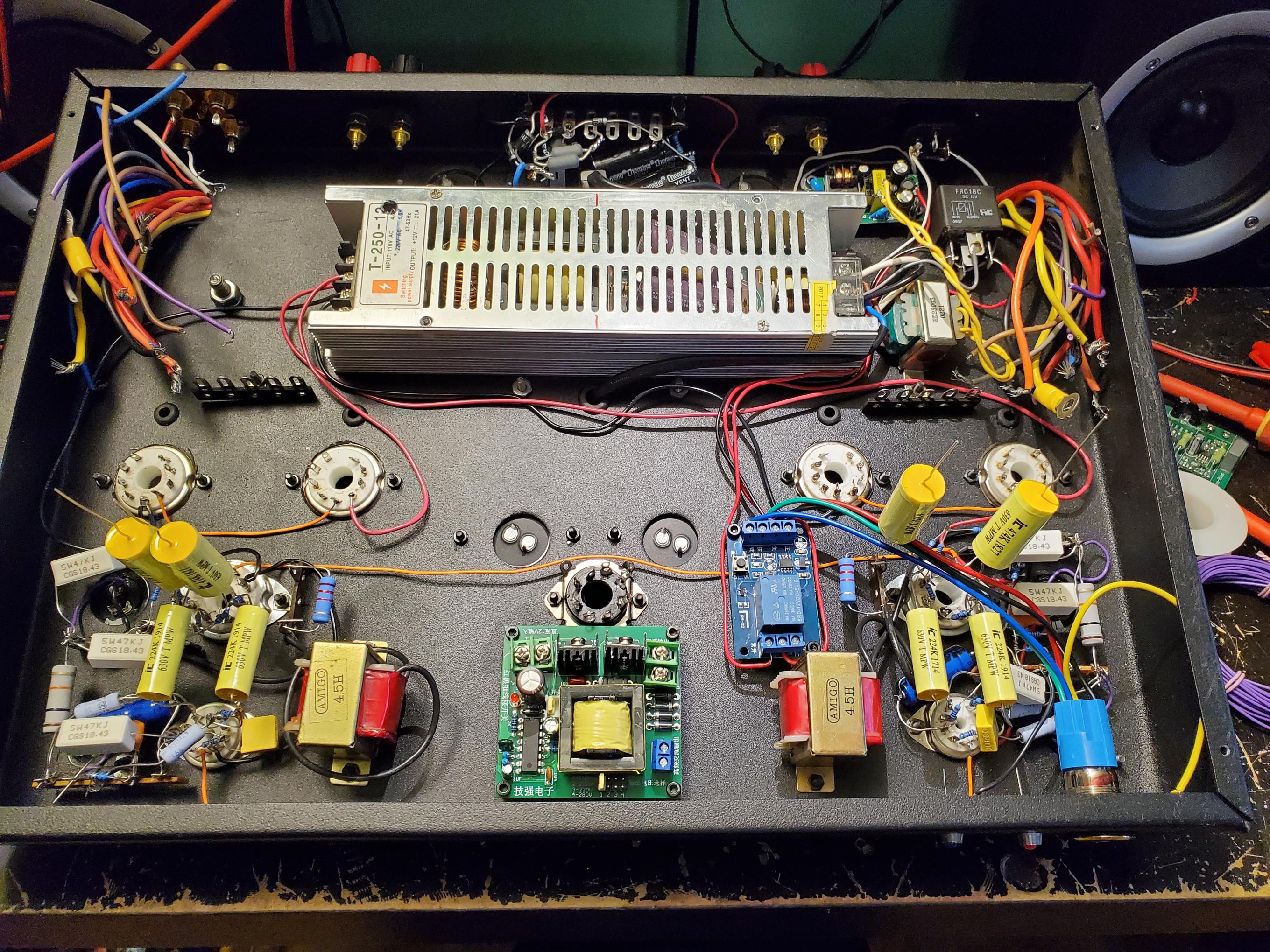

I think it will be powered up today. Just a few more wires to run.
Looks great anyway!
Thanks, Joe! The only Chinese electros (Chenxing - top middle) will be replaced tomorrow with UCC when they get here, too.

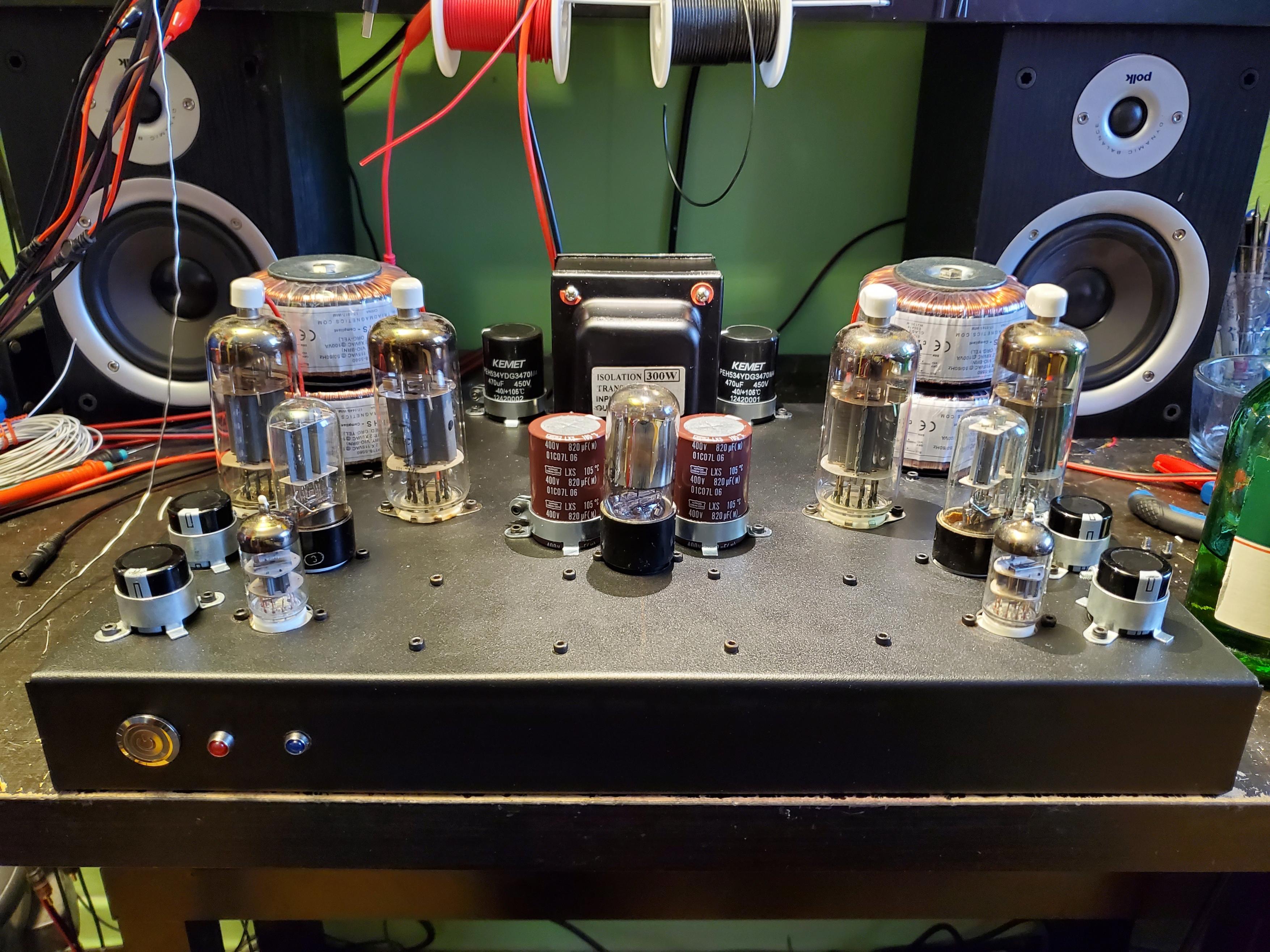

Here's the top...
Just two wires (gNFB loops) left and the chassis electrical ground.
Here's the top...

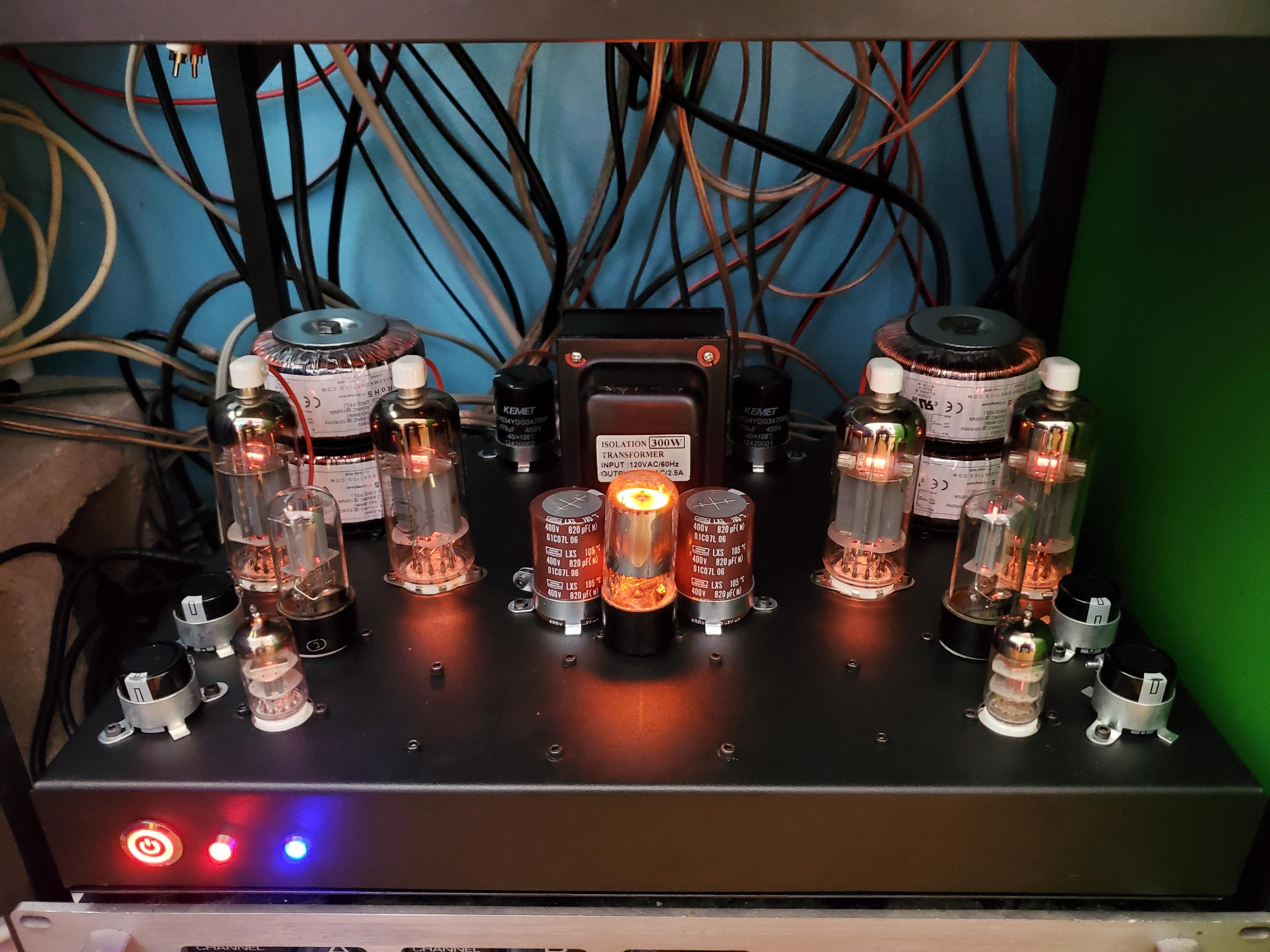

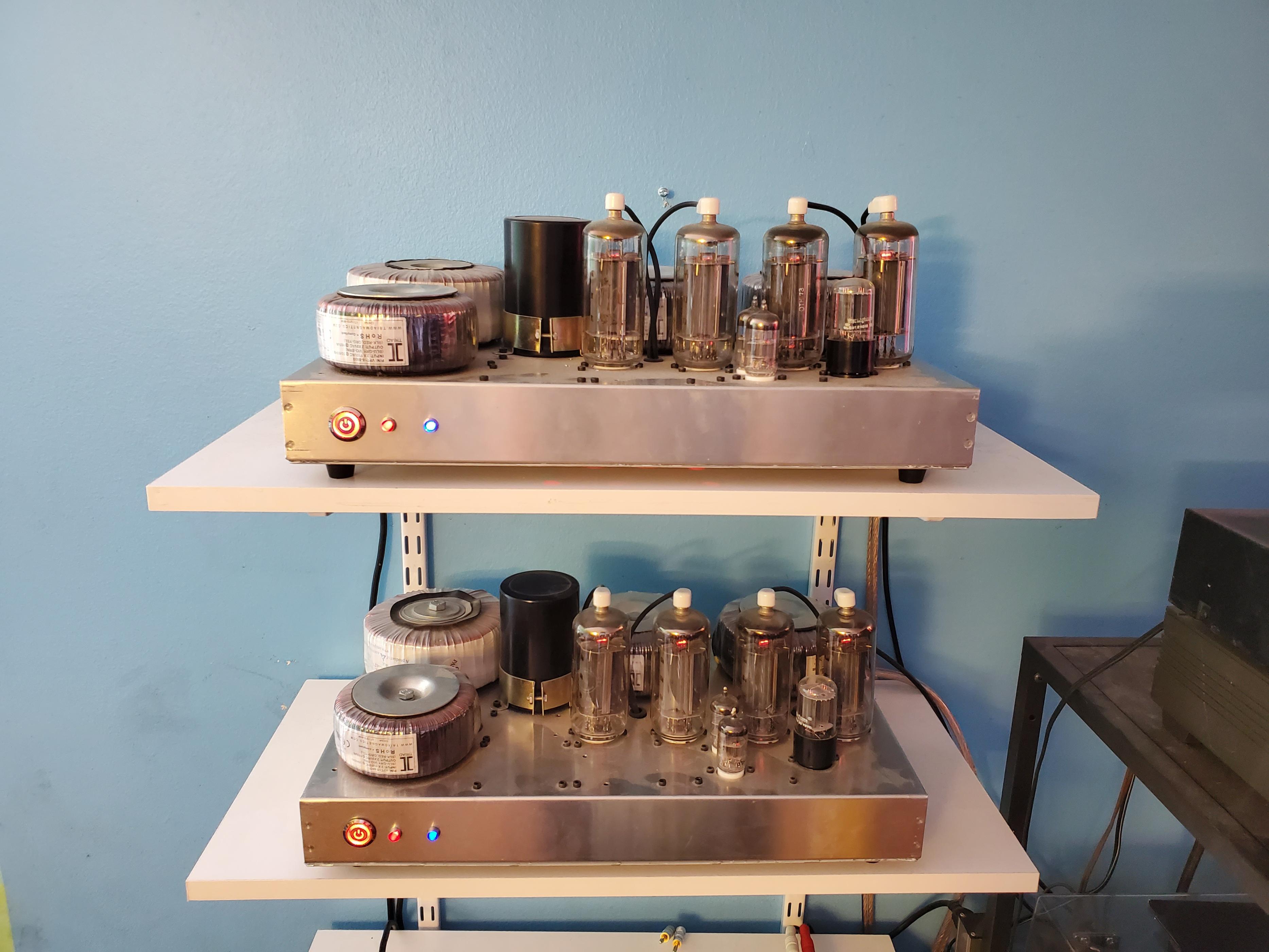

So except for reversing G1 and G2 on the 6F12Ps (mismarked on my sheet) and forgetting a ground for the bias system, it passed the smoke test @ 13h00 EDT.
Today I had a chance to work my monoblocs... Nothing I've heard compares to these triode connected >110W RMS Sine @ 30Hz output amps by yours truly IMHO.
Pure bliss in a bad time.

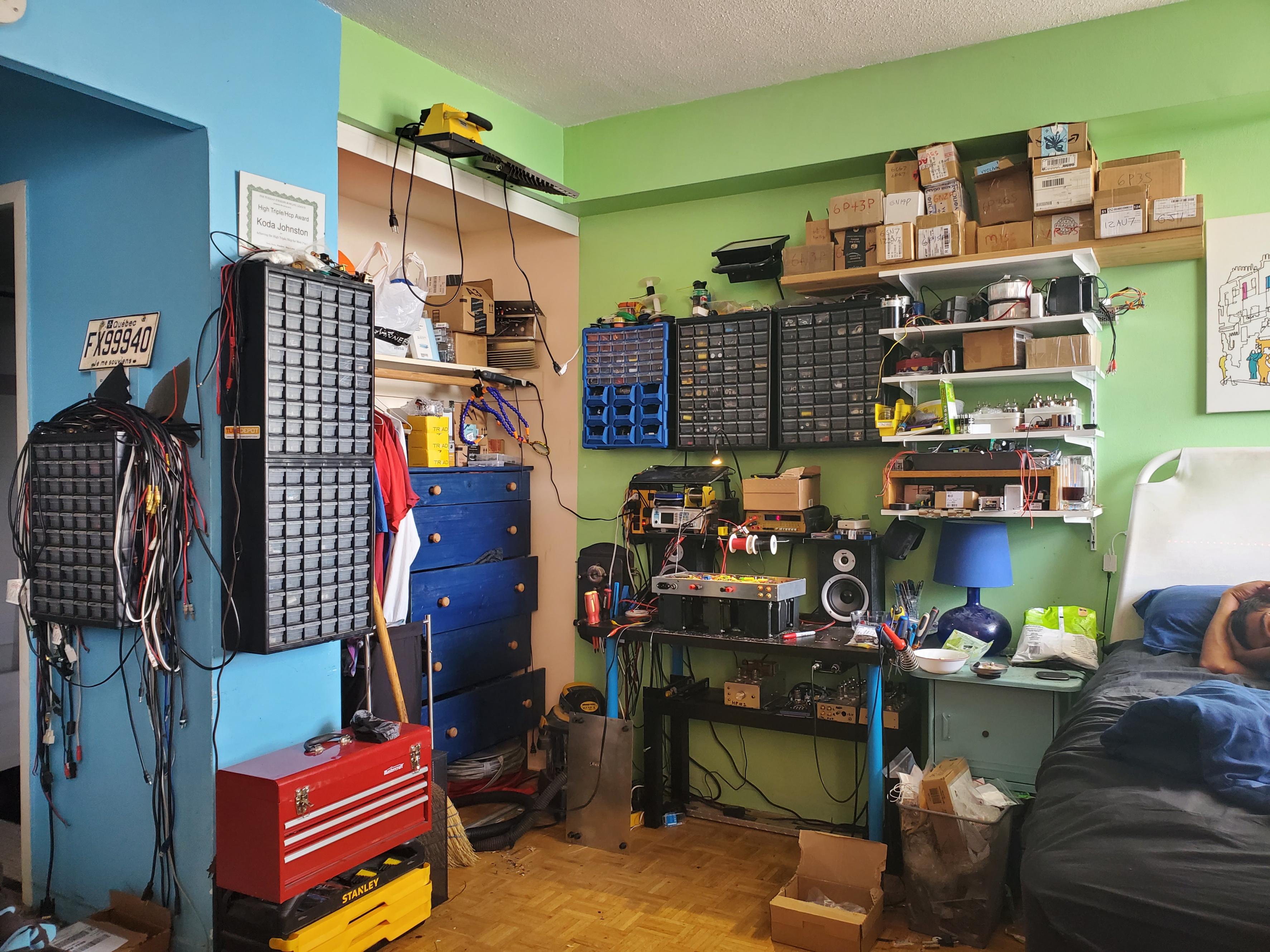

All built in my little "shop" lol

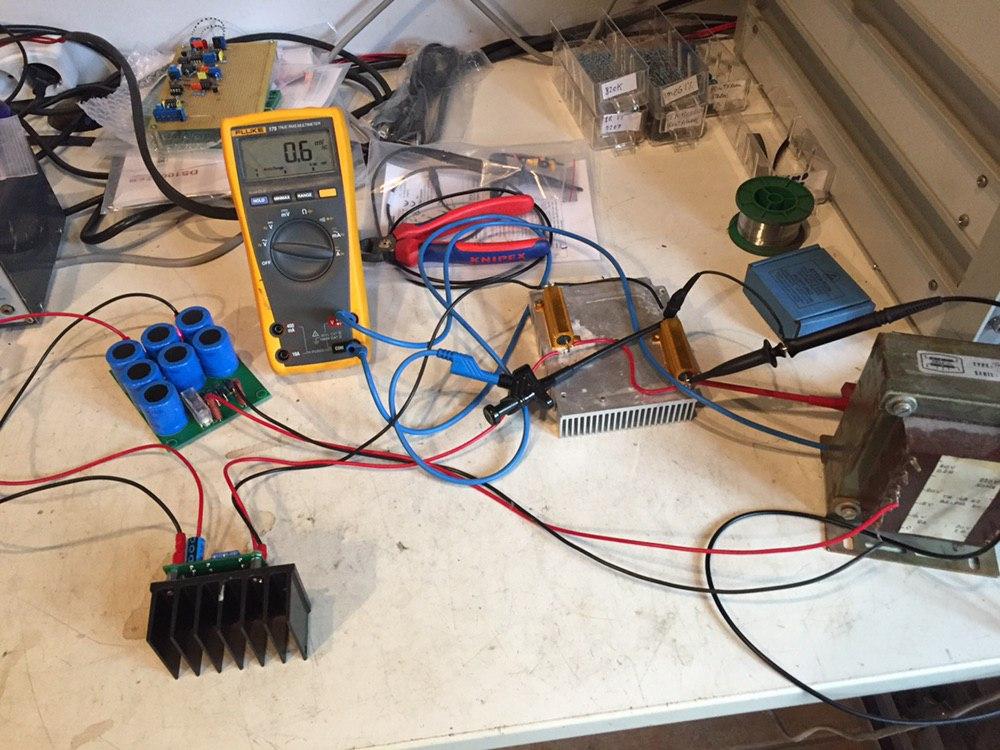

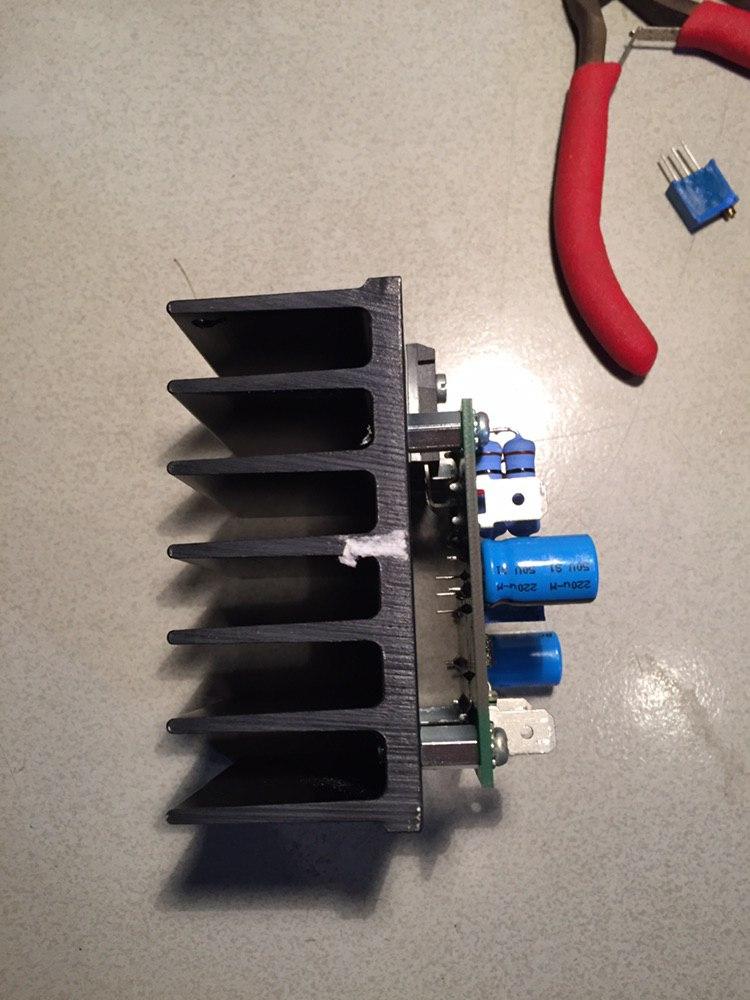

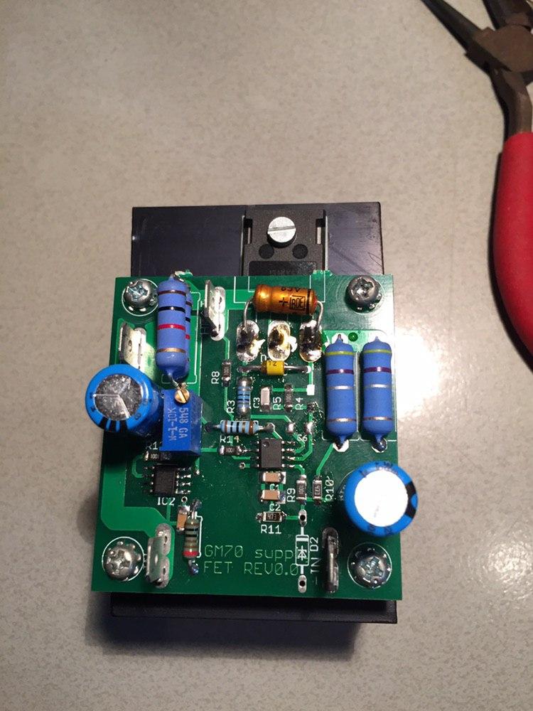

Heres some pics of testing my DHT heater regulator.
This particular unit is 2.5-25V 0.5-5.5A i got boards that can more then double the heater current permissible. Its a voltage controlled CCS with a very long integration time, keeping the internal resistance of the regulator high.
The picture shows the measured ripple at 20V 2A out, my fluke 175 says its about 0.6mV RMS
Why do You think AC O-core OT is with good quality, do You measure Sinus signalThanks 🙂
from 30-40 to 30000 Hz with scope for distortions? Its not important how cost, but how it sounds from 40-20000 Hz. /600 $ are too much....for 200 $ You can buy big 20 W Ш OTs with good sound from 40 Hz /
I've measured for distortion using sinewave, squarewave, and sawwave on the scope. The 1W power band was usable from 6Hz to ~75kHz. The full power output depends on the tubes and transformers used, but the most powerful one's I've built look clean at 30Hz @ 110W and bandwidth extends beyond 50kHz.. The 10kHz square wave response is very nice, too. For 200$ These effectively make a 100W transformer. Try it for yourself and If you think it's crap you have transformers for your heater supplies.

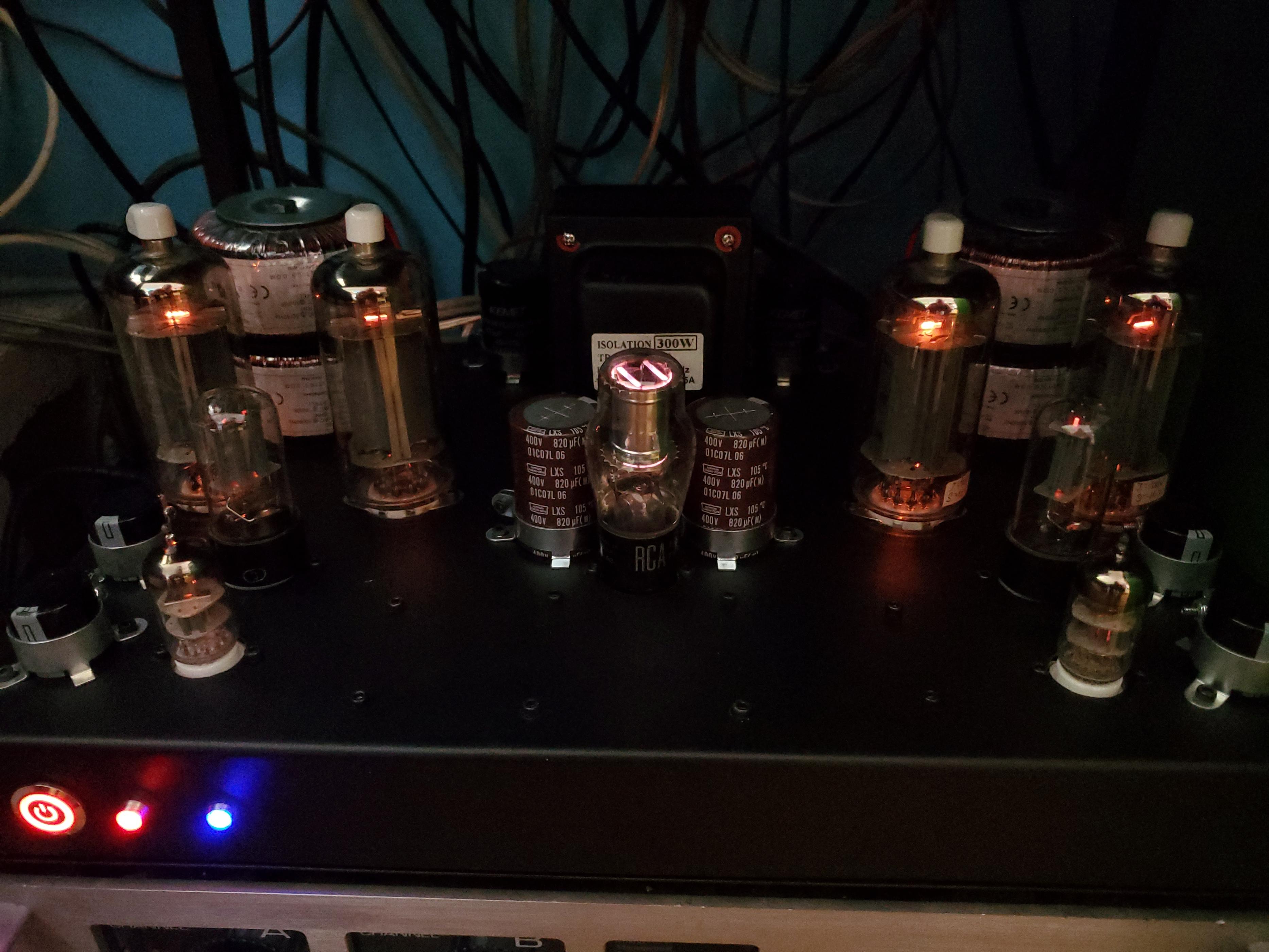

I also fitted this UCC caps, changed the tubes from 6P36 to 6P45, and changed from VR75 to VR105 because they need more bias voltage. I'm quite pleased with it.
now Jason, where is that like button? this is an awesome build....
