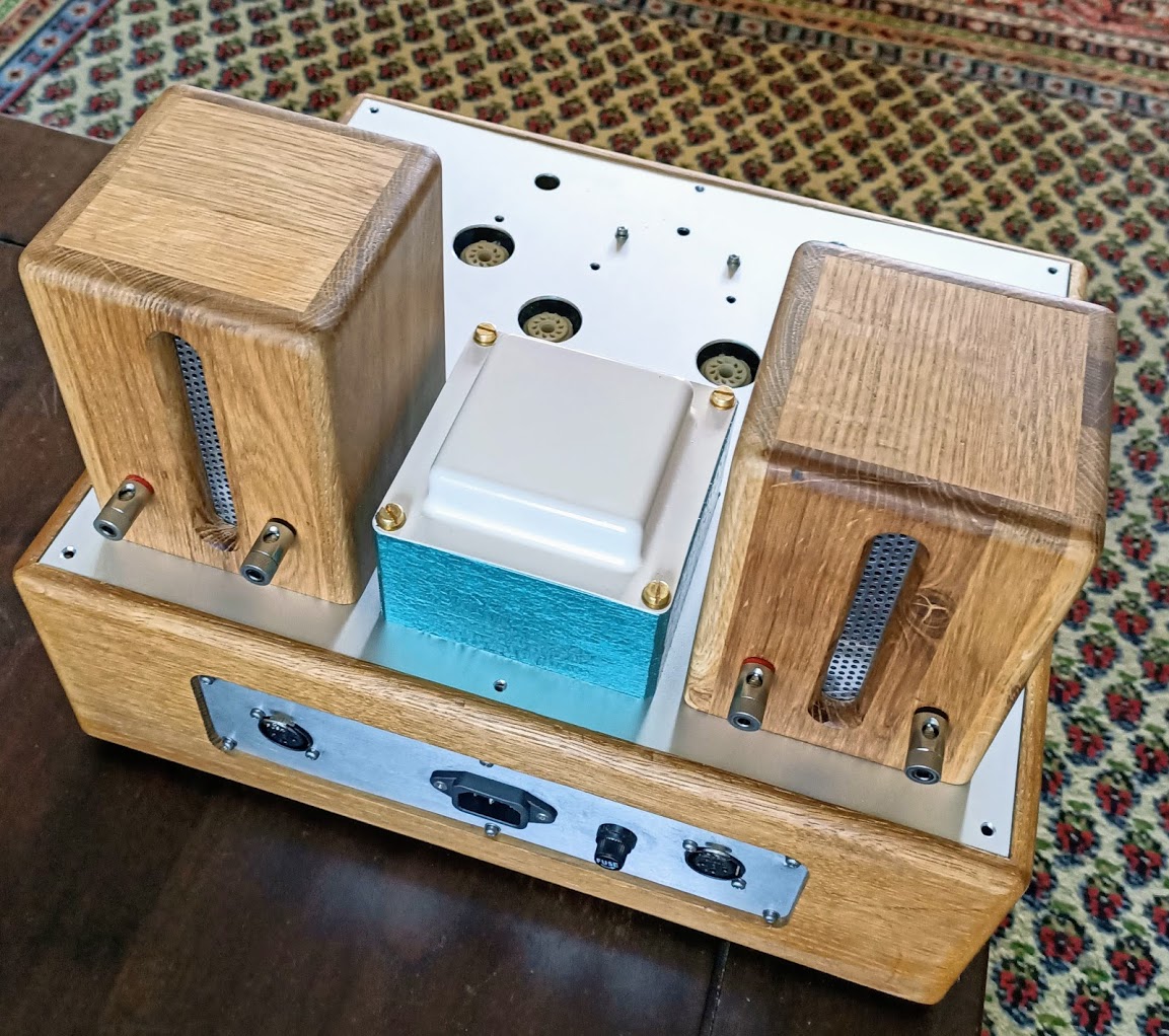

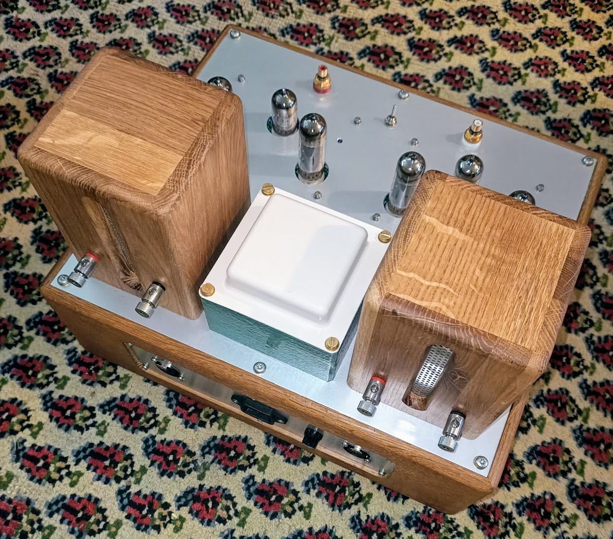

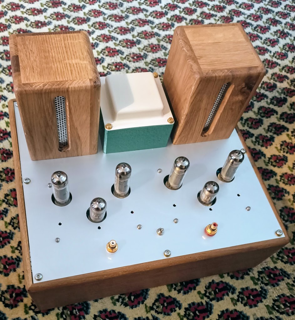

My dad turns 74 this week... I built this for him 🙂
Total cost about 300$ CAD.
~10WPC 14Hz-50kHz
12SN7 front end, 6F12P VA/PI, 6P43P output, triode connected, Eff Ra-a ~3k@8R using interleaved Triad VPT12-2080 as the OPT.
I love it, can you please explain how you used a couple of power transformer like the VPT12-2080 as OPT? ....all the best

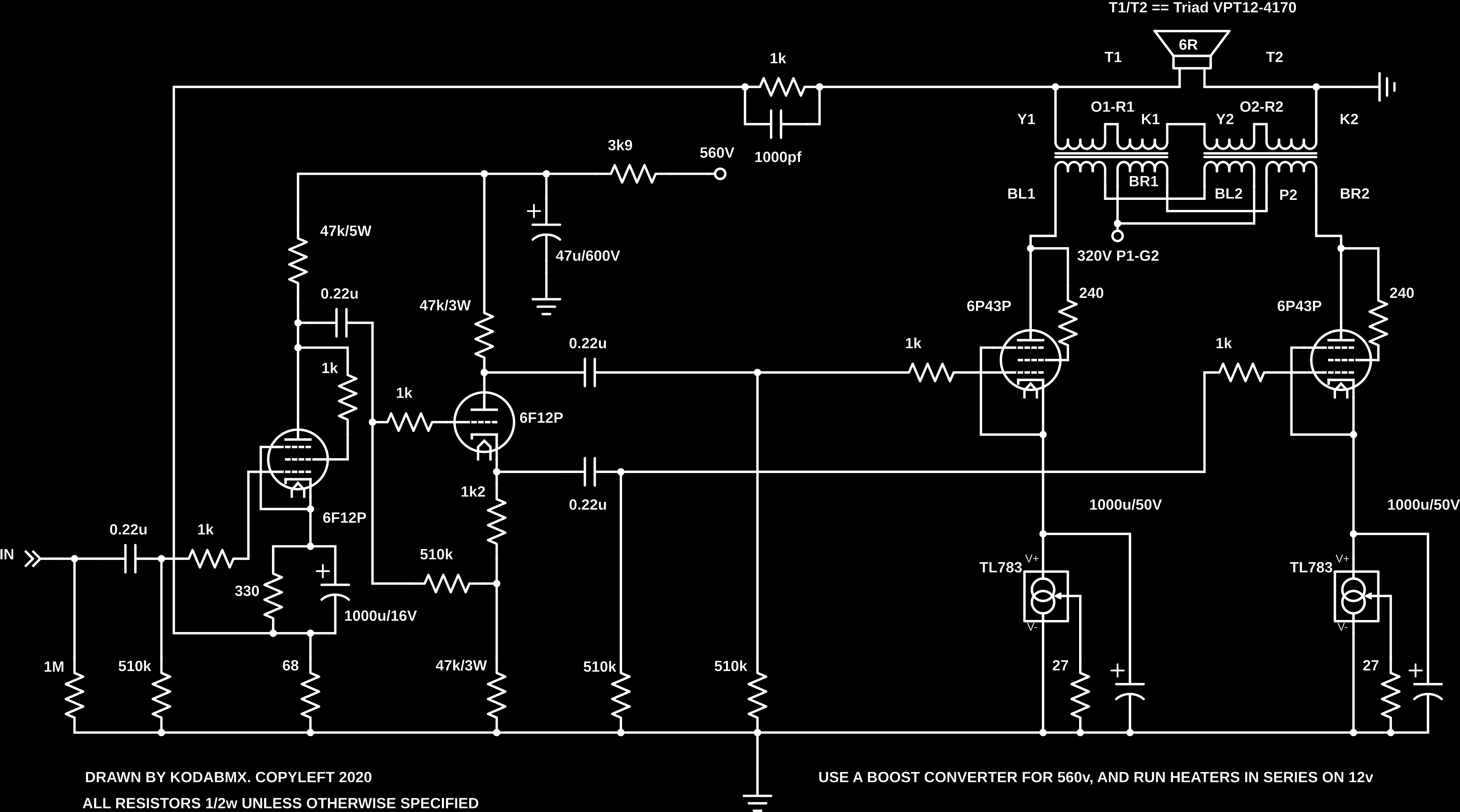

kodabmx,
That amp looks great!
It looks like you used 2 toroids per channel.
Did the toroids have dual primaries, and did you connect them so as to have a "center tap"?
And then parallel 2 toroids dual primaries; and parallel the 2 secondaries?
Or, did you wire one plate to one toroid primary; and the other plate to the other toroid primary, but in opposite phase (plate to B+) versus the first toroid?
And then parallel the toroid secondaries in opposite phase to make it all work?

Thanks.
Yup. Dual pri, dual sec.
I interleaved the primaries and connected the secondaries in series for about 2k2-6R

This setup consistently outperforms any of the EI transformers I've used. Much better LF response, too.
And of course 4 of those coils costs less than one standard EI OPT of the same VA rating...
Here's the complete schematic minus PSU for anyone who's interested.

Great, thank you for sharing the schematic. Is there any possibility for SE OPT using similar arrangement?
Thanks,
Bibin
Since there is no gap, you would need to use one of the windings to counteract the DC flowing.
You could use a big resistor to load one side of the primary (or build a PP amp and ground one power tubes' grid), or you could use one of the secondaries, and say a 12V PSU with adjustable current to get the nulling in the core. Otherwise, this is really only suited to push pull.

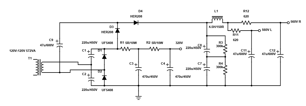

Thank you for the details, better to try the same PP then. Can you share the details of PSU and boost converter?
This is the basic idea using a quadrupler instead of the boost converter... Also it's mismarked... 560V is more like 640V...
Search eBay for "12V 280V" and you'll find the DC board I usually use though.
Thank for the PSU details

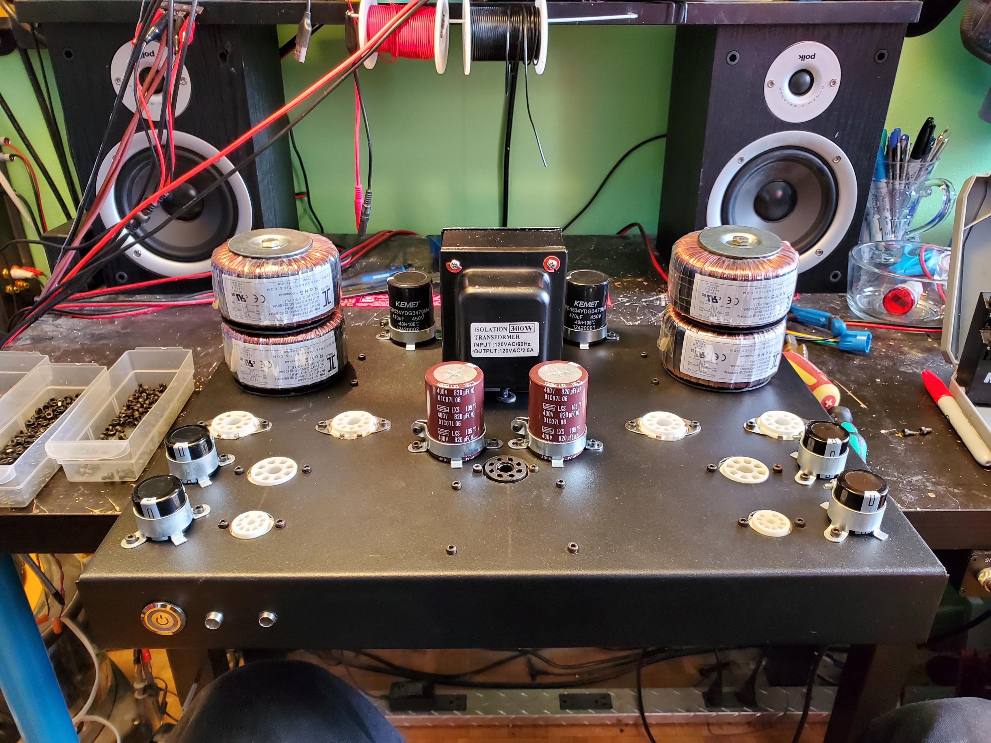

Starting another build... Not bad for a few hours work... It was a blank chassis this morning 🙂
Looks interesting, and expecting more photos of your build.
