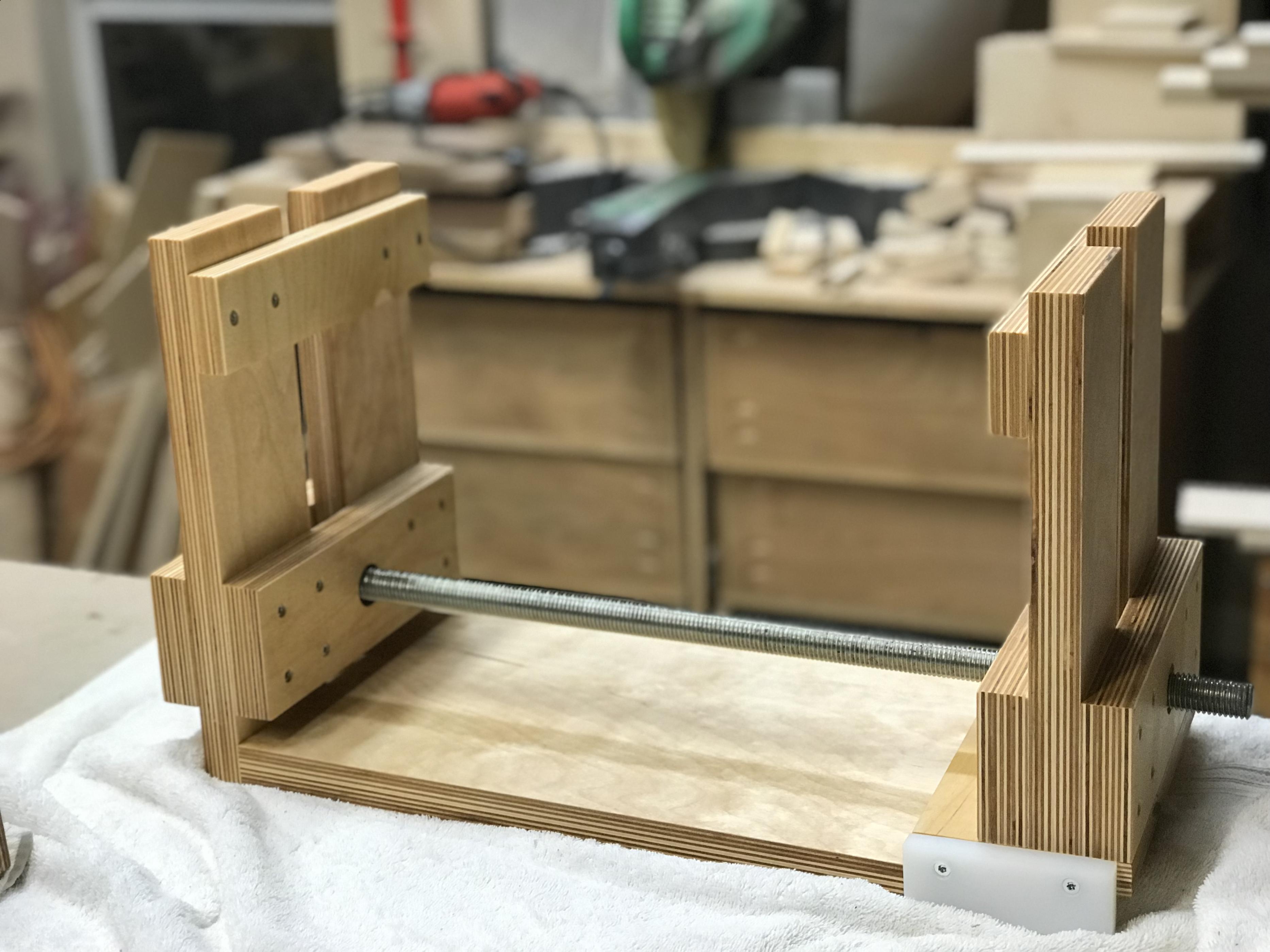

I've fancied something similar for when working on amplifiers. I like the larger units that the tube amplifier people use but I don't own one yet.
I threw together a somewhat similar stand awhile back. Mine doesn't rotate, but it works very well. Especially handy with chassis full of iron.
Was a quick and easy build, with mostly leftover pieces from various projects.

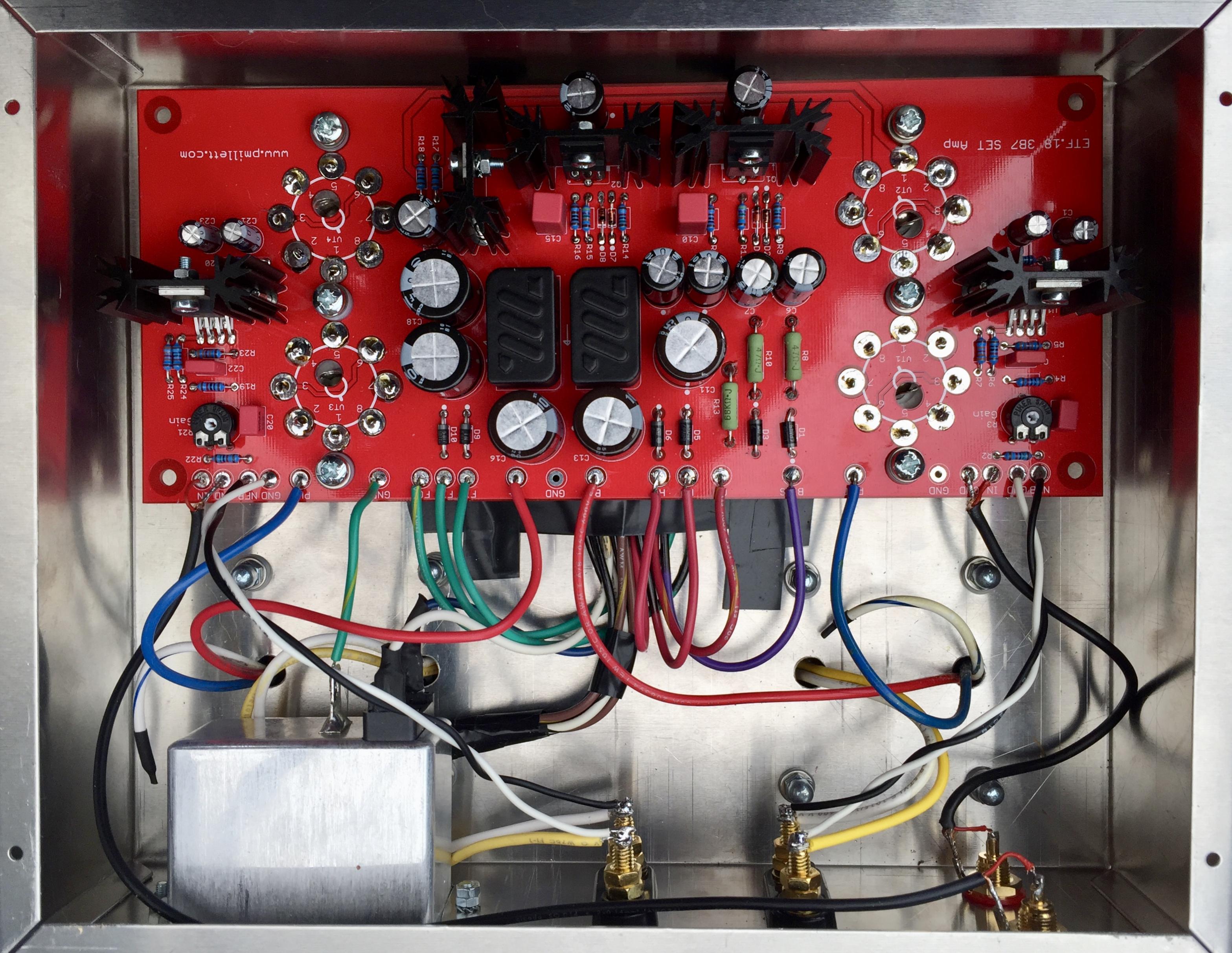

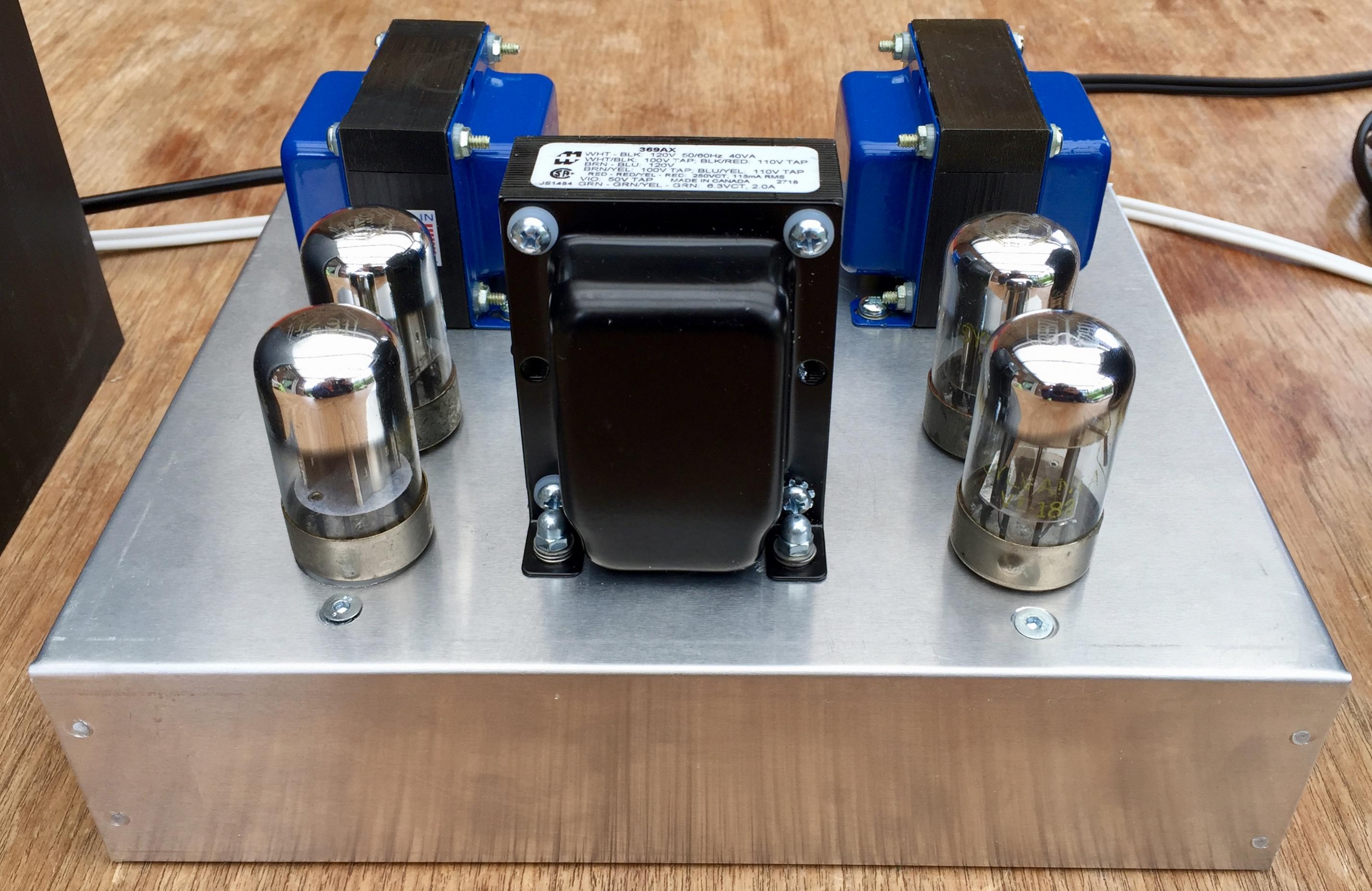

I have just completed my build of Pete Millet's 3B7 SE DHT class-A2 hybrid amplifier (3B7 SE A2 Hybrid Amp).
It sounds amazing, I will use it in my office where the 2.5 watts is more than enough.
The output valves are 4 VT-182 double triodes that was used in battery-powered field radio sets during the WWII and the Korean war.
The VT-182 valves are driven by OPA452 opamps. The power supply has 4 rails: 2.8V for the filaments, +/- 40V for the opamps and 160V B+. The B+ supply is filtered with MEC-100 chokes from Tentlabs.
This is my first amp project so I did learn a lot building this. One thing I learned from reading the specifications is that the LT1084 voltage regulator has vOut connected to the tab and the OPA452 has the tab connected to V– supply. As the heatsinks are connected to ground the tabs should be isolated.

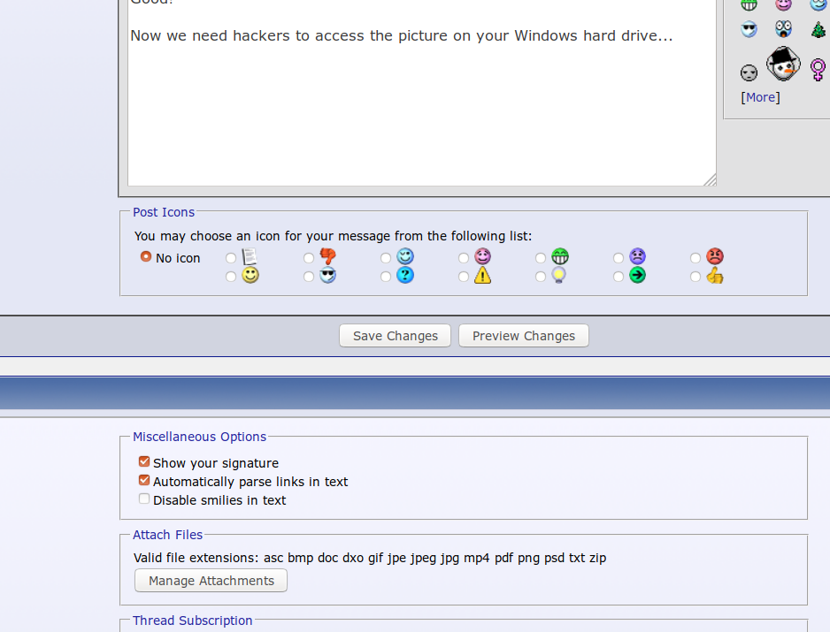

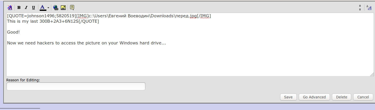

Now we need hackers to access the picture on your Windows hard drive...
Click "Advanced", "Manage Attachments", "Upload".

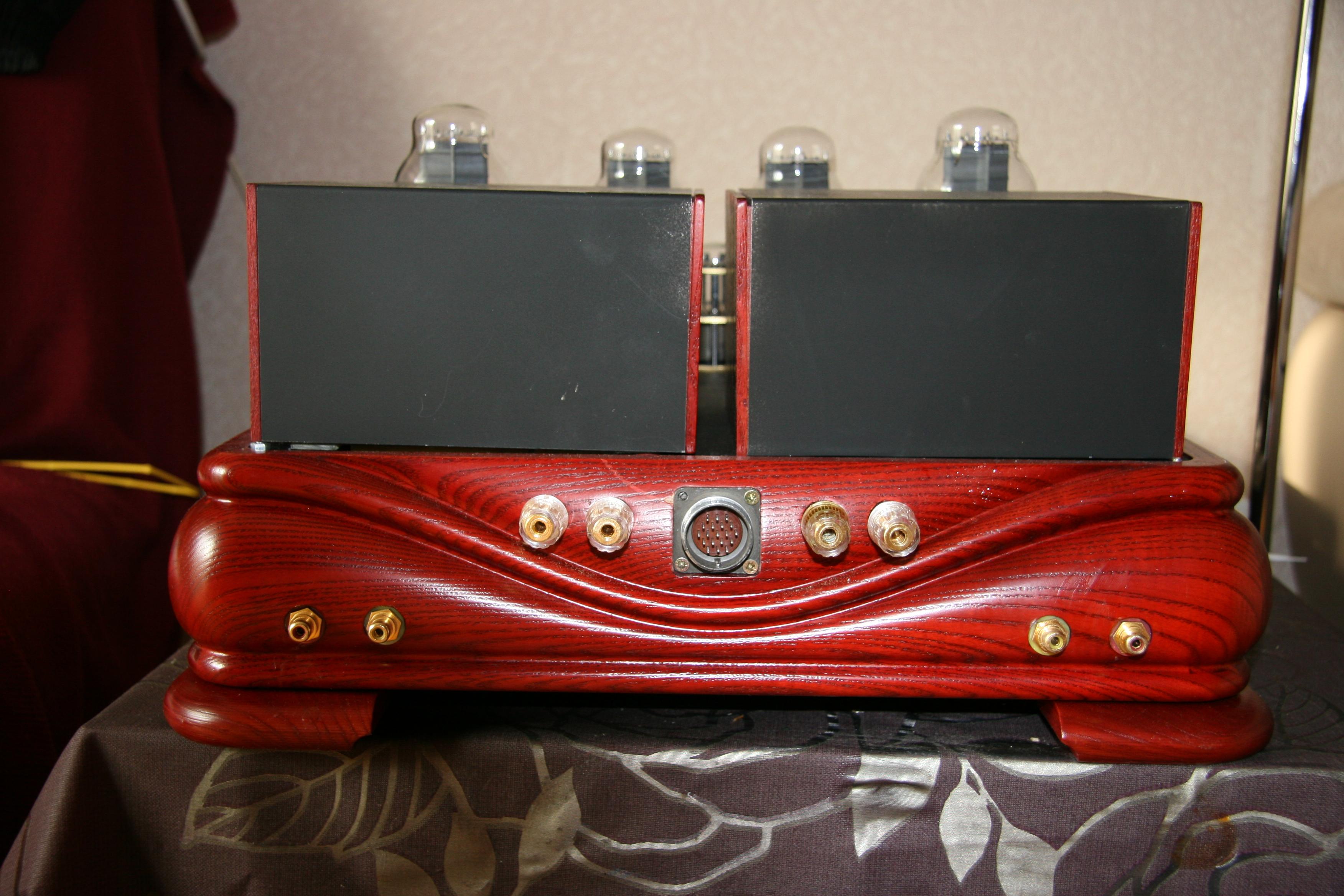

300B+2A3+6N12S 🙂
What a wonderful woodcraft!! Did you do this?
