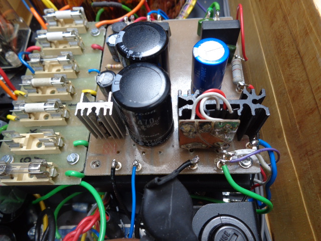

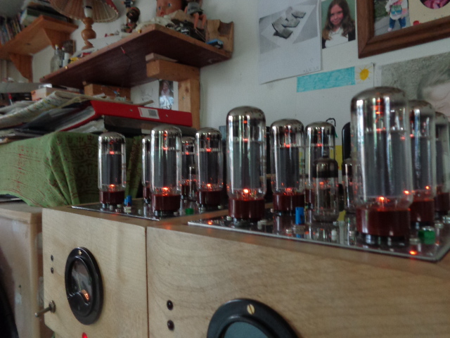

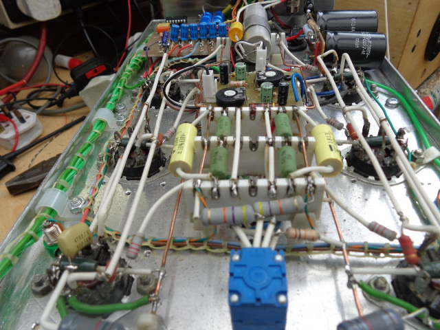

I've finally finished my first valve amp build, it's taken about two years. I built the amp once in one chassis, wasn't happy so started again.
Each mono block has it's own PSU with a 625VA handwound/overwound toroid mains tfmr with 9 second soft start for the HT/B+. There is also two protection circuits so that that if Ik of each EL34 exceeds 100mA a thyristor engages a relay that cuts the neutral to the main tfmr as well as no speaker/load protection.
Specs - 0.01% @ 1w, 0.07% @ 10w, 0.21% @ 50w and 0.28% THD @ 112.5w this at 1khz. N/ripple = 20mV. F response 3dB @ 1dB @ 5hz, flat to 28khz, 3dB @ 33khz.
Valve line up 6AU6 triode strapped for the front end with CCS load, two ECC99/6H6N's as the LTP phase splitter with CCS in the tail.
OPT's are Hammond 1650TA, caps 105 deg mostly of reputable makes, Bourn pots, Vishay resistors so most components of good quality but not boutique.
Woodwork is sycamore, hand planed from a tree, took ages as my tools are very basic. Chassis handmade from 2mm ali sheet.
Lastly though the design of most of the amps is my own work I lifted quite a few ideas of Patrick Turner and also picked his brains via email, thanks Patrick. Anyone wishing to build high powered amps or any valve/tube amp should have a butchers at his site, an invaluable resource for tinkerers and artificers.

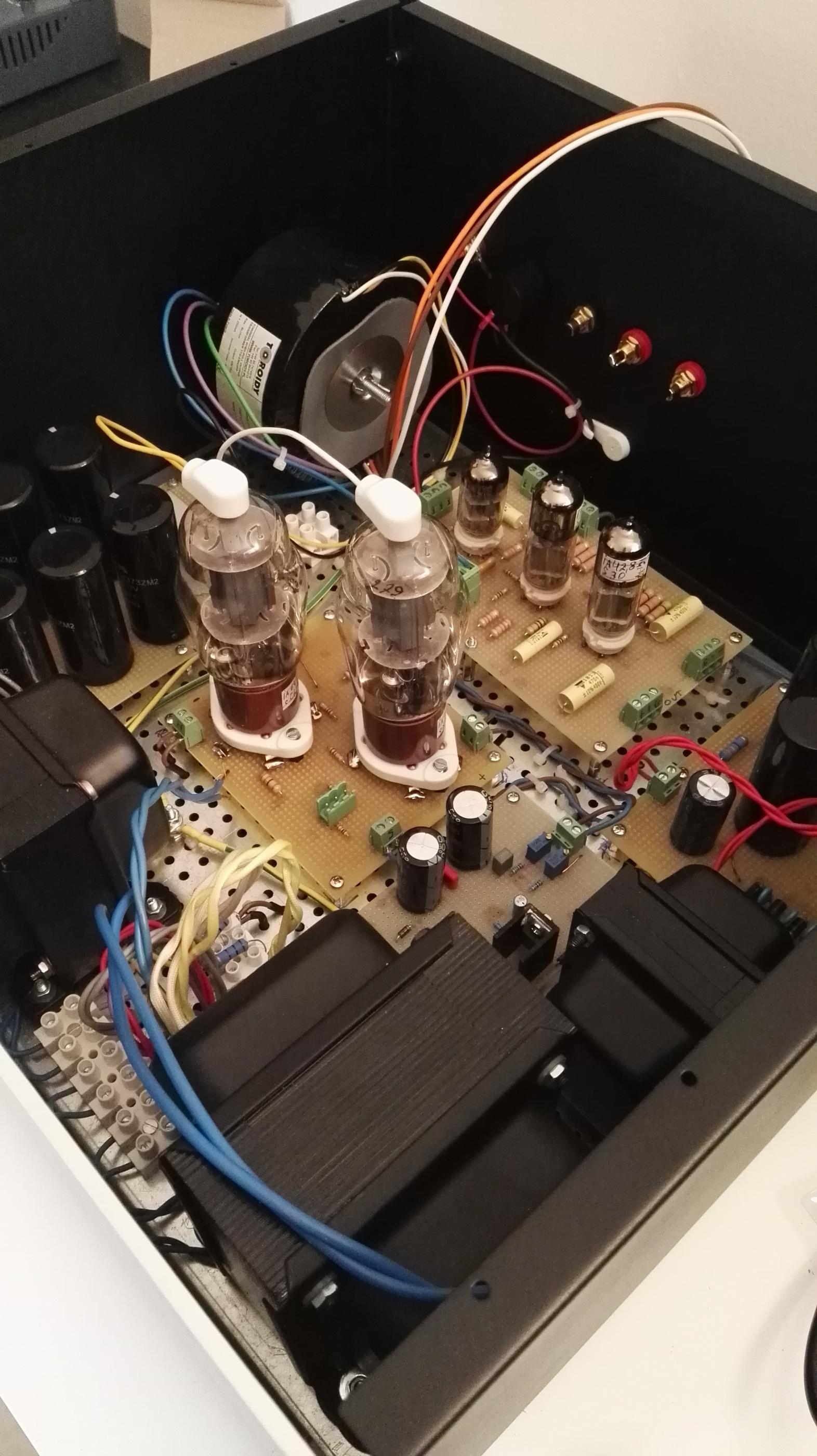

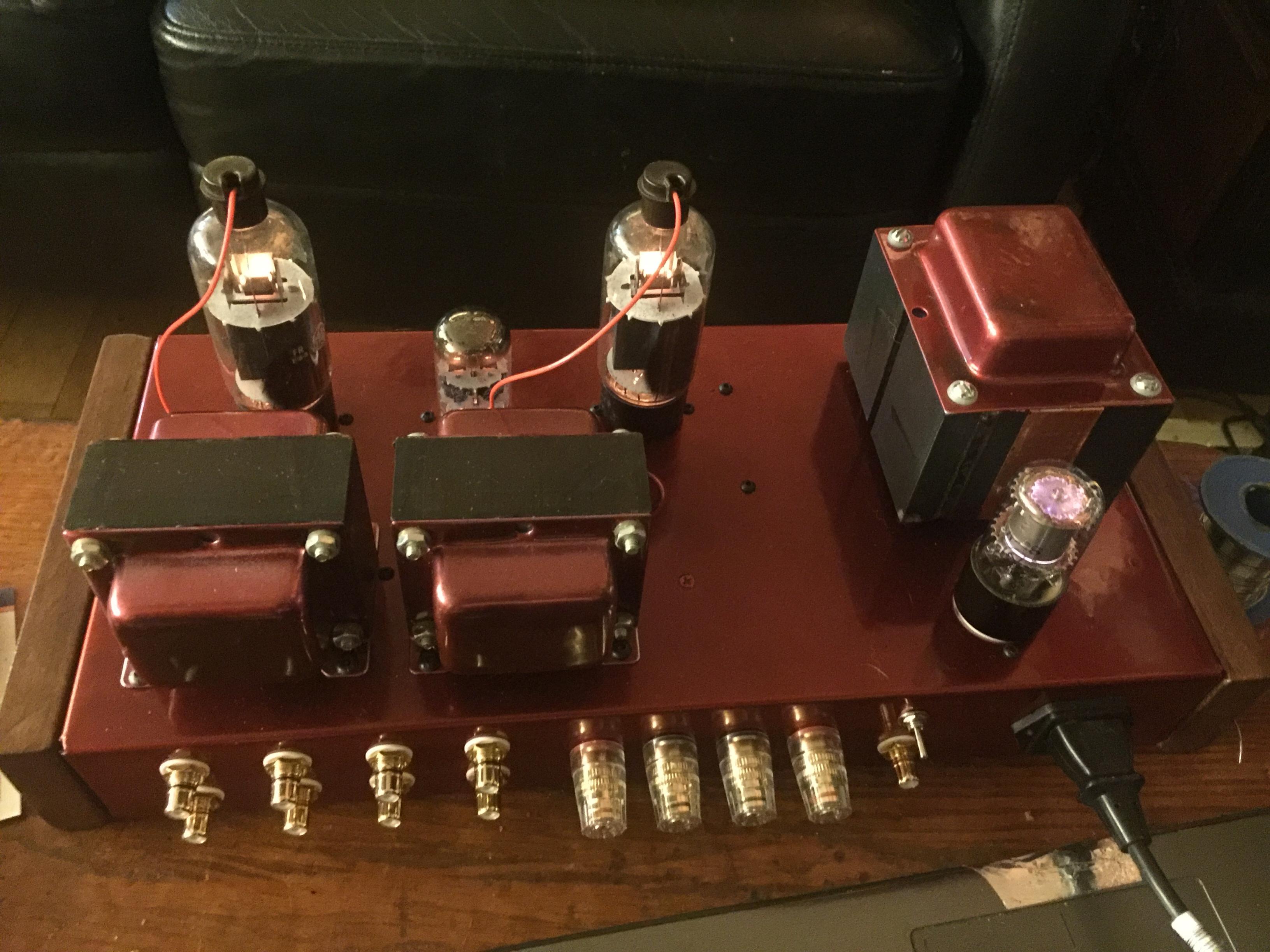

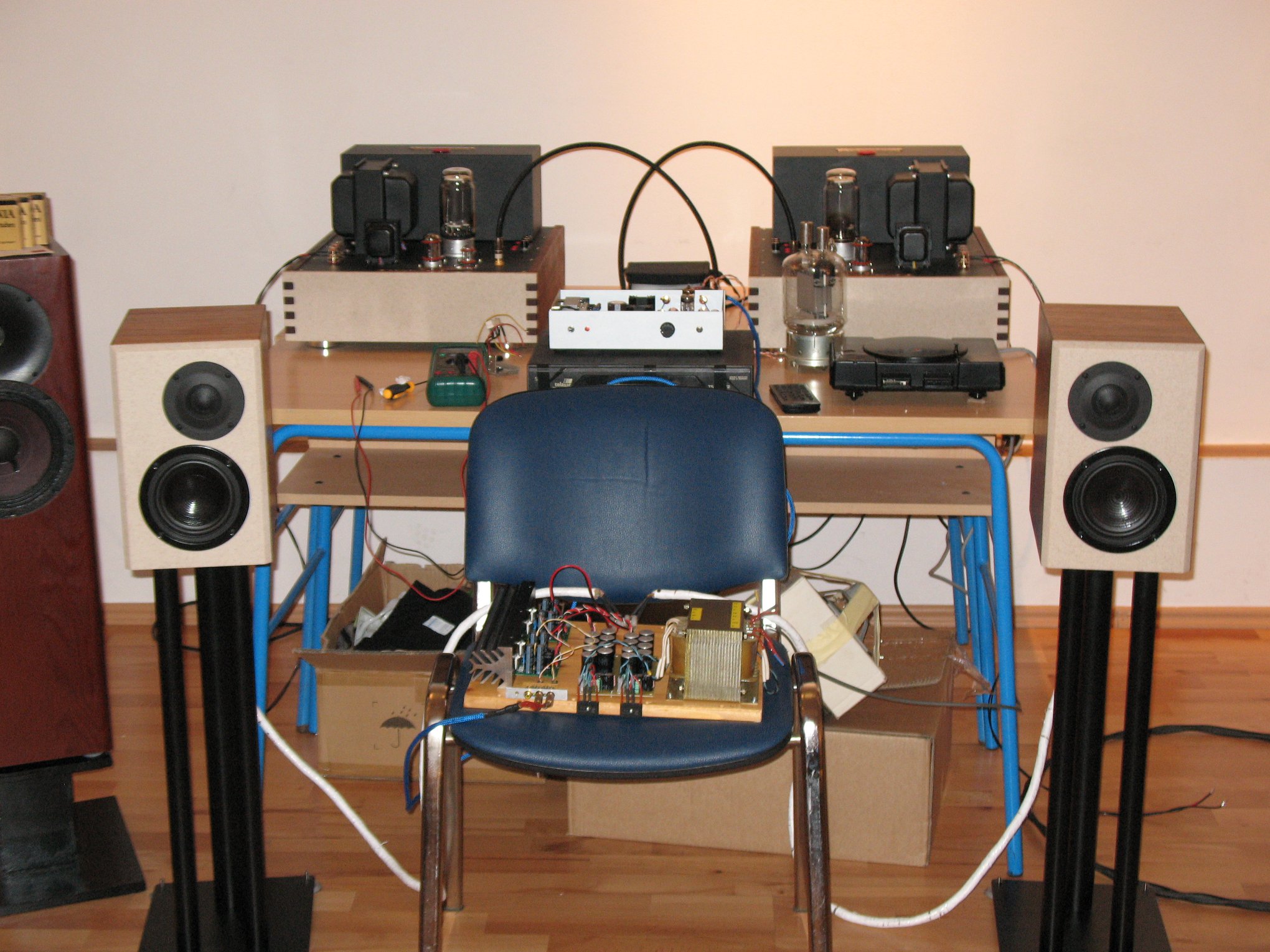

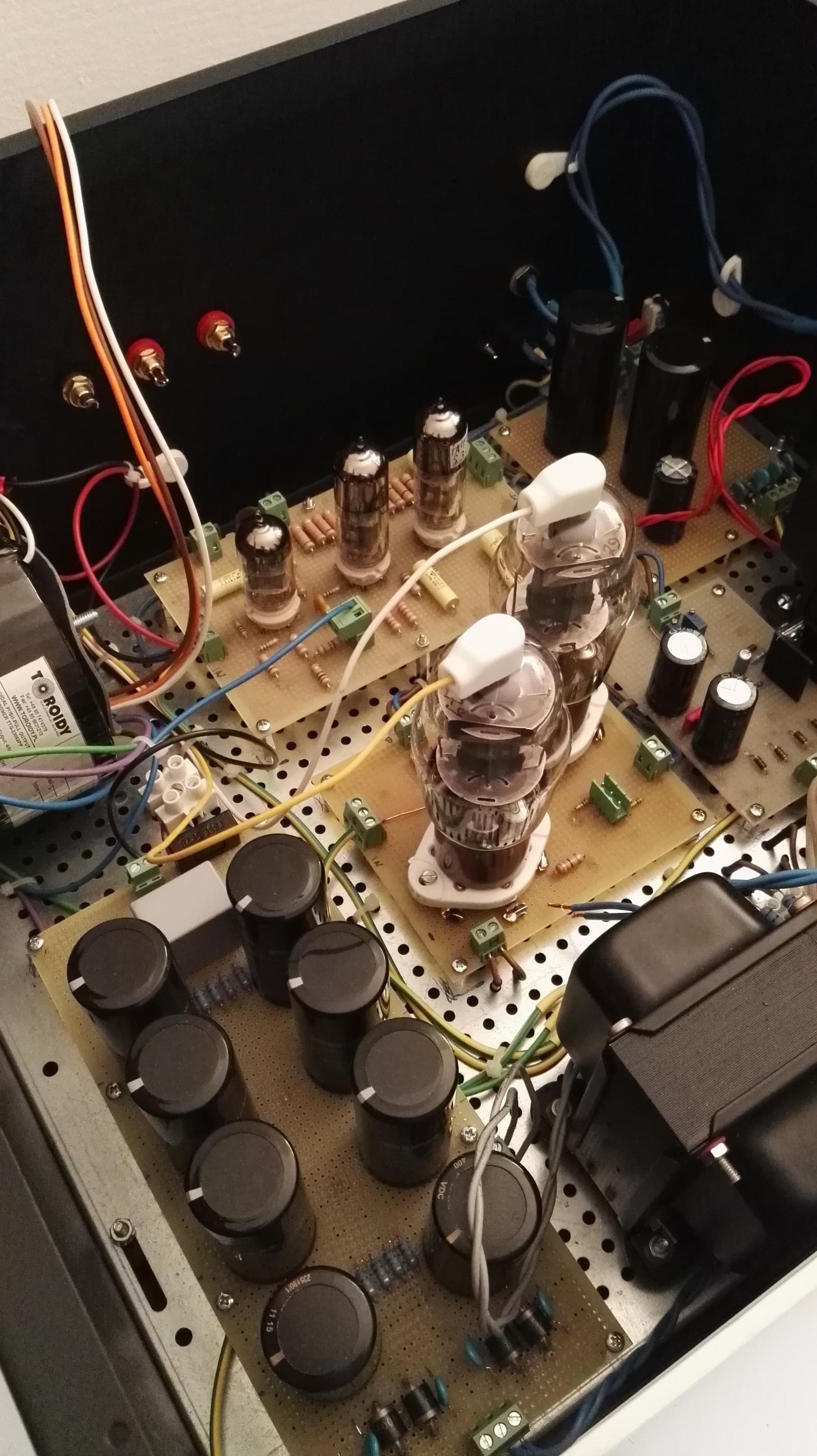

Hi all, here the first, almost completed, of the two monoblocks: 40W with 6N23P input, 6E5P driver, G-807 output. Separated CLC supply for input - driver and output tubes. Fixed bias.
Wavebourn,
Always great looking amps.
150V Screens?
danco.vim,
Fine looking amp!
And really stuffed.
I always loved 807 tubes, have used some myself.
150V Screens?
danco.vim,
Fine looking amp!
And really stuffed.

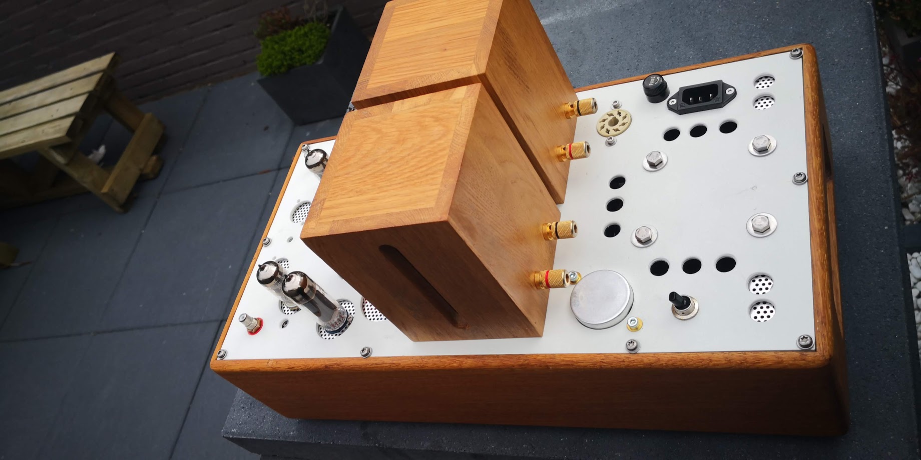

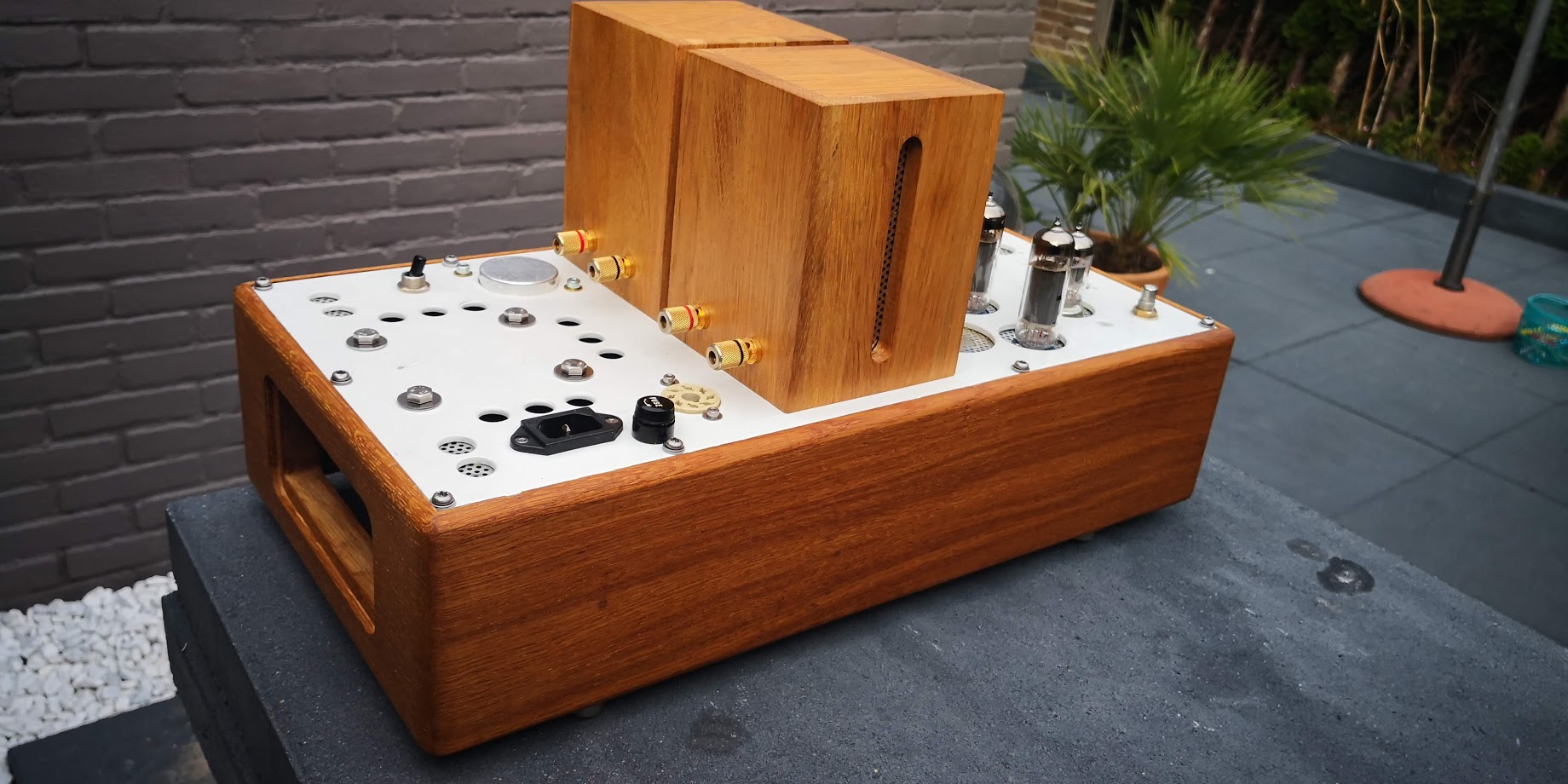

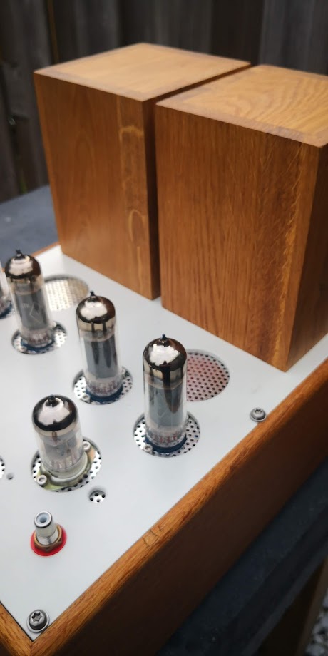

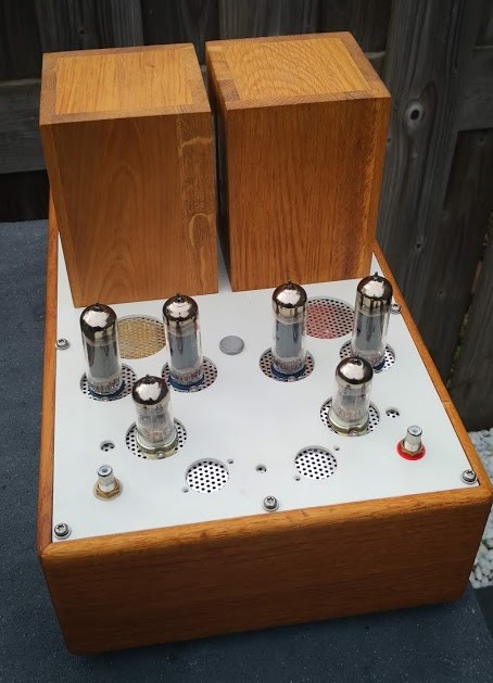

Integrated Edelweiss-3
............... and a mono subwoofer output on the rear panel.
I have often wondered how to build a "sub out" feature into a tube amp.
Would you be willing to share this circuit?
You see this often in vintage amps for a center channel output. A 10K resistor connected to each + speaker output, then connected together then with a 2K resistor from that junction to ground will provide a reasonably well isolated subwoofer output, assuming of course that the other end of your OT winding is grounded.
Yes, exactly like this. If a crossover is needed, one cap can be added for 6 dB/Oct, or even one more RC for 12 dB/Oct.
