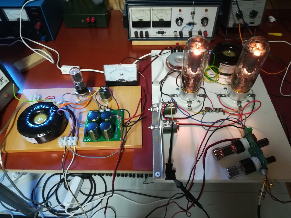

As already shown by my tests the 2.5 Vpp ripple at the plate voltage of the 845 output tubes generate 0.013 % (-78 dBc) 100 Hz IMD.
This is 6 dB below the IMD caused by the AC-heaters. I would like to know why would anybody need as low as 1-10 mVpp ripple (at PP-output stage) ?
You shouldn't due to CMRR, but obviously 2.5Vpp ripple is a lot for a single ended voltage stage with 6db PSRR like a common cathode amp 🙂

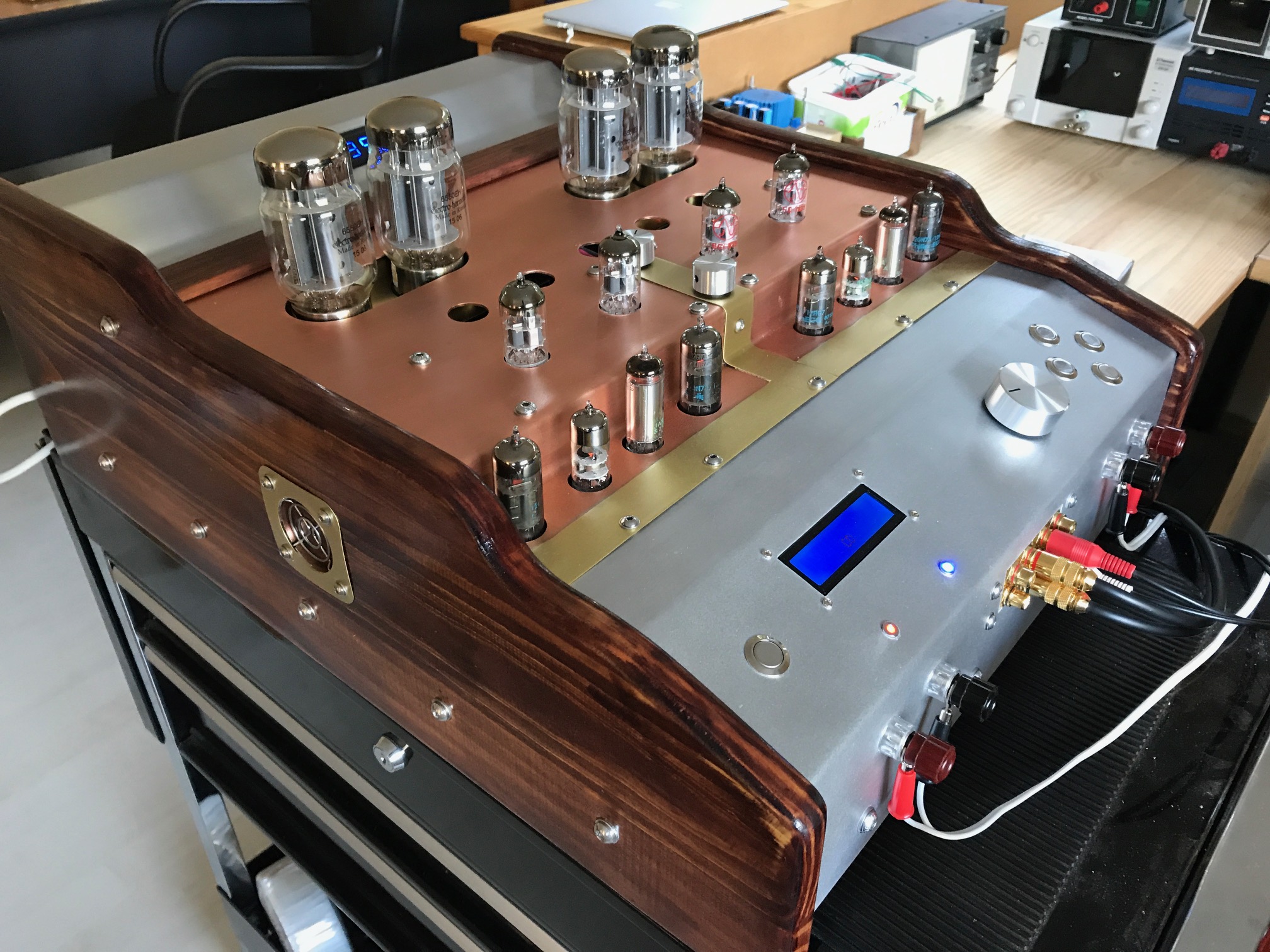

I have finally boxed my Raspberry Pi controlled P-P amplifier. It ended up rather monstrous! All metal sheet was hand beaten into submission. No a single laser cut to be found in this construction!
Summary:
P-P output stage using toroidal OPT
Bias monitored & controlled by the RPi
Takes a range of power tubes (6550, KT88, 6L6, EL34 etc), the Rpi makes the bias adjustments as set from front panel (25-90mA)
B+ approx 400V
Driver is Pete Millet's P-P driver boards
Tone control is Braxandall. Can be switched off & out of the circuit via the front panel.
Pout = 40W RMS into 8 Ohm (visible distortion on scope)
Distortion at 2W is approx 0.1% (2nd & 3rd harmonic)
It has its own charm for an engineer without WAF-issues 🙂
Anyway congrats for finishing such a build. Hopefuly the RPi is online and can be controlled by an app 🙄
The only way it should be done. I once saw a video of some Indian(?) guy making a VW floor pan out of a piece of sheet metal using nothing but a hammer and a couple blocks of wood. The result was pretty impressive. So is this amp.

wow! that looks like a lot of work and great result. Any photos of the inside?

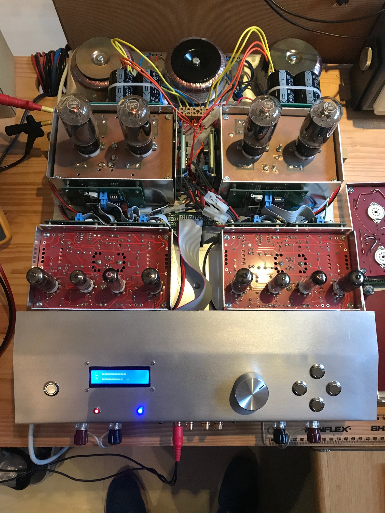

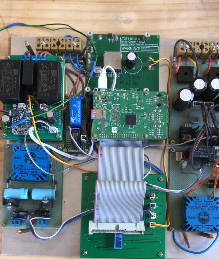

Here are 2 inside photos, the first is the lower chassis with the auxiliary PSUs and RPi:
5V for RPi with LiPo 3.7V charger & backup 15V for the LT3751 capacitor charger demo board (that I had salvaged from a previous project) which generates the -110V for the control grid supply +-15V for the grid voltage amplifiers 18V ac for the driver board, to generate the -Vneg needed Filament rectifier & relay control
The 2nd photo shows the driver & power tube arrangement with the bias control. The 3 toroids are B+ PSUs and the centre for filament. The OPT are below the power tubes.
