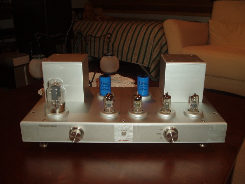

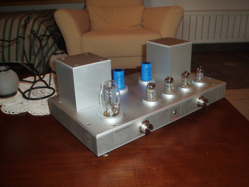

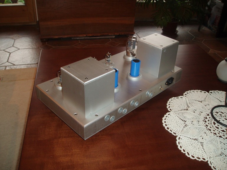

ecc88 preamp

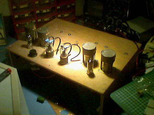

Not electronicly conected yet inside. Tested on a test chasis (works great). Chasis - 60$ bill for complete material, 40$ for works I could not done by my self 15 $ for enrgaveing leters, and 40 hours of my work in a workshop in a basement. It came out qouite well for me.

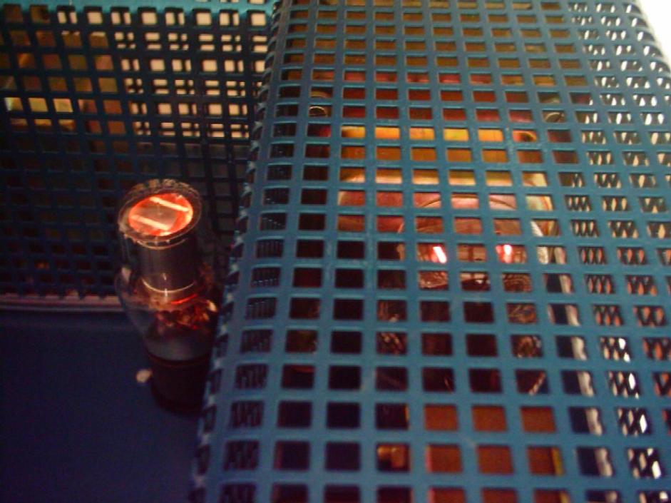

It's magical to watch a 0A3 glowing!
Here's my new amp, based on Mikael's KT88.
Only difference to original schematic is a Philips E88CC instead of a 6N1P.
Plays beatifully!!!😀
As can be seen, from left to rigth, KT88, E88CC, KT88, 0A3 as turn-on indicator (buzzing along happily) and between the choque in front and power trafo, a 5U4G.

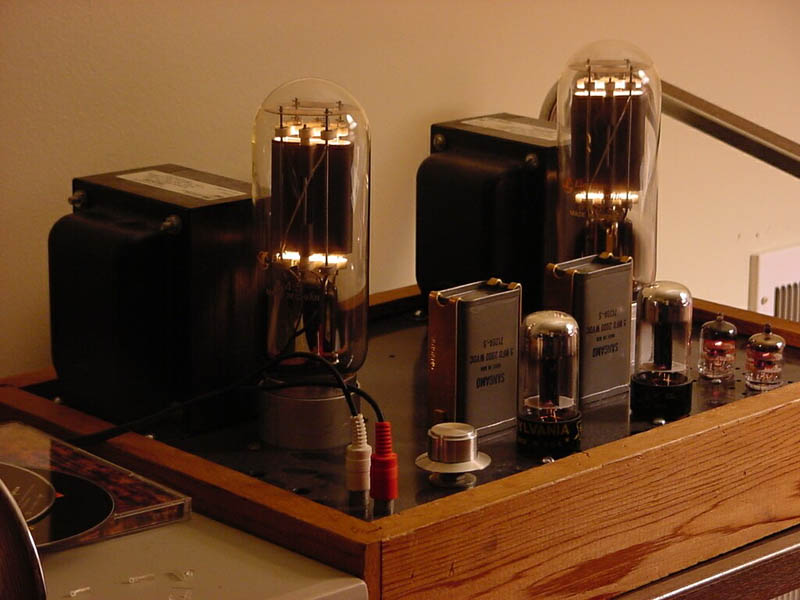

845 SE
Transformers are Hammonds and the power supply is external and not pictured. The driver stage is powered by a 5AR4 rectifier and the 845's use UF4007s in a bridge to get about 850v. The tube lineup goes 417A-6AH4-845.
