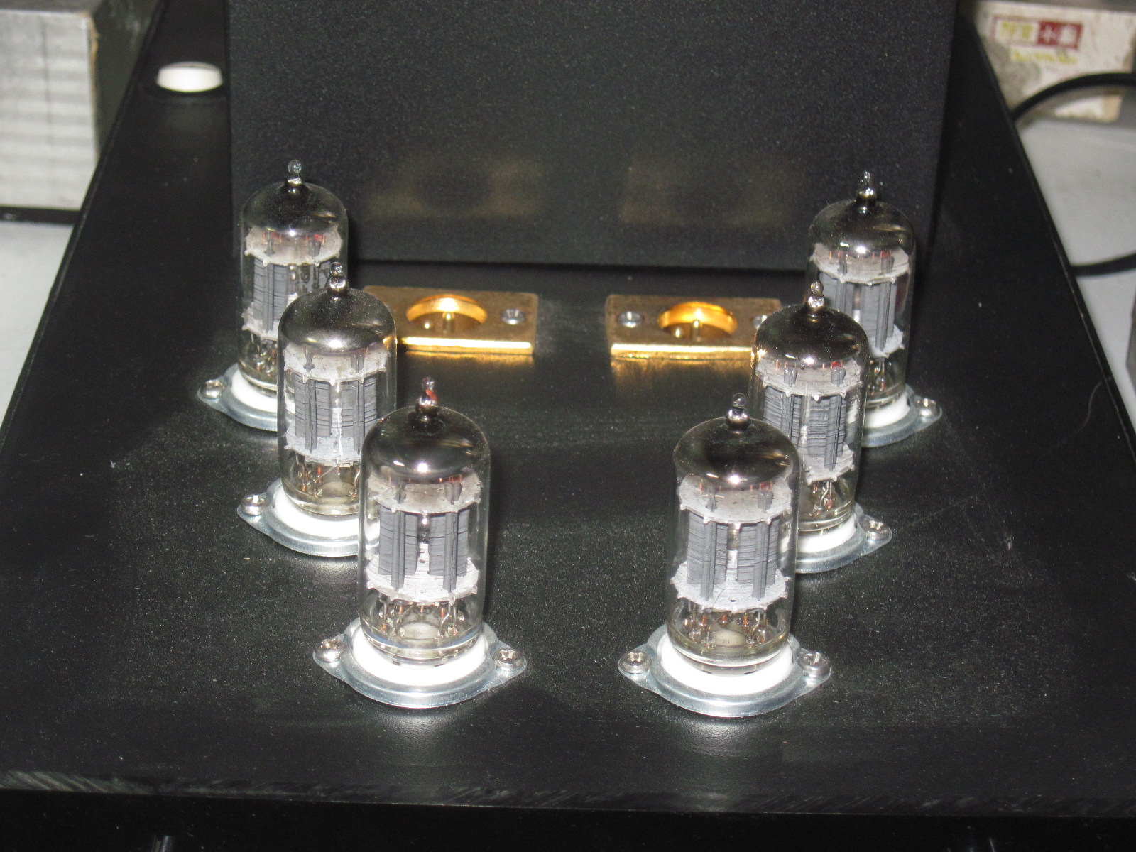

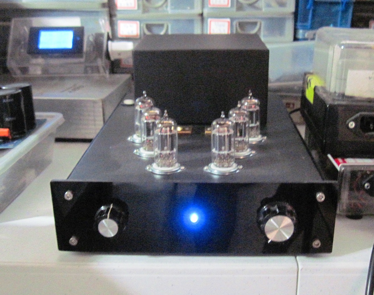

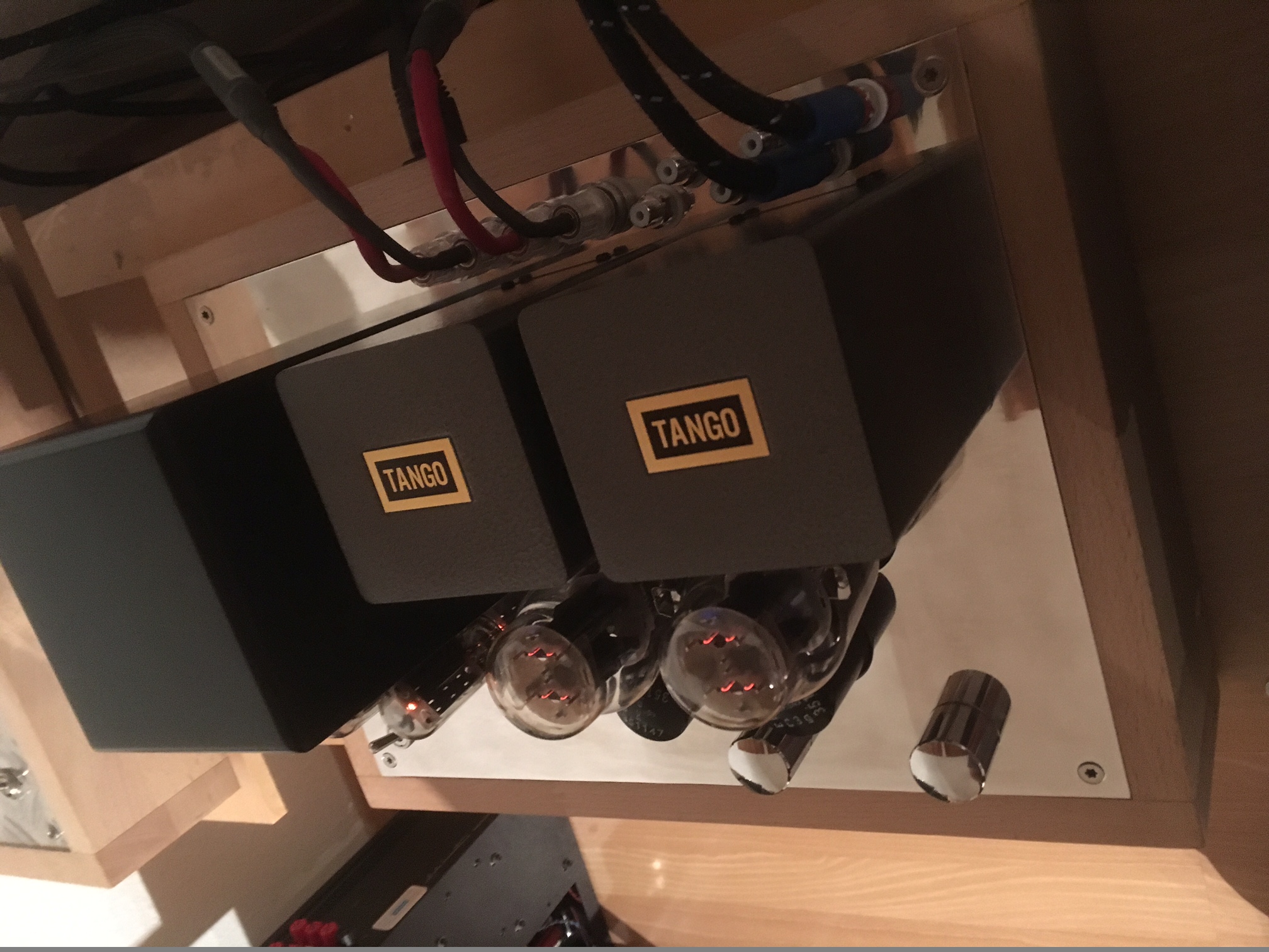

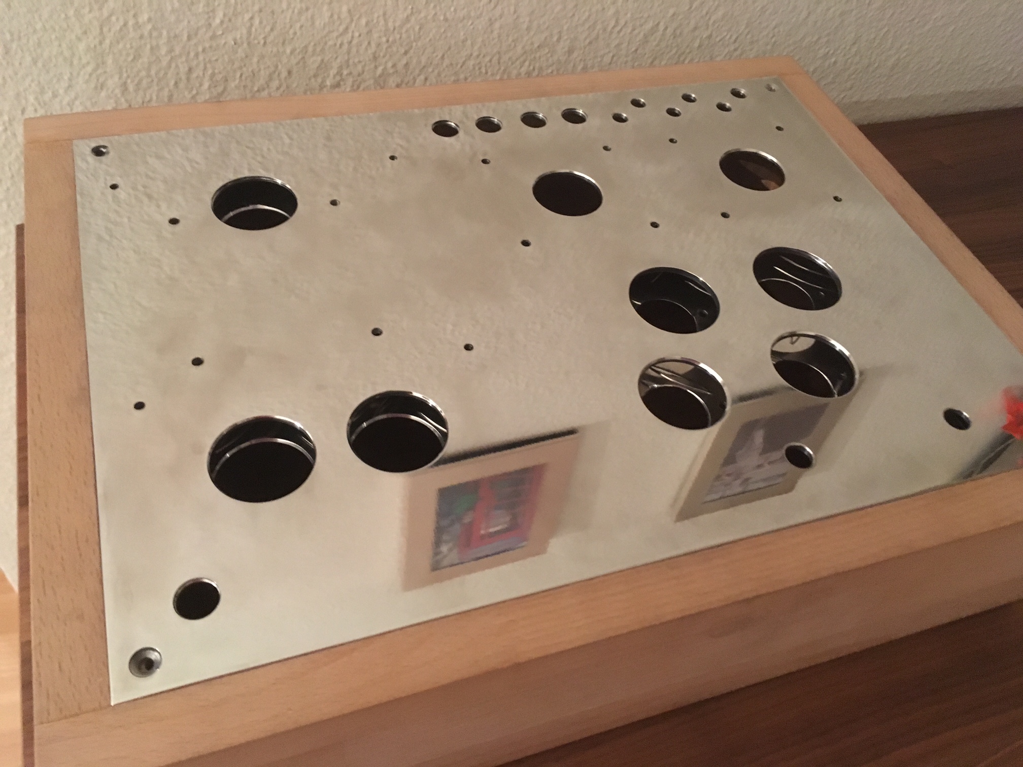

Very nice, soulmerchant. Can you give us any tips on how you cut the holes for the panels? It's a great result.
First marked them on the plate (print-out on thin paper carfefully taped to the plate before tapping the drill points.
Then with a very small bit as exactly as possible I drilled pilot holes.
Then I used a stepped drill bit, making sure it was well lubricated.
You might notice that the only visible screws are in the corners. All tubes are counter-sunk to the underlying plate, which need not be so pretty :)
