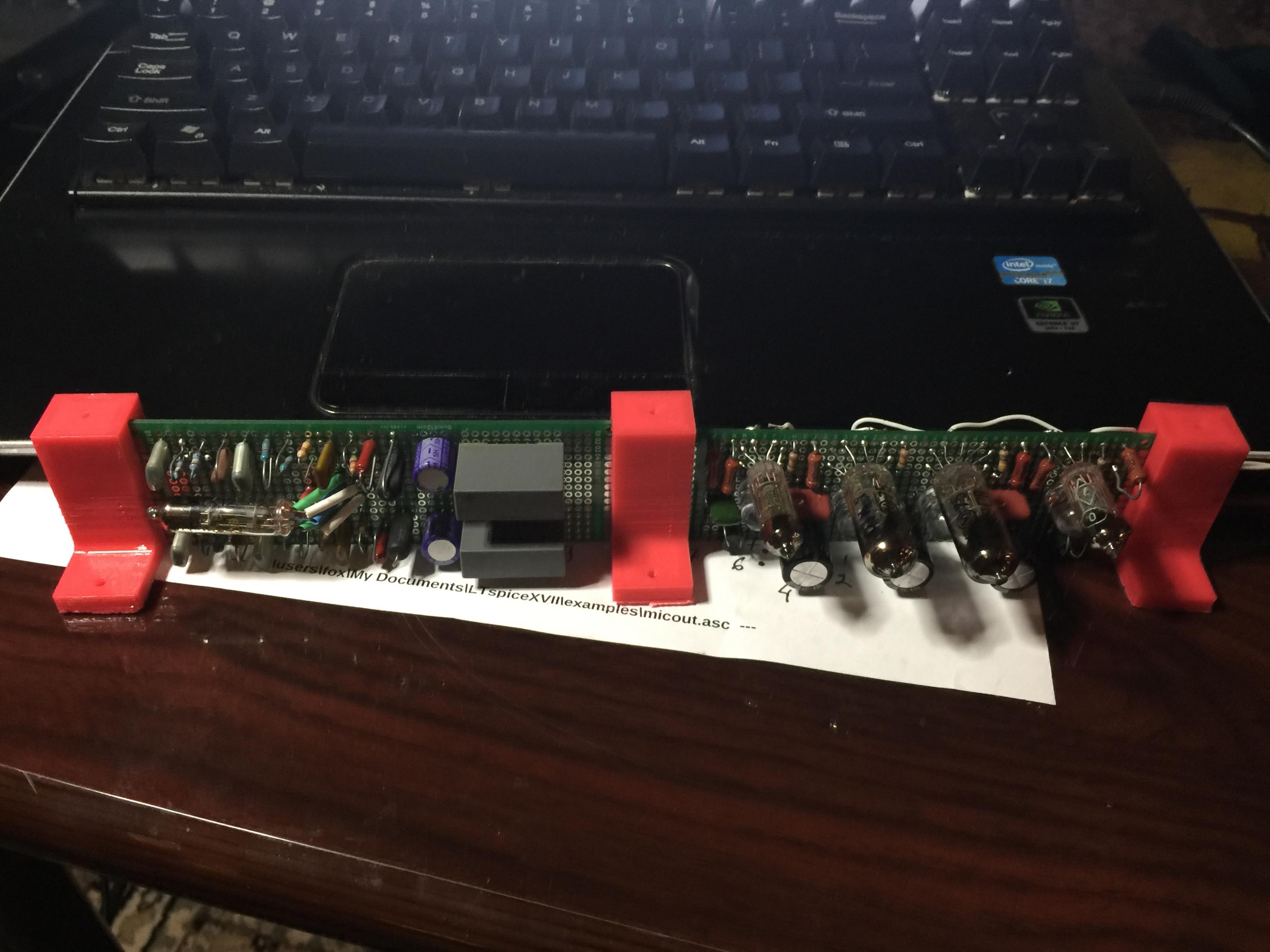

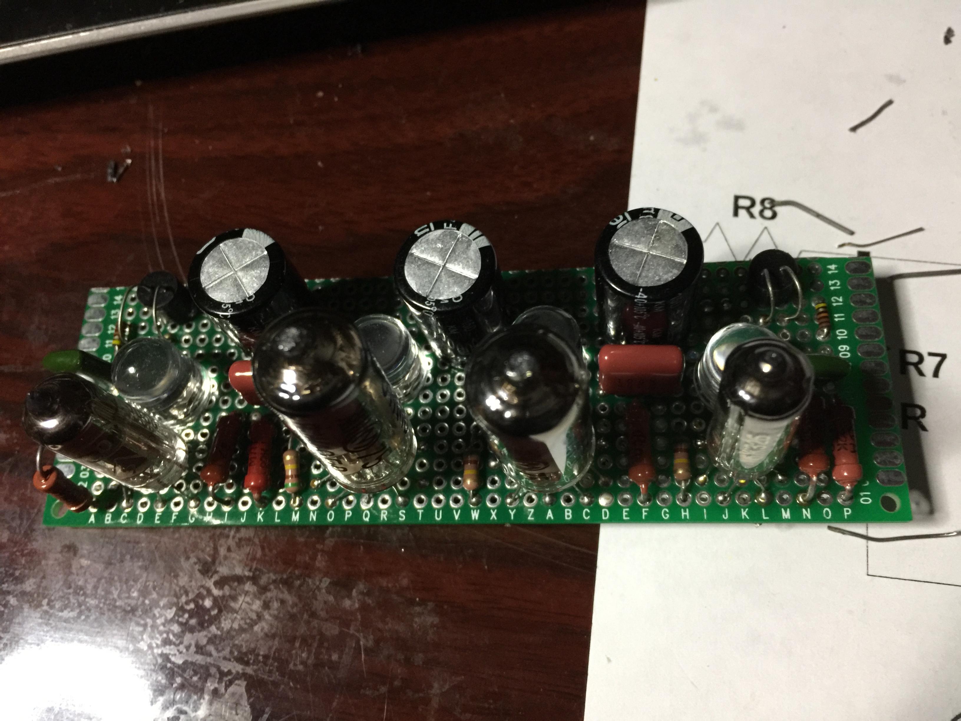

Stereo amp prototype board...
OK, I'll bite. Looks like pencil tubes but they seem a little bigger than the ones I have. What are they and what's the amp?

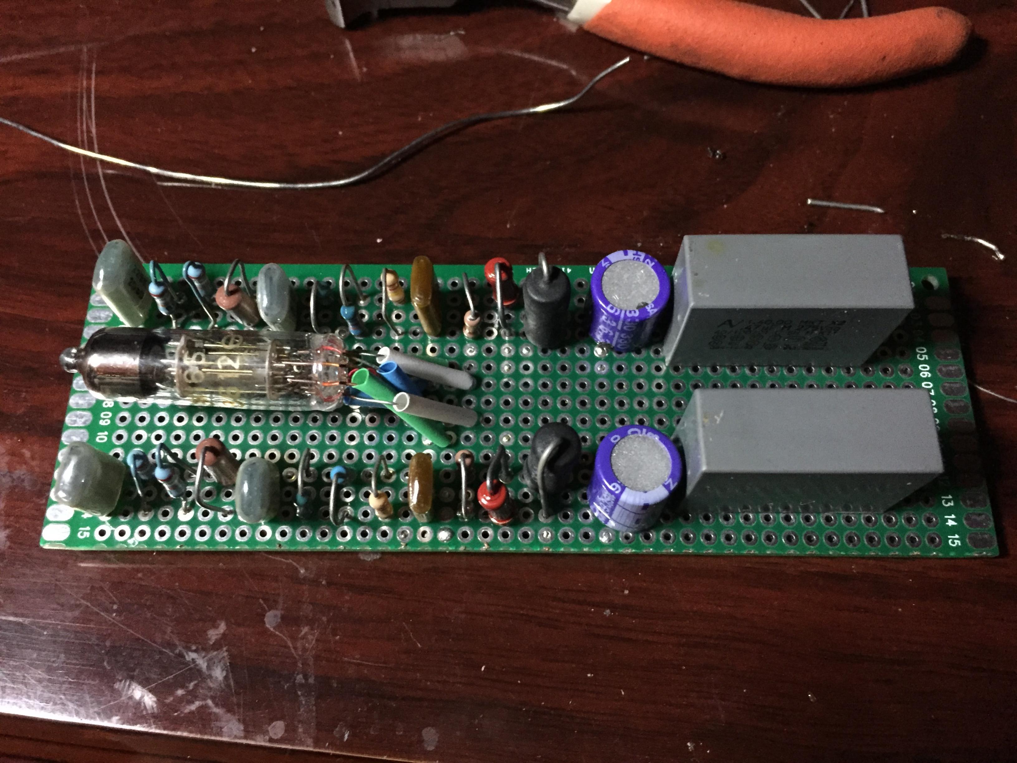

6Ж32Б-В, 6Ж9Г-В. Stereo microphone preamp. SE transformer outputs, 600 Ohm 0 dB. Pentodes with feedback resistor between anodes.

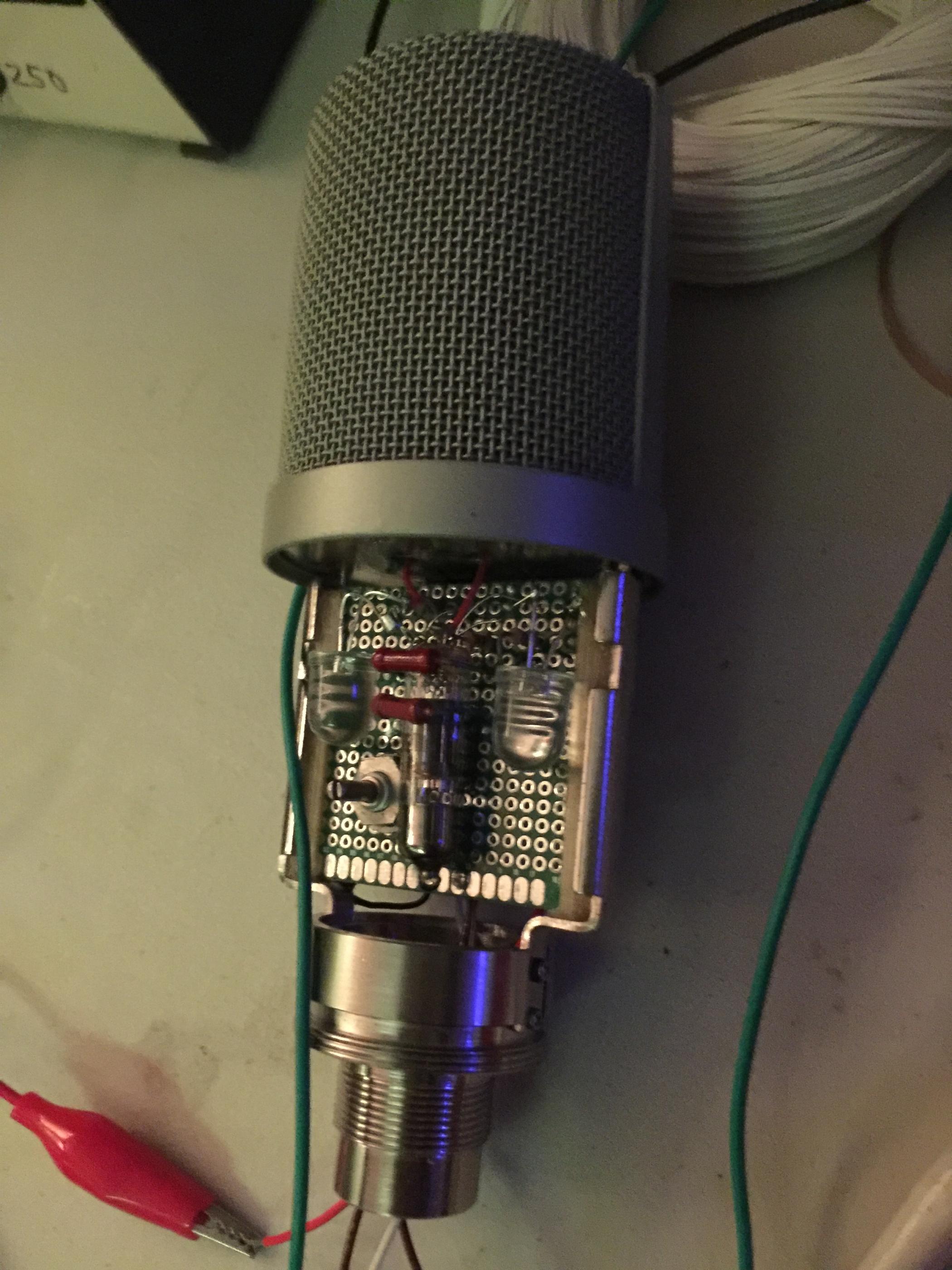

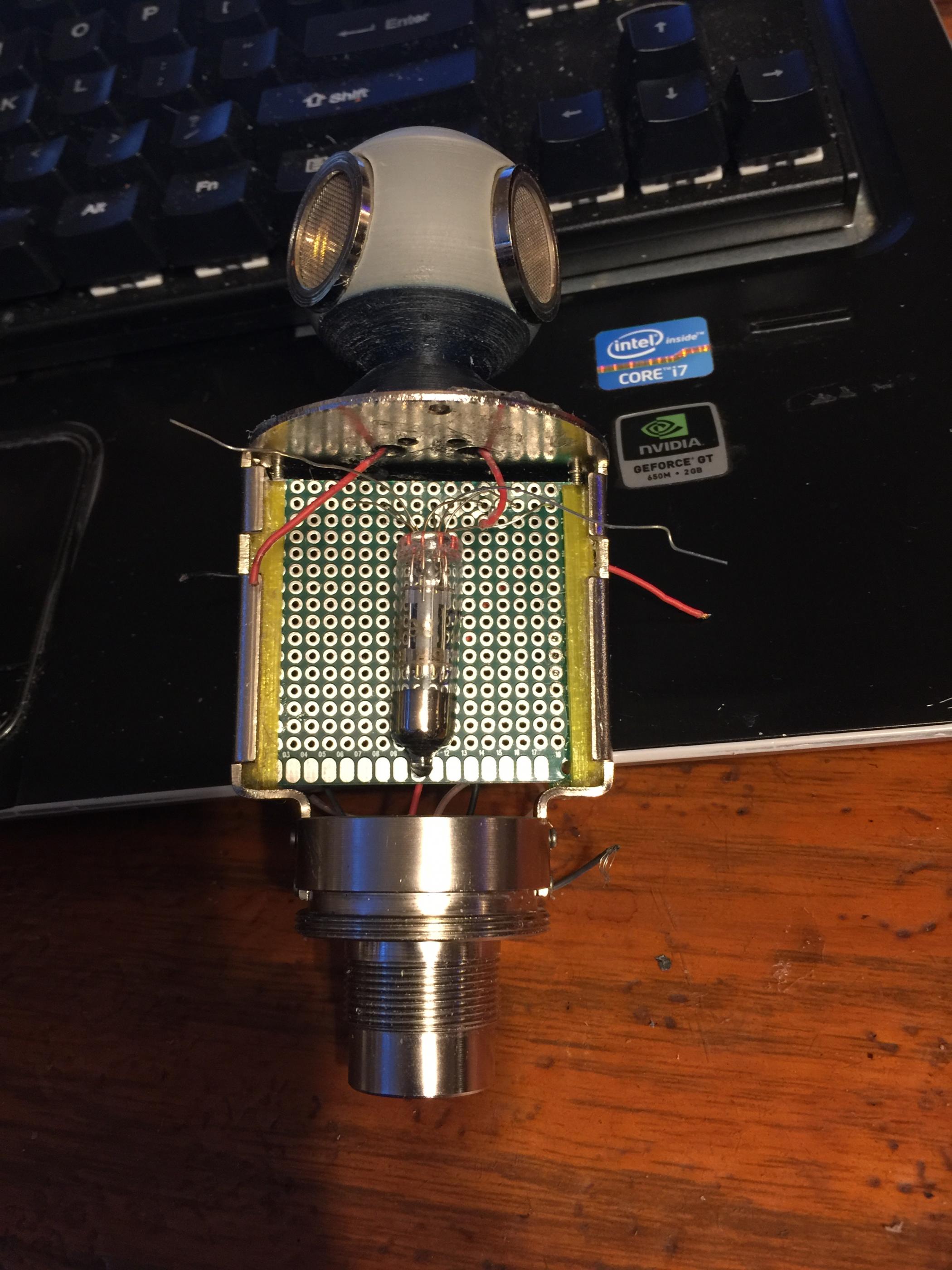

6Н16Б-В in the microphone itself and in a HPF (Sallen Key)
A stereo condenser vacuum tube microphone, with switchable HPF and an optical compressor - limiter.

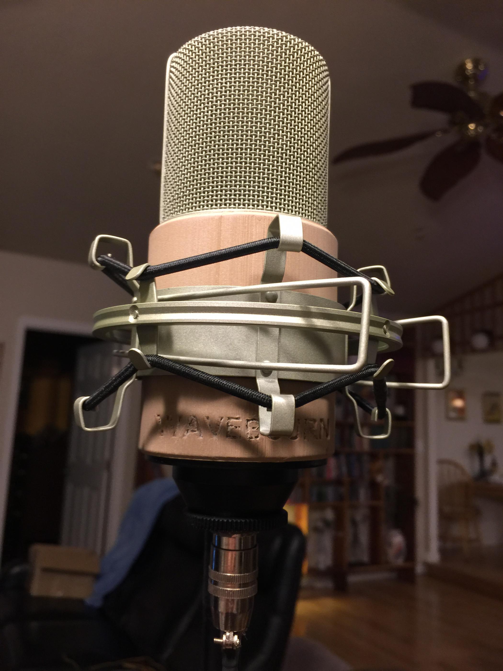

Beautiful microphone. Similar to the Russian Octave. They are produced in my cityView attachment 594973
Thank you. The body for the prototype I took from Marshall MXL microphones. 🙄
Octava does not produce stereo vacuum tube condenser microphones with 0 dB output. 😛
It's Russia: D: D: D. On request they make any, with any characteristics. Even if you want to cover with gold:п. The factory is 100 meters away from me ...
But your microphone looks super confident that sounds the same. Excellent work

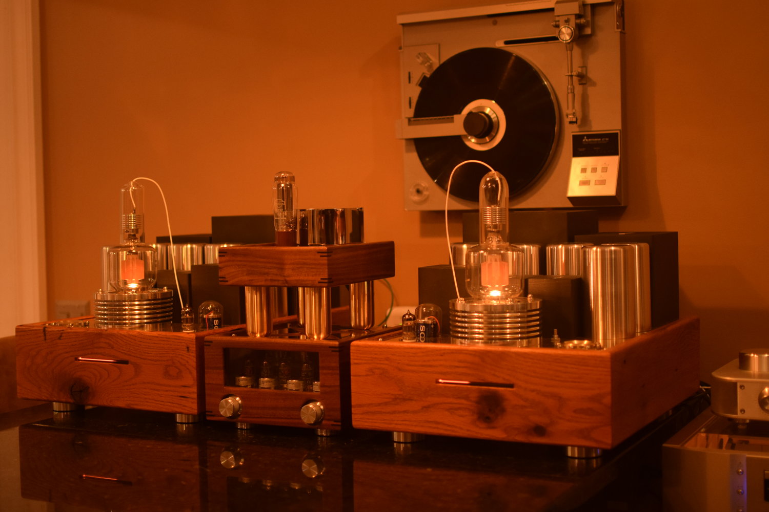

Top center is the Phono pre? And btw, how do you control tracking force?😀 (edit: nice system btw)
Impressive!
Schematics and details of making amplifiers with rs1026, please?
This is a special vertical model MITSUBISHI LT-SV (One of my favorite toy😀)
yes similar to audio note M10Top center is the Phono pre? And btw, how do you control tracking force?😀 (edit: nice system btw)
Mitsubishi LT-5V is designed to work in vertical position 🙂
