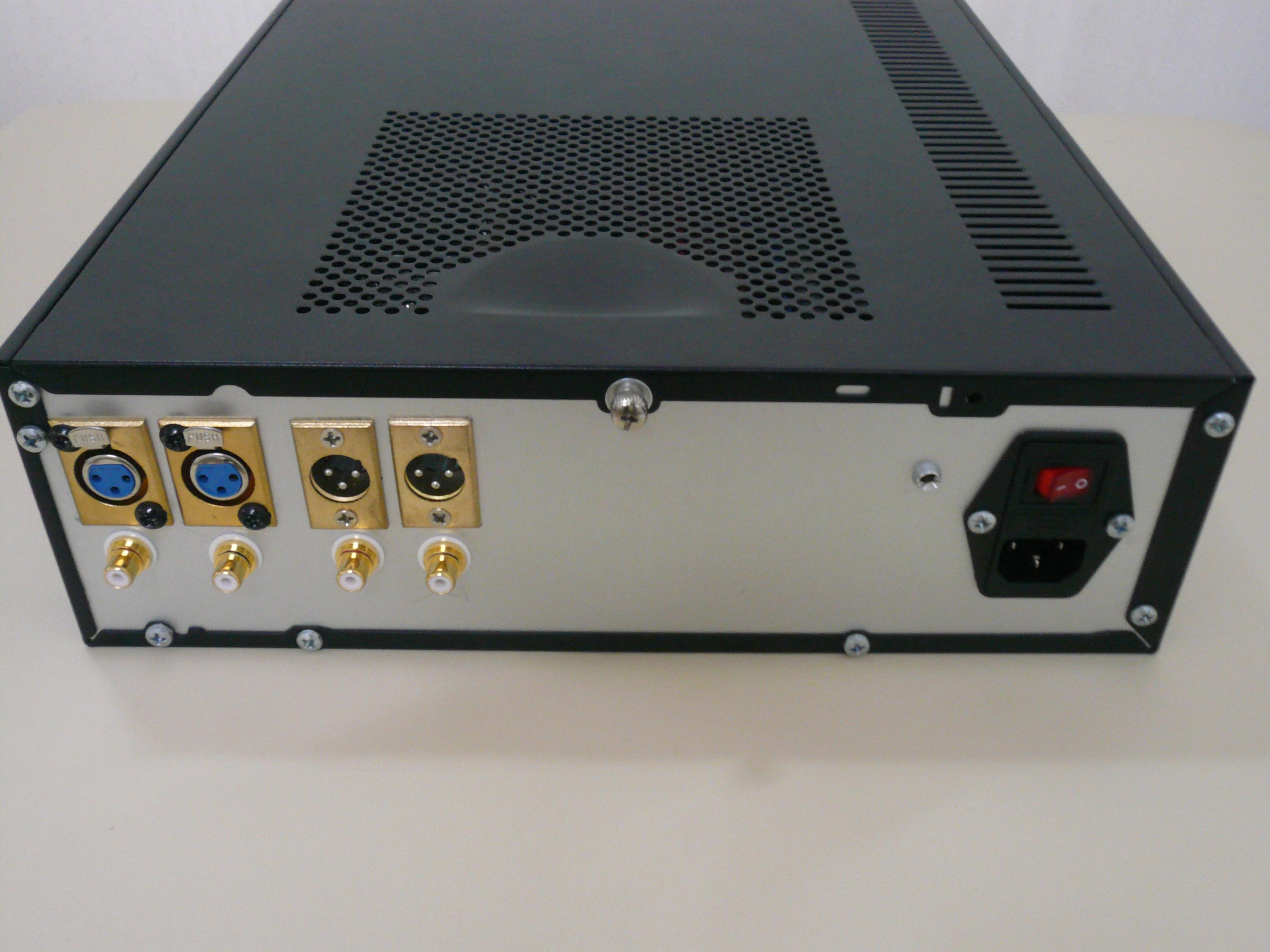

it really looks lovely. How do you feed the pcm1792 DAC? With USB or via
SPDIF? Is the DAC section in that casing as well?

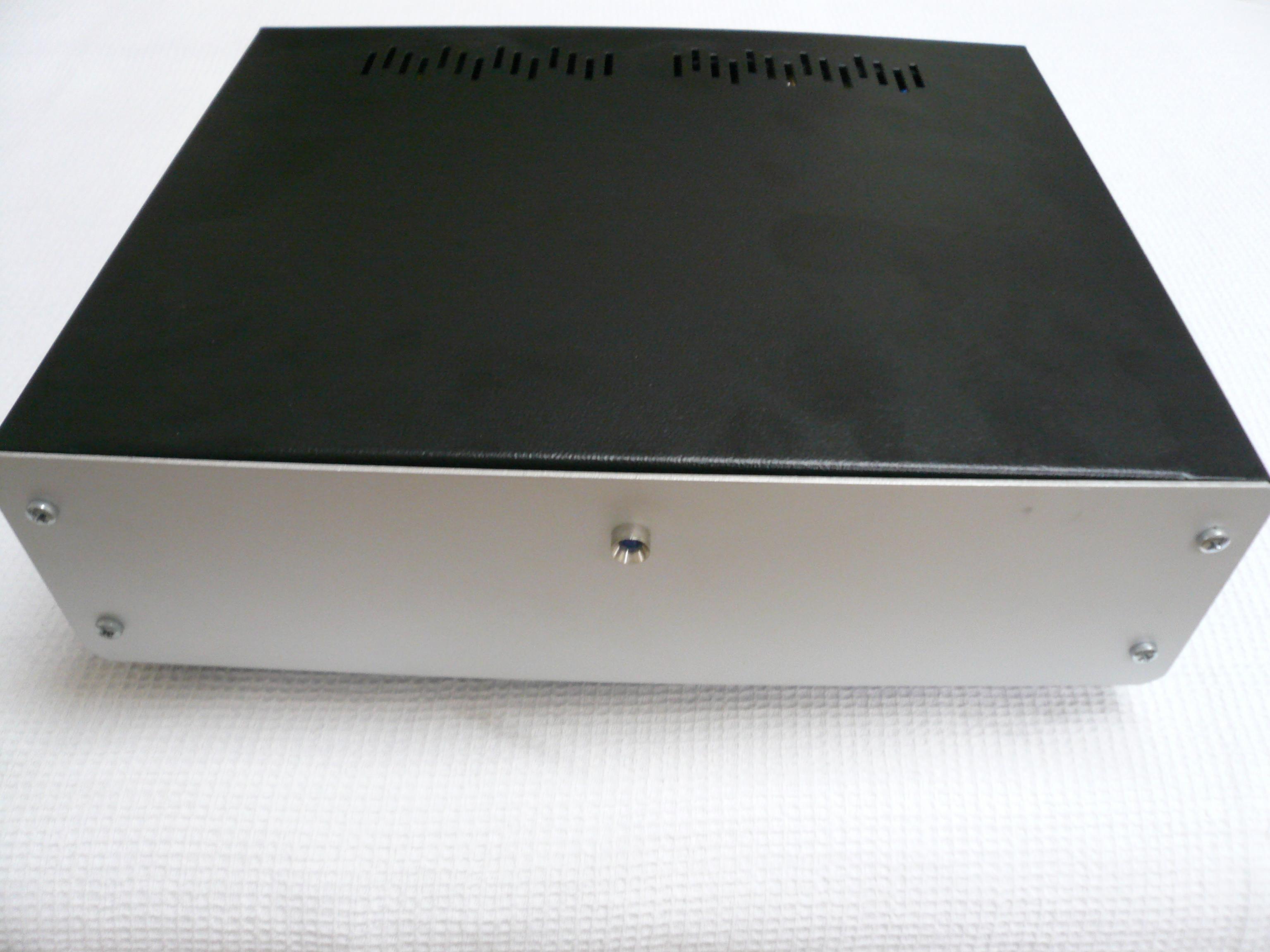

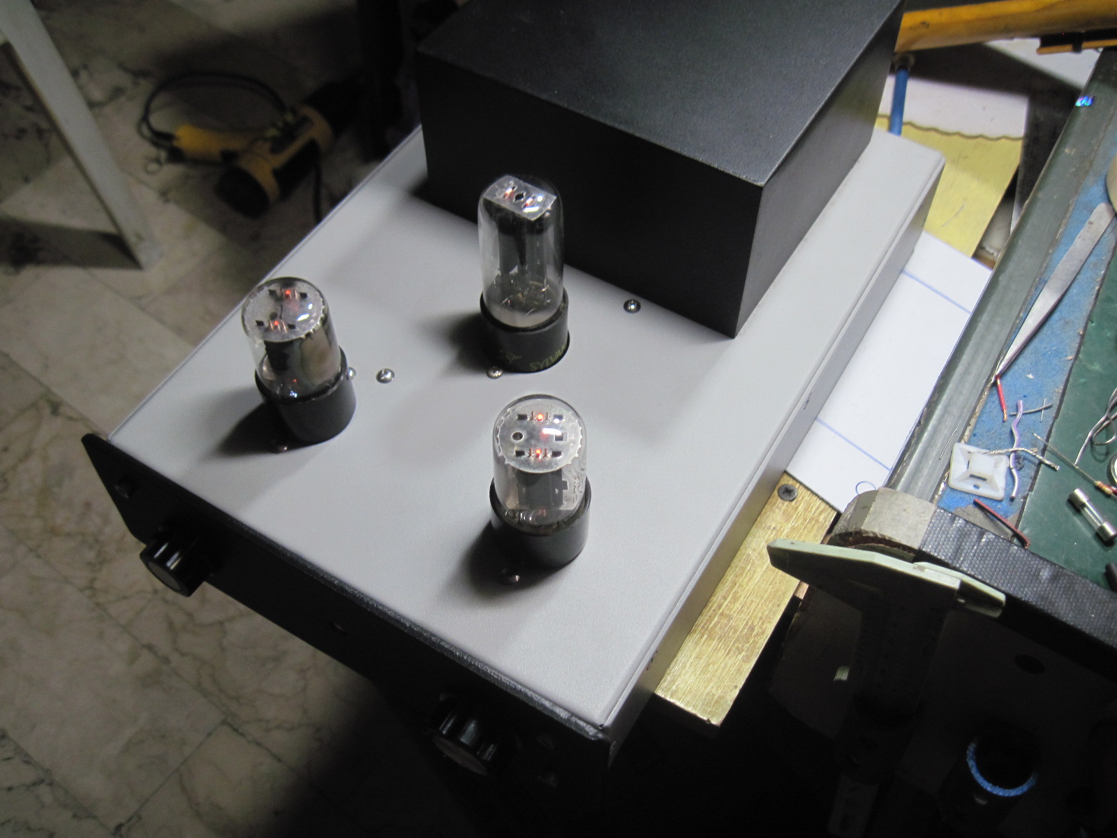

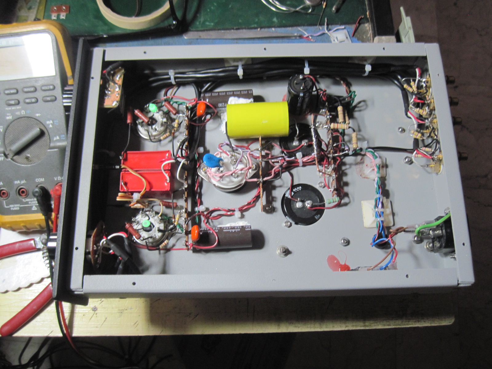

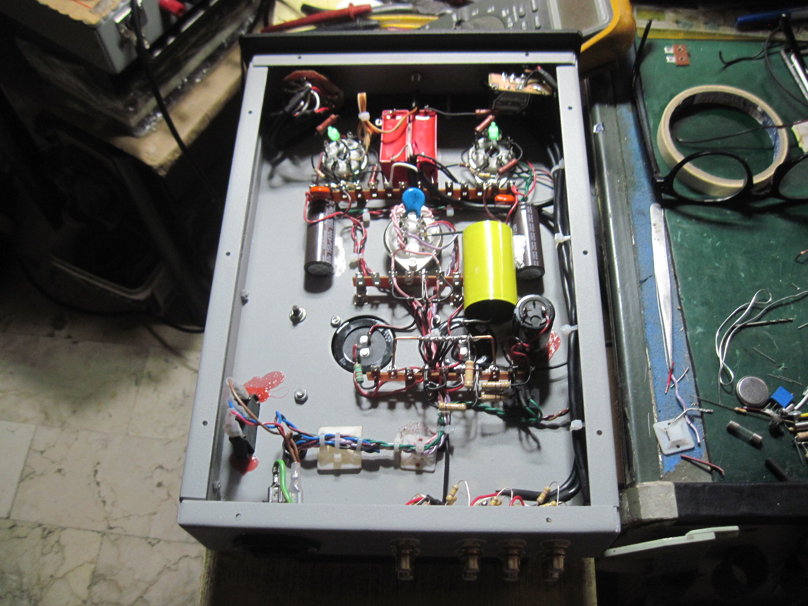

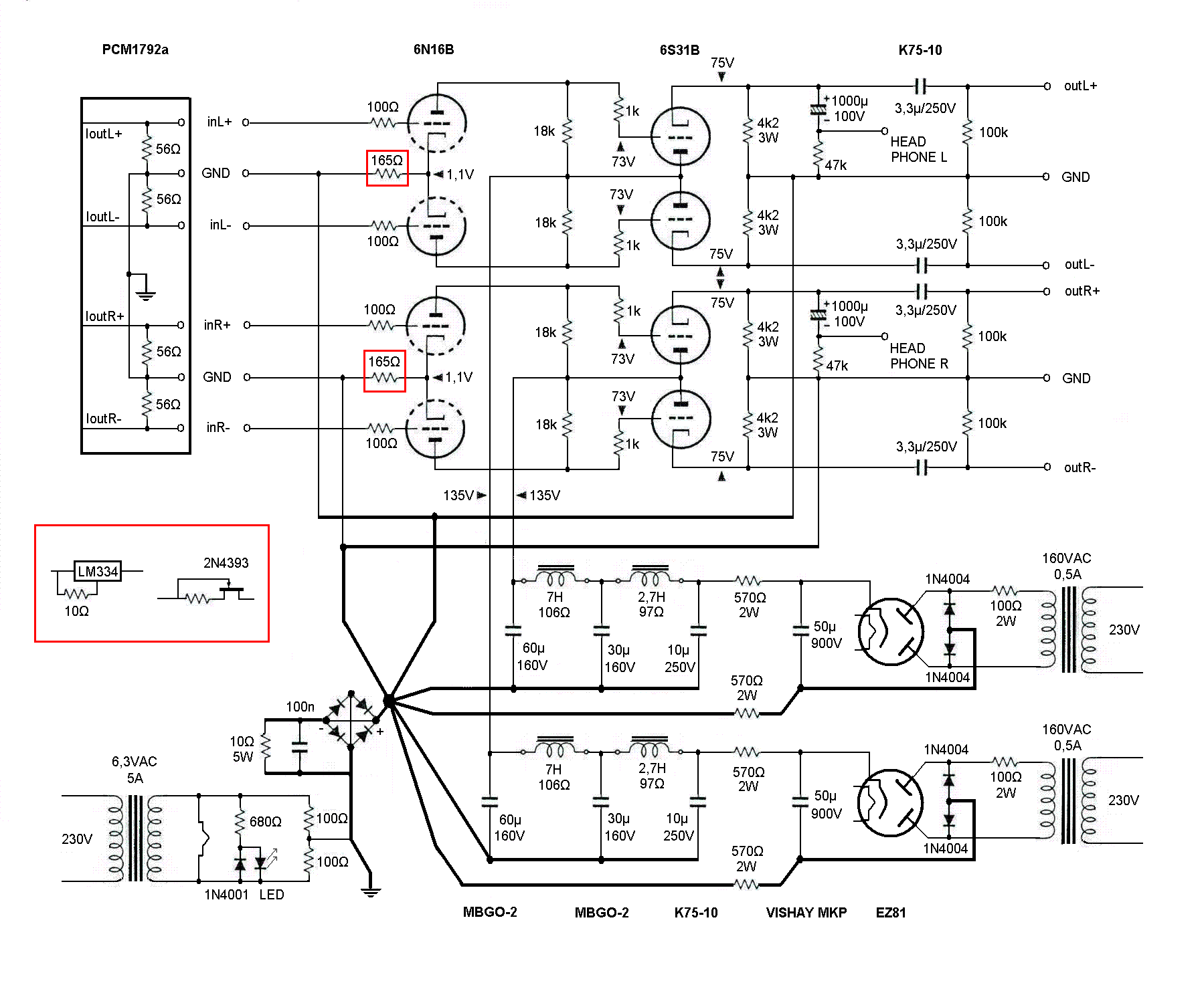

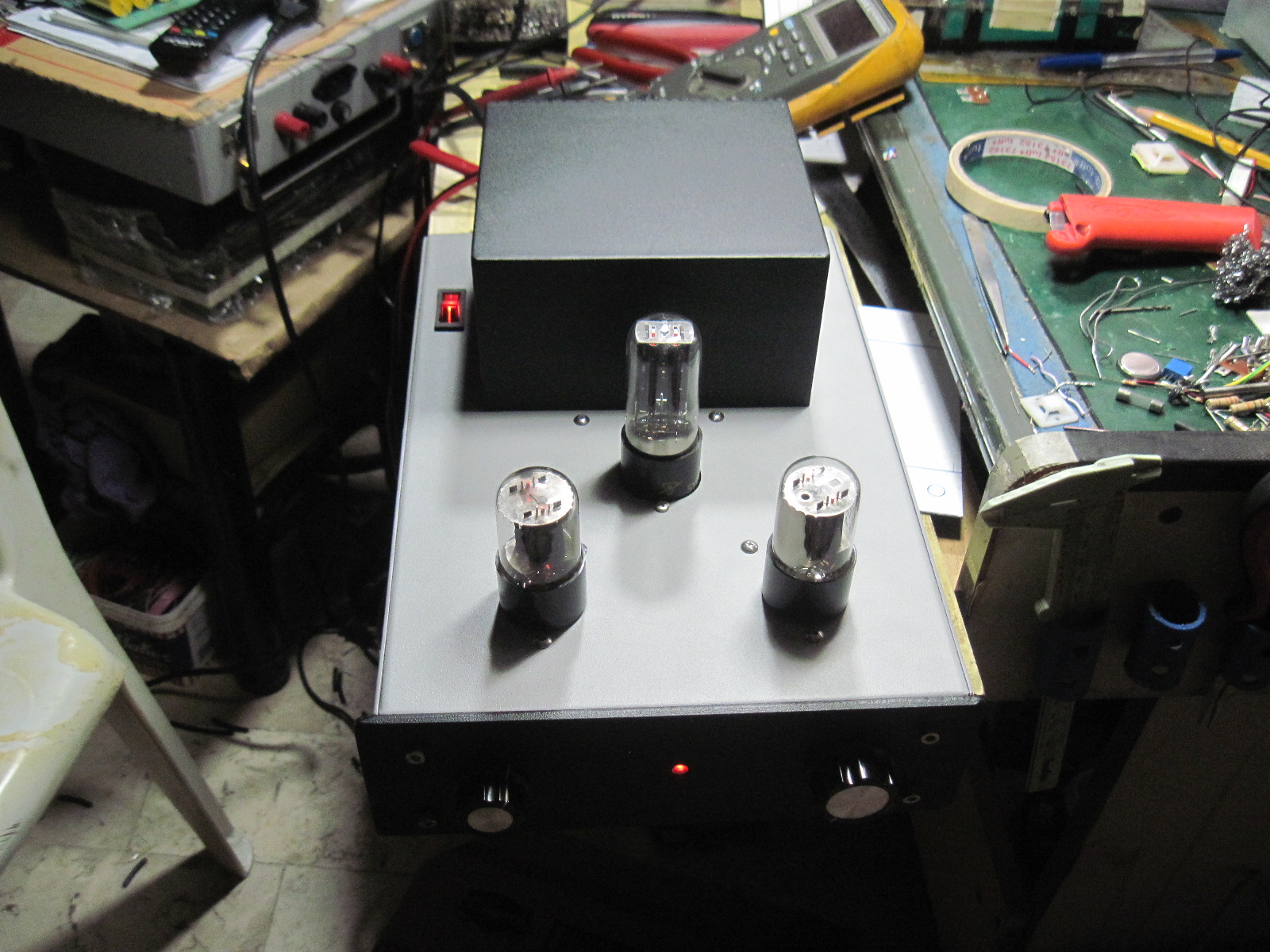

Hi Ulf,
It is quite straightforward design derived from my not so advanced level. This box is only tubes, nothing digital in it. The "DAC" is a PC audio card - Asus Essence STX ii - with modified psu and output. I simply take the output pins of PCM 1792 and feed them to the tubes.
Kostas
Kostas
Hi Kostas,
great idea. Where did you get the Cassis you put the
Tube-Stage/PSU in? Kinda looks like a housing for a
computer.
Cheers
ulf

It is a computer housing. I use the same for my audio PC to match appearance. I had to strip it down from front and rear panel and inner subchassis but for 50 euro - at a local eshop - including ATX psu is irresistible!

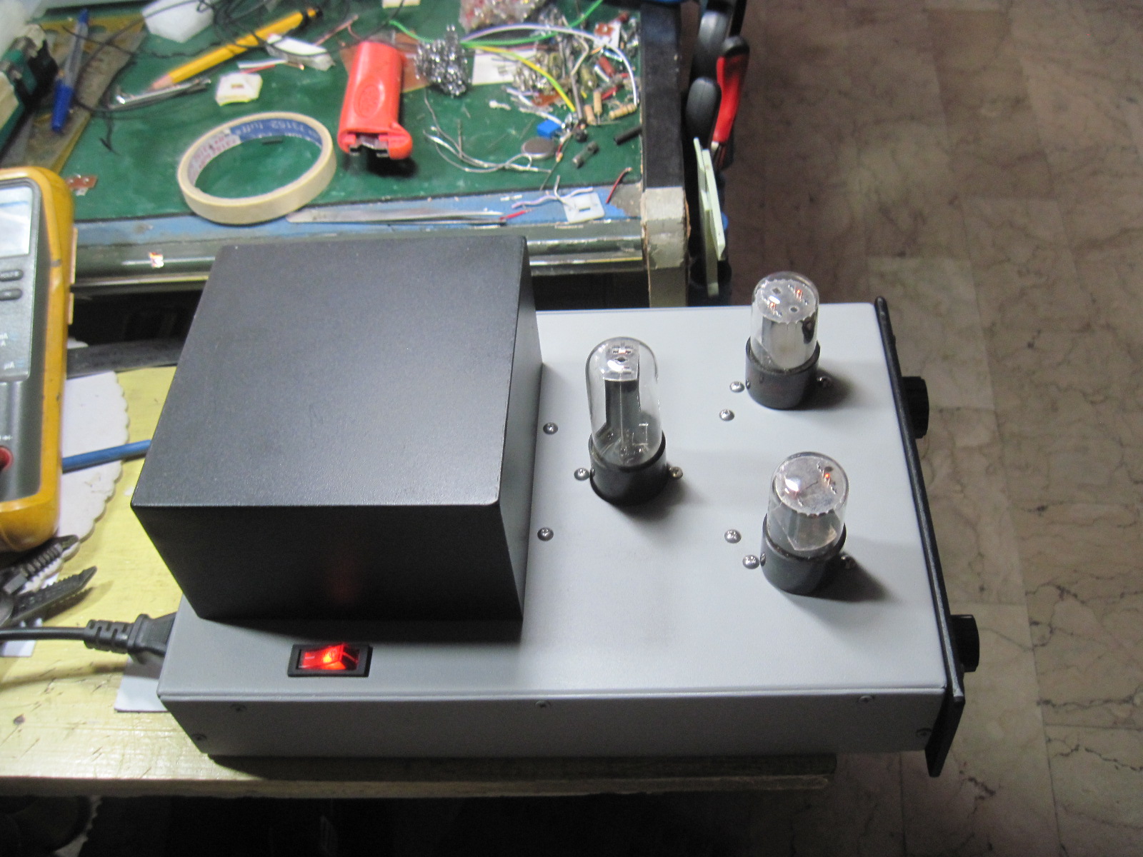

Thank you. It is not a production, just garage made prototypes. I left a day job in November last year to finish prototypes and to find the way on the market.

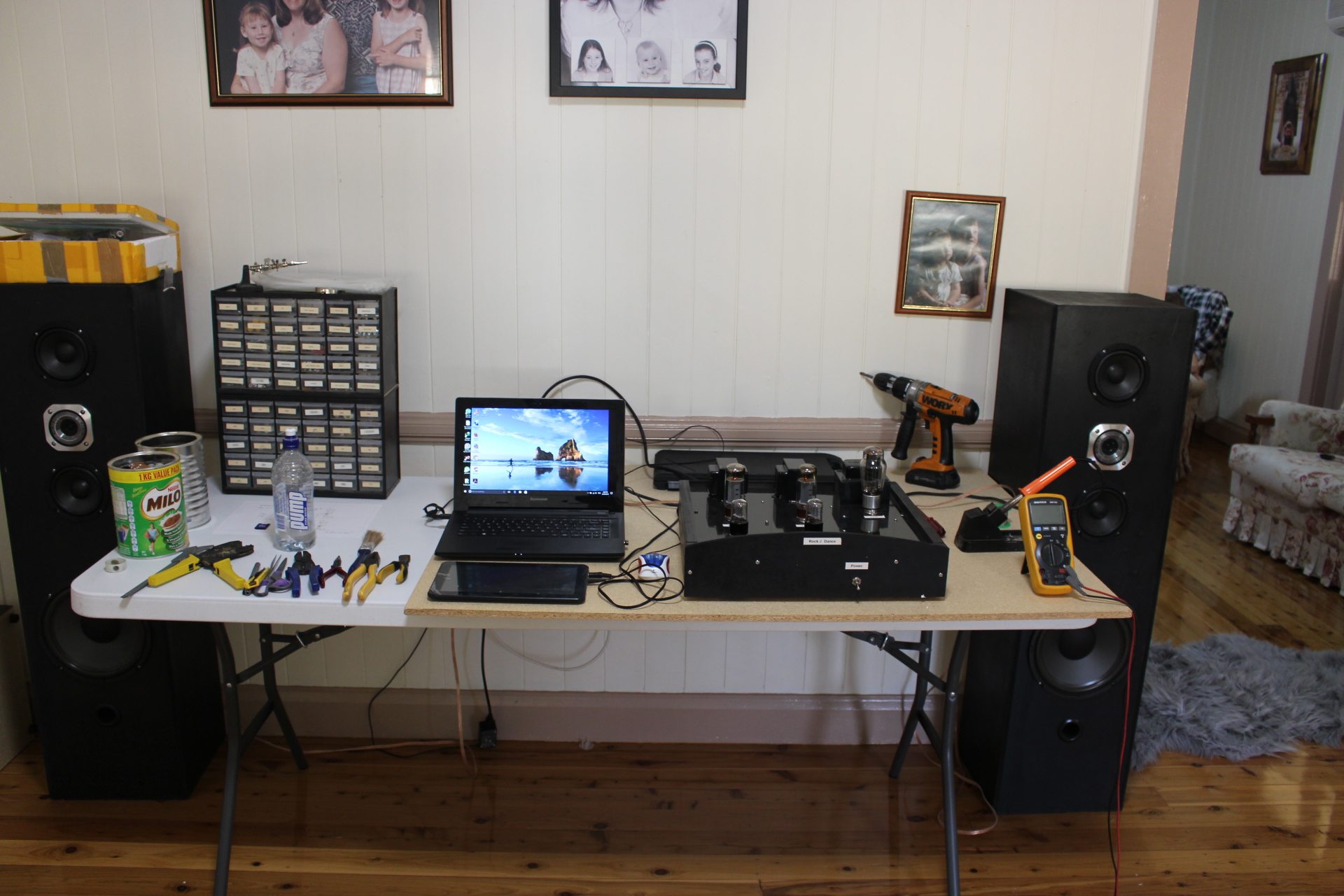

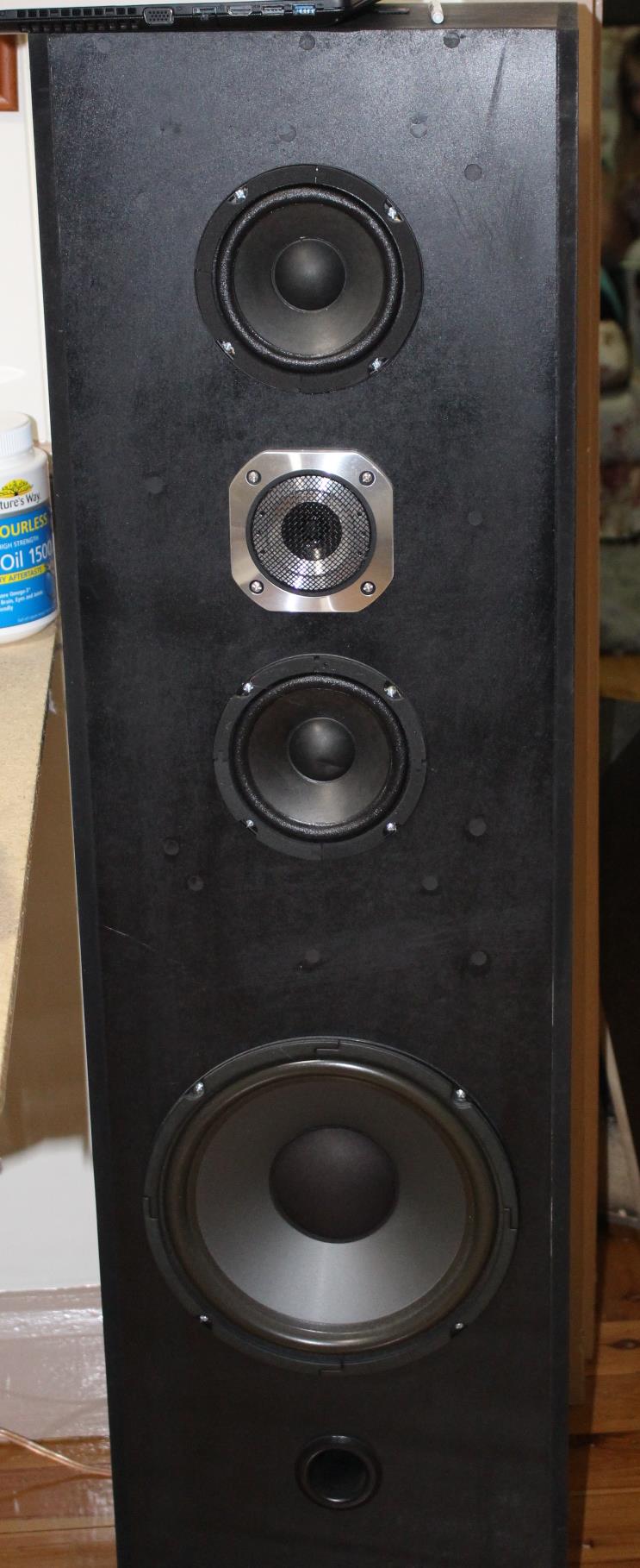

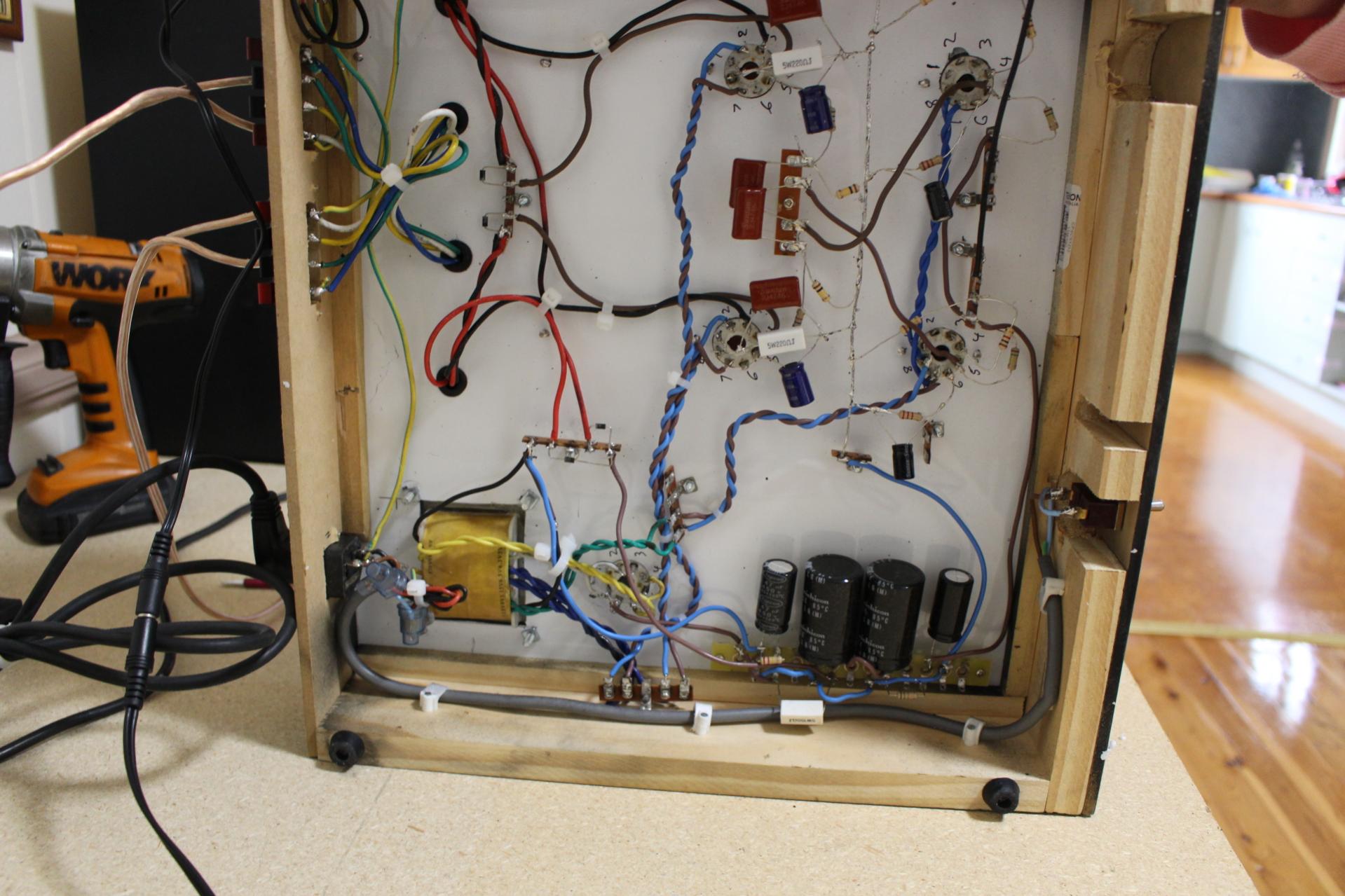

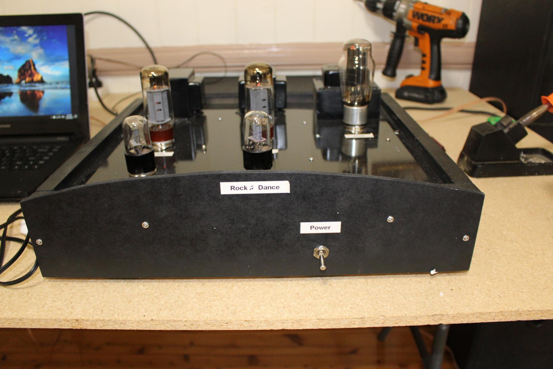

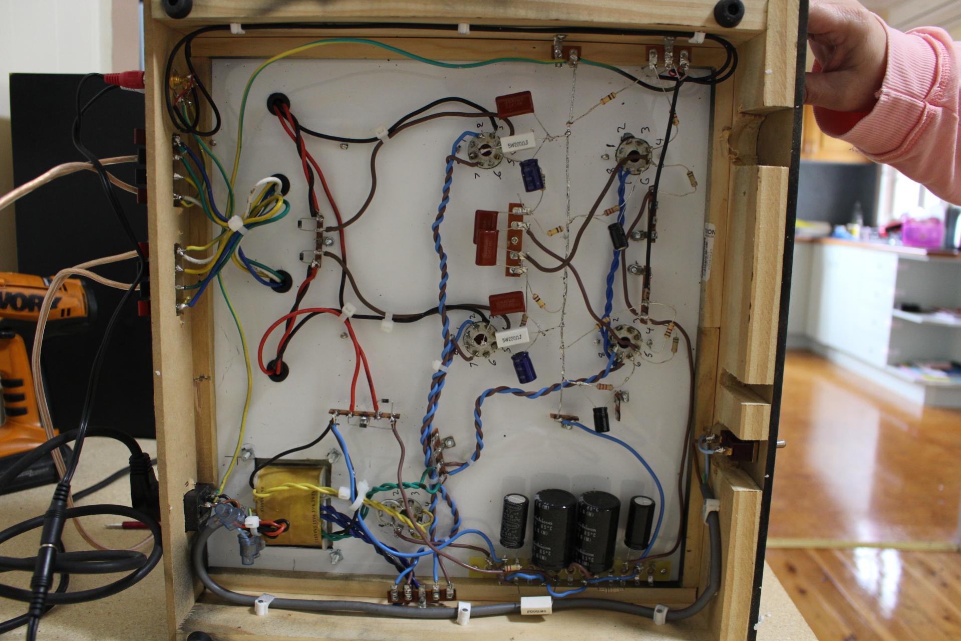

Hi just finished another valve amp and have to say heaps of bass midrange with my new homemade speakers 10" bass 2@ 5' midrange 2" tweeter see what you think of this one 🙂

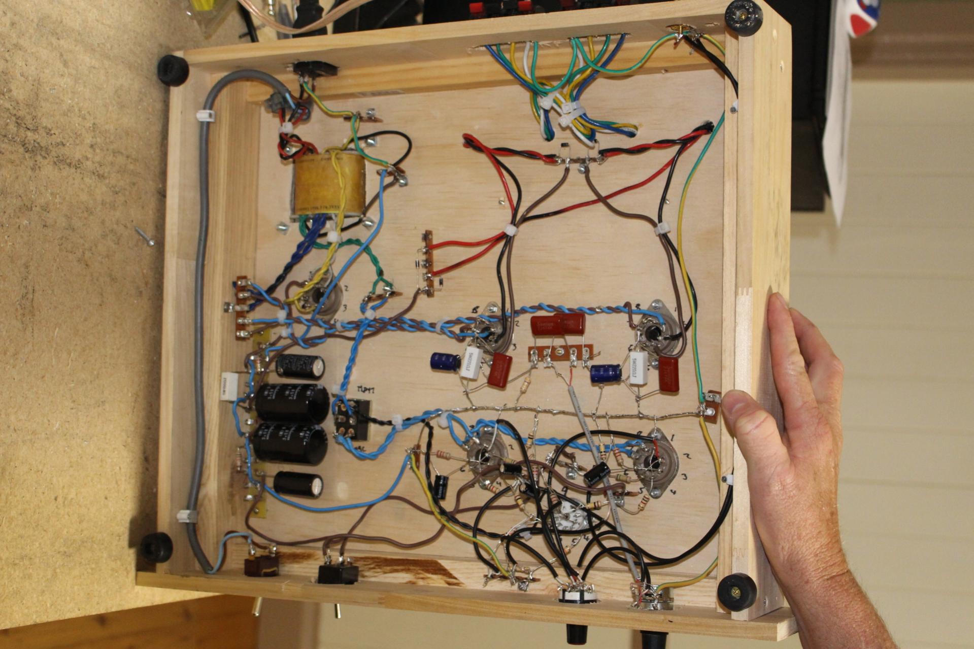

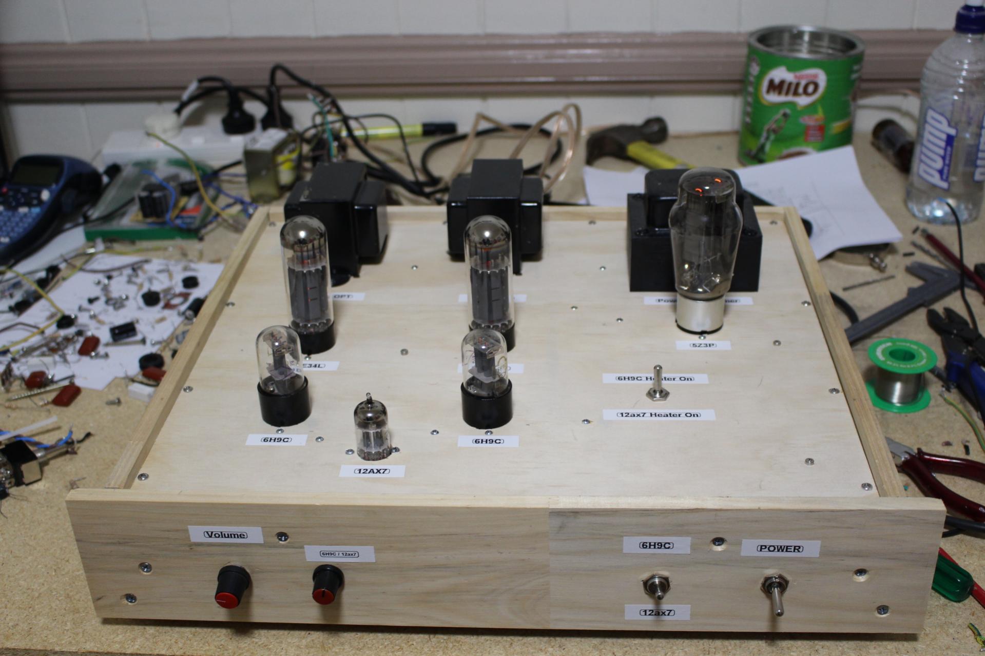

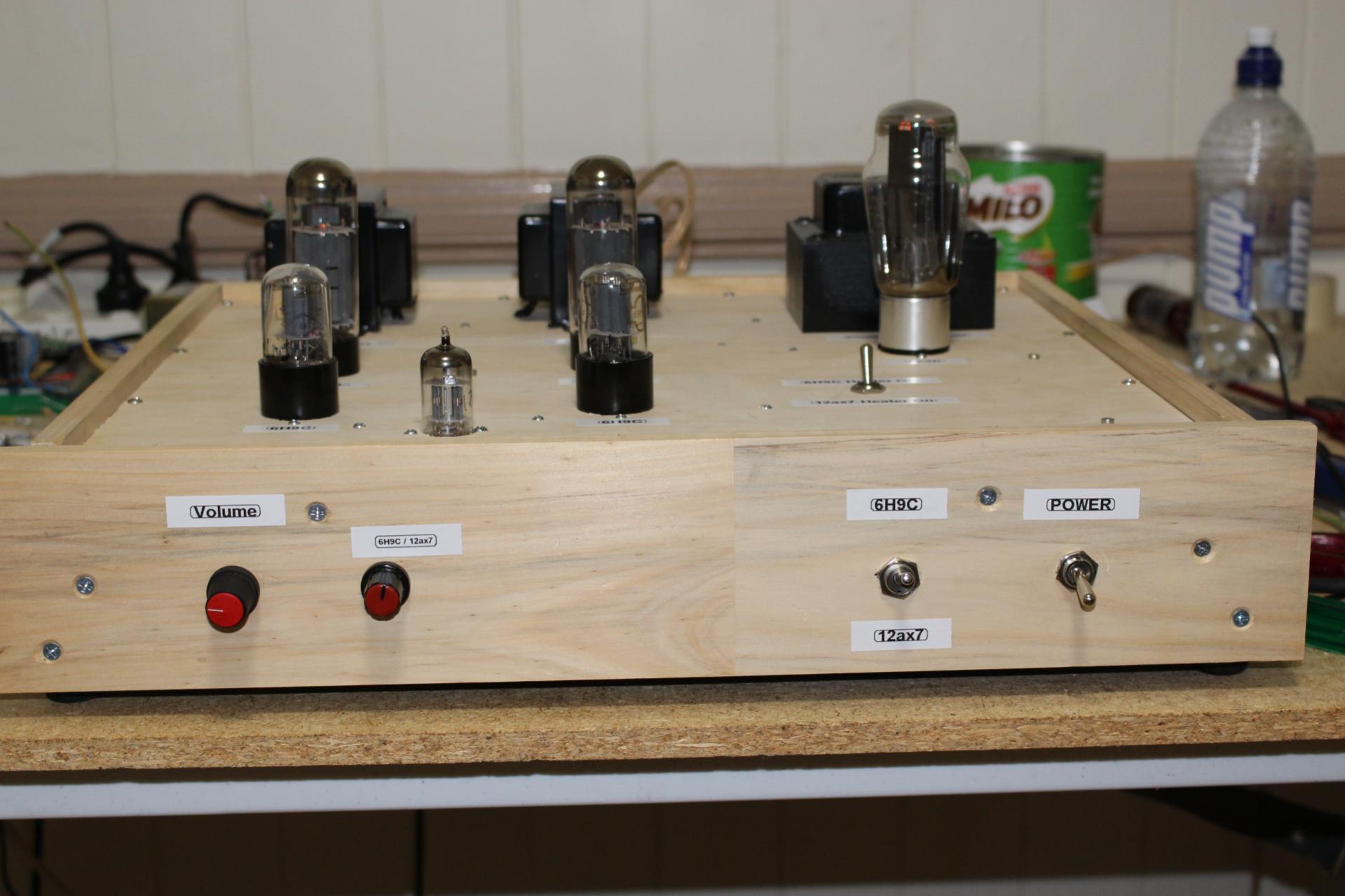

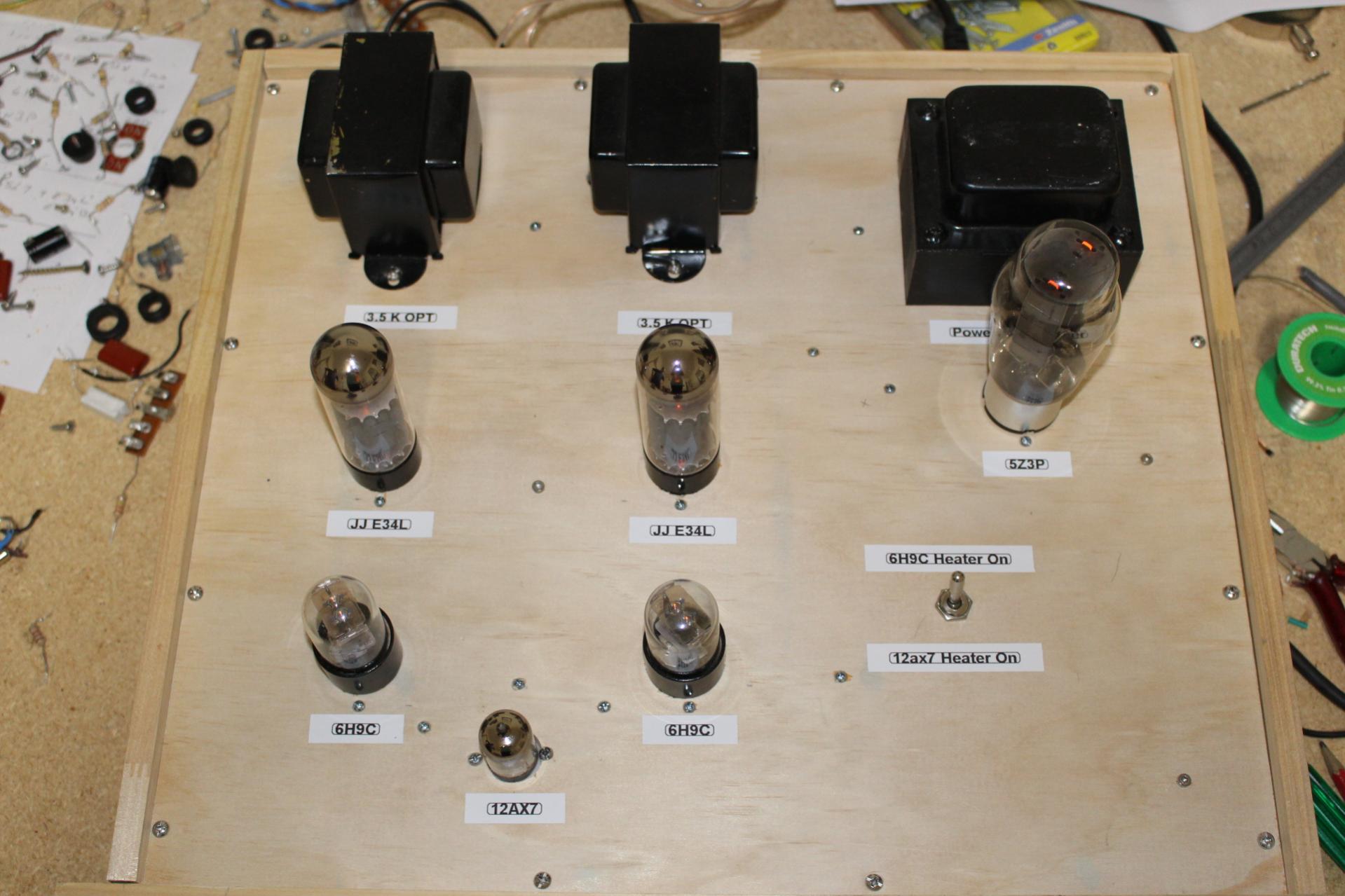

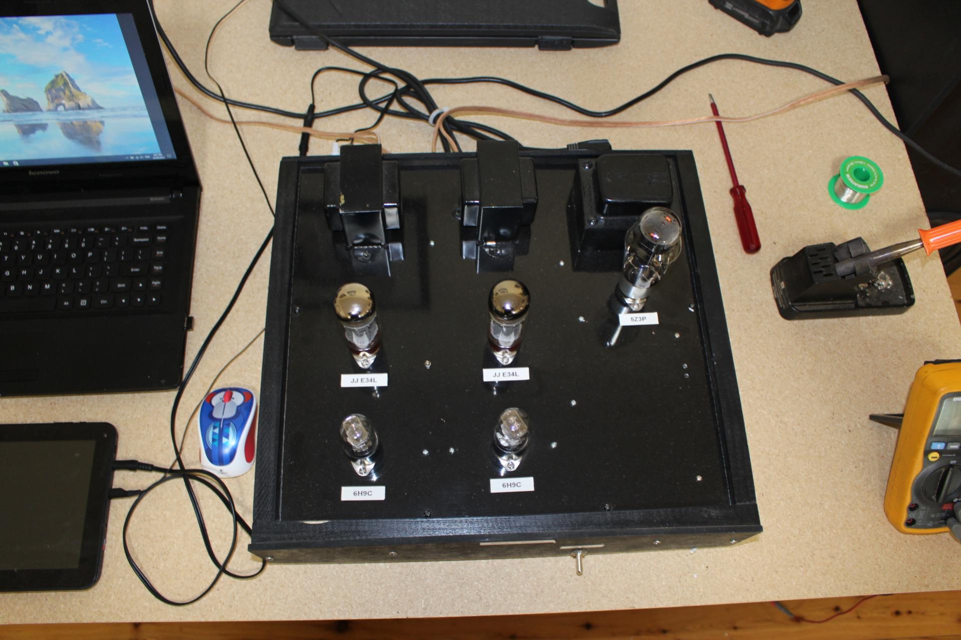

I just finished a 2 in one preamps / main amplifier didn't wanted single preamps so I decided to combine all 3 into one cabinet works great too, preamps are 1@ 12ax7 and the other is a 6H9C switching from one to the other through a JJ E34L main SE amplifier, the bass is excellent midrange is also great very happy with the way it turned out. next project will be a 6N3C main amp with 6SH8 / 6H8C preamps for jazz music.

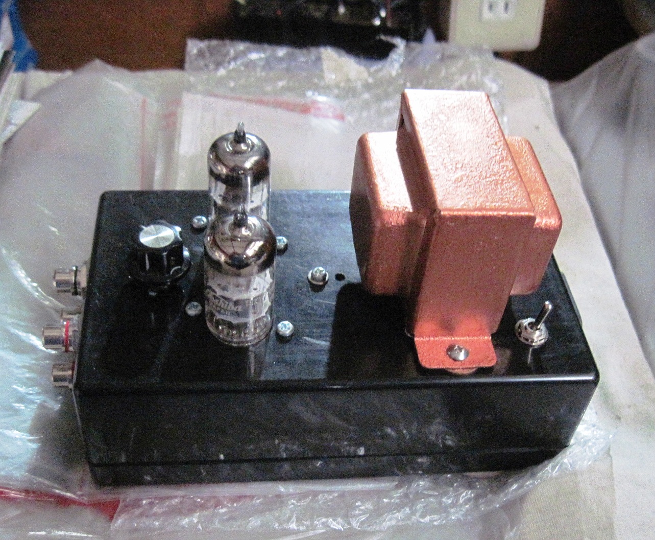

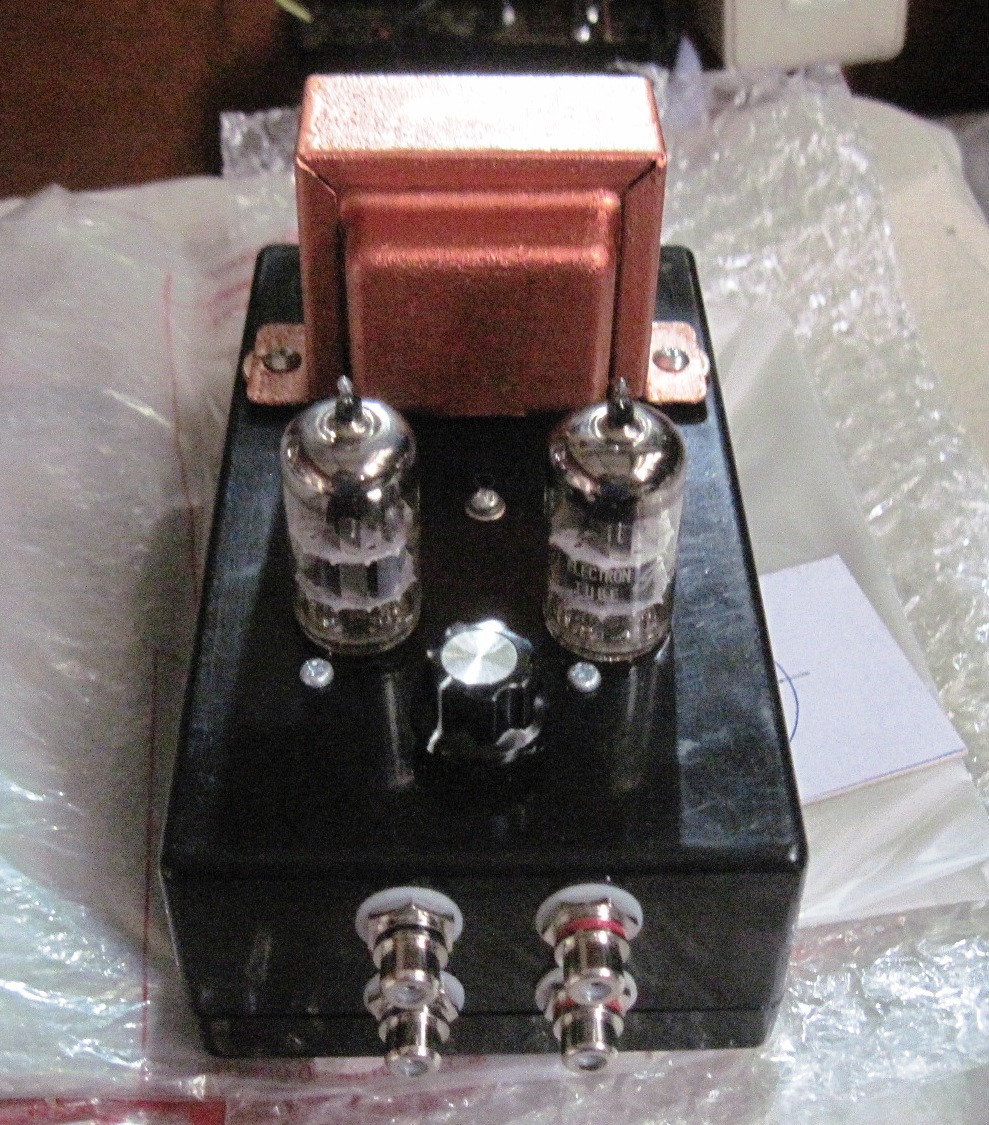

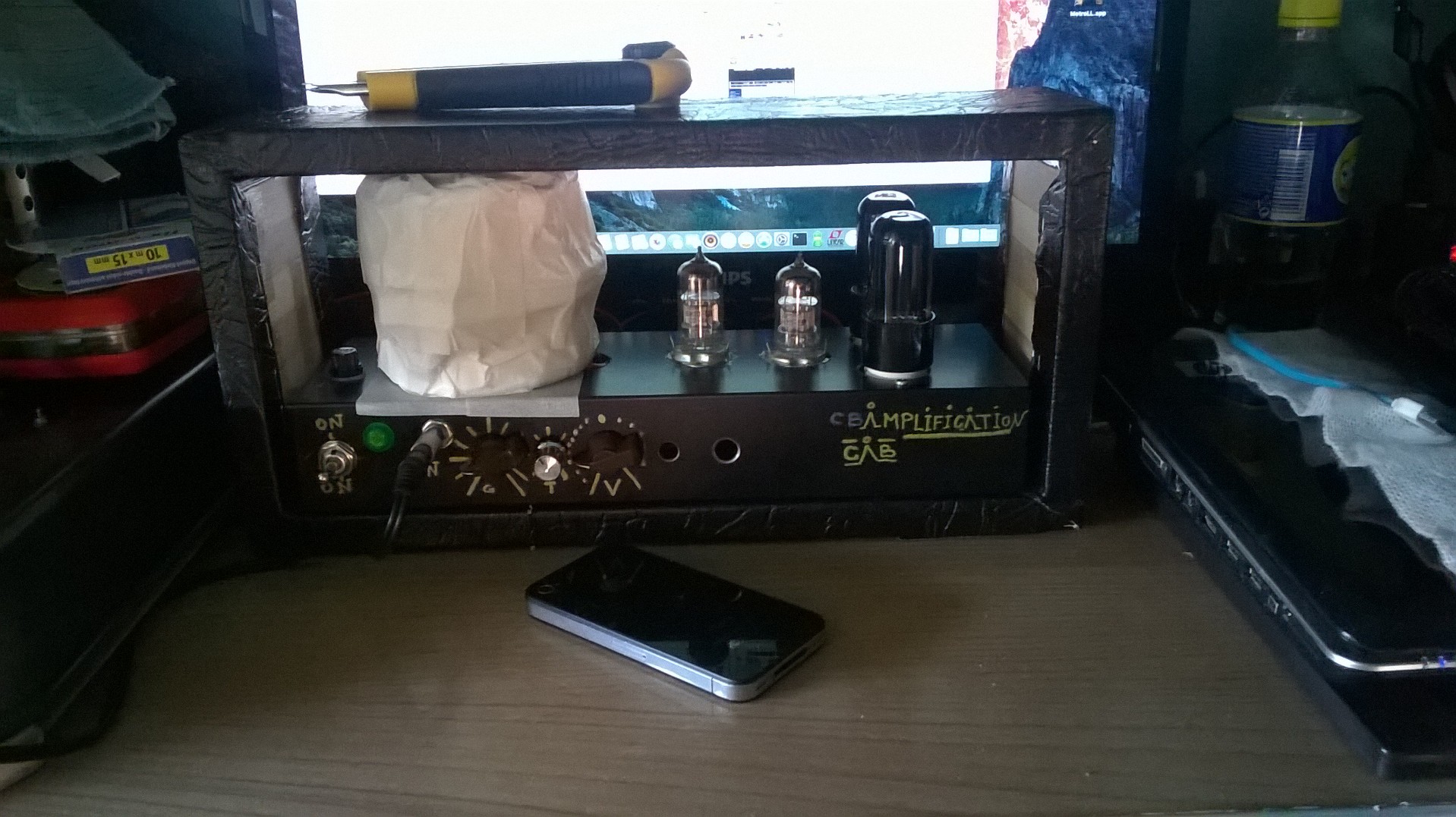

I' m glad you like it. I' m trying for low budget, good appearance and, of course, good sound...
