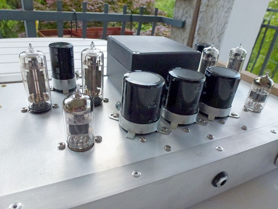

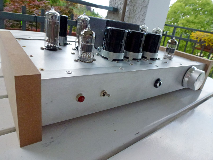

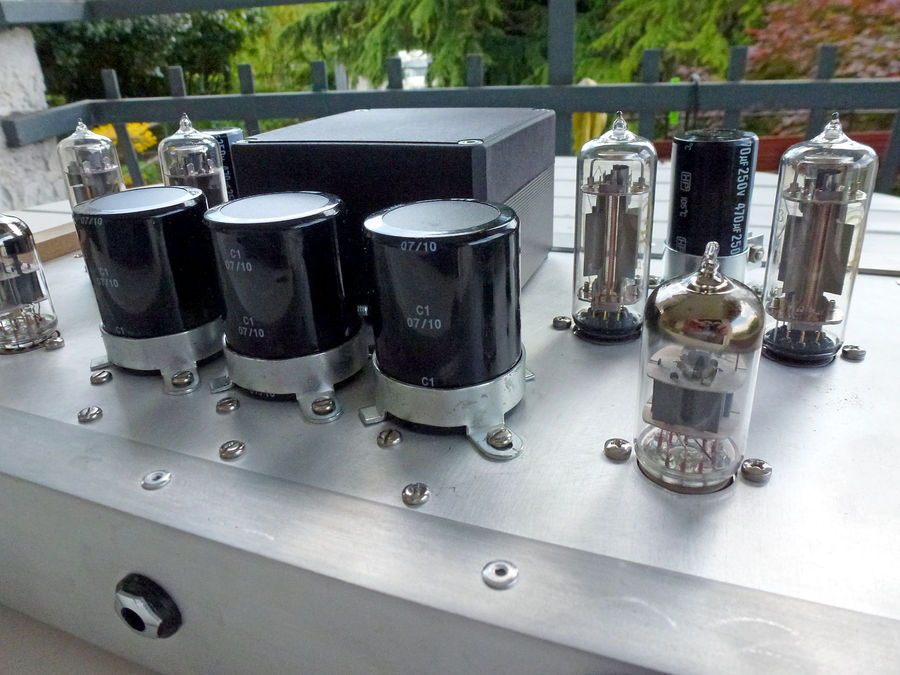

I wanted to make a "pumped" version of the famous Bijoux headphone amplifier by Alex Cavalli. This is the starting point which I then modified.
In this project, developed first with Pspice to optimize it, I used two triode 6S19P and one 6N23P-V for channel. Has been a long and careful looking for the best tubes working points and listening tests with various prototypes. This is the final version and is the best tube amplifier for headphones I've built (... and I have made many over the years).
As Venus amp the cabinet is constructed of aluminum scrap and MDF, I do not care the aesthetics but the best sound.
This is my best one! Great great sound and performance.

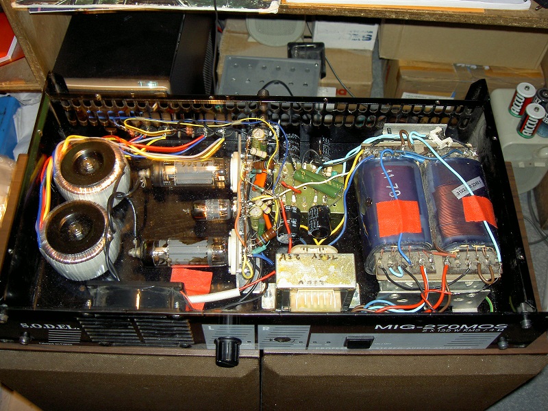

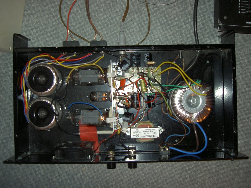

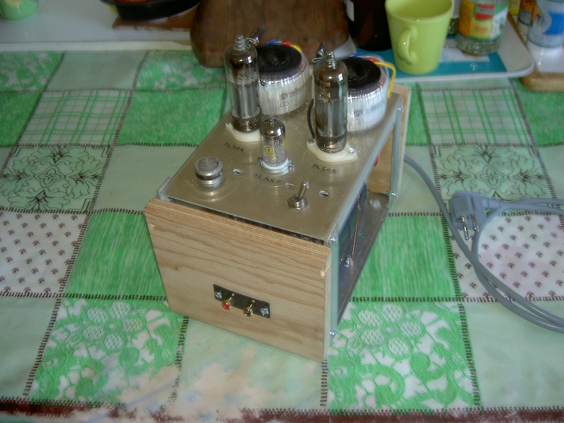

hello ,
i rebuild me old proto ...
old time to PL 504 / ECC 81 for out power 2 x 5 W max .
and new build to EL 502 / ECC 81 for out 2 x 6.5 W max .
the build use mode " Triode "
I enjoy seeing someone improving a layout/design and preserving/repurposing a style of case from the past. It makes me think of "how I'd do things differently...if I could go back in time."
It's pretty cool, actually to dive ito the ones stores of started but not finished project and give some old projects a new start. Often it takes some time to sort of digest the original plans and make something better of it.

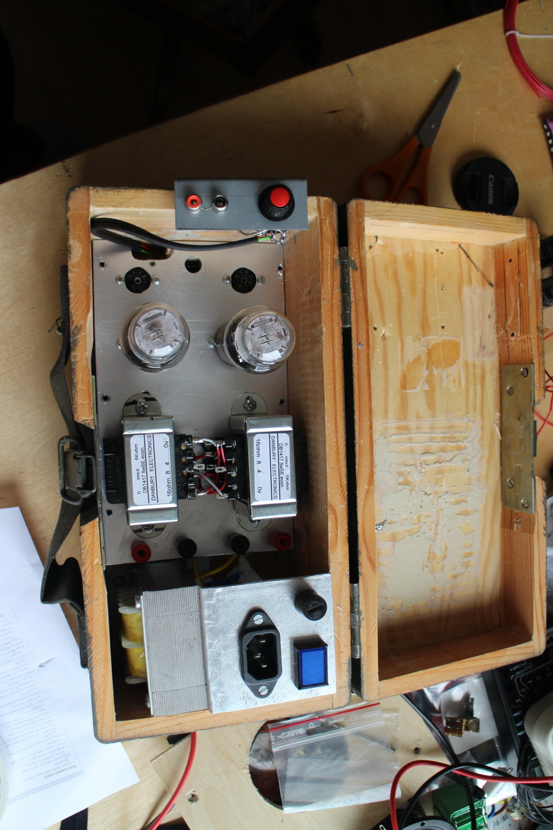

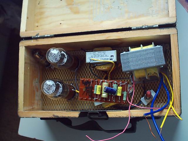

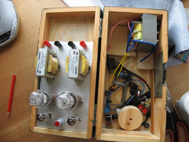

Right now I am trying to make something out of an old military dosimeter box. It once was intended for the original Darling (*), then a matrixed Darling, recently an original Darling and now a Darling but with 12B4A.
Edit: Pics below shows my dosimeteramp i various stages of "completion" but the 12B4A version is still to come. I chose the 12B4A as I have another Darling lying somewhere ...
PS. Do they still brew asparagus beer in the beer house in downtown Traverse City?😱

I didn't know the 502 valve, looks like 503, monster !
the valve EL 502 is +/- clone to EL 34 , so 20 W anode and gain max is 14 mA/V to 100 V=
looks like EL300 very popular in France.
yes , so futur build mode in " Triode "

If you took the trouble to put some real hardwood end caps on that, you would have a thing of beauty. I like the way you made a decent chassis without a sheet metal bender! Nice work.
