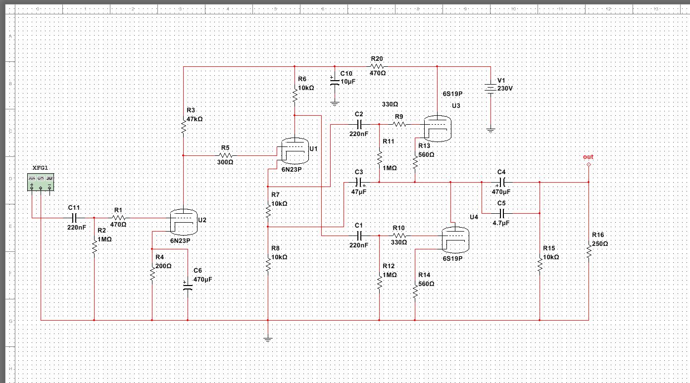

I like to take a look at the schematic
... the schematic

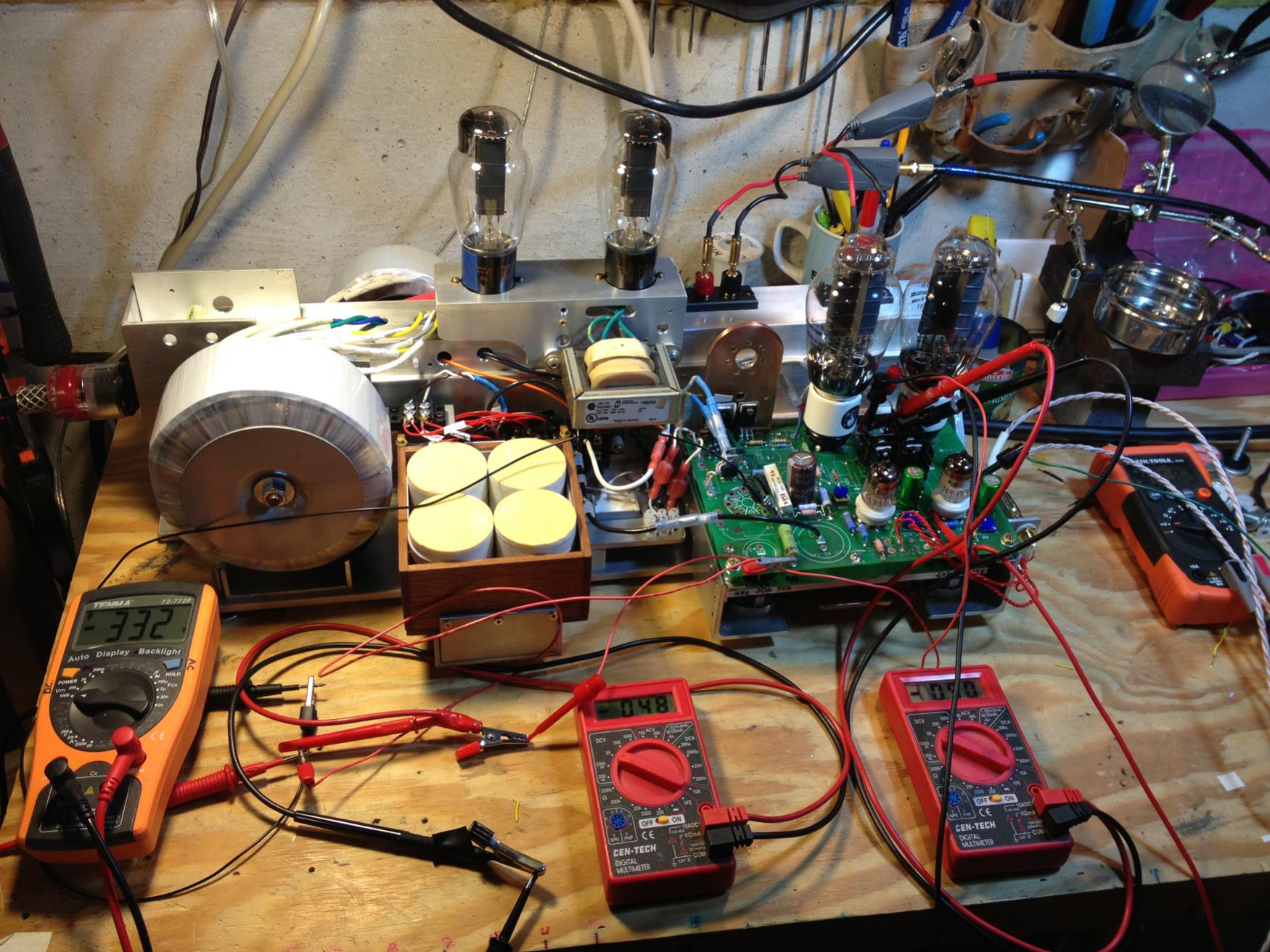

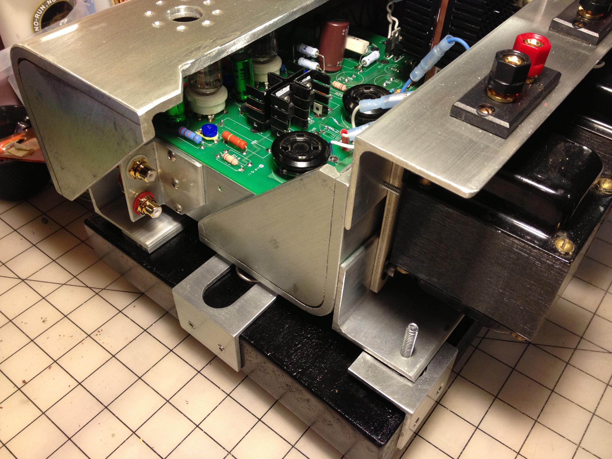

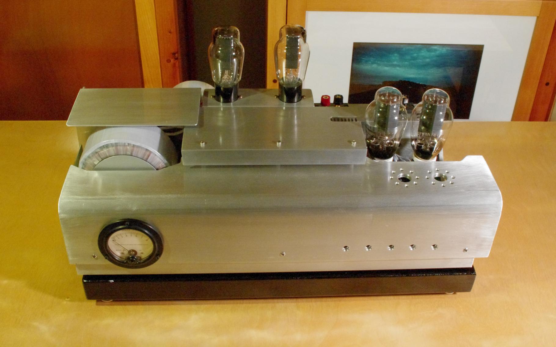

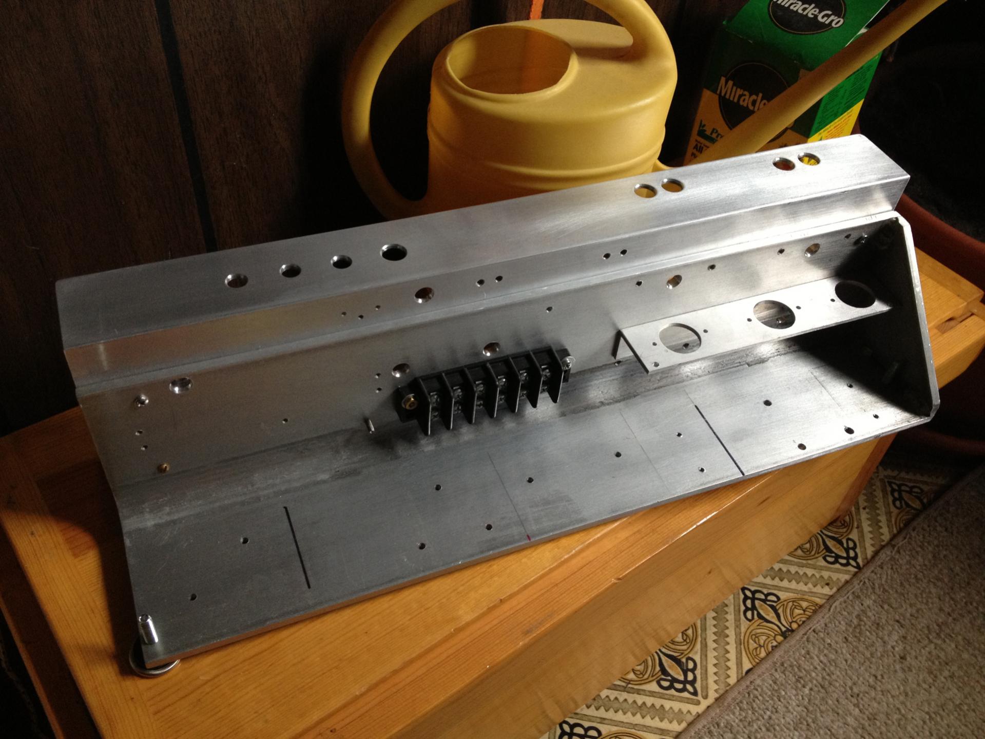

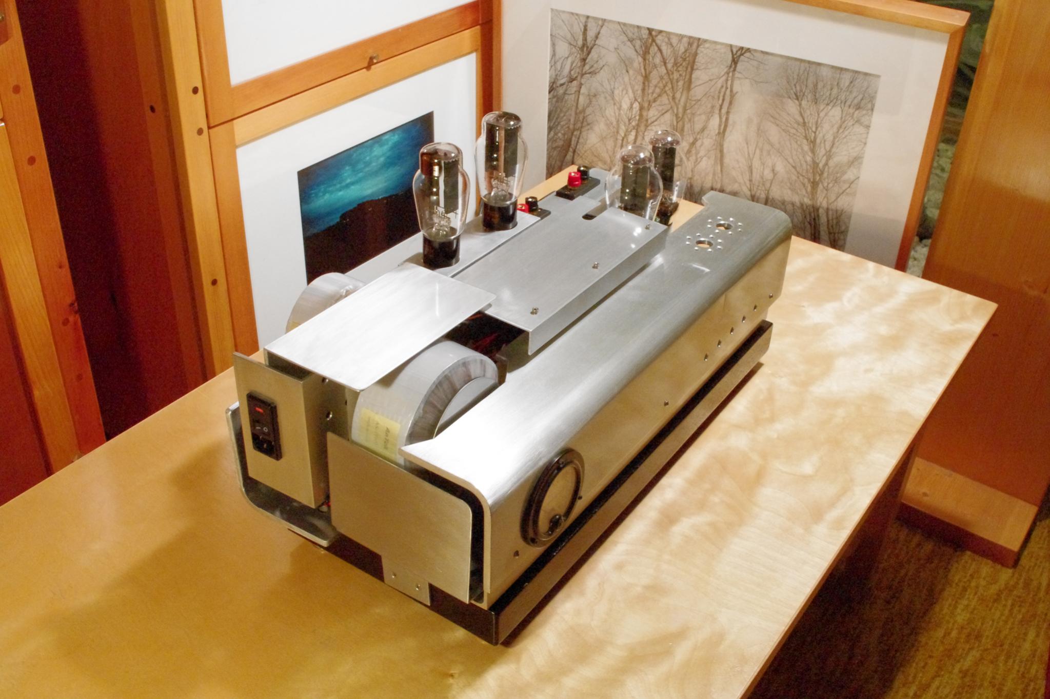

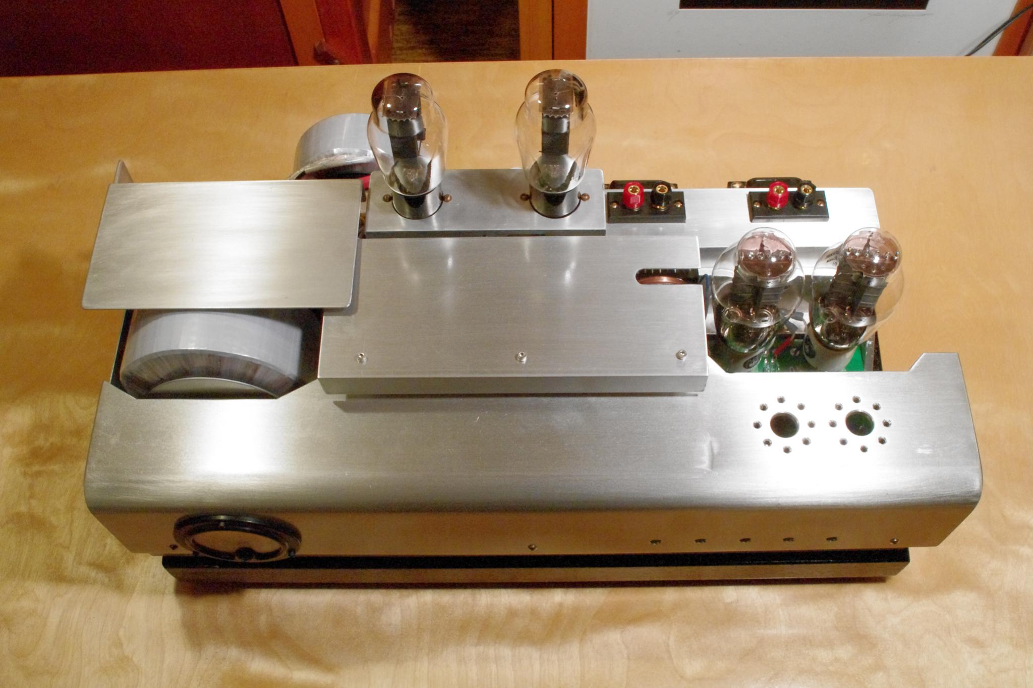

another scrap yard special
OK, so I found these heavy duty aluminum table legs at the scrap yard and I knew they needed a second life...
The signal stuff is the Tubelab TSE; the PSU is my own. Warning: don't try this with the TSE, it is not friendly to alterations of this type, thus the extra toroid on the back of the amp to get the bias circuit to function.
