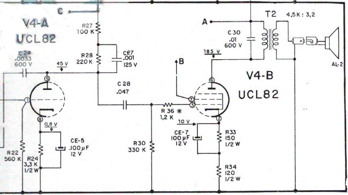

the uber simple circuit, except the cathode lifted from ground, and connected though a 1.5 ohm derivation in the secondaryand custom made 15W (overkill) output transformers with cathode feedback winding, for the UCL82 output.

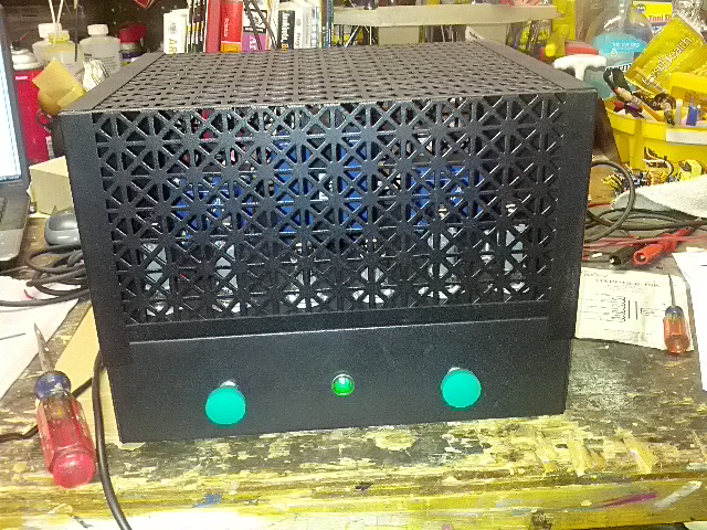

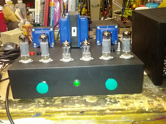

I like it, simple and robust. But, if you paint a) the iron bells light grey, or reseda green, or b) navy blue knobs and orange pilot light, it will be even better (IMHO).

The electronic is from an old Philco console, but modified, featuring a big isolation transformer (220 to 220 volts) and custom made 15W (overkill) output transformers with cathode feedback winding, for the UCL82 output. The wooden furniture is "ex novo", completely different than the smaller original: The speaker arrangement was inspired on a bigger and considerable more pricy Philips console (those with OTL UCL84s and 800 ohm drivers. This thing teached me that, in a favourable context, 2.5 tube watts a side can be more than enough. I whish to thanks the guys from the argentine site "Tecnicosaurios" that kindly shared the schematic, and service manual of the original Philco console.

I feel deep that in this thread tastes are tastes. I say deep that anybody wouldn't qualify the aspect that anybody else got from colour combinations, forms and materials that the humble or magnificent finish of the member could show and teach to the rest of builders. IMHO, On step of criticize we should learn "the better" that is obtainable from the designs. This is the thread in which ordinary like me and you can show our works, and at least the minimum rather than criticize is that at least remain silent

Design is not art. There is a right and a wrong way to design something.
There are rules. My wife has two masters degrees in design. It is a serious profession.
I think people giving design advice are helping, the same as people giving circuit advice. We are all here to have our designs critiqued.
While it is necessary to learn the basic rules, the best designers learn how to bend and shape those rules into something closer to the source.
That is an art that requires many years to master.

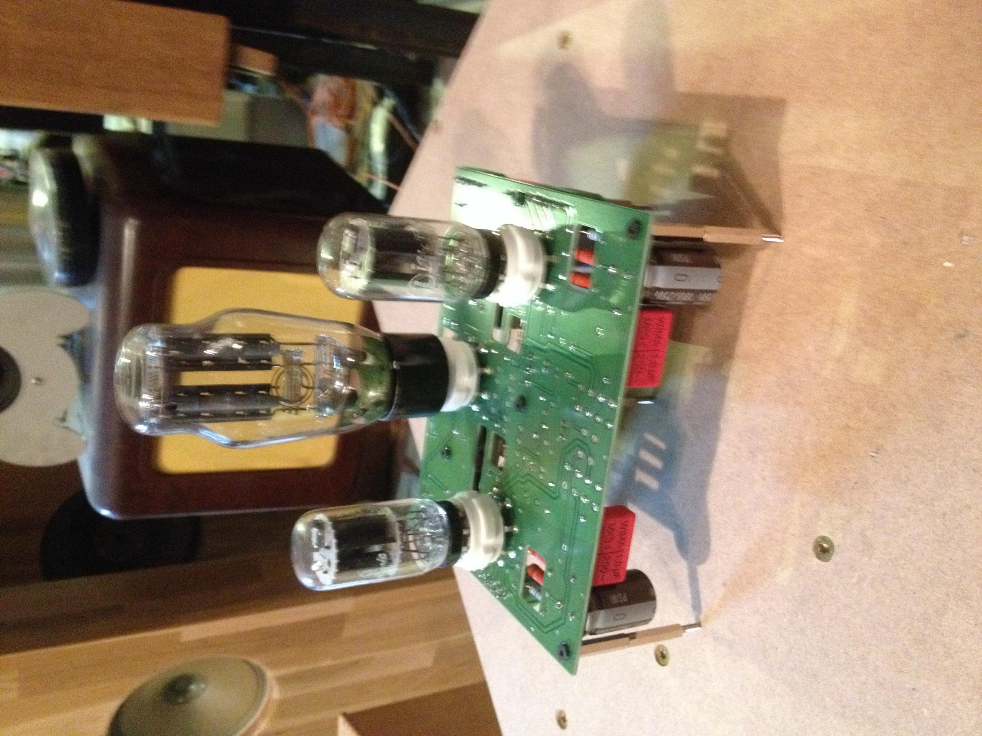

My new pcb's arrived!!
The basic board is for a stereo 6EM7 amp including PS.
You can use a tube or diodes. The board is configurable too.
You can make a pre-amp with it as cascode with a 6SN7 or just 2 stage with 6EM7 if you need to drive something big. There is also a subwoofer output.
Small board. Lots of possibilities.

yes, I had made 3 seperate boards before, mono and the PS but that still had a "lot" of wiring. now I'm almost "wireless". I've made about 25 amps with the small boards, now I'm more free to configure them the way I want. I can drive a 300B or a KT88 or KT150 or even an RS607. Or just listen to almost 2W of pure single tube audio pleasure.head1962,
The PCBs are your own design?
