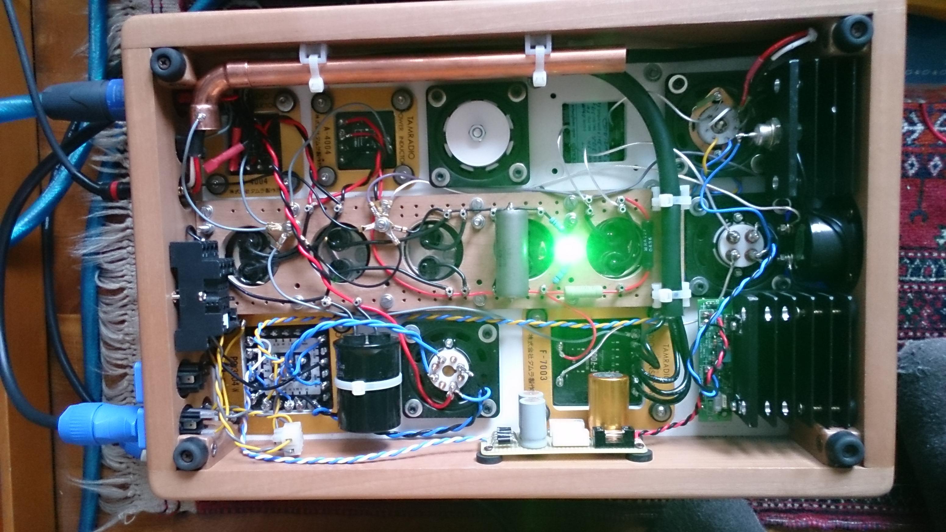

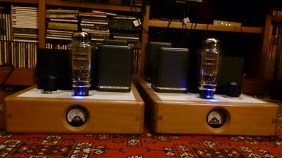

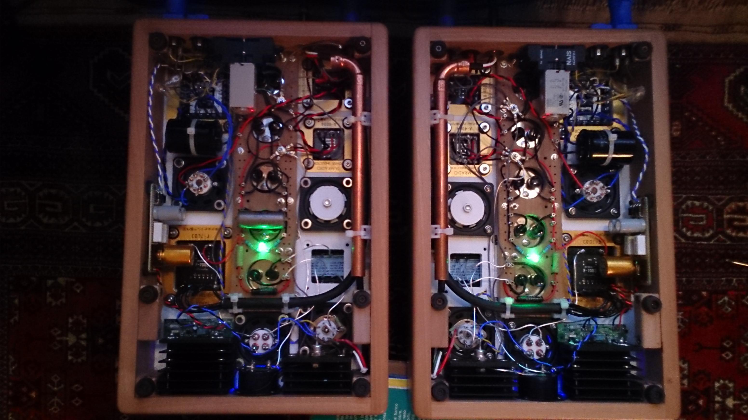

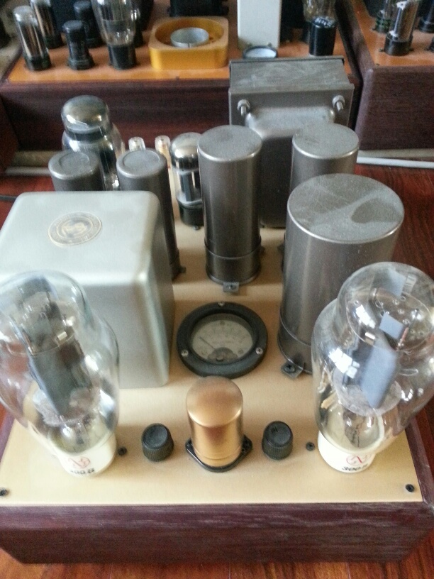

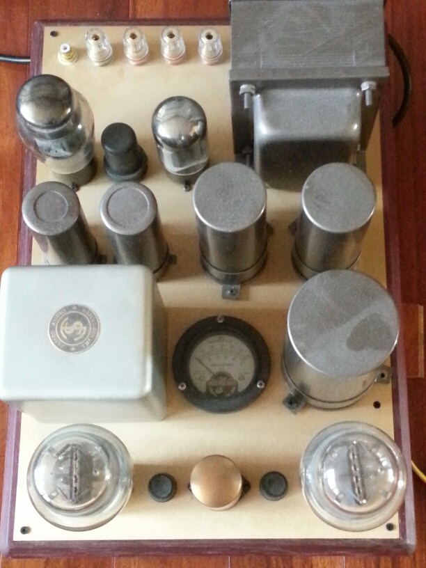

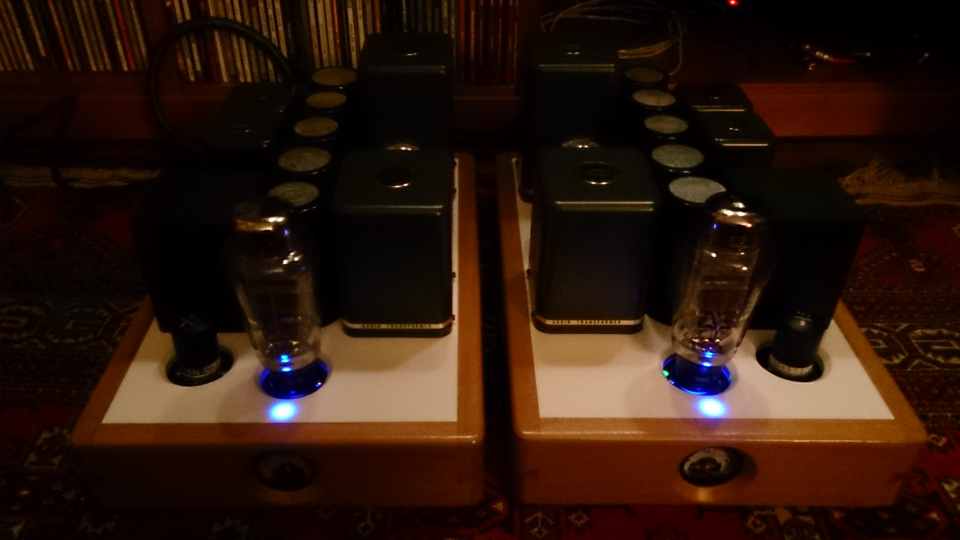

EML 300B mesh driven by c3g.
Heaters supplied by a Coleman board.

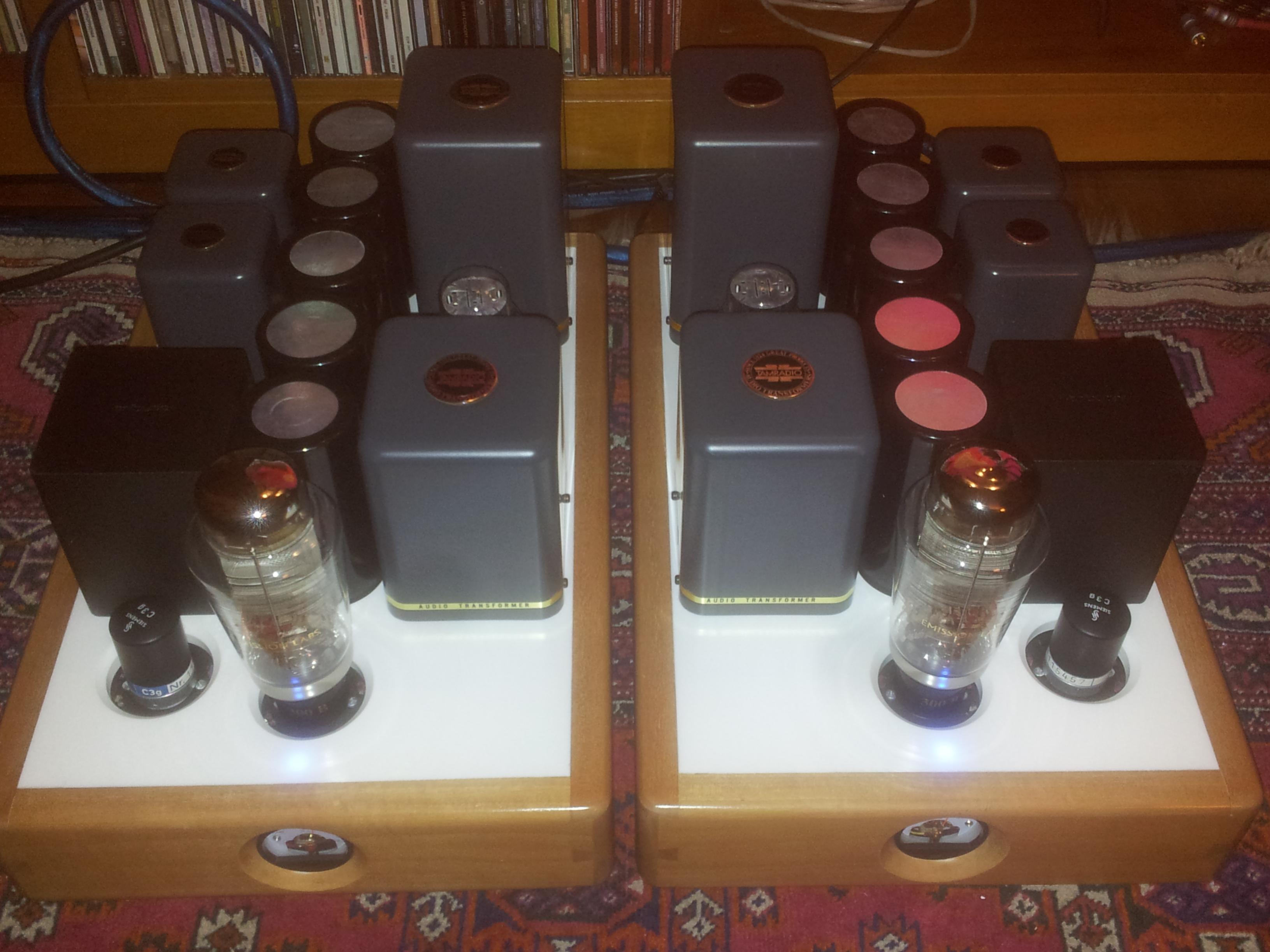

Interstage coupled (a really well sounding Tribute on amorphe core).
A lot of Tamura irons. Including the famous F-7003 (5K). A little pain for my wallet but a plesure for eys and ears.

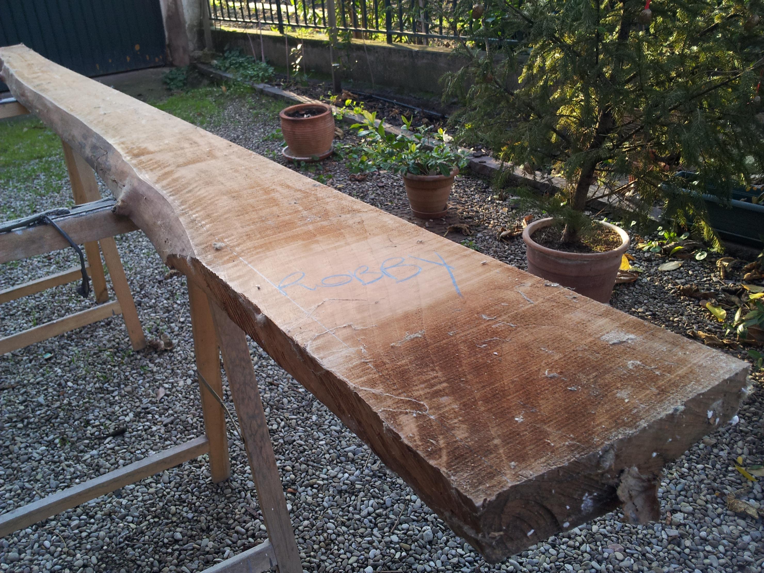

Case with frame of walnut wood matching a Corian top.
Dovetails joints on edges.
Professional Neutrik (sepeakon, powercon and rca) connectors which I found more reliable and good quality made for a fraction of the price of "audiophiles" ones.
Gain enough to be driven directly by the DAC (Buffalo I).

Whats the idea with the copper tube and elbow.
attacato alla canna del gas! 🙂Hi,

Why did not use all the iron from Tribute?...or Tamura?
Diagrams to share??

What speakers did you drive with this?

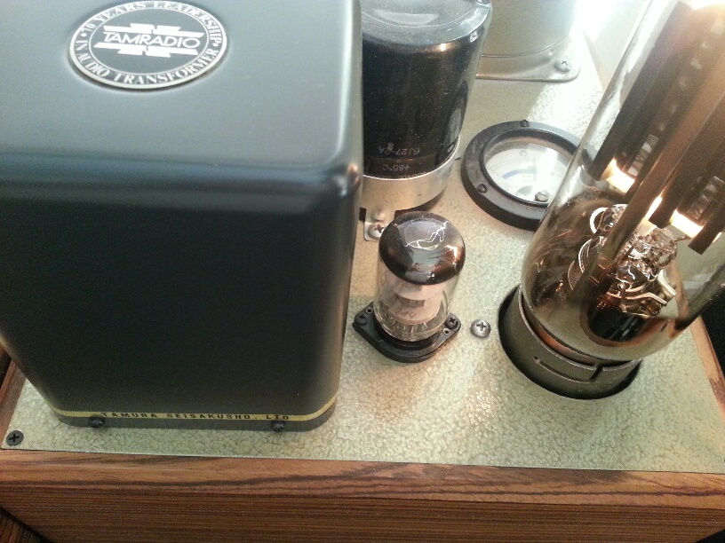

An interesting coincidence, this is my 845 SE 10W amp, 2 stage design using Tamura F-7003. Input tube is C3GS (nude) in pentode mode (plenty of gain), capacitor coupled to 845 tube. Beautiful sound when mated to my Stacked Quad/RTR tweeter, now it power my Tad2001 horn.

The tube I thank is a WE437 but is a C3G without shield.
It should be a shield. Not for mains cables but for signal input cables.Hi,
I don't have any metal part in the case and the amp is placed in a bookcase with tons of electronical equipments around. In ls than two meters:
- TV
- Children's PlayStation
- Children's Xbox
- Children's Wii
- Cordless phone
- Router
- Multimedia HT-PC
- DAC
- Blueray reader/writer
not all switched on at the same time but enough to make some noise.

I have a couple of Tamura B-5003, but the Tribute.....PloPla.....great work.Congrats.
Diagrams to share??
Thanks.
Speaking around seems a miracle to have been able to receive a couple of Tribute in a relatively short time.
I'll ask him for some more for shure, excellent products, but I know you have to wait.
I don't have a diagram.
But is not a difficult.
- Double choke supply in common mode (half each on the positive side, half on the negative).
- 5u-10mH-70u-10mH-210u-R-70u
- A blue led under the c3g to get -2.8V on the grid
- A power zener 68V under the 300B
- B+ 390 (including the 68 on the grid)->65mA
- B++ 200V
- Interstage
- grid stopper 1k
- grid resistors 100k on both tubes
C3G/300B
Yes, that was C3G driving 845. I took the shield cover off exposing the tube, I call it C3GS nude.

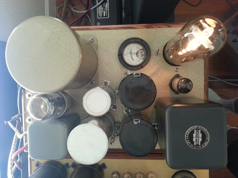

Below is 300B PSE amplifier. Input tube is also C3G painted. Amplifier has tube regulated power supply and oil cap. Originally it was a 3 stage SE 300B with interstage, C3G input driver 300B with interstage driving a SE 300B. It has been changed to 2 stage 15W PSE300B, but it can also be modified to 8W SE 300B without much work. Output transforner is James.

JBL 15" 2226H in BR 90 liters + B&C 2" driver DCM50 with StereoLab horns Tractrix 250 + Fostex T925
Filters round 500Hz and 5.000Hz
Efficency round 96 db/W
