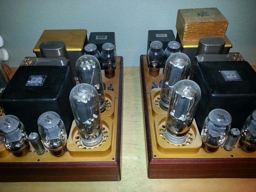

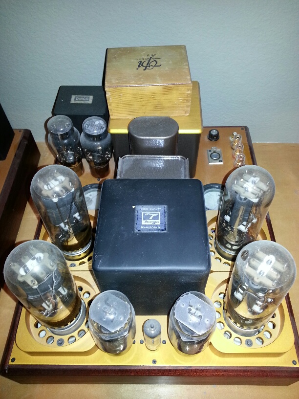

100W Class A 845 Parallel Push Pull amplifier.
I pull out my most powerful tube amplifier in my collection: 845 Parallel push pull amplifier, 100W pure class A to power the Acoustat/Tad2001/horn system. Plenty power to drive the 2+2 with authority.
This amp used nothing but power tube: EL84 for input, a pair of KT66 loaded interstage for driver, quadruple 845 for output. A pair of these amp draw about 1500W out of the wall playing music.

Your 6C33C built already so unique now you have stepped up the game and get these powerful PPP 845 done nicely. Congratulations.
Are you going to bring these new additions to this year's BAF?
