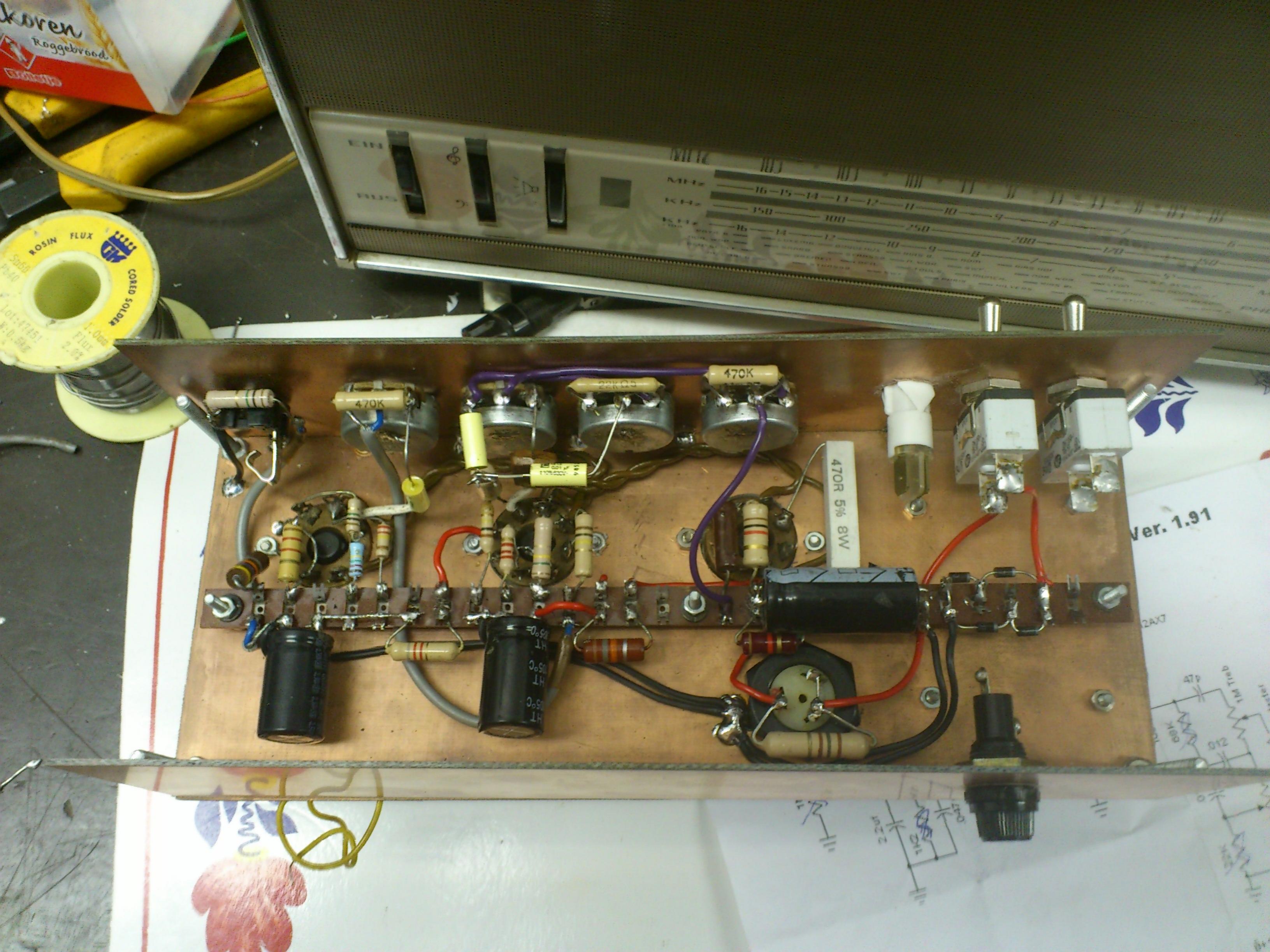

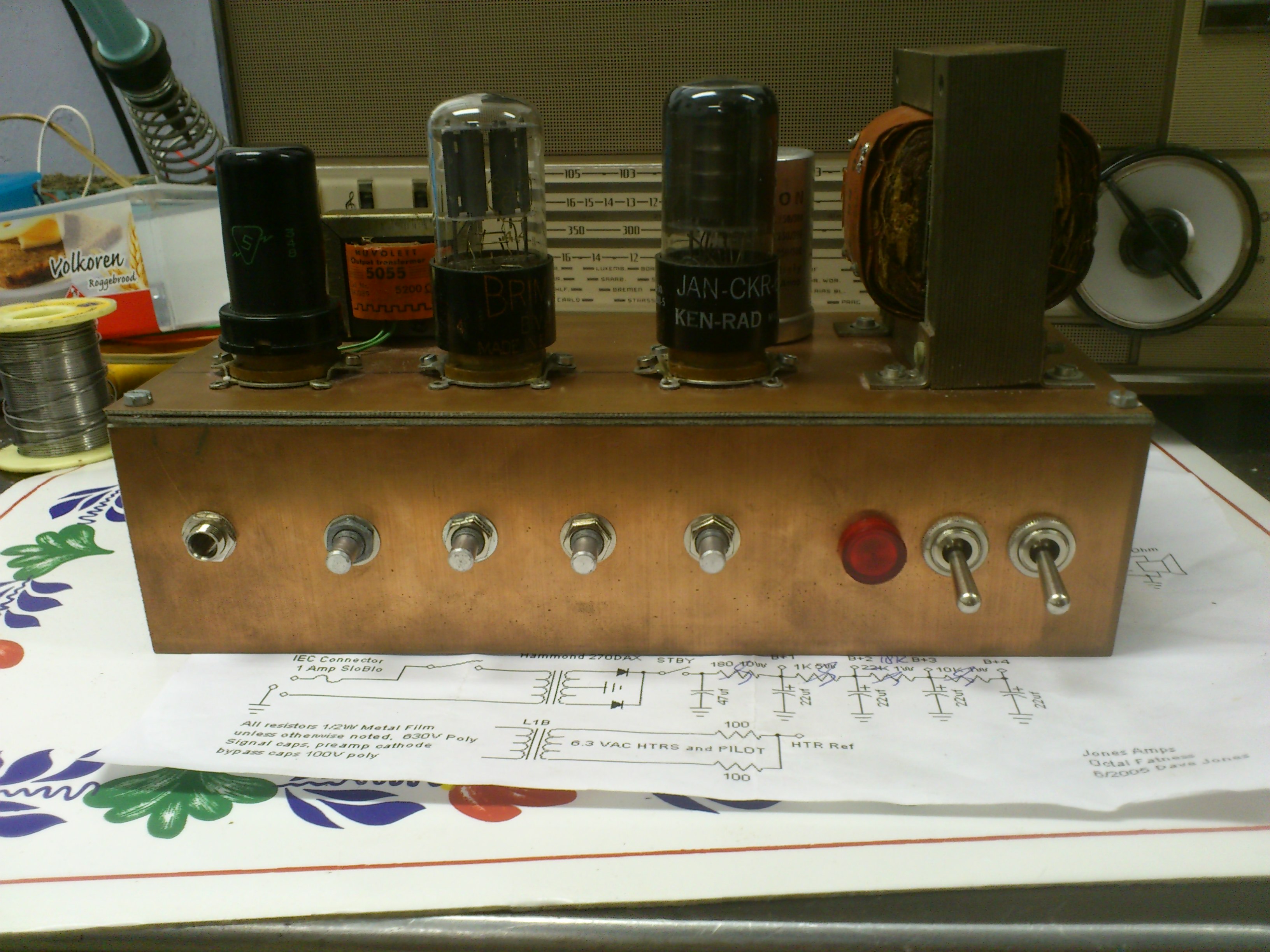

A while back I built this small guitar amplifier with all octal based tubes.
- 6SJ7
- 6SL7
- 6V6
Controls are:
- gain
- bass
- treble
- master

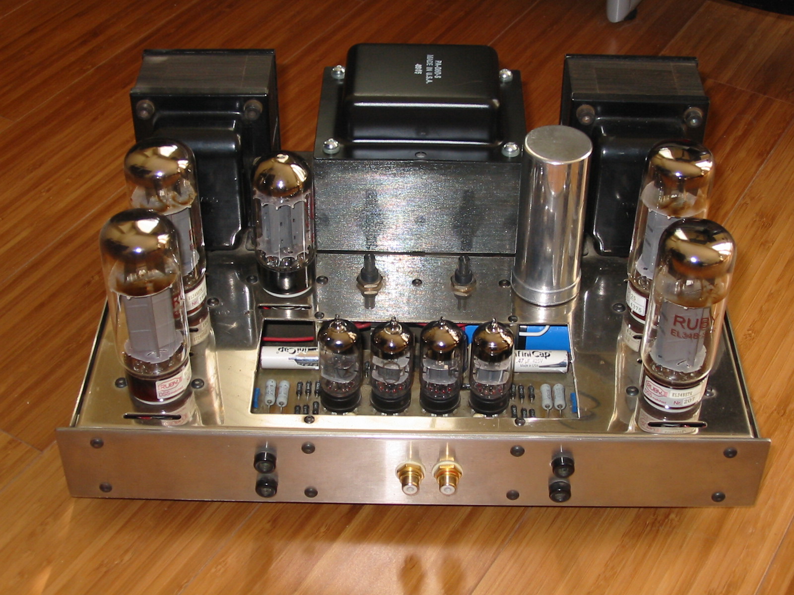

My humble contribution. It started as a Stereo 70, but the only remaining original parts are the chassis, cage, outputs, and fuseholder. Curcio cascode 6922 driver, triode wired, beefed up stock supply with lots of by-pass caps. It has been making tunes in my system for 20 years now. 😀

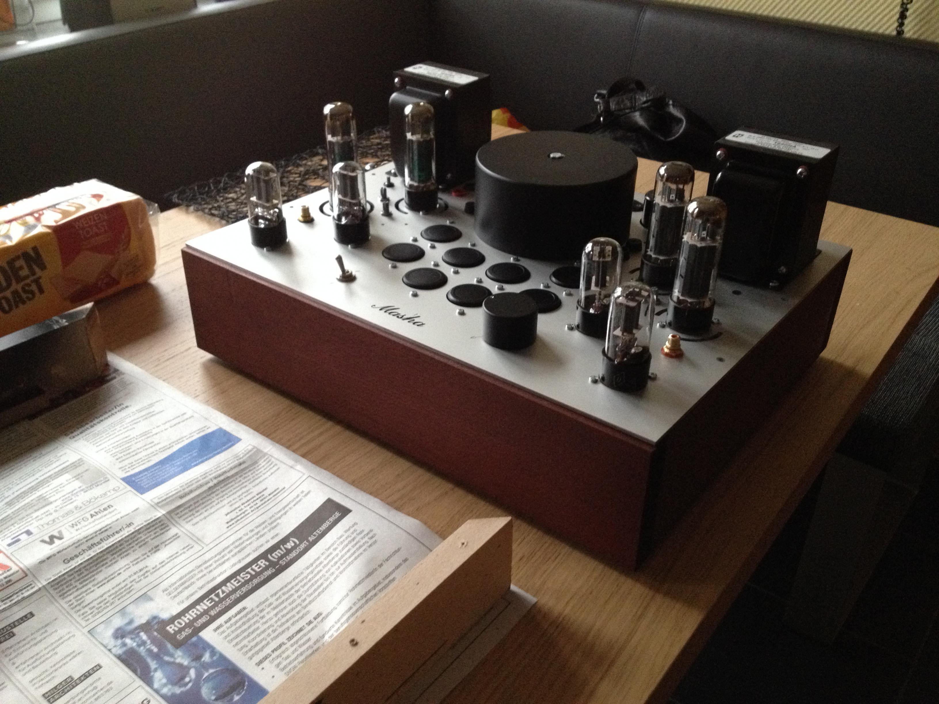

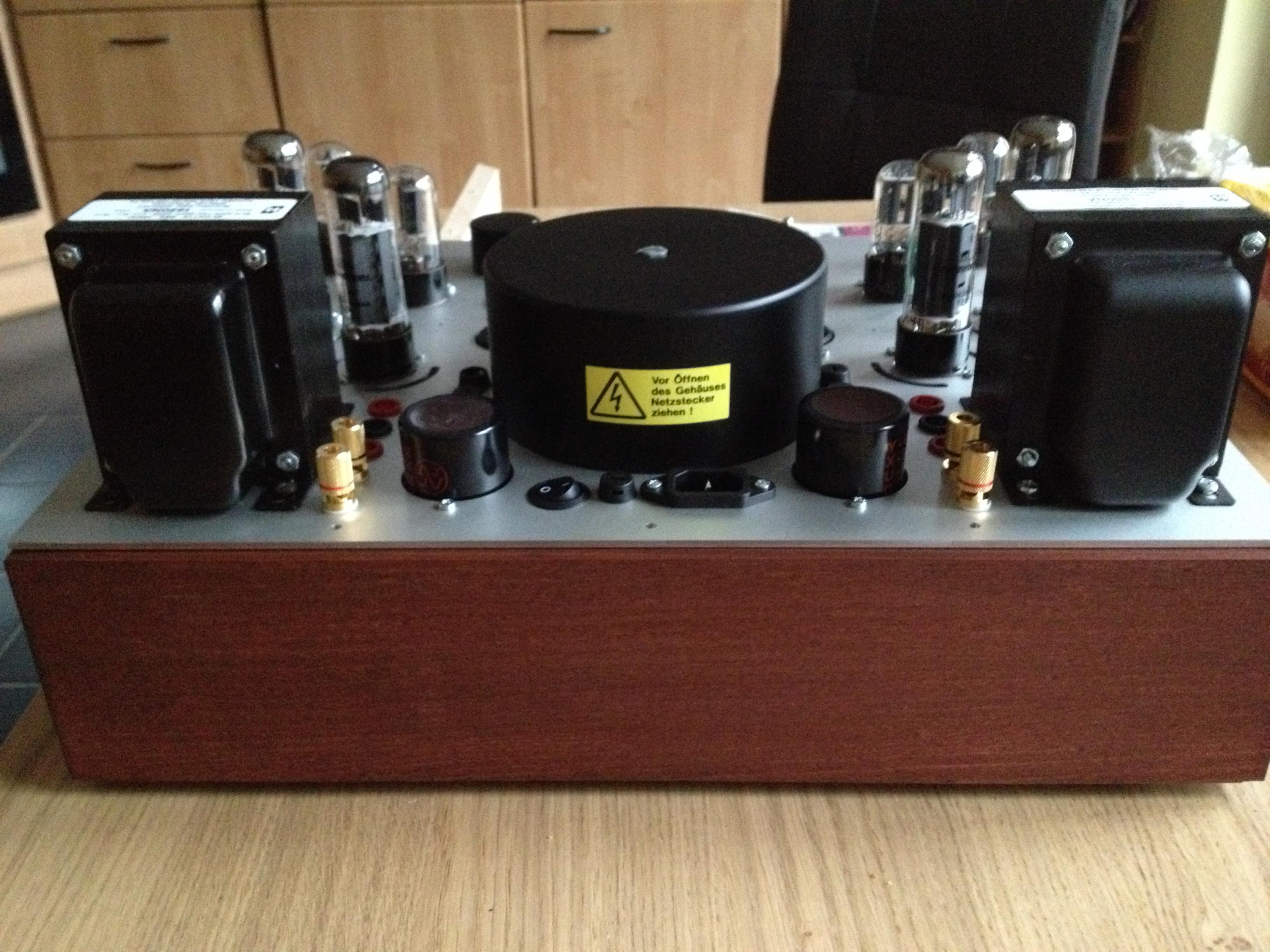

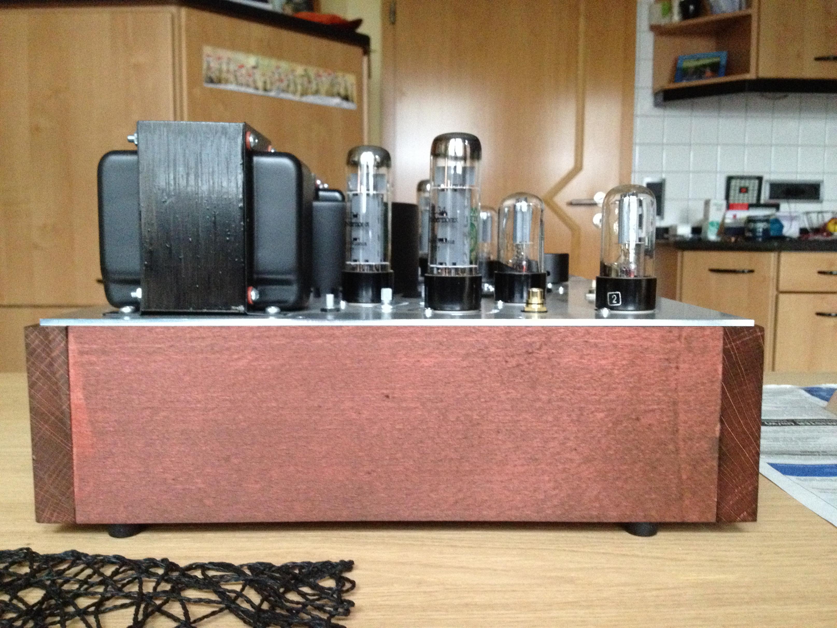

I nearly completed my recent stereo amp:
Two 807 SE, one 6SN7 and EAM86. Only the Volume knob is missing yet... It isn't that easy to find one as big as I want it to be 😱
Maybe I'll do one of hard wood...

Very nice and clean looking amplifier. I like that EAM86, does that vary with the volume level? Also, is it some weird error or is there really a blue blow in those 807's?
Thanks 🙂 It took some time until I was satisfied with that veneer...
As the picture is long time exposed (ca. 10s), the tubes' light effects appear to be a bit too strong 😀
The EAM86 works as a simple volume indicator, i.e. varies with the music. Actually there is a faint blue in the 807s that can be seen even at daytime.
