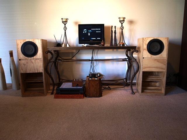

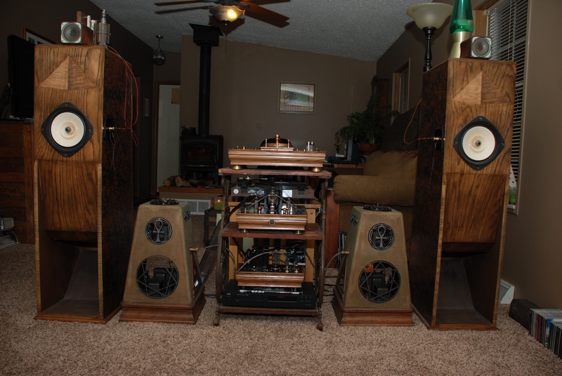

Here is a shot of my 1920s tube based (UX-171-A) Intermezzo amp with Fostex FE206En backloaded horns, Oppo BDP-95, 4SUniversal single stage 12AU7 tube amp with BoZ buffer stage and all wire-wrap inter-connects and speaker wire. The rec. tube is a 1940s 80.
Very transparent.

Nice work!I love the vintage look.I always strive for this in my projects as well.Taking inspiration from the lovley old table radios of generations past,and throwing in a little steampunk as well.
What's the story with those Fostex FE206En's?They look nothing like mine!
The speakers are Fostex FE206En in the backloaded horn boxes.

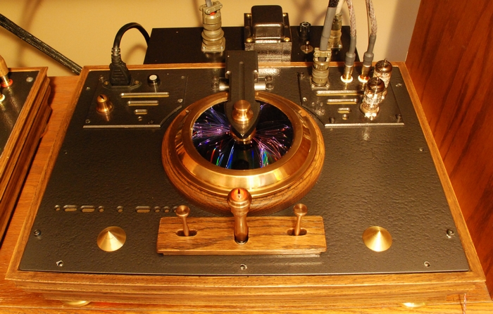

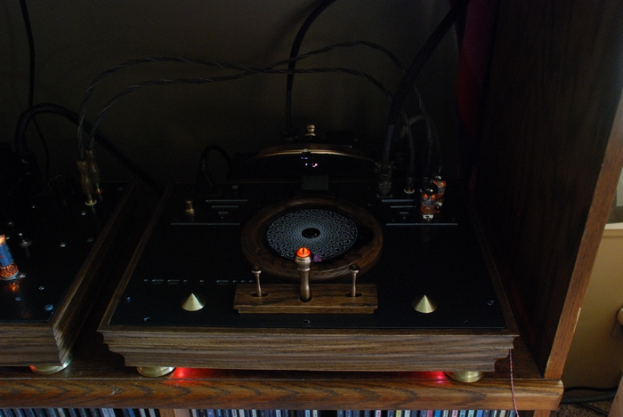

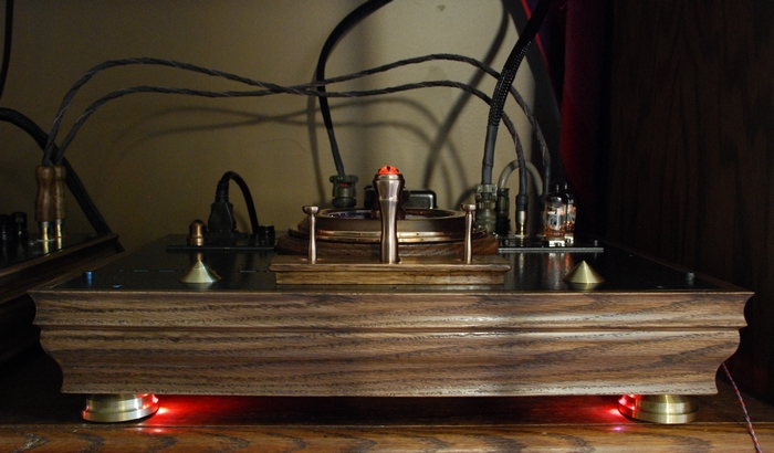

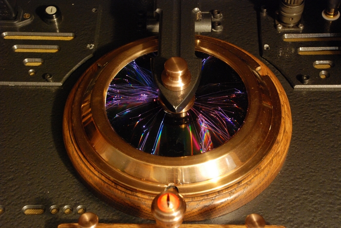

Thanks for all the great comments.That Cd player was a rather ambitious project to say the least.I enjoyed challenging my engineering and fabricating skills and gettting to use the 110 year old metal lathe I inherited from my dad.He would be proud to see this.I think my next project might be a little more "normal"...naaa.I am kidding,I can't do normal.:D
He would be I'm sure.
