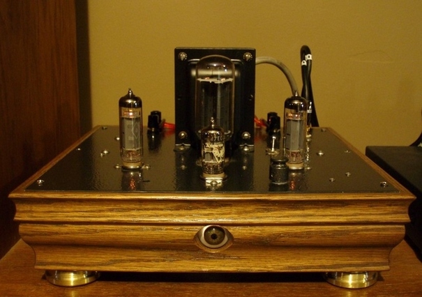

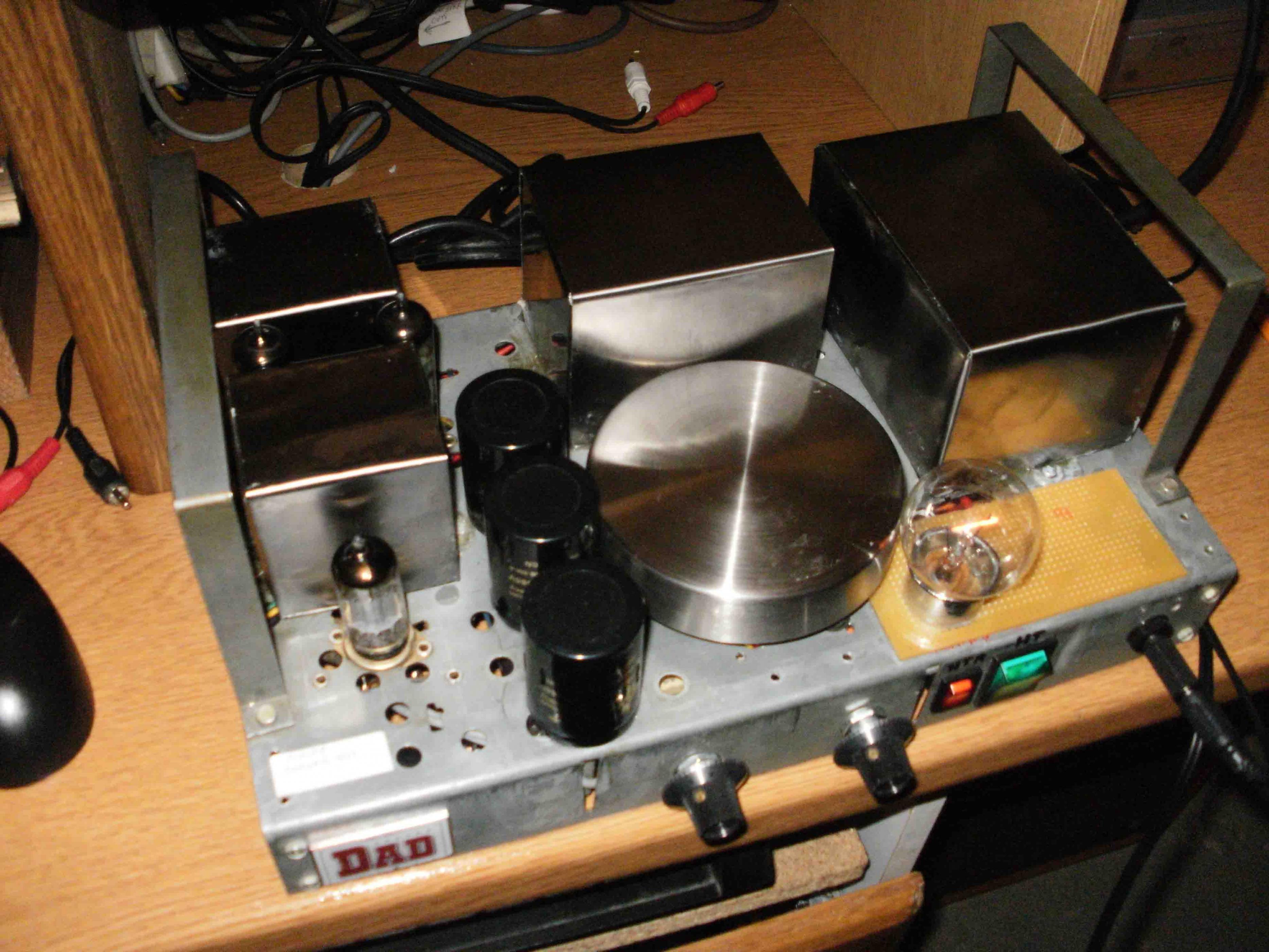

Thanks for the comments guys. I stuck with the original Mullard valve set ie ecc83 and two el84. As for the HT diodes, I went back to the silicon bridge and just used half of the bridge instead of two 1N4007's and the sound is better.
Latest pic with full covers. The amp sounds nice for guitar sounds and for my rock and roll moods.

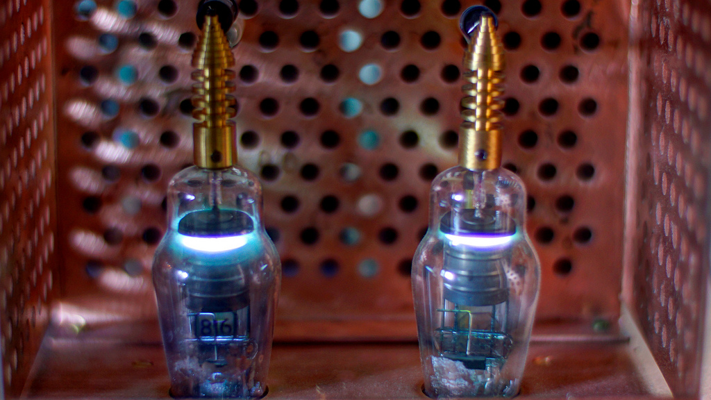

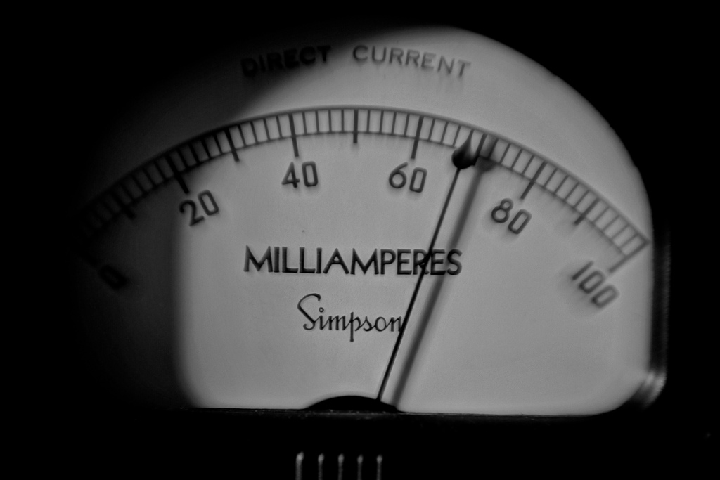

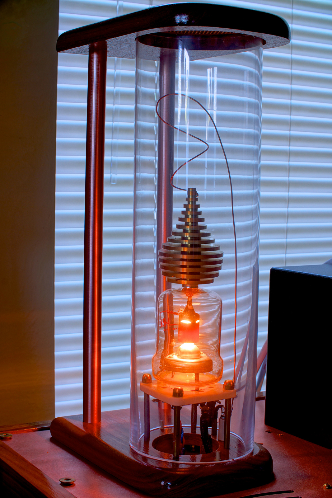

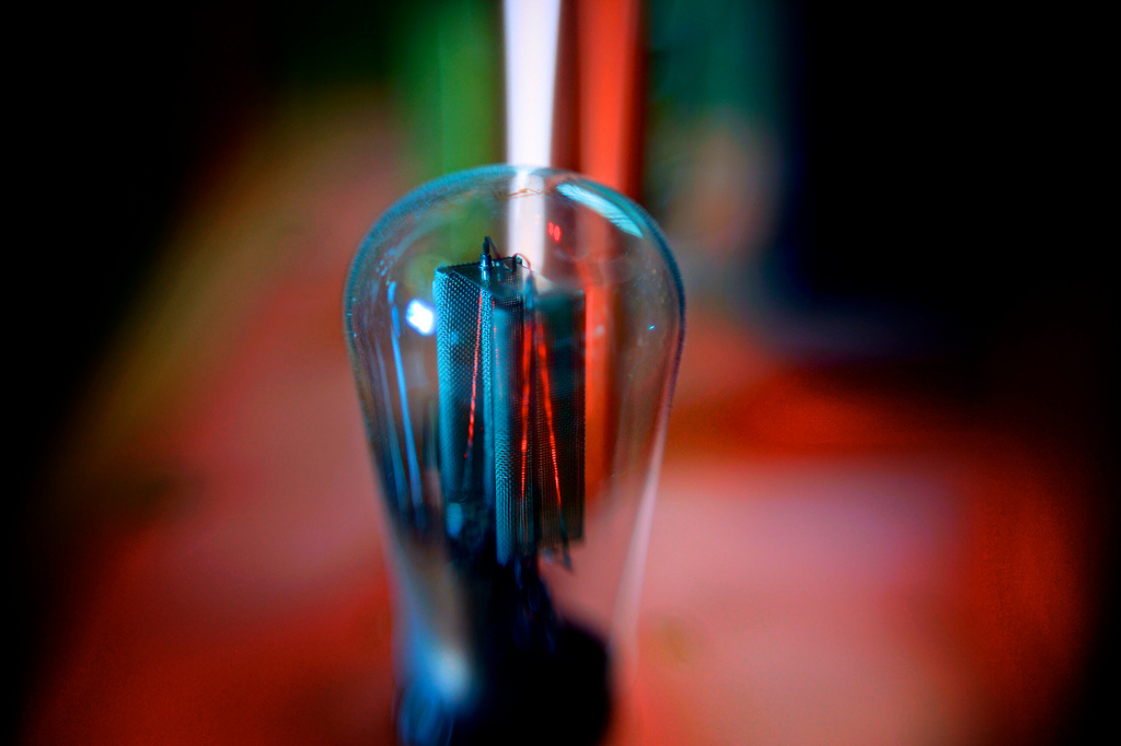

New (more artistic) pics of my 4-65a amps
Some were taken in HDR and some with a Lensbaby and speed adapter.
Original post back from last year when the amp was first completed.
http://www.diyaudio.com/forums/tubes-valves/71300-photo-gallery-463.html#post3328592
One change is that it's gone from a d3a as input tube to a e280f. This input tube has about 3.2v bias from two AA batteries. It avoids problems I had with running the d3a into A2, and I think sound a bit better as well.
-MW
