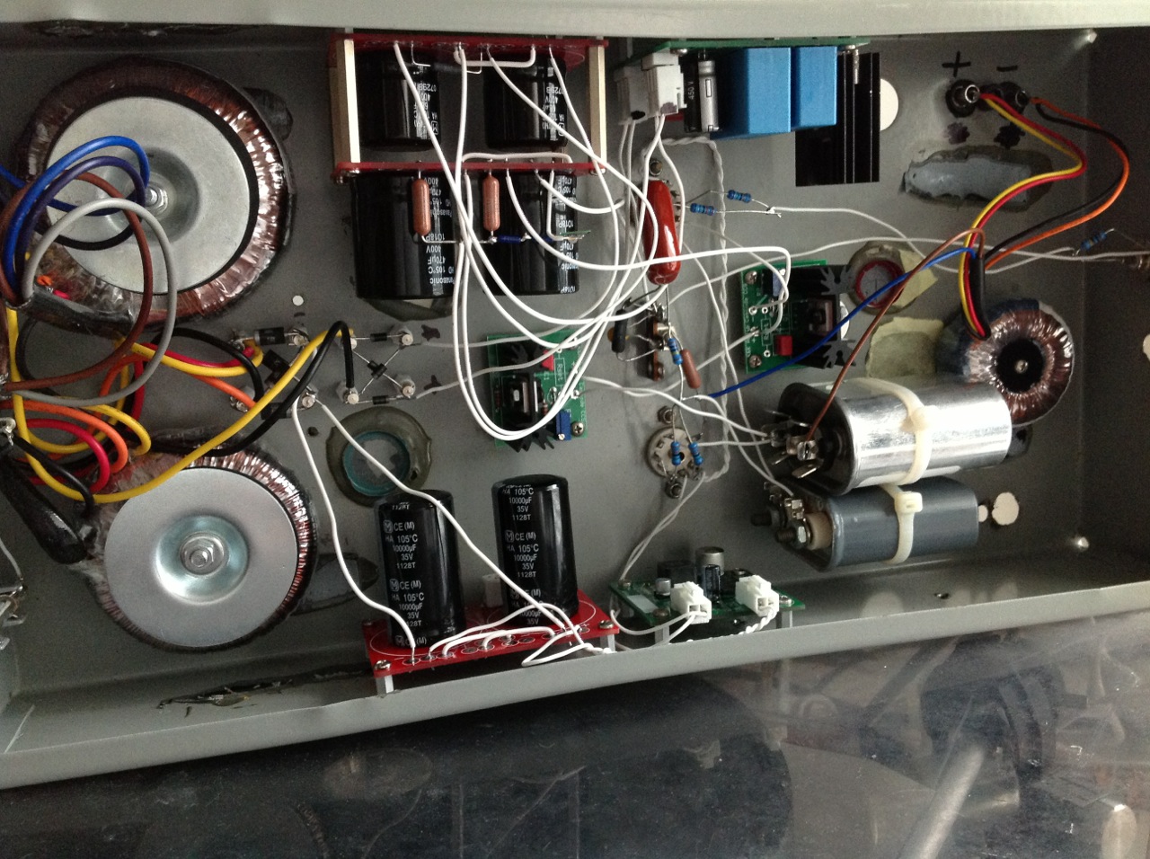

i cant ever get them to stay longer than a year! even clean the surface, grind off paint clean with solvent etc.... dont last.
i like the duct tape, not that it is the best looking underside... but come on, you cant argue the top side is B-E-A-Utiful!
self-adhesive ty-wrap pads
I'm in the process of repurposing an electrical panel as a control system module for my new DIY wind turbine here at home. There were a bunch of these self adhesive ty-wrap pads which had to go and they were very difficult to remove. Perhaps not all of these are made to the same quality spec. These had a very thin layer of white foam sandwich under them.
It's probably the heat of the amp that degrades the adhesive and/or the temperature cycling of the amp going on and off. Some JB Weld epoxy will keep them from going anywhere. Just be aware that the epoxy will never come off once cured. Never. (picture included)
The last amp I built had a thick enough top plate that I could drill blind holes for mounting. It turned out really nice but that was the most nervous I've been tapping a thread. I think I can live with screw heads sticking out of the top plate on the next project.
what i do in my case is i remove the original sticky backing completely, instead i use rubber cement, the type that is used on shoes....
coat both surfaces to be joined lightly and allow a few minutes to dry somewhat, then using a rubber mallet to bond the mounting base to the chassis...
You guys could be right could be quality and I had never thought of epoxy. Would work nice.
I must admit,
I use evostick to glue them..or epoxy..and as said you can't get them off even if you want to..😀
I'm not a fan of epoxy on plastic I prefer rubber type glue.
And there is a quality issue..I have used some in the past and they are still stuck fast after 10years..

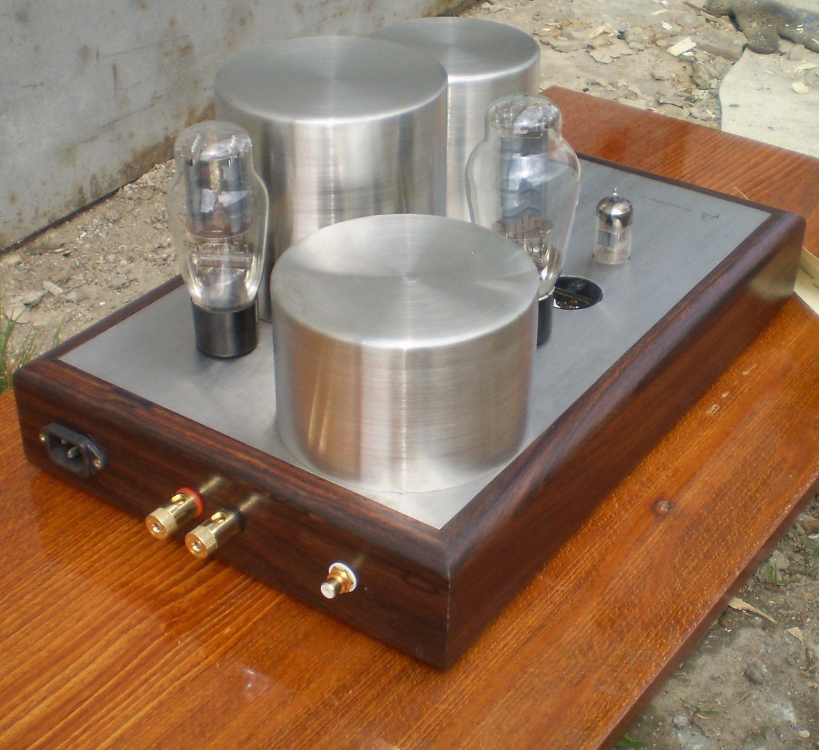

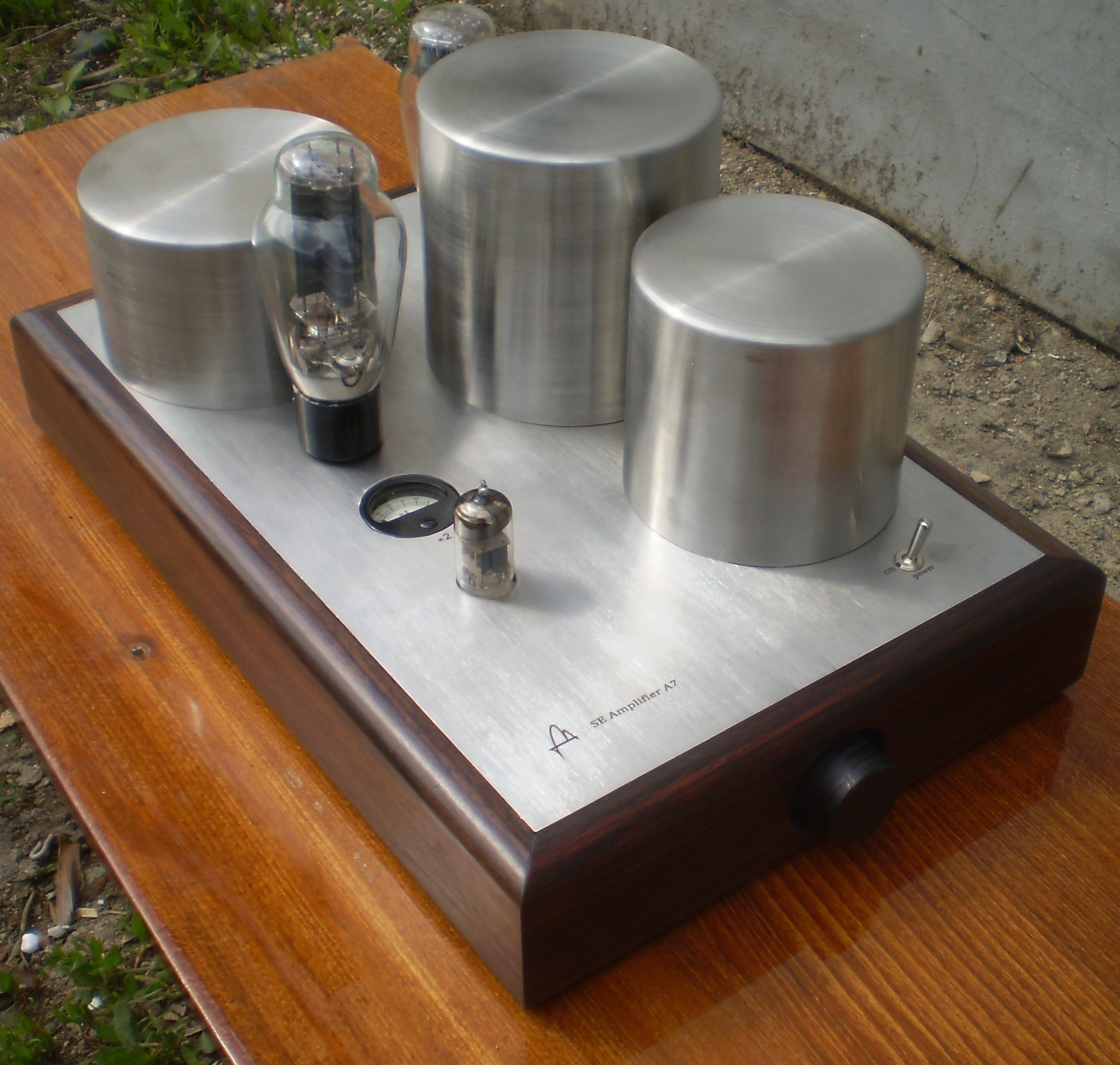

mono 300b lamp SE. the body is made of rosewood
Very nice!
How do you cut the covers for the transformers and fix mountings?
Regards
M. Gregg
Male42: very nice build. Clean and smart looking. What is the driver tube and do you have a schematic?

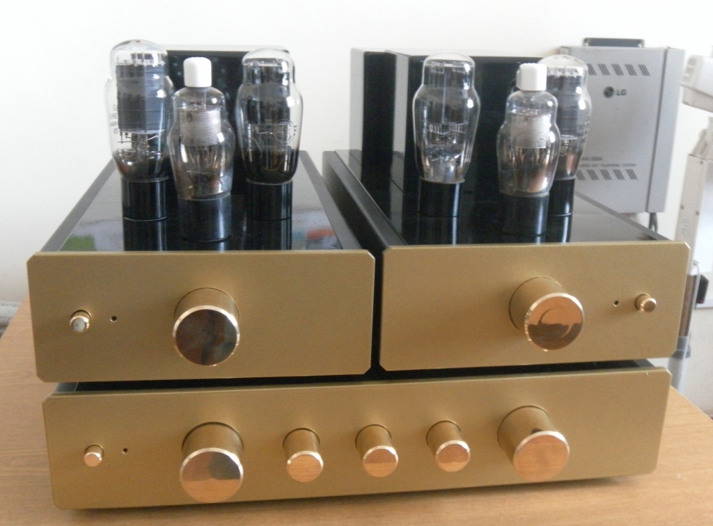

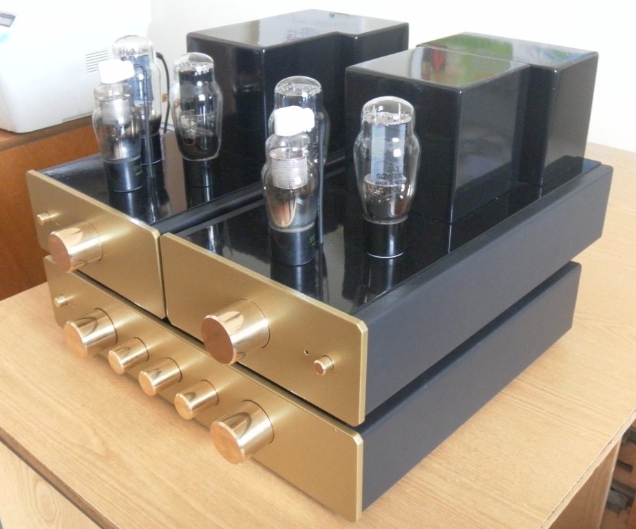

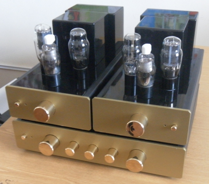

They are pro looking amps. Excellent work.24A-2A3 SE monoblock with a preamplifier.
