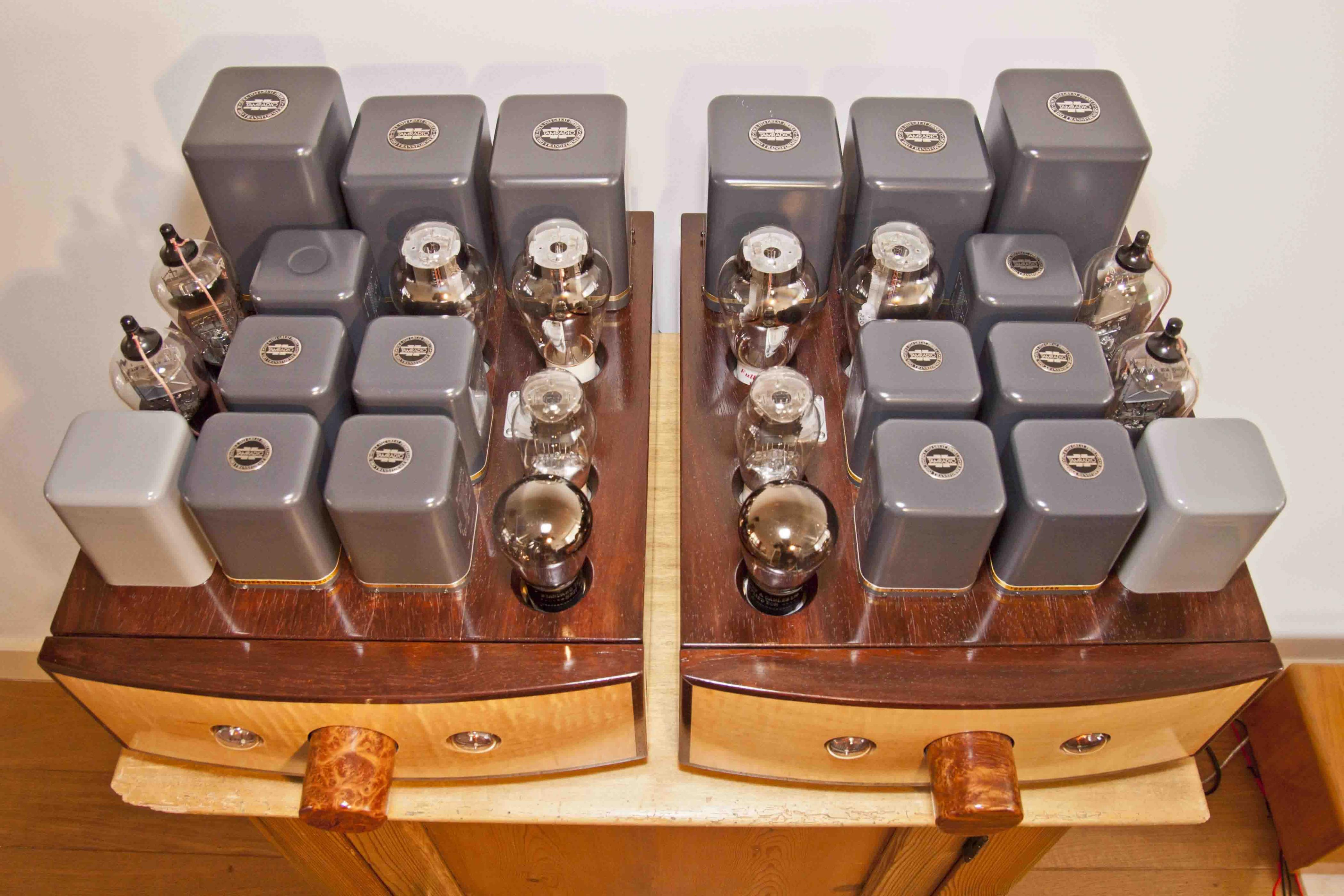

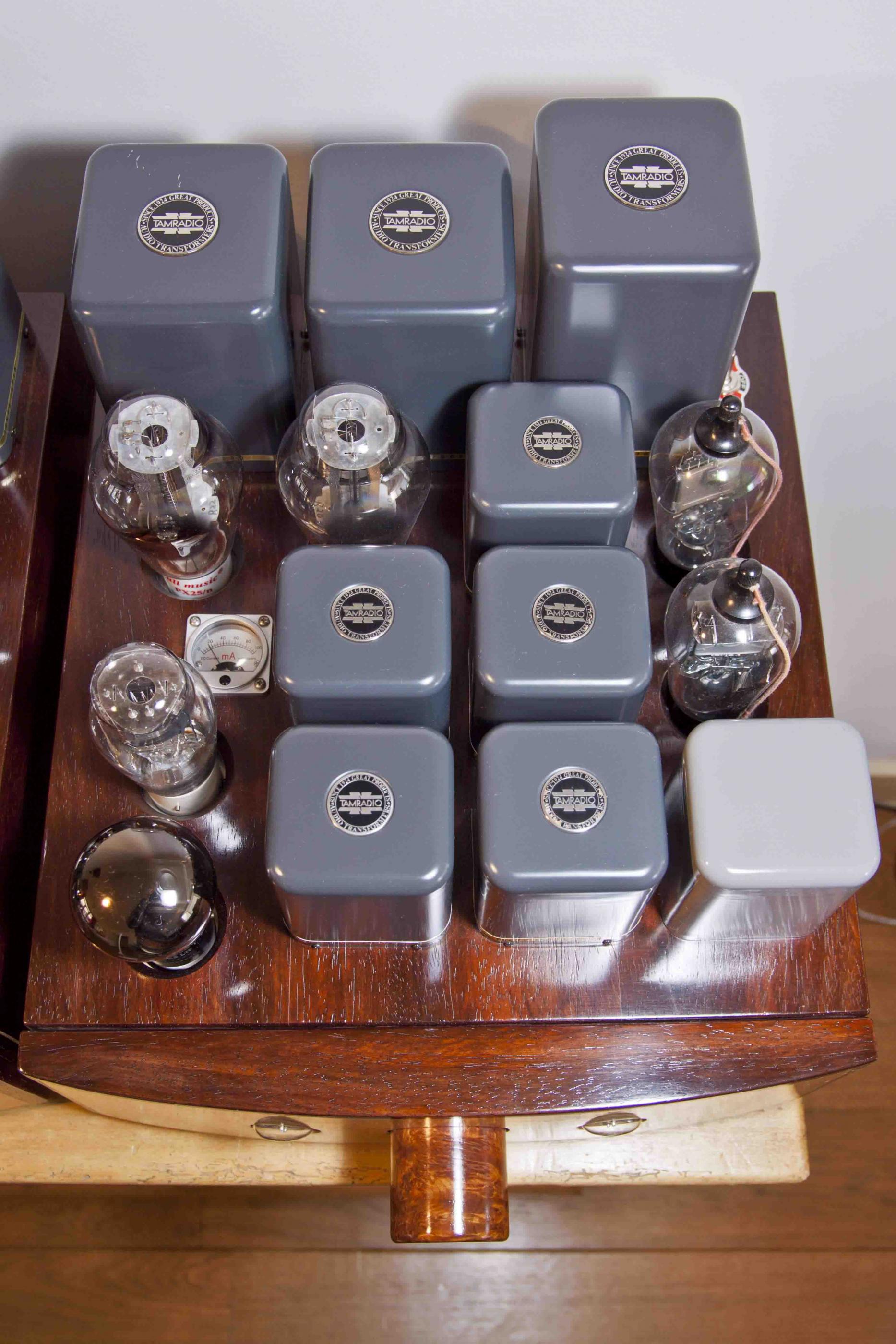

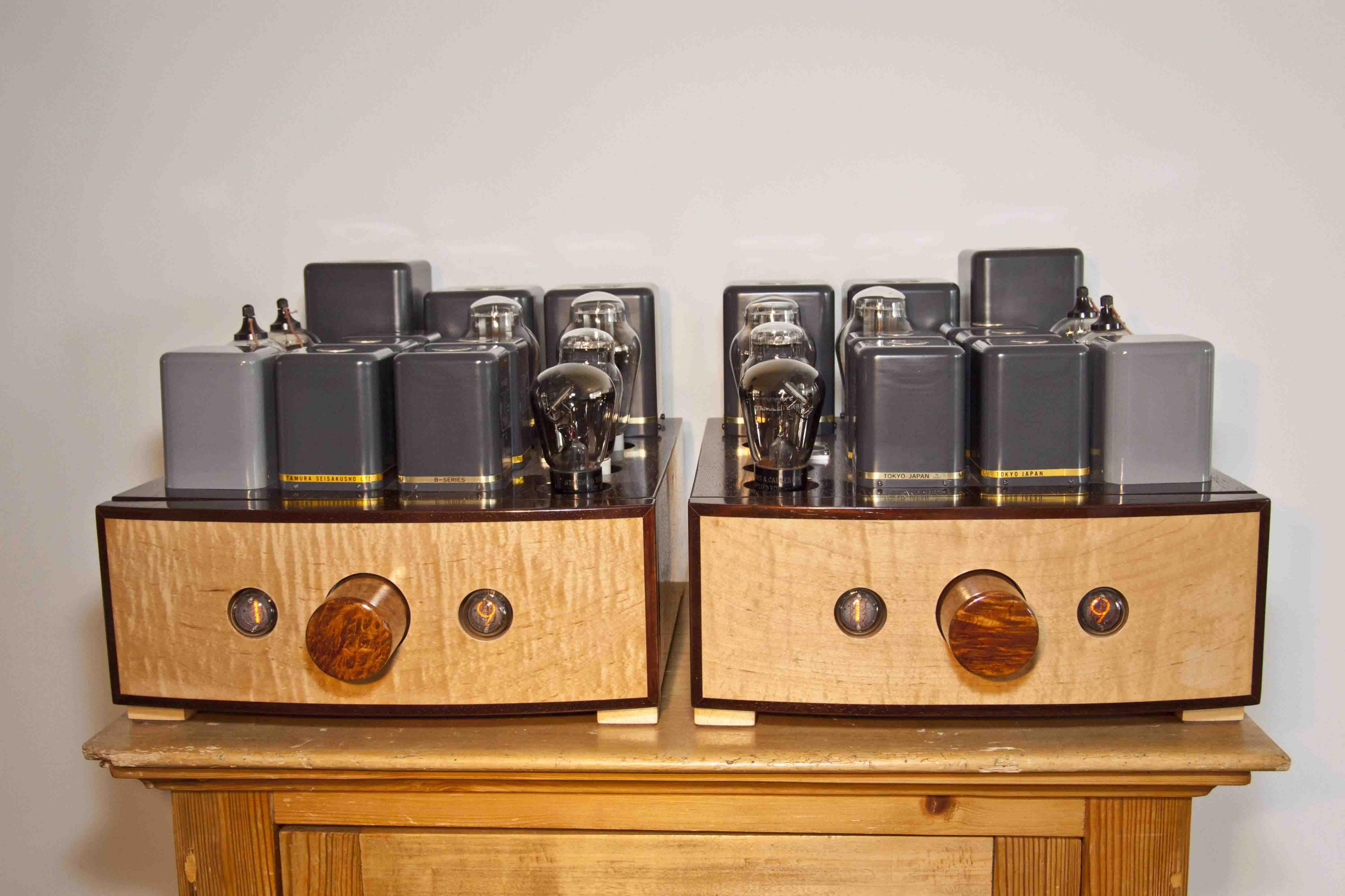

2nd unit, slightly different circuit...
Some pictures of my current amp.
Used Tubes:
input :Standard 4019A
driver: Western Electric VT-25
power: Full Music PX-25 mesh
Rectifiers: half wave Klangfilm KL75303 (Telefunken RGN 1404)
All tubes are connected with interstages, the rest of the transformers you see are chokes.
The amp has double power channels; one for mid/high (actively filtered), one for low frequencies. The channels are split after the VT-25 with two interstages (primary in series) to drive two PX-25 into two permalloy output transformers.
Volume control is by a transformer with 24 sec. windings. the counter tubes indicate the volume setting.
Front is made from maple wood, knob from thuya burl wood, rest is Padauk wood.

Hi Guys,
Sorry! I didn't mean to show-off. I hope to inspire people to build amps in a different way as standard.
A few years ago I decided to make my lonely island amplifier; things got a bit out of hand after deciding for Tamura transformers, these are extremely expensive and hard to get in Europe. But now the design is so universal that I have already tried numerous different tubes and schematics without much trouble or additional costs.
And yes, it looks very cool in the dark.............
