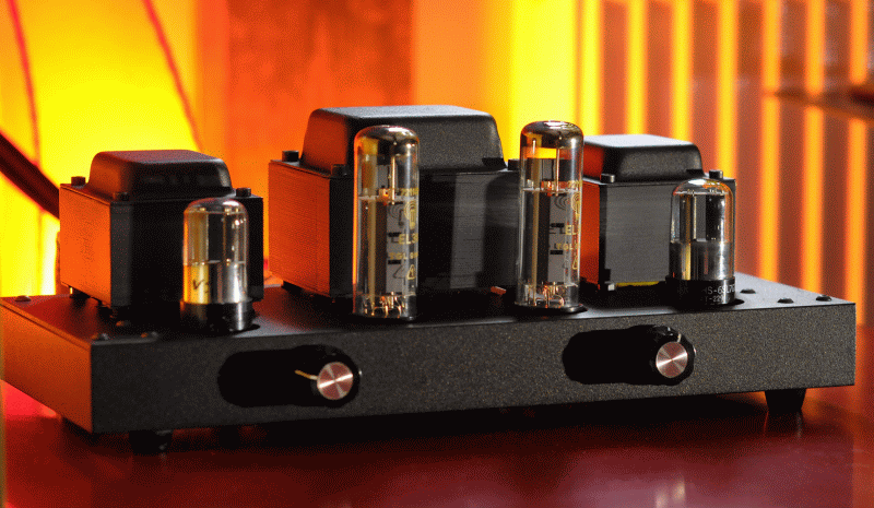

Dolphin123: always like to see something a bit different. Too many amps look to plain. Nice job and nice reds. Which is the front of the amp?
The EM84 indicator (I presume em83) is probably facing forward?
Very nice indeed!
Sure, EM84 is facing forward. Second phtoto shows the front.The EM84 indicator (I presume em83) is probably facing forward?
Very nice indeed!

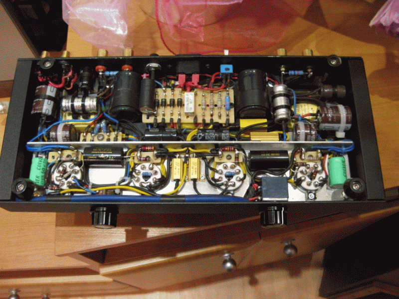

Hi, my last SE EL34 amp - no NFB and triode configuration. On the occasion of Easter - my best wishes of prosperity - Dinkers

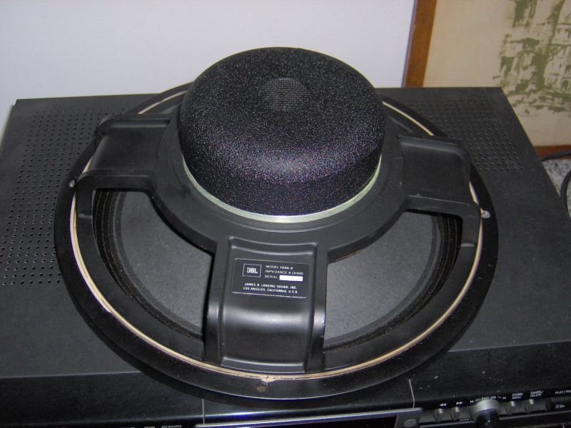

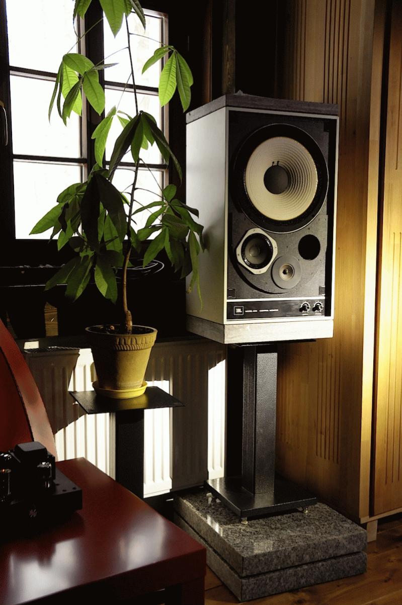

Nice JBL. Thats the 123woofer,correct.
Thanks.
That's well laid out and stuffed to the brim. Very nice work!

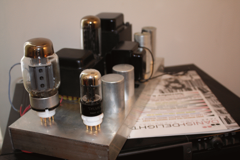

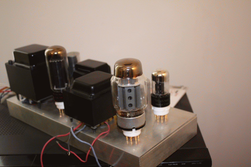

Yes, the JBL 4110 woofer works 123A. By the way I present my new project SE KT88 monoblocks. Regards Dinkers

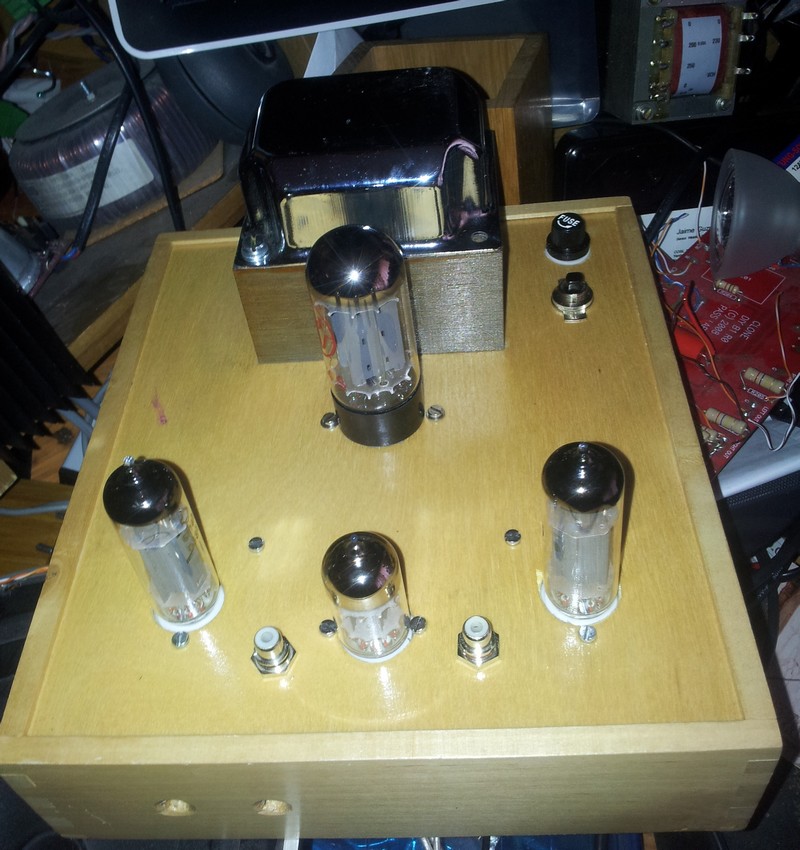

A quick and dirty build. Initially wanted to add a lightspeed as attenuator. Hence the holes in the front. Alas not enough space. I'm very happy with the sound of the RH84. Especially as the output transformers were little 10$ jobbies from Triodeelectronics I bought yeaaaars ago. Very satisfying to build something relatively frugally and have it turn out so well... soundwise. Here still pictured with Russian made EL84. (Not the EV version) which have now been replaced with JJ which were slightly better sounding imo.
A quick and dirty build. Initially wanted to add a lightspeed as attenuator. .
It looks great. I am sure you have considered that the lightspeed can be controlled outboard. The only thing that needs to be in the amp is the pair of LDRs and the 100uf caps on each channel. I used CatV cable to run to a separate box with the PS, reg and Pots. You can still get the great sound of the lightspeed in tight quarters.
Thanks for the idea. Might just order some more LDR's because I don't feel like desoldering them from the current pcp.It looks great. I am sure you have considered that the lightspeed can be controlled outboard. The only thing that needs to be in the amp is the pair of LDRs and the 100uf caps on each channel. I used CatV cable to run to a separate box with the PS, reg and Pots. You can still get the great sound of the lightspeed in tight quarters.
