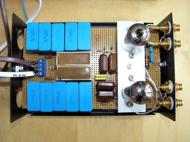

Did not have much time (finished at 2 a.m.) and LPs to listen to, but in comparison to my Aurex preamp with phono stage:
- it is more lively
- the sound is not dimmed (my wife's remark)
- there are more details to be heard.
- bass is better controlled, good dynamics
- highs are good enough
- my wife likes the new one better !
Overall: it is good. Well designed GND is a must. I did matching of all components.
I will do some more comparisons and checks (Thu) at my friend's. I will let you know.

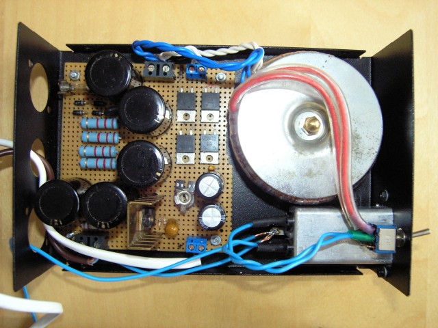

Can you post your PSU schematic? I'm interested in this phono stage and I'd like to see your regulated PSU design.
Kofi
Kofi
Phono pre PSU
Kofi,
The HV PSU is unregulated (CRCRCRCRCRC) for output tube and next RC filter for input one. I use regulated PSU for filaments (LM317).
If you still want it, drop a line.
Yag

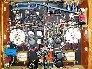

my final Stax electrostatic headphone amp. Schematics by Kevin Gilmour (www.headwize.com) I made some minor modifications in the PSU. Sounds very good!...Thanks Kevin.

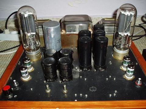

Angel Puerto said:This is my first and only experience in amplifiers to valves. A while ago that I made it and I am satisfied with the result.
Greetings.
Your first tube effort you say, that is some fish story! 🙂
Very Nice.
Regards
Anthony
ONGAKU 211
Now I am interested in making an amplifier with 300B.
Some suggestion or circuit in special?
Thanks.
Ángel
Thanks.
Ángel
