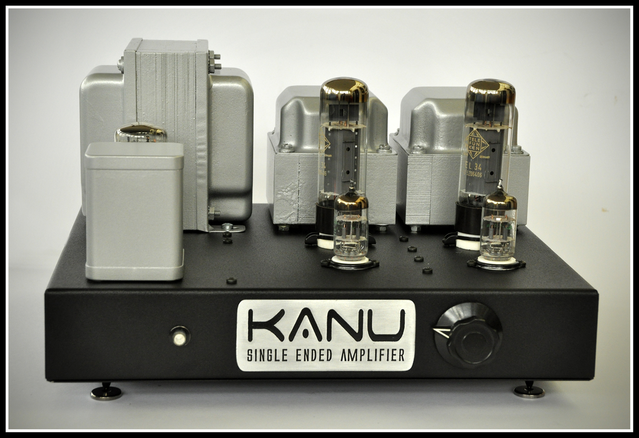

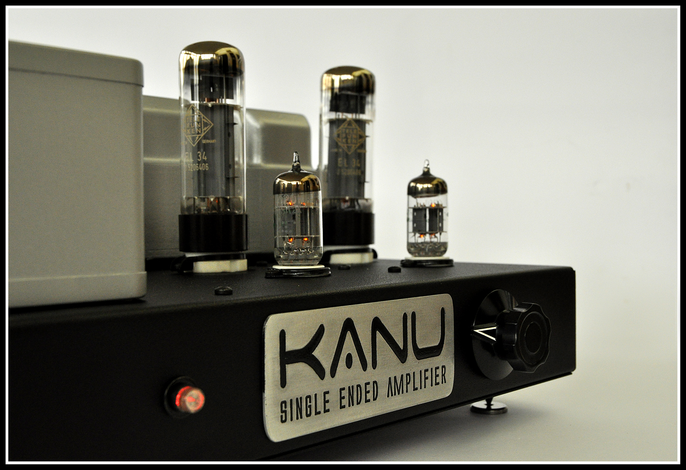

My new SE EL34 amp.
What preamp tube did you use?
Also, do you have a good source for those nice old bakkelite knobs?
Preamp tube is a 6021 (12AT7WA) but will be replaced with an ECC801S.
That knob is from an old power supply. I used some polish to clean it.
