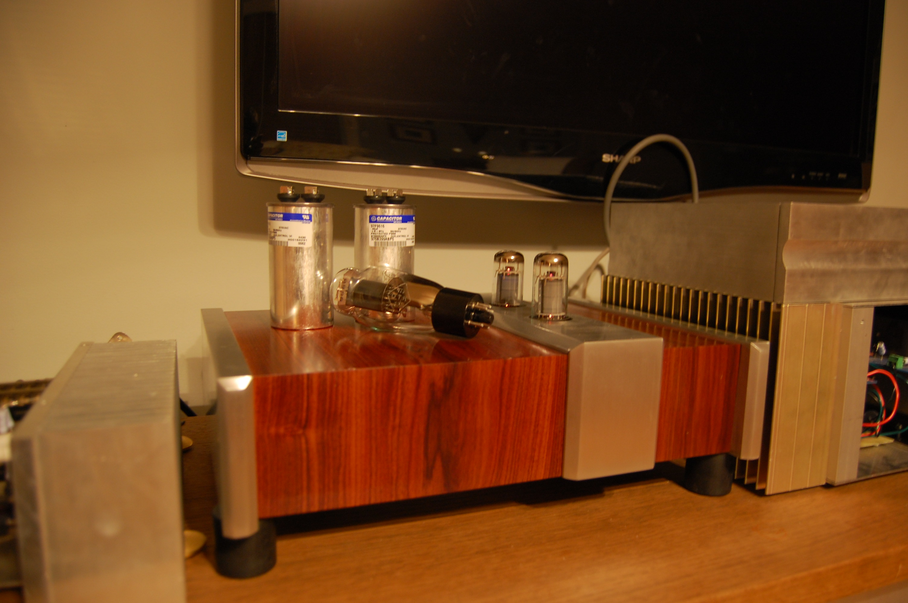

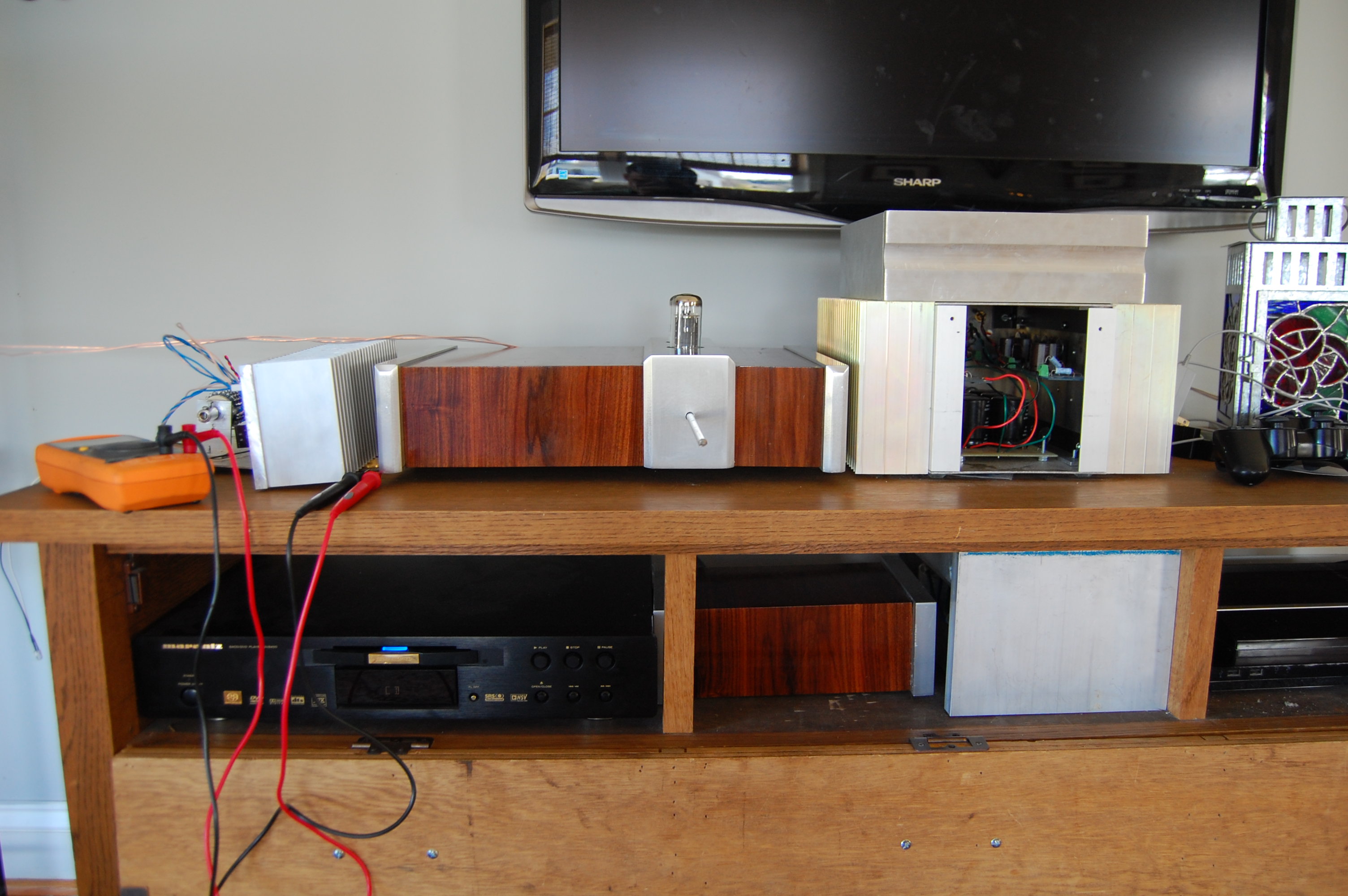

this is my Shuguang EL34 pp amp, ultra-linear output, based on the Mullard 5-20 and HK Citation V amps....sounds fantastic, bass is tight and controlled which is a revelation.....
B+ at OPT center lead is 445 volts, tubes are biased at 33mA each.....so that they are idling at about 15 watts each.....
the front end 6J9 tube B+ is zener regulated....it is very quiet, no hiss, no hum......Hitachi 6CG7 LTp drivers....
solid state psu with big capacitor filtering, a common mode filter choke isolate the rest of the amplifier from the power supply, freds isolators ensures cross-talk between channels are minimized, with generous filtering psu ripple is held to a minimum.
testing and setup:
fixed biasing with about 33mA on each cathodes put the tubes idling at about 14watts at idle....
using my power monitor:
line current draw is shown:
true power consumed at idling:
apparent power draw:
line frequency:
line voltage:
under the hood:

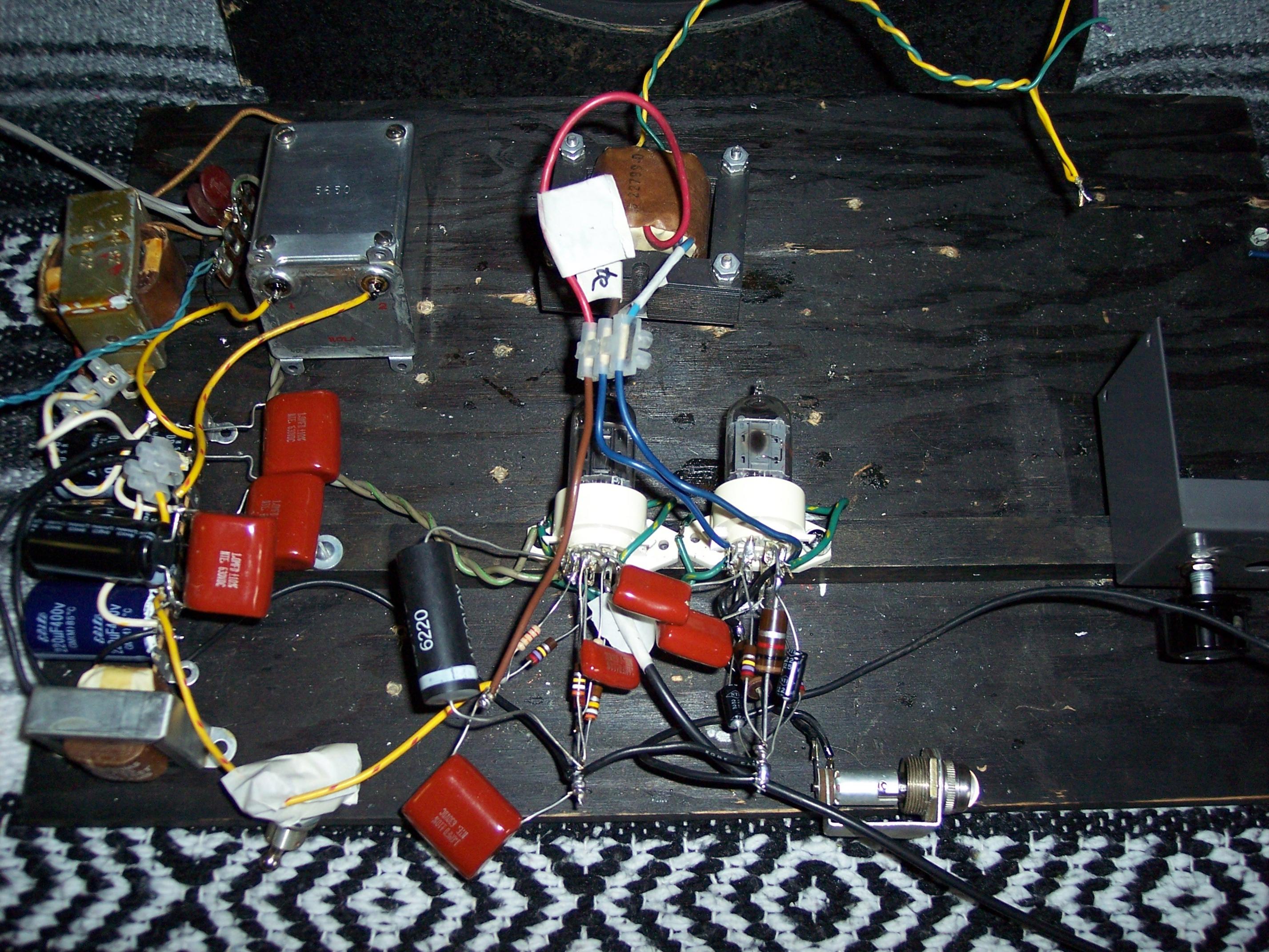

A 12AU7 push pull output joke amplifier....
At first I just wanted to see if I could get any amount of sound out of this set-up. The circuit is a simple 12au7 up front, one triode as first audio, and then the second as a phase inversion driving a 12au7 push pull. The OPT that I used has 34k p to p and 8 ohm on the secondary. All PS caps were bypassed by 1mfd pp. The PS employed was a junkbox PT 136v and then I made a voltage doubler to step things up.
Like I mentioned in the title it was built as a joke, but turned out well for it's power capability. Here it is on the bread-board... I am not sure if I will be building this in stereo yet, as there are better things to do. I did not build from a schematic, so if you would like to try this, give me a little time to draw one up.
Also I have a audio sample for you, the link is to my youtube...
12au7 pp sample amplifier Mono - YouTube
